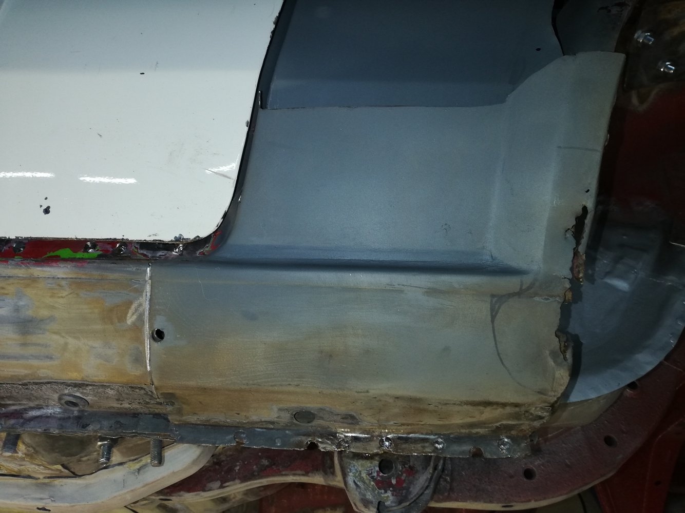

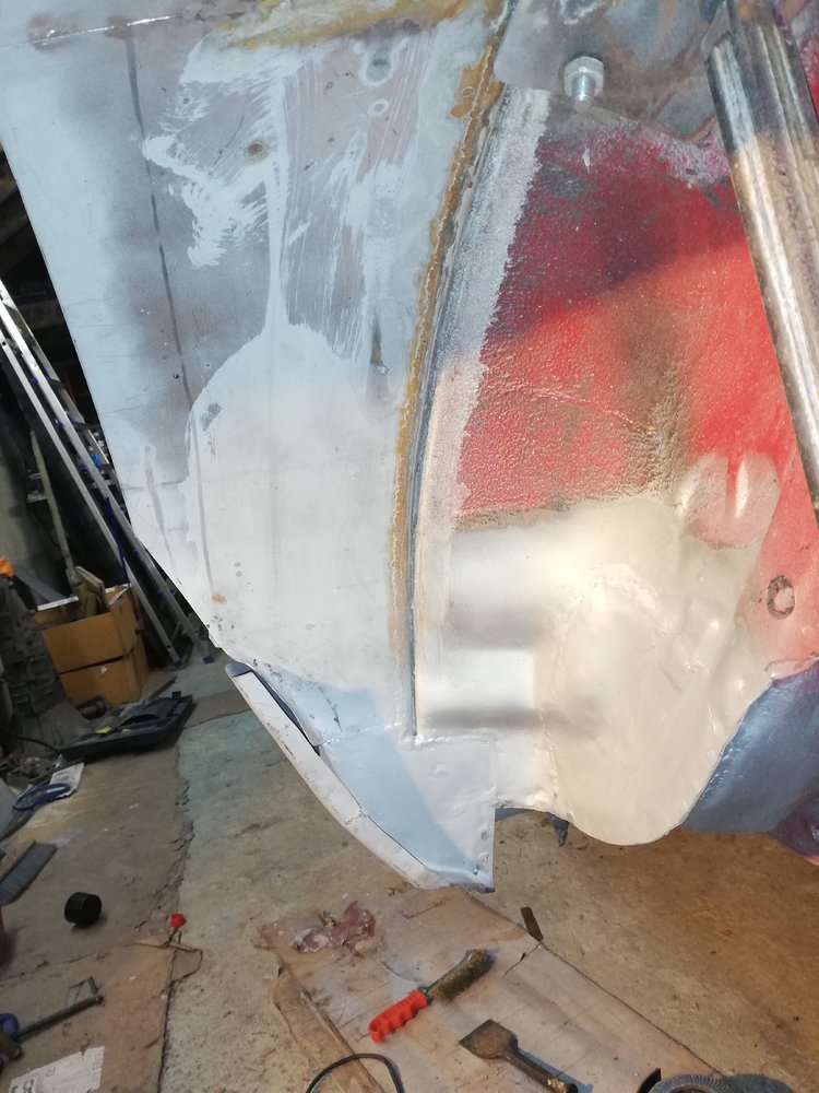

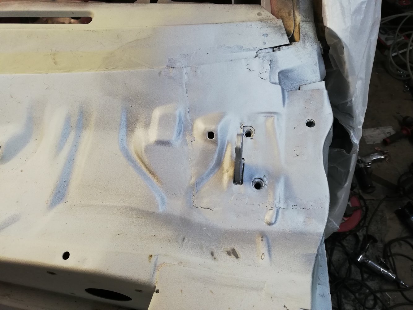

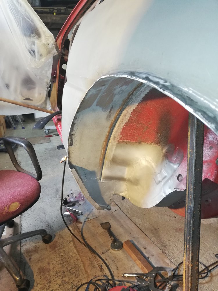

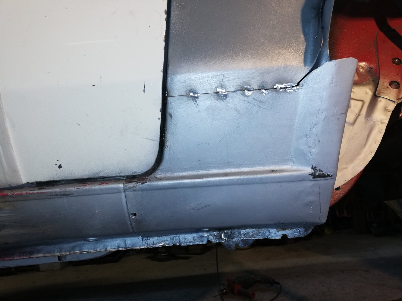

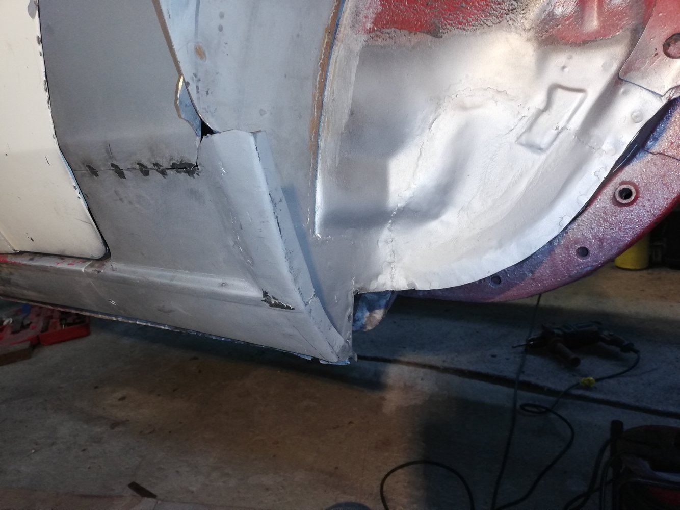

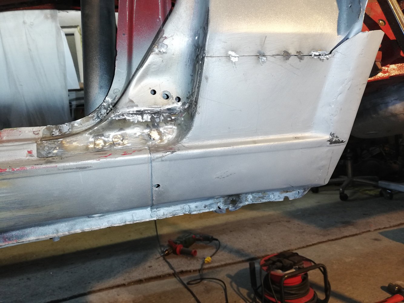

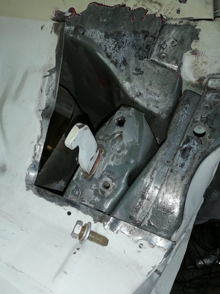

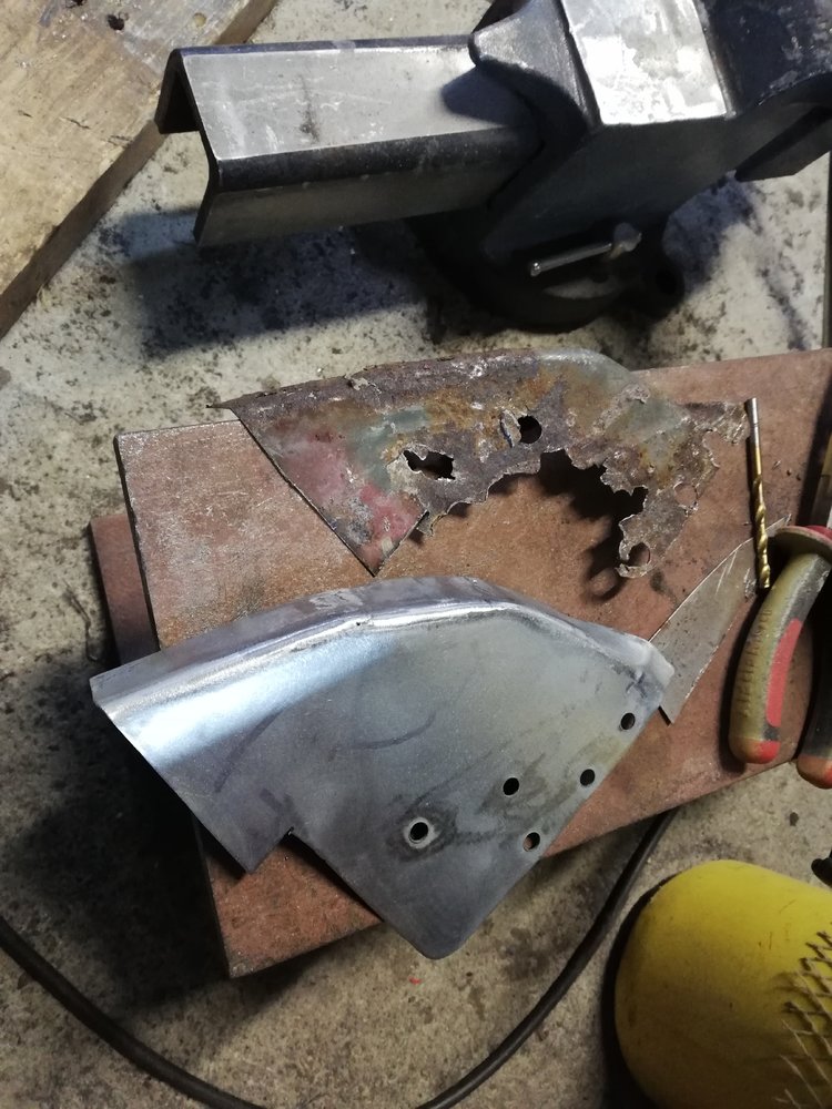

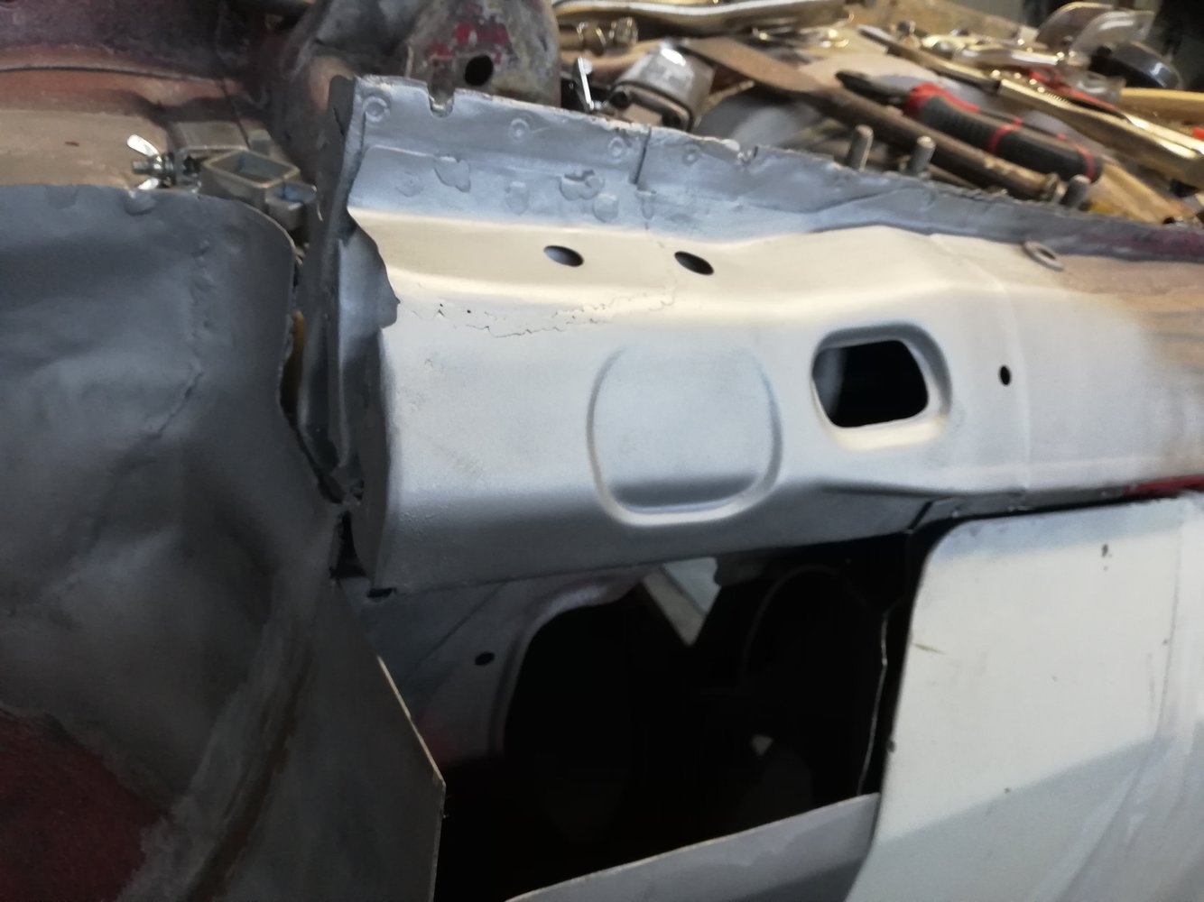

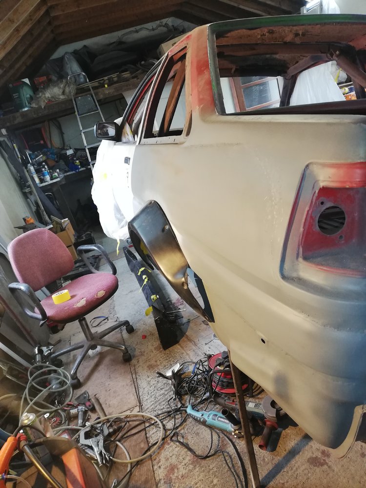

This area is quite complicated as there's a lot missing (rotted away) so I'm having to be creative....Ouch.....
It must be nice to be able to do sections like this big and relitively easy pieces to fit always feel like great success.

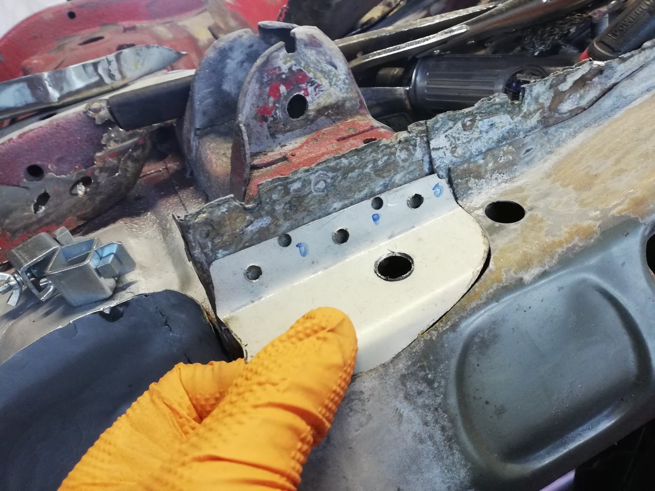

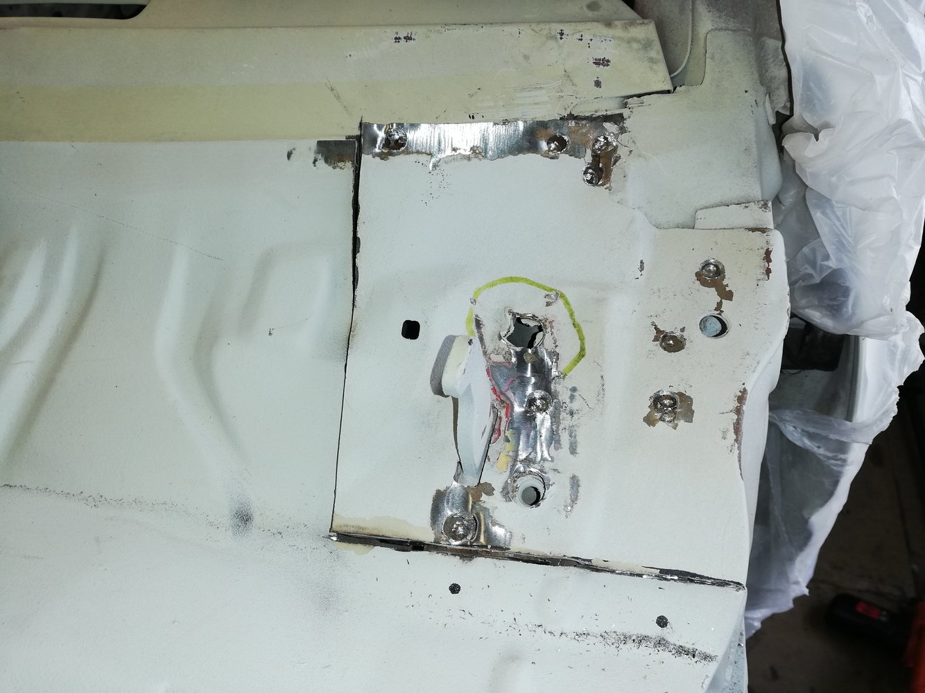

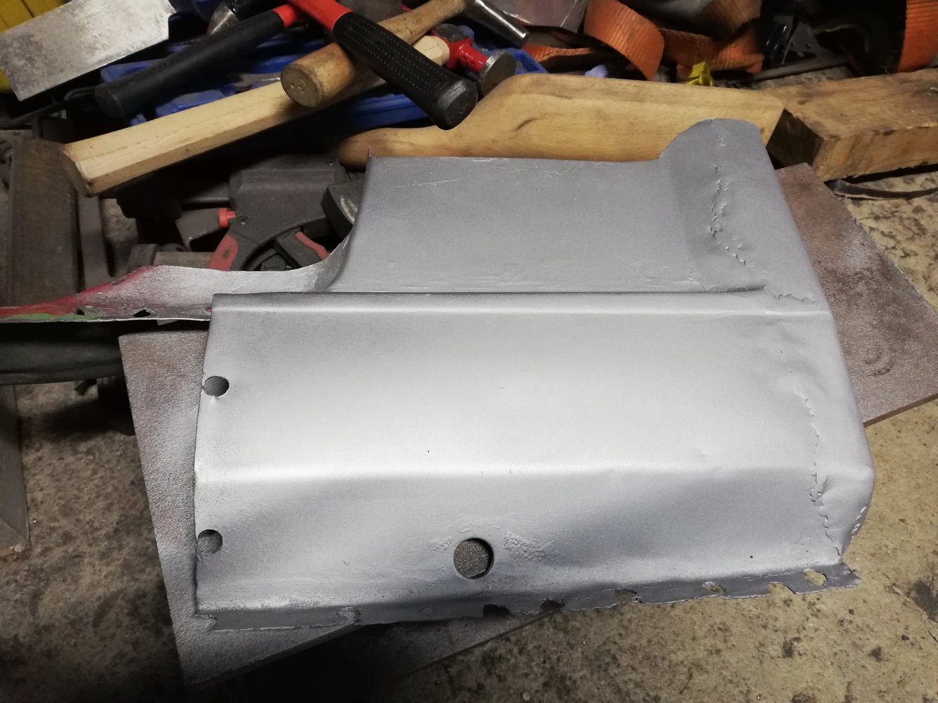

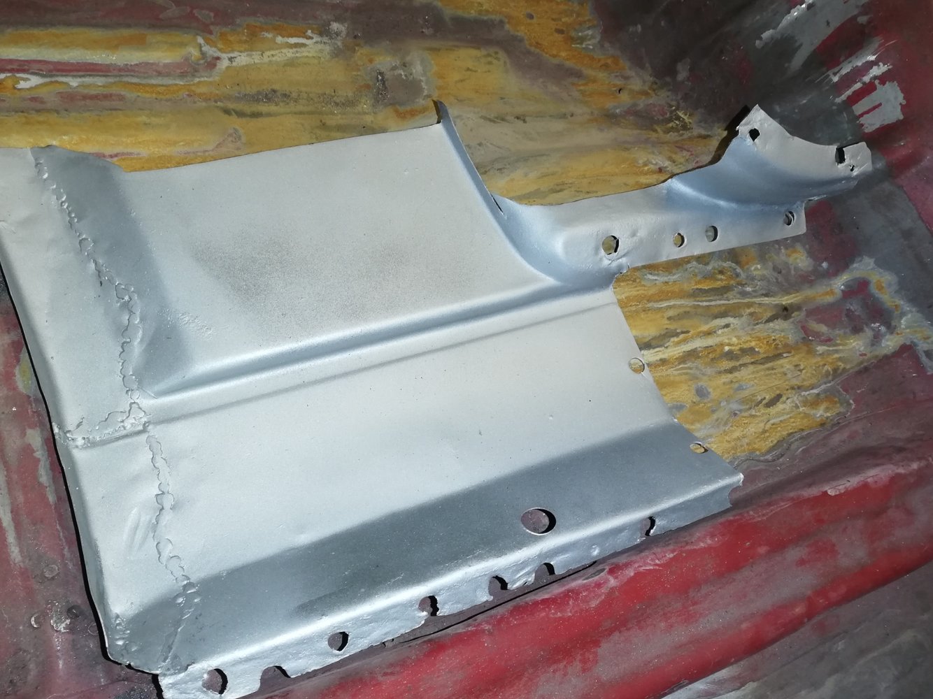

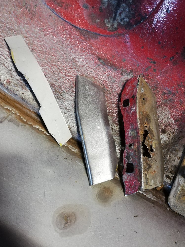

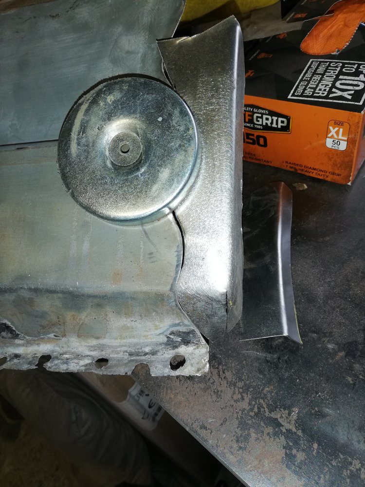

The blank (?) for the end of the sill:

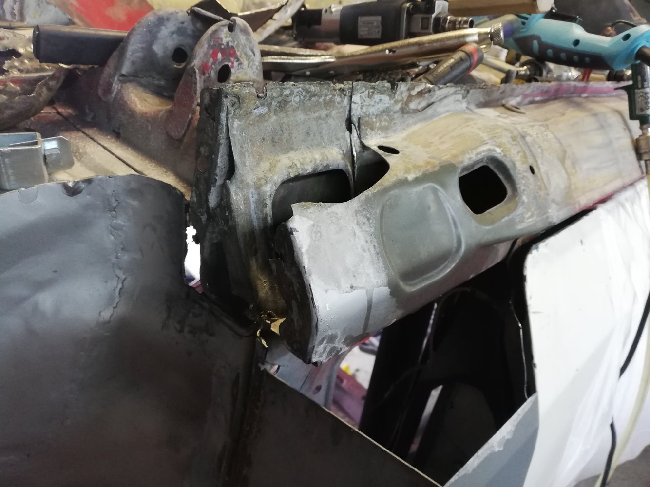

.....^^^ the above will be plug welded to the inner and sill membrane, and will be butt welded to the inner arch as well as the inner wheel well...

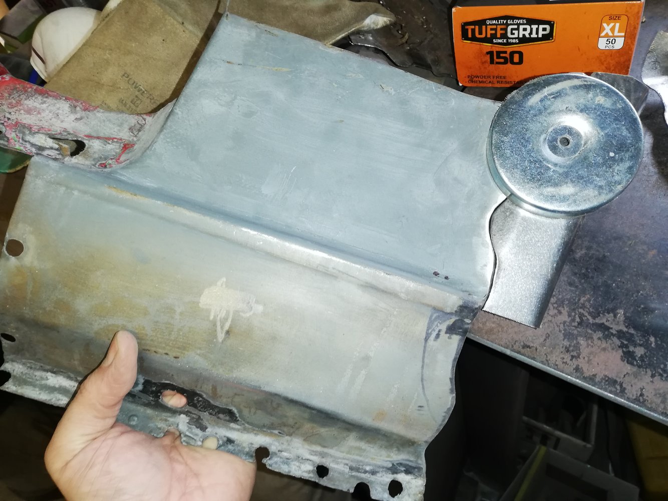

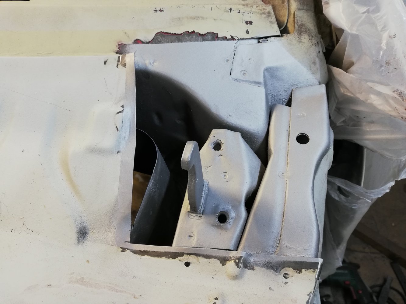

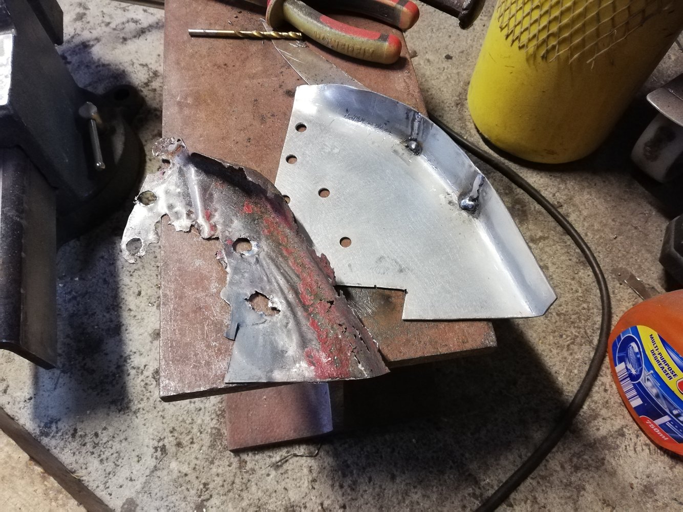

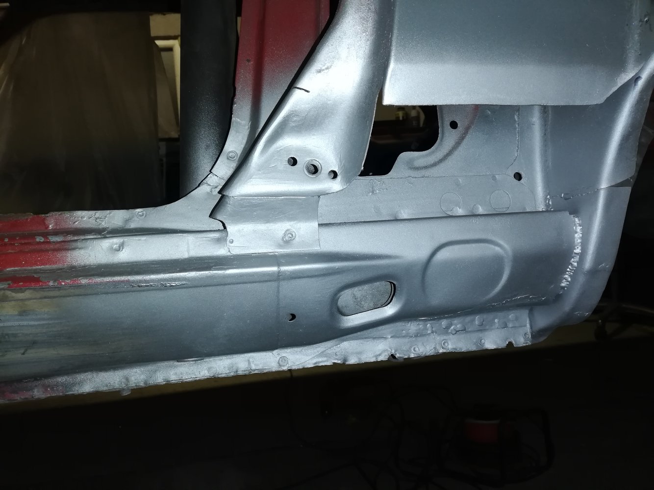

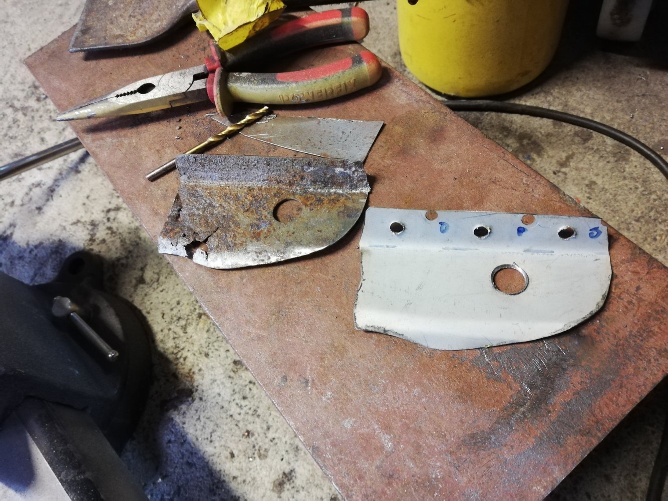

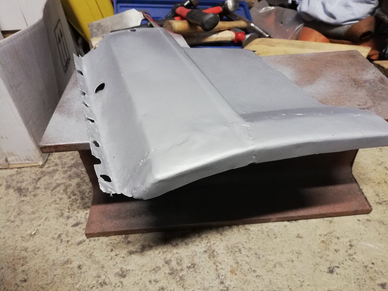

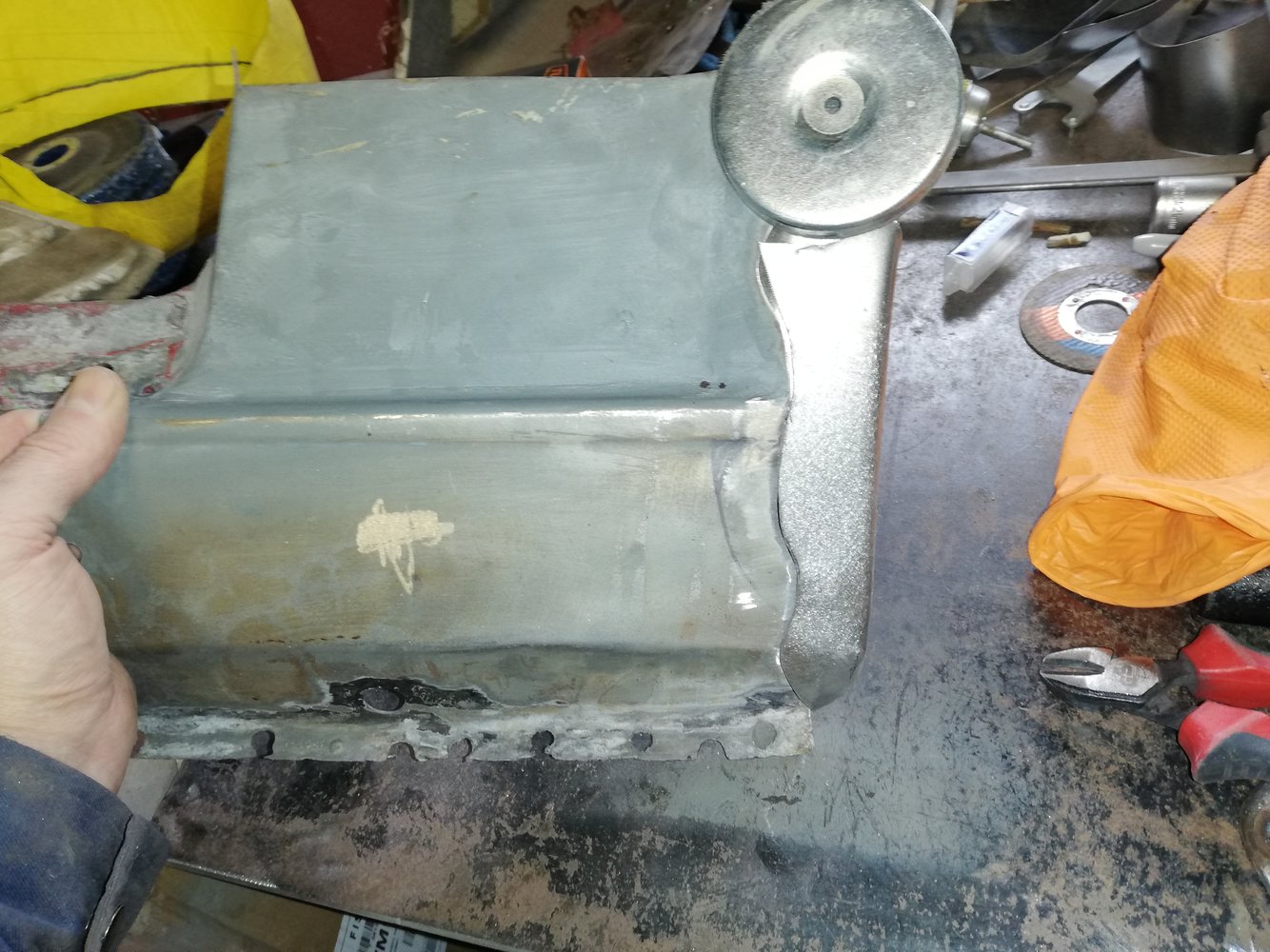

.... repair section for the inner sill:

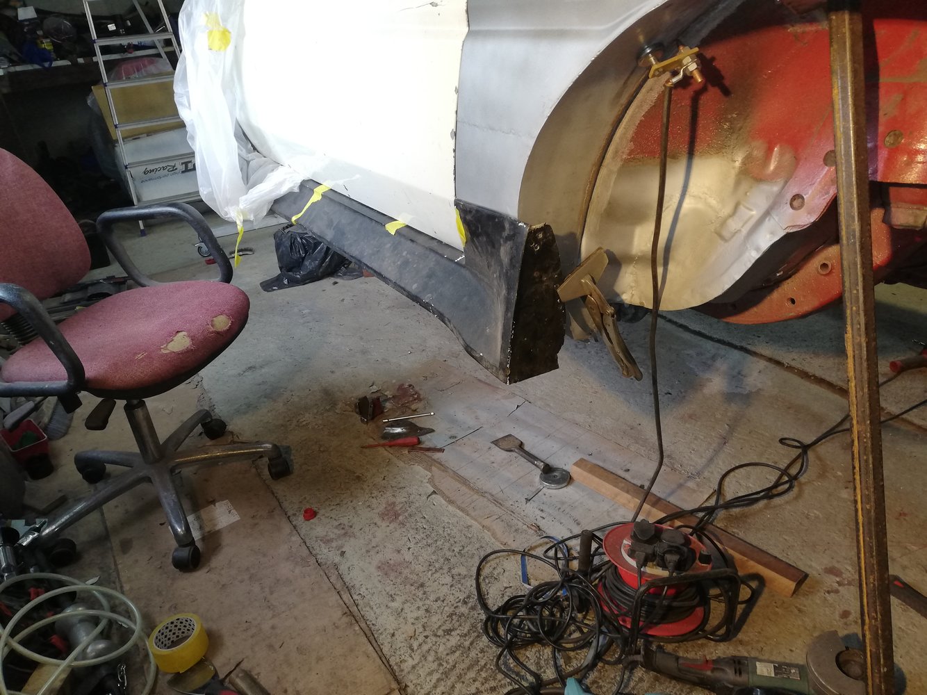

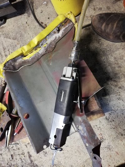

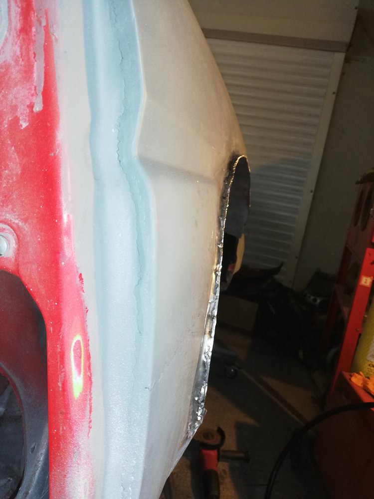

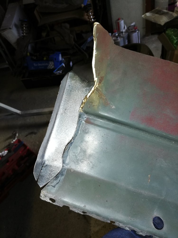

....and cutting out the rot from the quarter panel sill end:

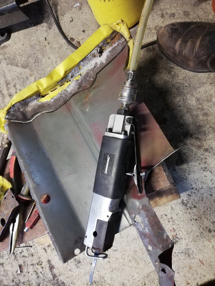

The cheapie air saw is great, but the replacement blades (from china) aren't so hot

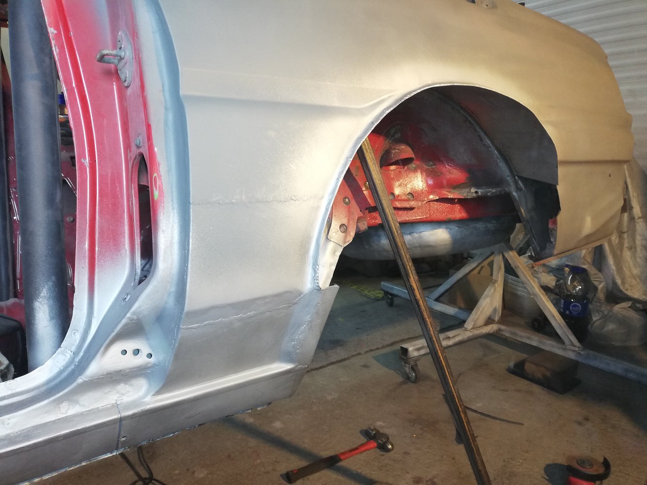

) next time

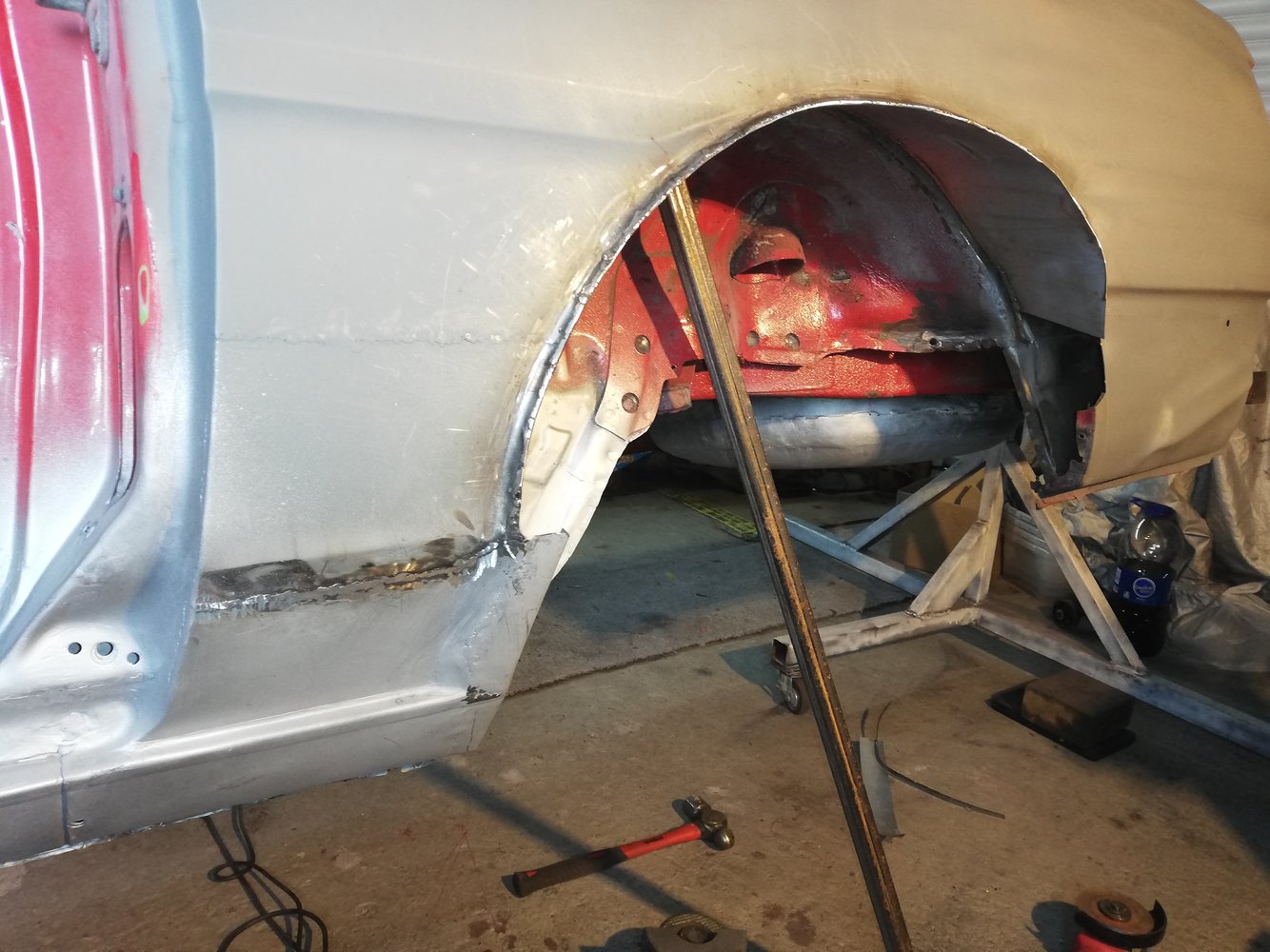

, although I did fill in the holes left in the floor.
