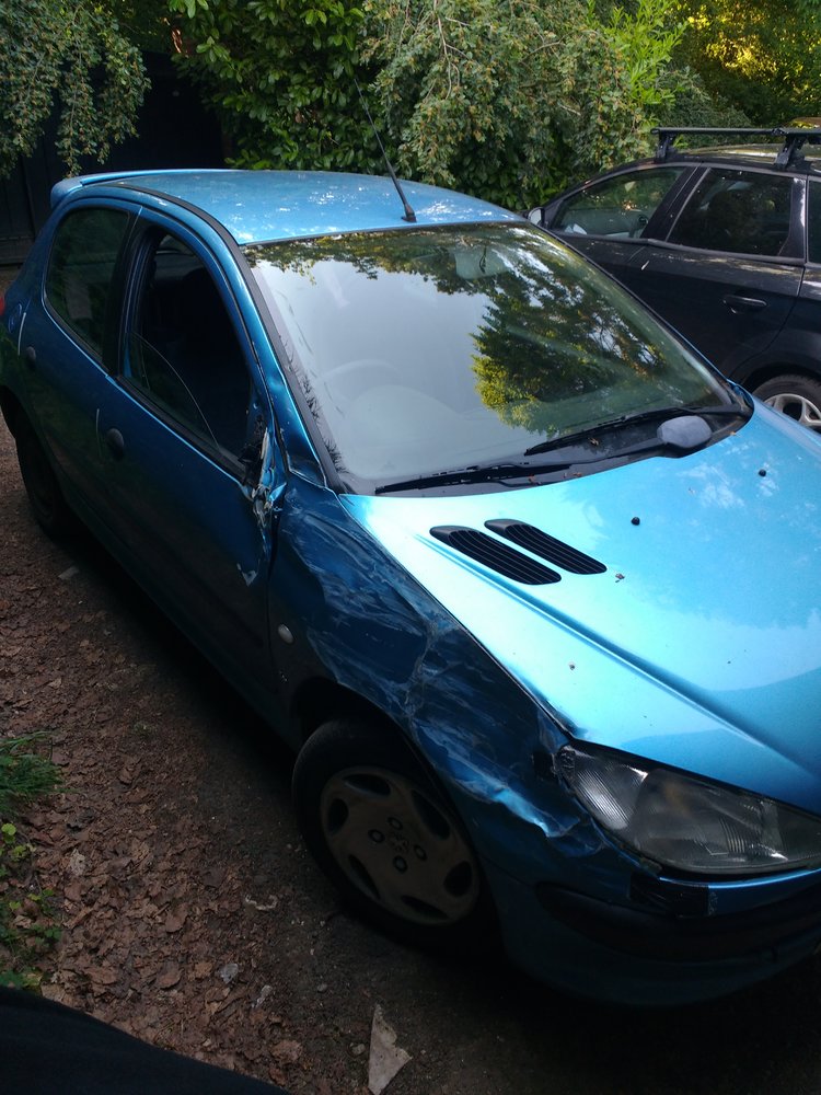

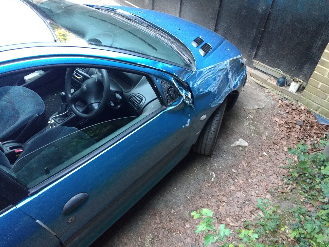

We had an '04 Citroen C4 that, according to the OBD codes, kept eating coil packs. Your symptoms sound similar in that it idled roughly and eventually just refused to start. After it happened a 3rd time, I read a couple of posts online which suggested the BSI could be at fault. Not a cheap part, but I just happened to have a scrap car of the same model at the bottom of the garden and pinched the BSI from that, and it did solve the problem!
