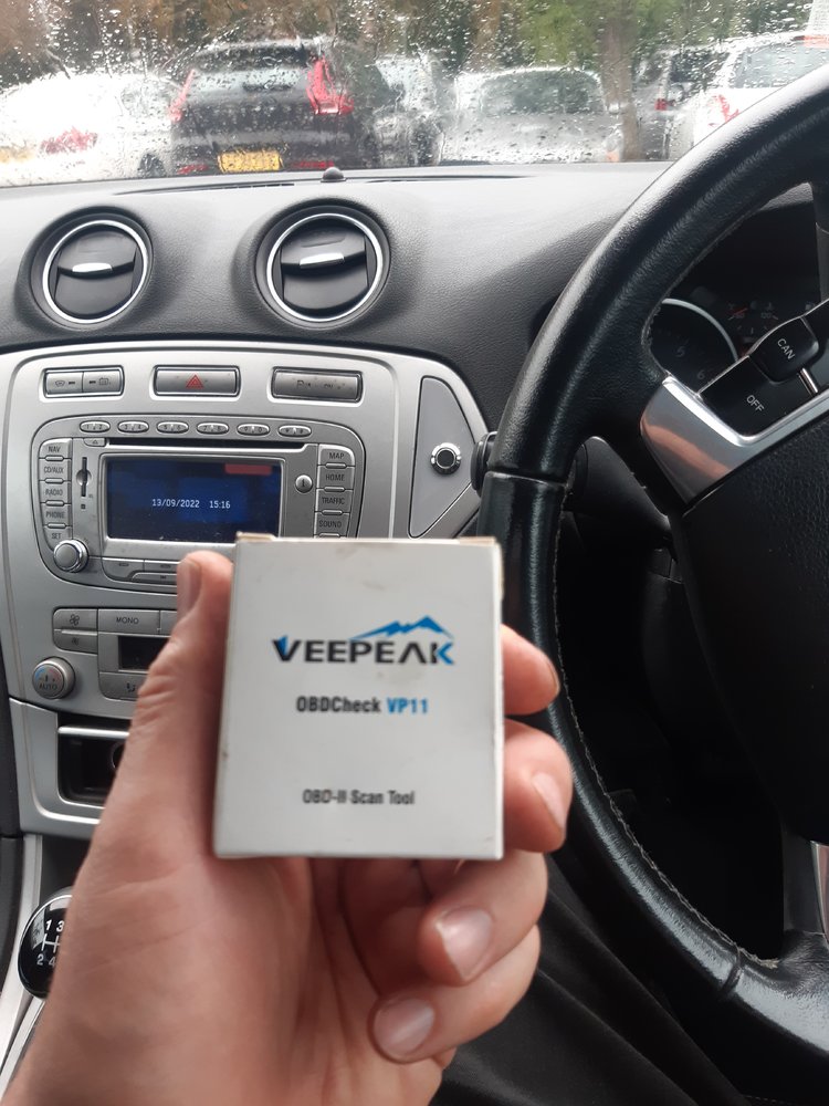

Is there a way of reading the obd data, maybe buy a cheap reader and plug it in?

Can you get a look into the fuel tank - the bit about struggling up hills has me wondering about water?This is a 2000 car, pre plex or something like that. Even my BiLs top brand reader (he has a few) struggled and gave limited diagnostics, even then nothing related.
List of changed bits is endless but immediately then fuel filter, all 4 injectors, the coolant sensor next to the stat. Coil pack too. There is a MAF, all I've done with that is clean it.
