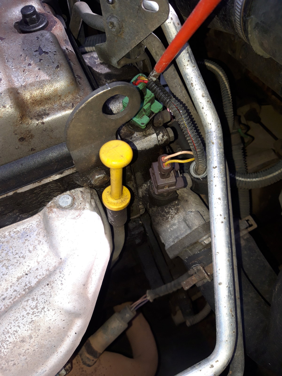

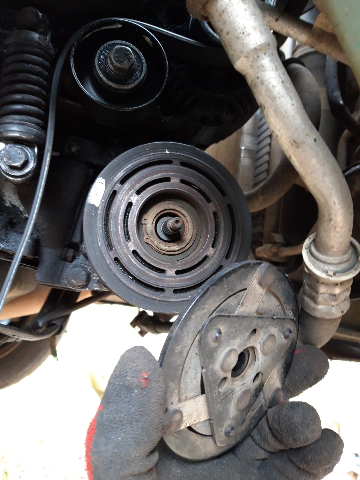

Does it make the same noise with the A/C clutch engaged?

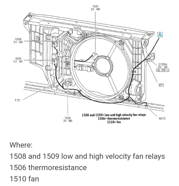

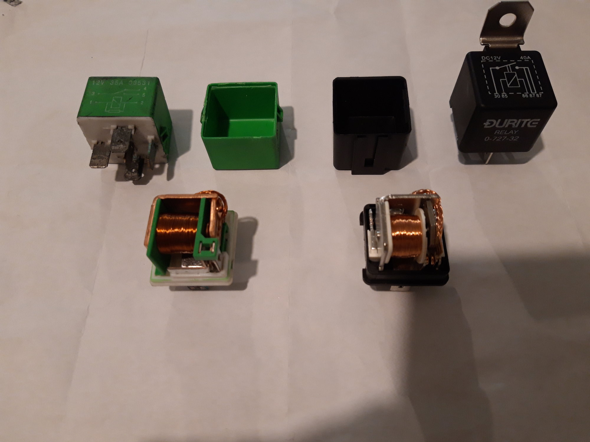

Depends if the ECU controls the relays or not - if it does, that EMF disapating resistor matters.

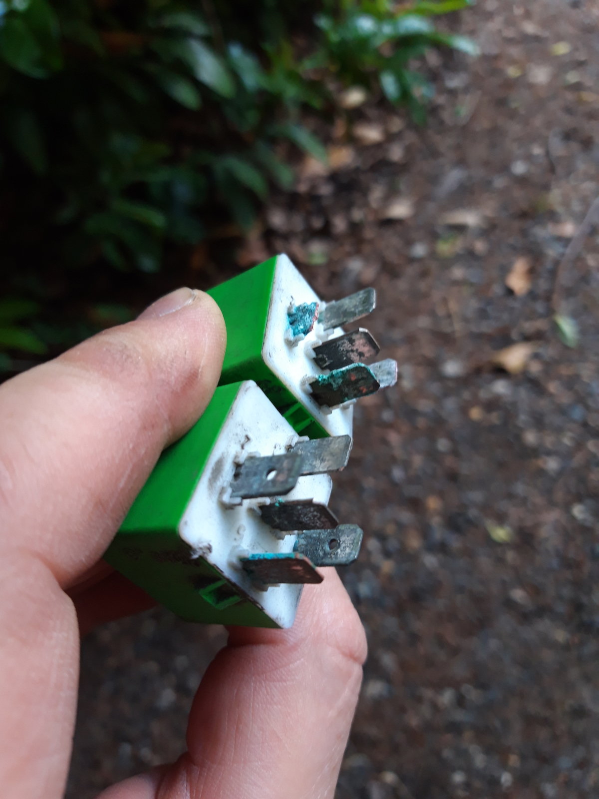

I assume you've tested the old relay to see if works or not, and shoved a flying lead between the switched terminals to see if the fan itself works?
that relay issue is a common fault on most pugs

yep , id got that ,, just mentioning the timing belt for any one working on one in the future ,, that was all.Nope. Whine was the bearing in the AC clutch. All sorted now.
