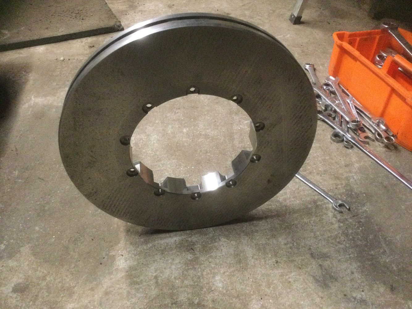

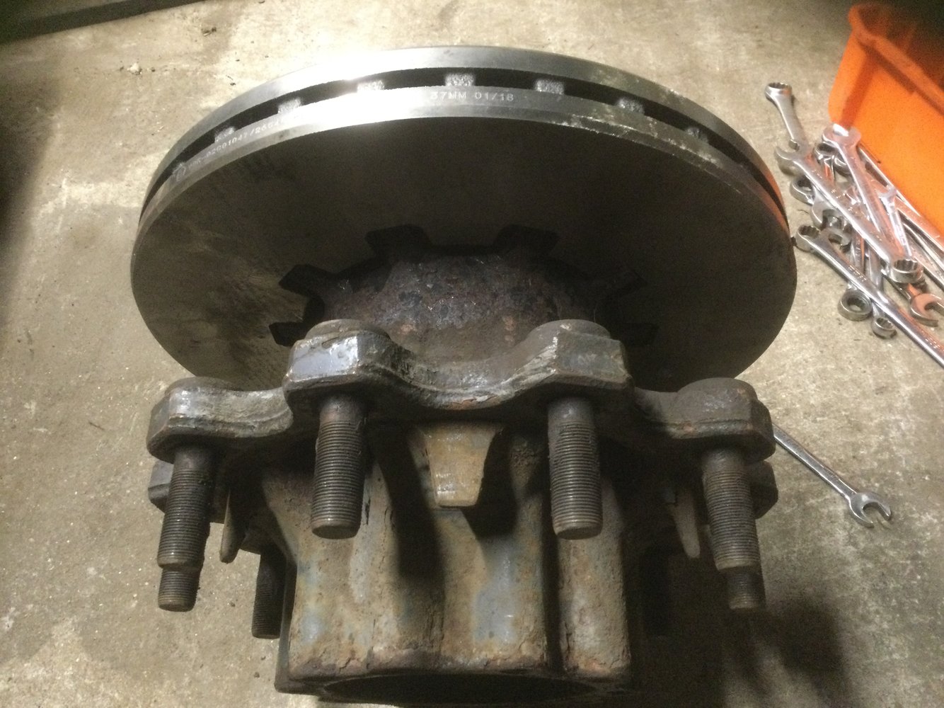

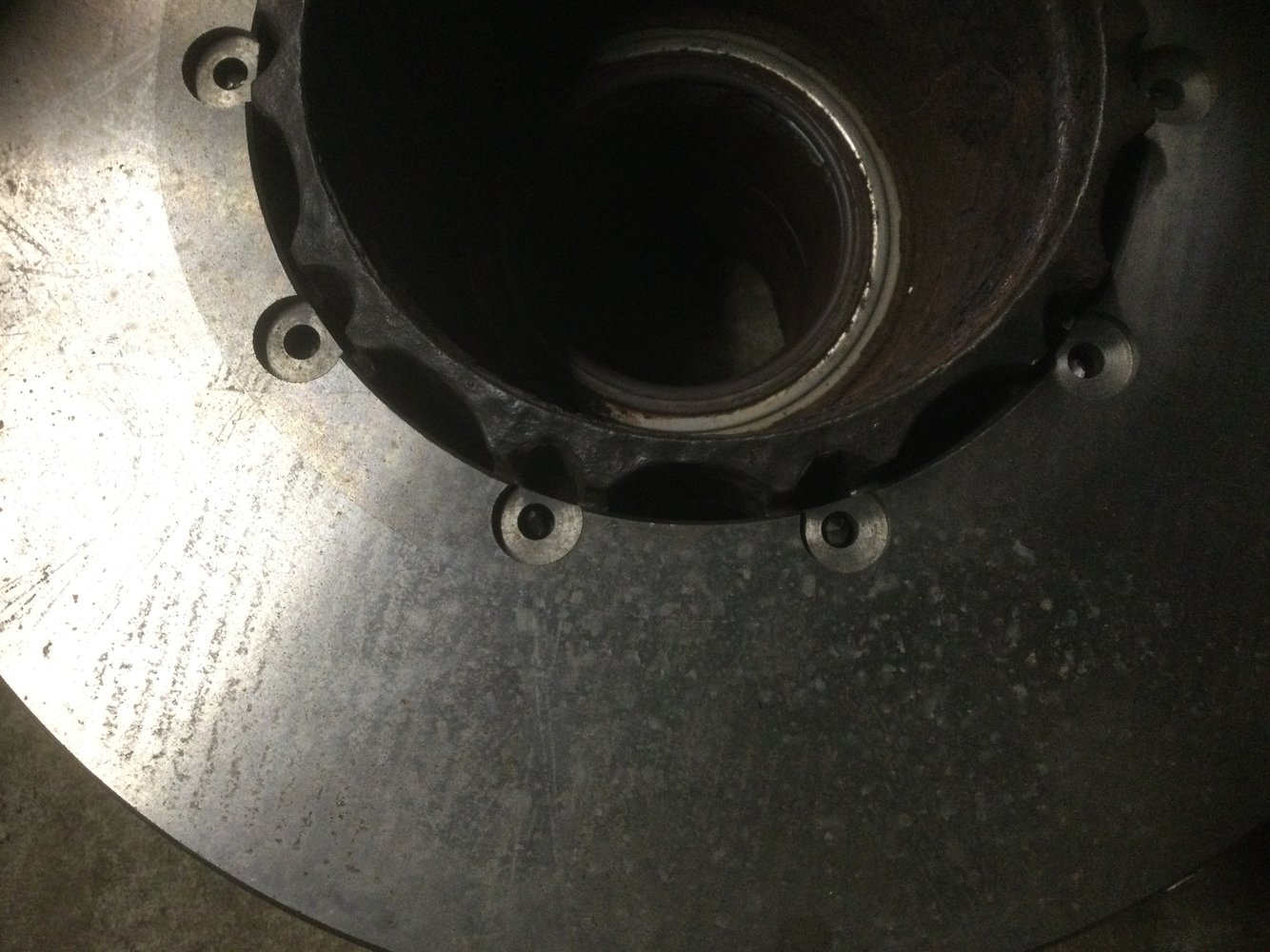

I could use the new discs as a drilling jig if I spun up some drilling bushes, I can cut the broken bolts down with the gas axe. I have tried to mill off the top of the bolts but they are way to hard for any of the cutters I have here.
There are four of these hubs to do.
