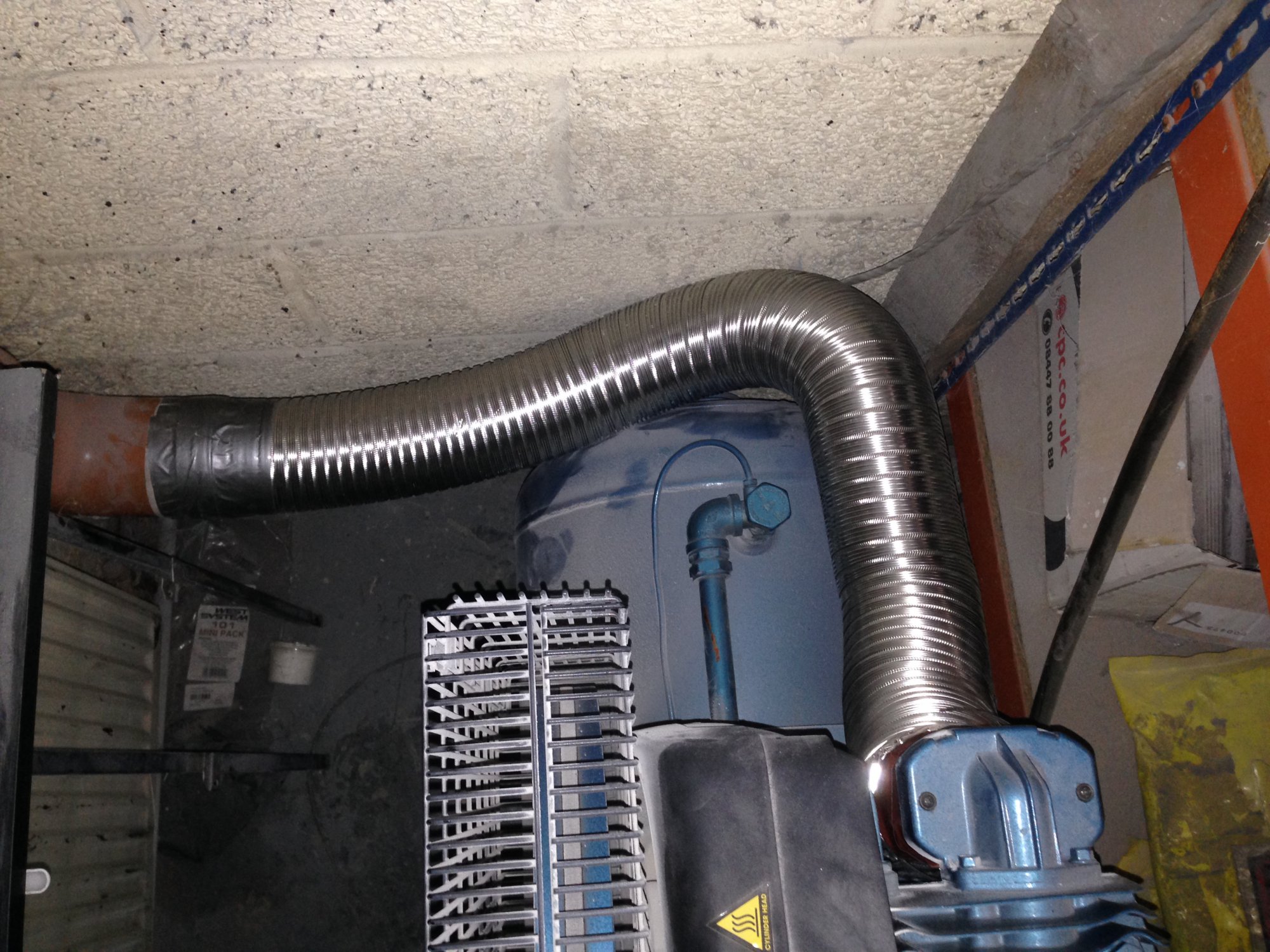

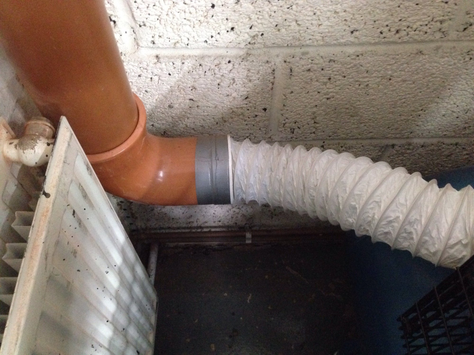

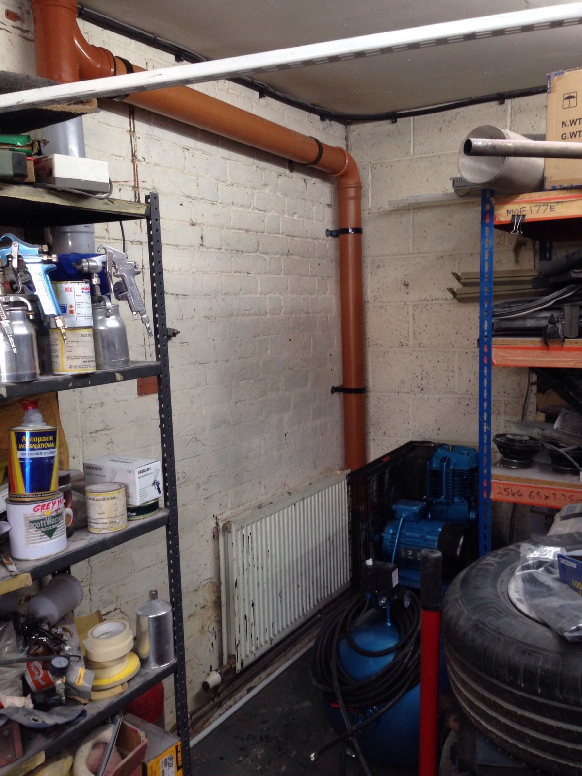

Read it again Parm. The compressor was, but it sealed and was fed by fresh air from a 4" duct from the roof. The flexible coupling to that duct had become perforated.
What exactly was the mistake?Why did you post the above ????
Ok that makes sense...I was not sure if you meant using rubber hose air IntakeYep definitely mistake placing the intake of the compressor in the same environment that the airborne hazard is being created
its only air bourne particles you have to worry about, its a myth regarding isocyanates being absorbed through the eyes and skin, so after a decent time period and all your over spray and mist has cleared its then safe to go back into the spray room
Maybe, but you still have the problem of contact dermatitis, plus the nuisance factor of getting 2K products off your skin before it dries. That means gunwash, so more contact dermatitis risk.
