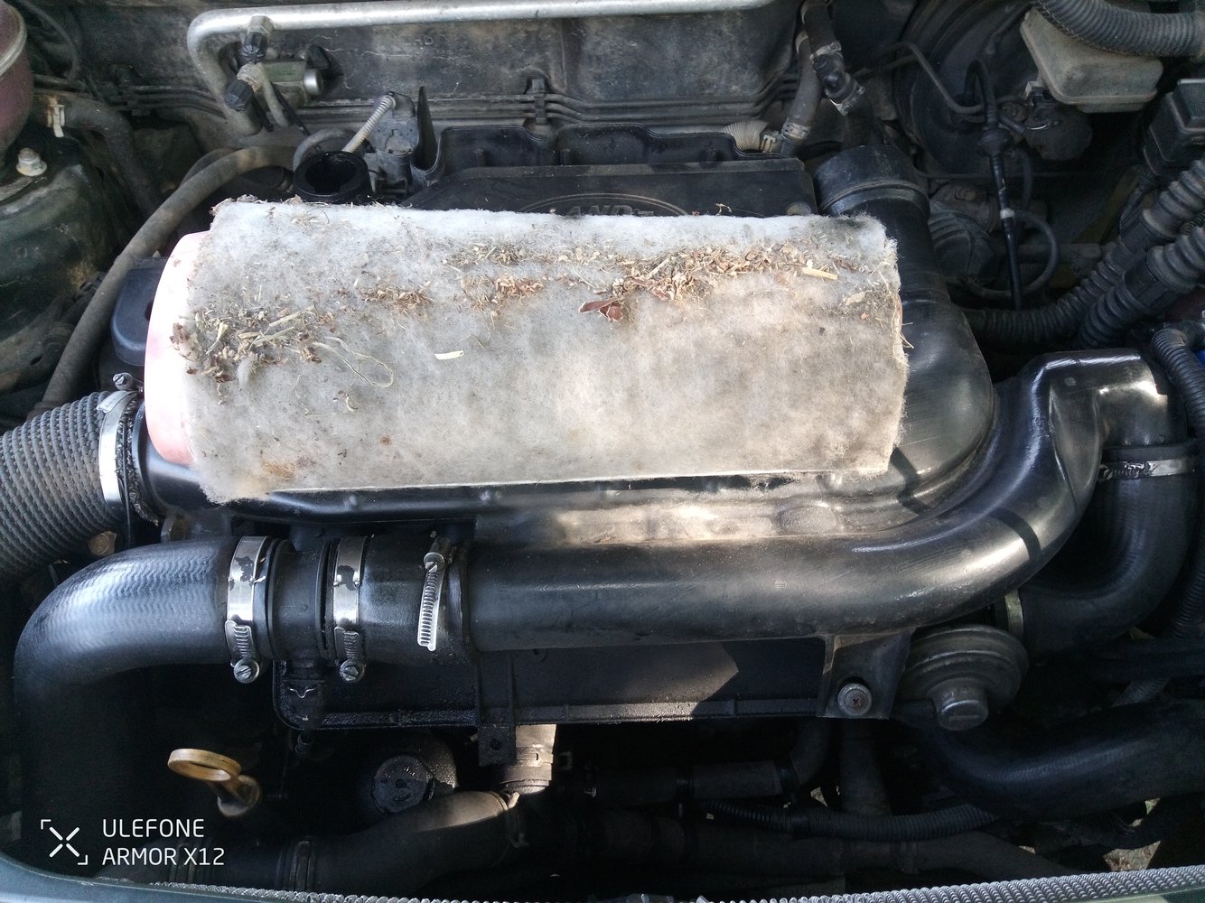

.......Opened bonnet, closed bonnet, googled air filter location, because I couldn't find it.

Blow it off with an air line, that'll be alright!
I tapped / rubbed it off, sounds dodgy, loads of crap came out.Blow it off with an air line, that'll be alright!![]()
Are we still on air filters or the under bonnet helpers?I tapped / rubbed it off, sounds dodgy, loads of crap came out.

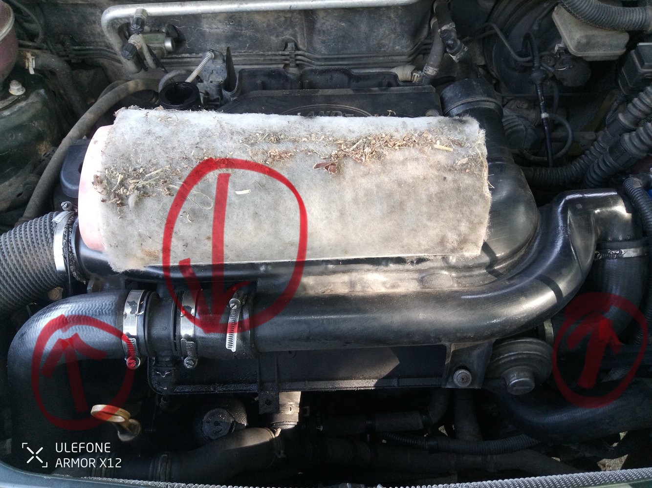

Three arrows:Where should I be looking for split pipes, I've a new wide bore angled rubber hose in the boot, probably intended to go somewhere ?
Maybe not this evening.Get the ginger with glasses to rev it up to about 2000 rpm and feel around all the hoses and see if you can feel any air blowing out.
Unlikely, but the intercooler might be punctured, OR might be half full of oil, which would not surprise me.
Can only see 2 arrows ?Three arrows:
Yep. I once had a Rover 200 with the Pug XUD engine and the intake pipework looked a bit oily. I took the intercooler out, tipped it up and a fair bit of black sludge came out.Get the ginger with glasses to rev it up to about 2000 rpm and feel around all the hoses and see if you can feel any air blowing out.
