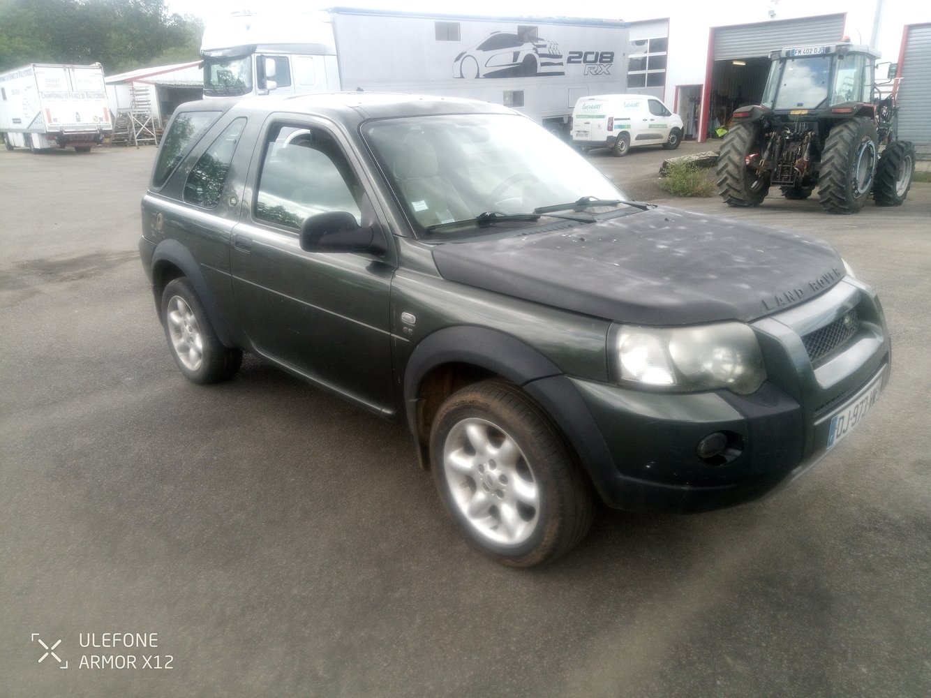

Ah, facelift model, nice...Photos, I'll caption them in a couple of minutes.

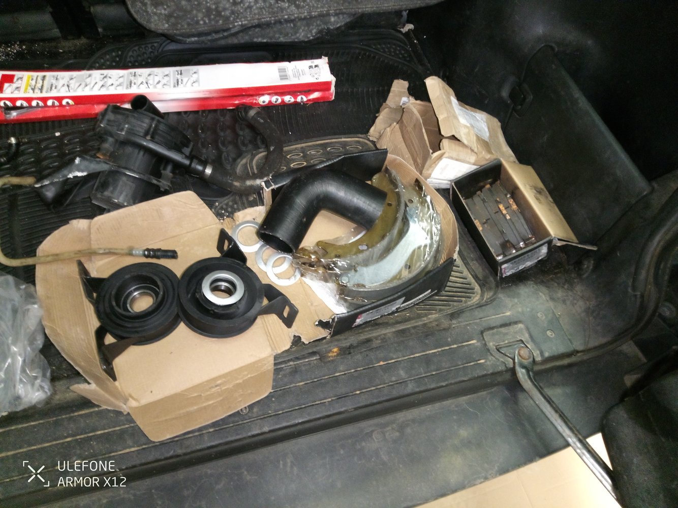

Complete replacement new brakes, no disks, and some rubber pipe.
The one litre of brown filth which came out.

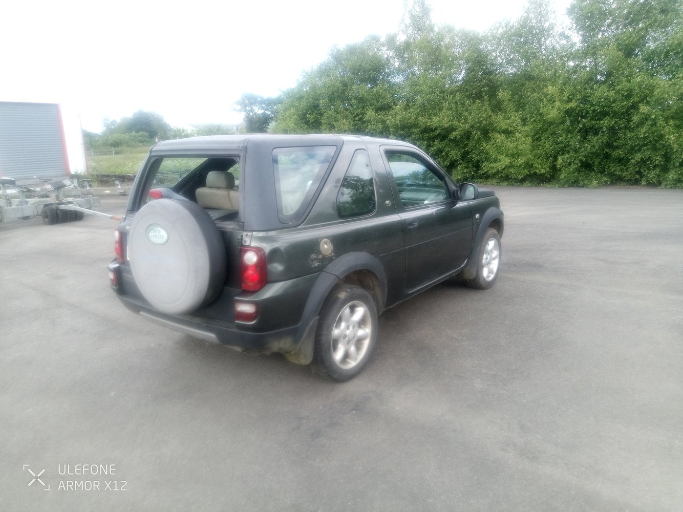

View attachment 451488View attachment 451489View attachment 451490View attachment 451491Rear window fully functional, all windows good, all lights good, headlights need polishing. A.C. needs recharging, as that's not working, on start, all warning lights come on, and go off, pro body work shop bloke next door will respray bonnet for mates rates....
No, I don't quite happy with a 2 litre diesel, assume it's got a turbo, no idea.Ah, facelift model, nice...
Now you just need a v6 and a turbo, Rover 75 gearbox and an lpg kit.
Hours of funAh, facelift model, nice...
Hours of fun

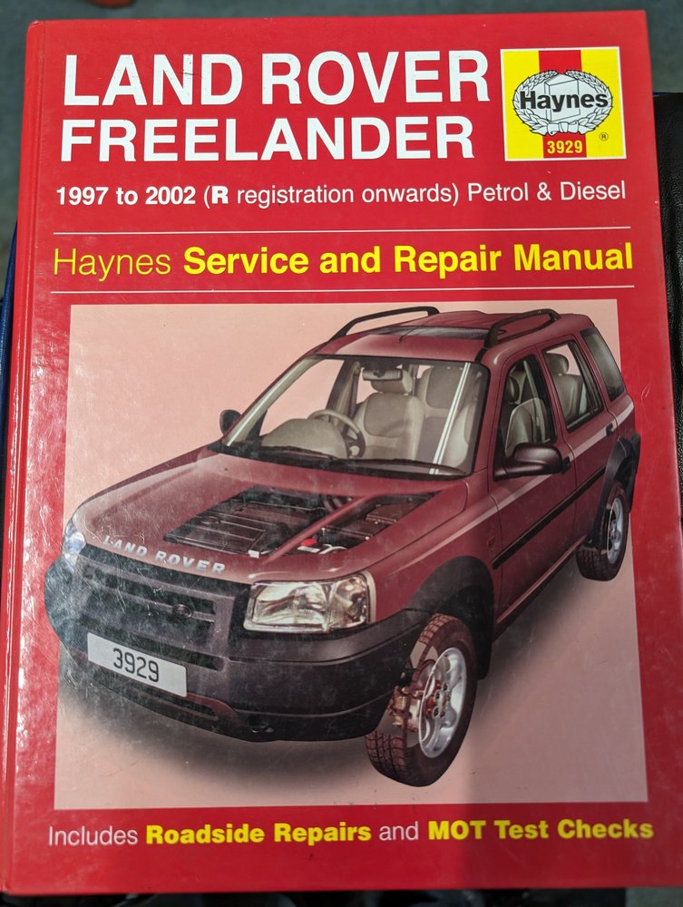

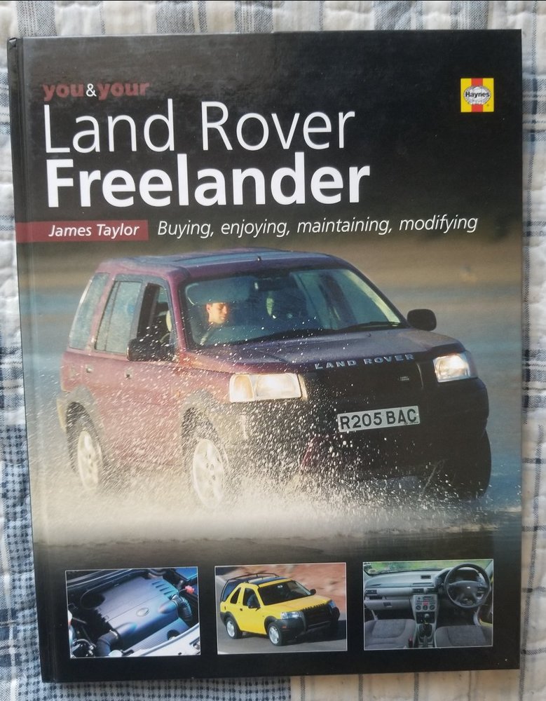

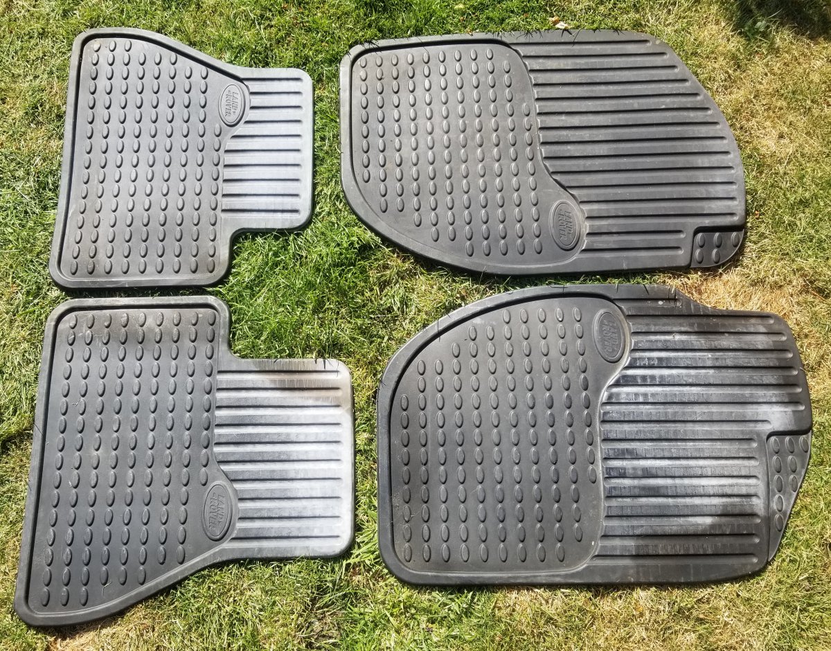

Yep, yes please, my brother's in Bristol and regularly gets over here, I'll pm you his address, happy to pay postage, many thanks.I've got a book and some genuine mats you're welcome to if there's any way to get them over the water to you without costing silly money/export aggro.

Yes please, I'll pm you my brother's address in Bristol, he's back and forth, happy to pay postage.Is this of any use? Though for earlier version, covers TD4 and think mechanicals largely unchanged. You are welcome to it.

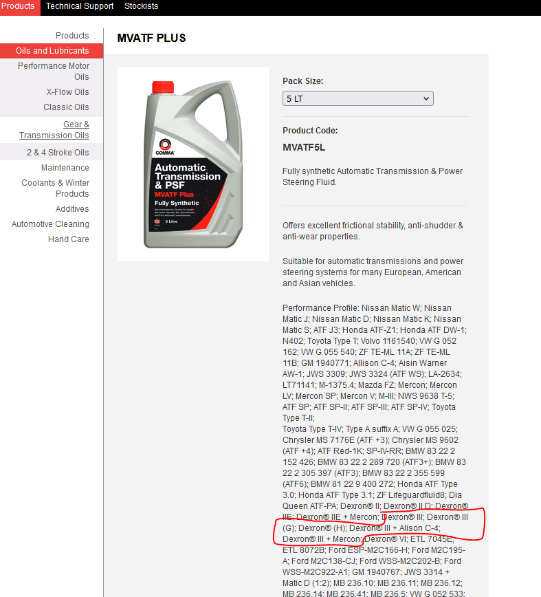

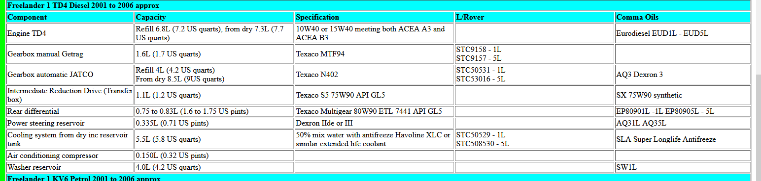

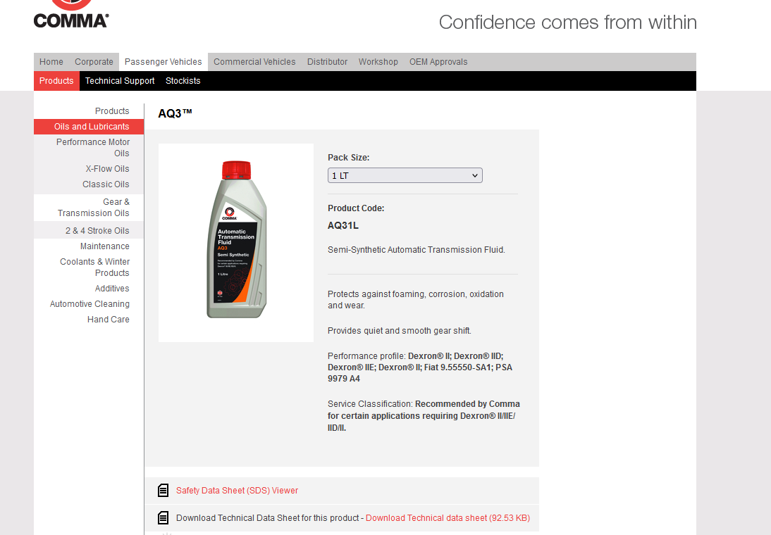

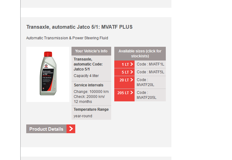

So Dexron 3 it is then ?@Barking Mat
Look at this https://www.dingocroft.co.uk/acatalog/Rec_lubes_FRLNDR1.htm
Dingocroft know their stuff, never given me any duff service in the over 25 years I've been using them.
That will at least give the box a good clean out. Flush it then put the new stuff in, cross fingers.Yep, sure enough I put dexron 2 in the box, looking at the last container we had, that would have been compatible, so what's in its to rinse, I'll order some stuff. Thanks again.

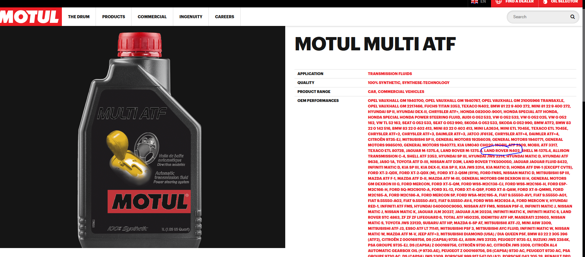

Yep, but no, we have Motul ATF, in 20 litre cans, the last one which is now empty, corresponds, Dexron 3, but the current can we're on is Dexron 2, which doesn't apparently, I'm still scratching my head.You say you use Motul at work
This
https://www.motul.com/se/en/products/multi-atf
is what they recommend for the Frogloader 1 TD4 Auto
