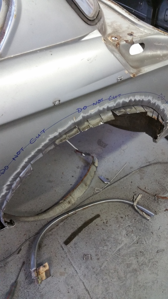

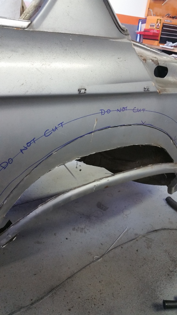

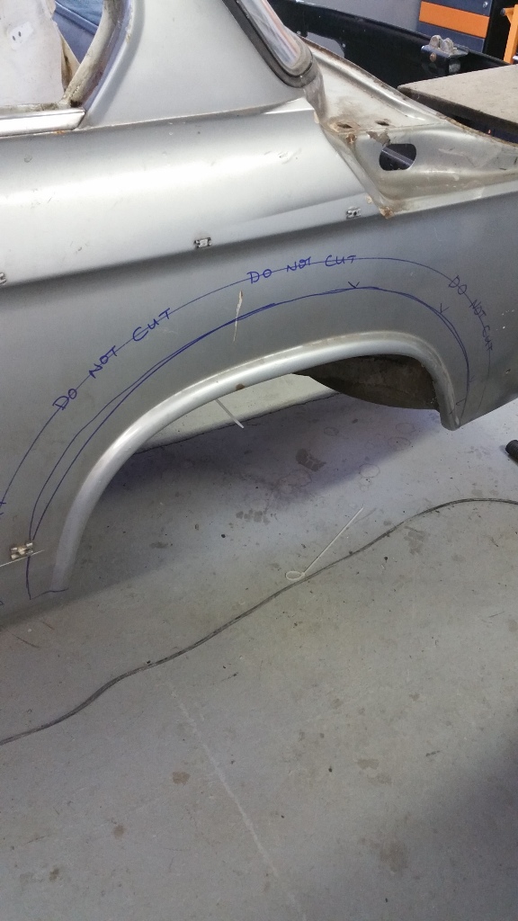

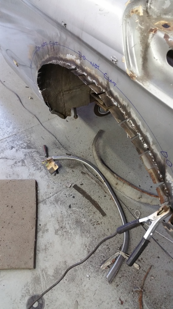

Well....The Tii is still at the bodyshop, so I decided to tackle the rear arches on the silver car. Looks a simple job, to just bolt on the turbo arches over the top, but OH no !!!! That would be way too easy !!!! You need to cutout the old panel and weld the inner arch to the outer. Took a day to do both and still needs to be finished off and rust proofed, but big job out of the way.
