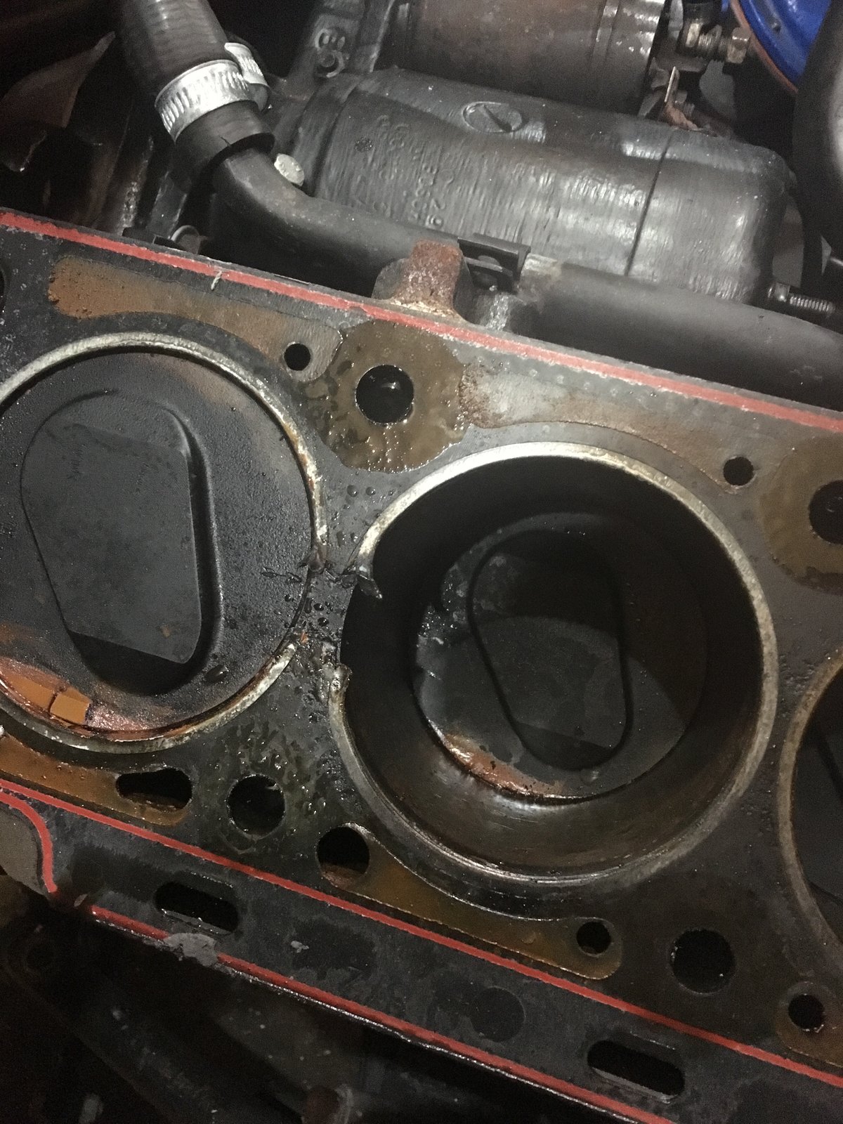

    It's not exactly exciting. But, the mechanical cooling fan is really close to the radiator. One engine mount has a 'stopper', incase of forward movement, which has to be setup with a specific gap (3mm). I had neglected to do this properly when I dropped in the engine.
    So, I was out one day, driving the car like a loon and luckily, I was on my way home, not far from my house when I noticed the temperature was in the red. I managed to find somewhere to stop and the fan had cut through the bottom of the rad, causing a total fluid loss. So, I'm guessing the engine must have moved forward under braking ? I replaced the rad, with a spare I had, but I suspect the damage was done, the thermostat must have also been damaged, because the car then kept overheating.
    So, I bought a new thermostat, but the car was still getting hot when it was being pushed, until eventually, it gave up about 1 mile from home. I then managed to limp it home and did a compression test, with no compression on 3 and 4. I am only guessing it's the HG, I have been advised that, given the circumstances, it's the most likely scenario.

    Bit of an update on this. It WAS the HG and it was fixed. The head needed a skim, but it is back on the road. However, I have a low oil pressure problem, that I am now chasing. I just hope that's nothing too dramatic. The car runs fine, but the oil light keeps coming on at idle, once it warms up. Could be as simple as changing the oil for thicker stuff, or worst case, wrong size bearings. We'll see.
    Anyway. Here's a pic of the blown gasket !!!

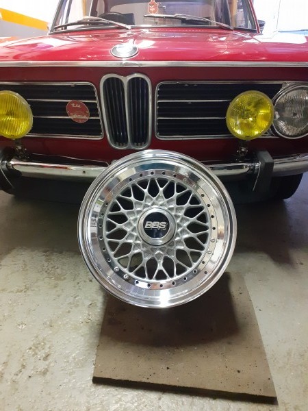

    On a more positive note, I have decided to fit some BBS RS 3 piece wheels, which I am rebuilding at considerable cost !!! Can't wait to get them on the car.

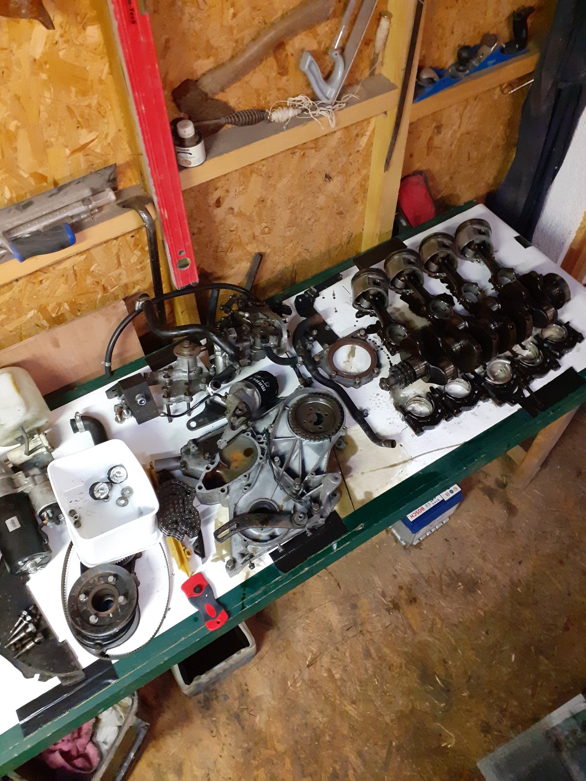

    Hi Slim_boy. Apologies. I've not disappeared. Still here. Had another issue with the car. I managed to blow a piston !!! I guess it wasn't setup correctly after the HG was done. Bummer. But it's currently back in pieces and having another engine rebuild. I might find time to finally get the engine bay paint matched up too.
