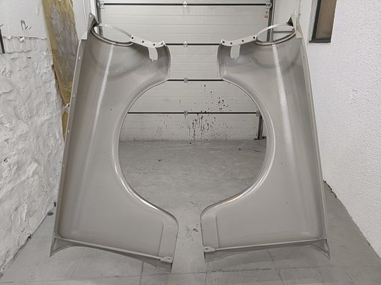

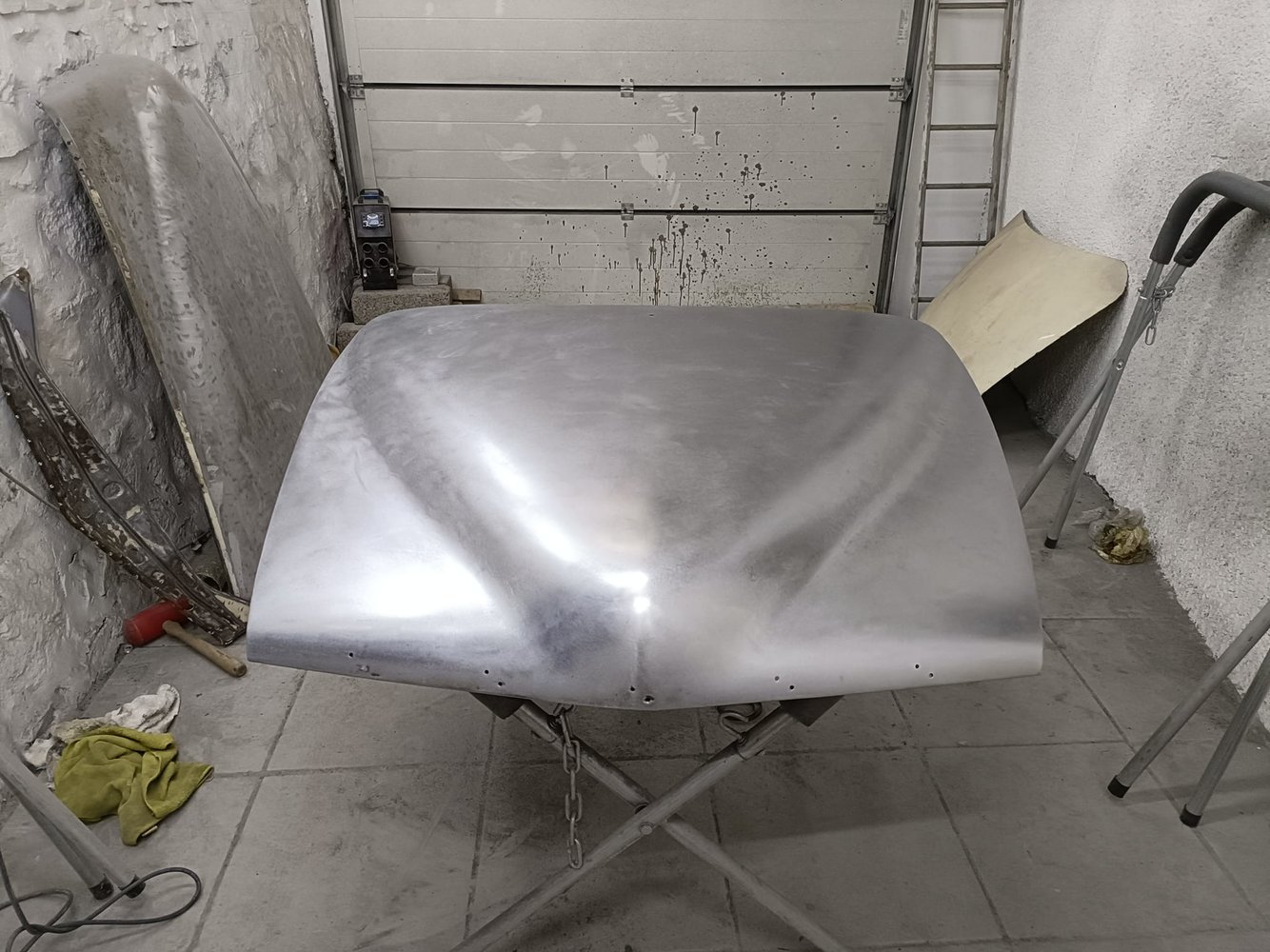

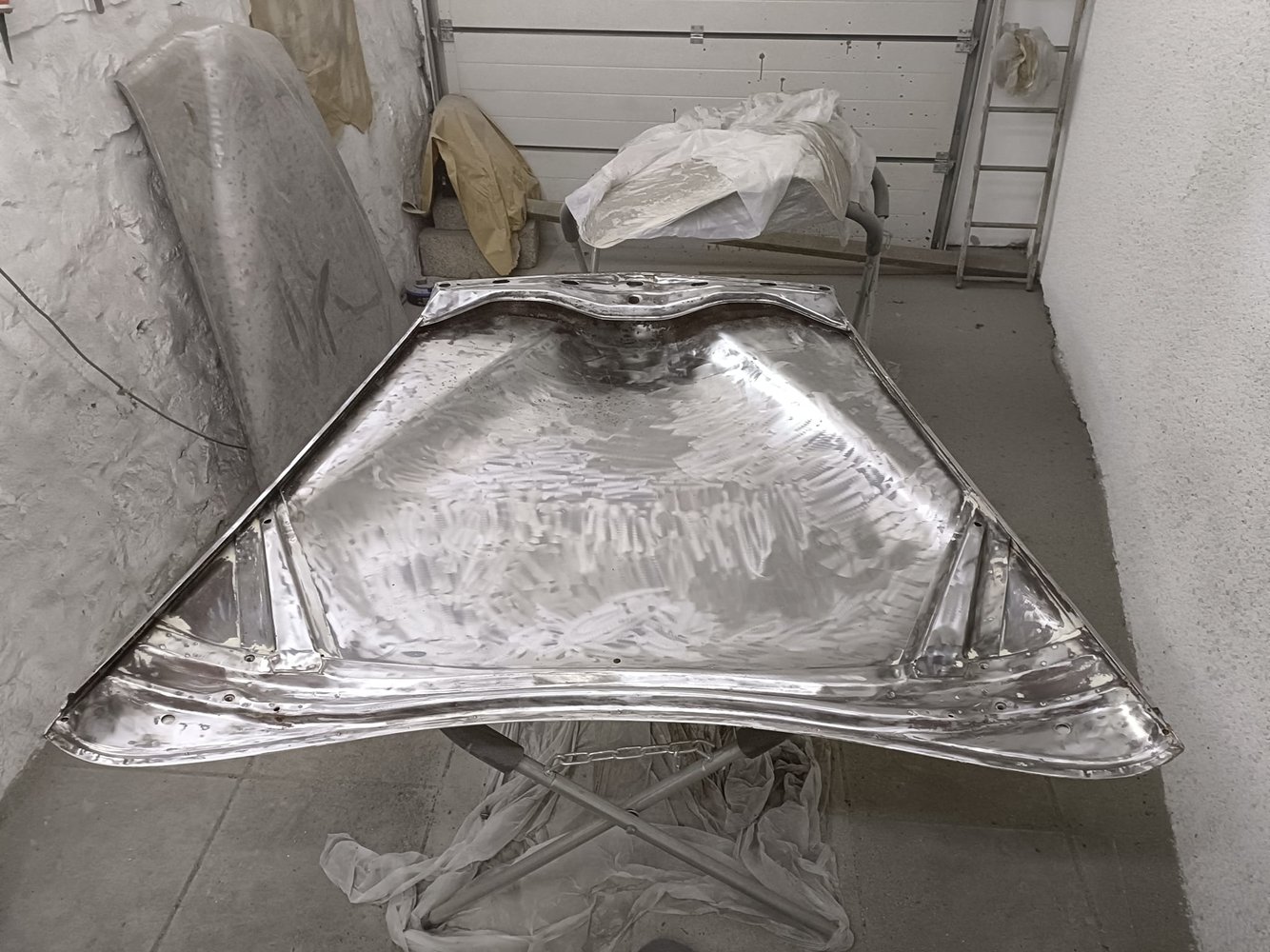

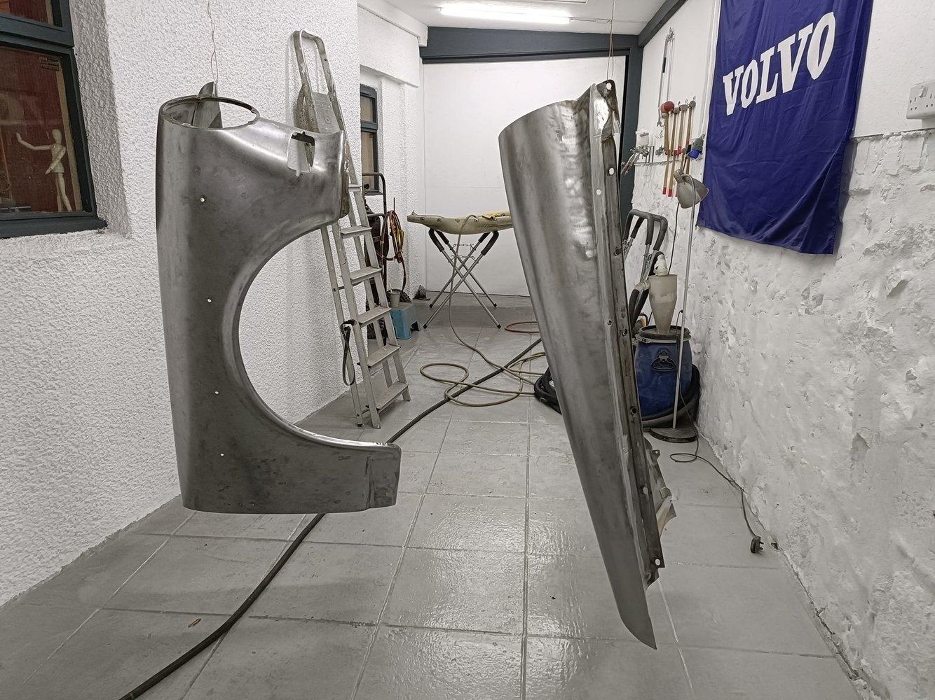

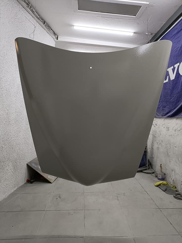

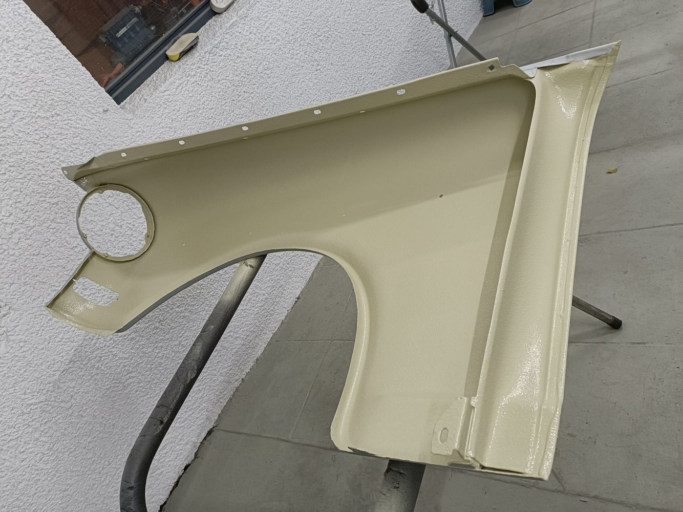

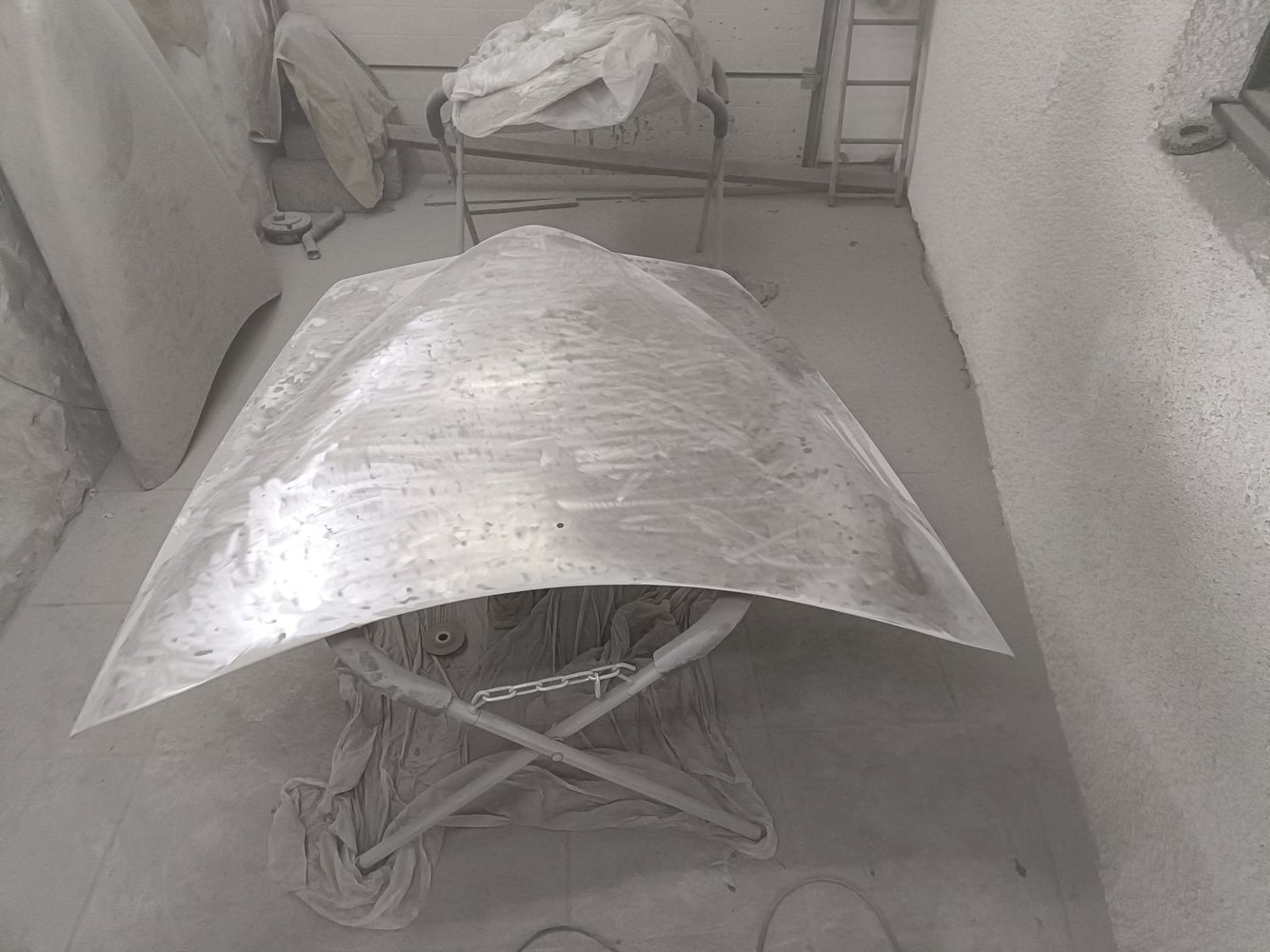

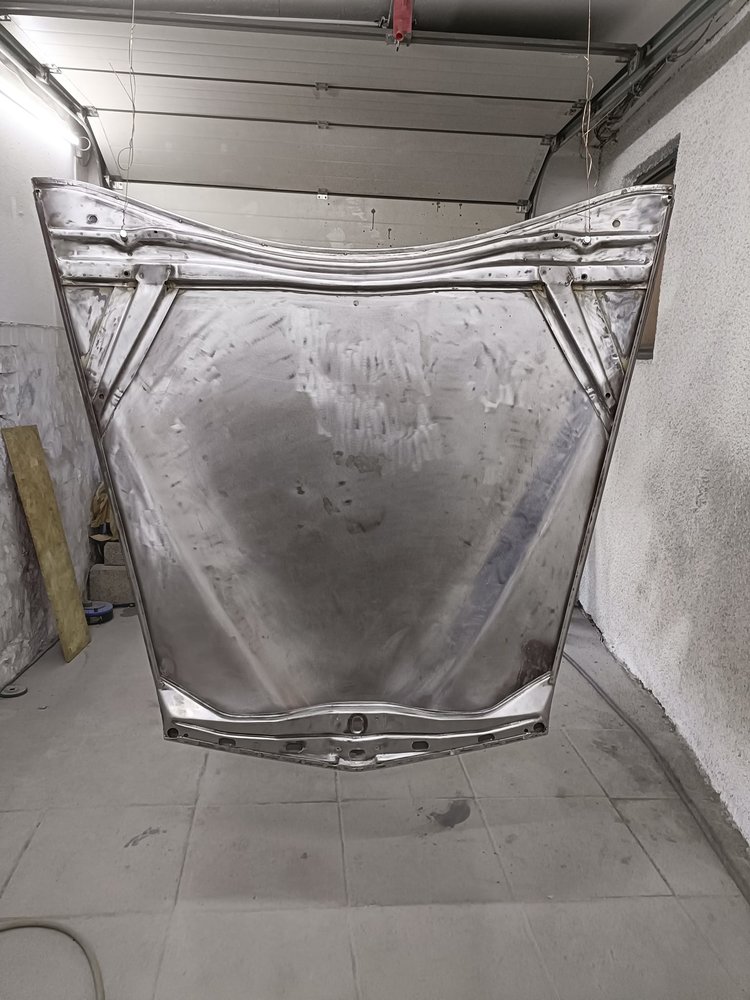

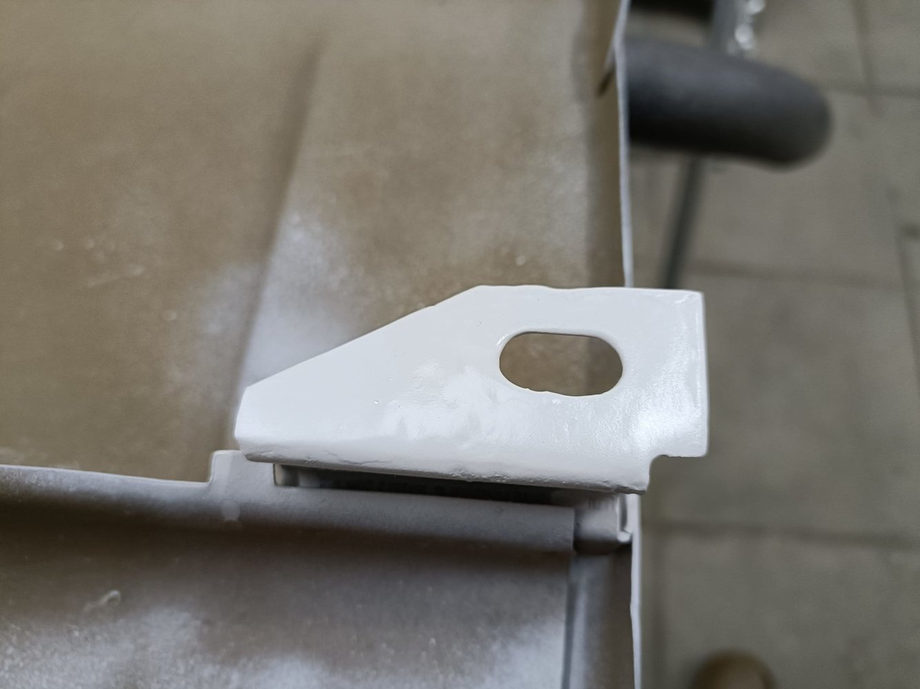

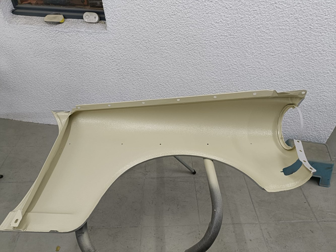

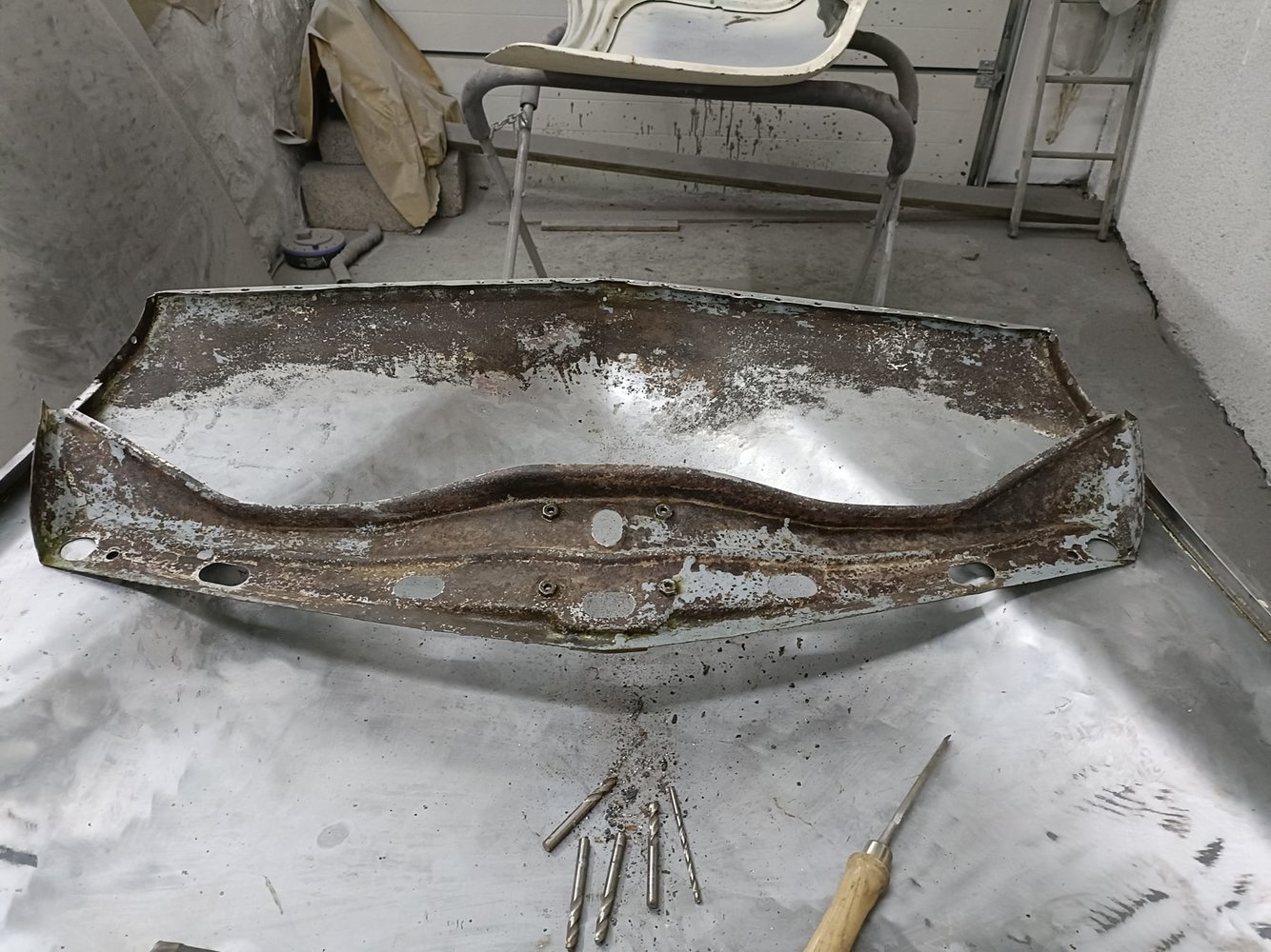

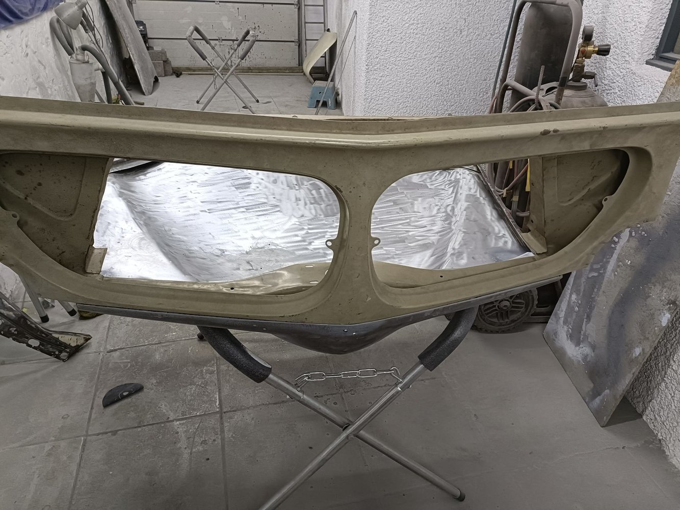

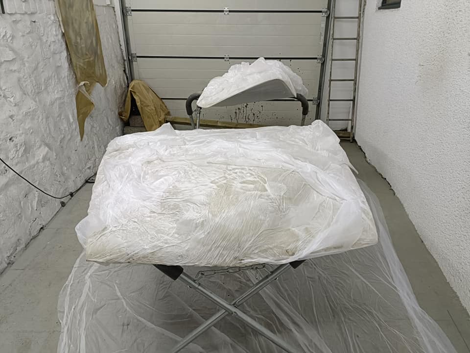

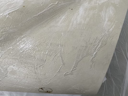

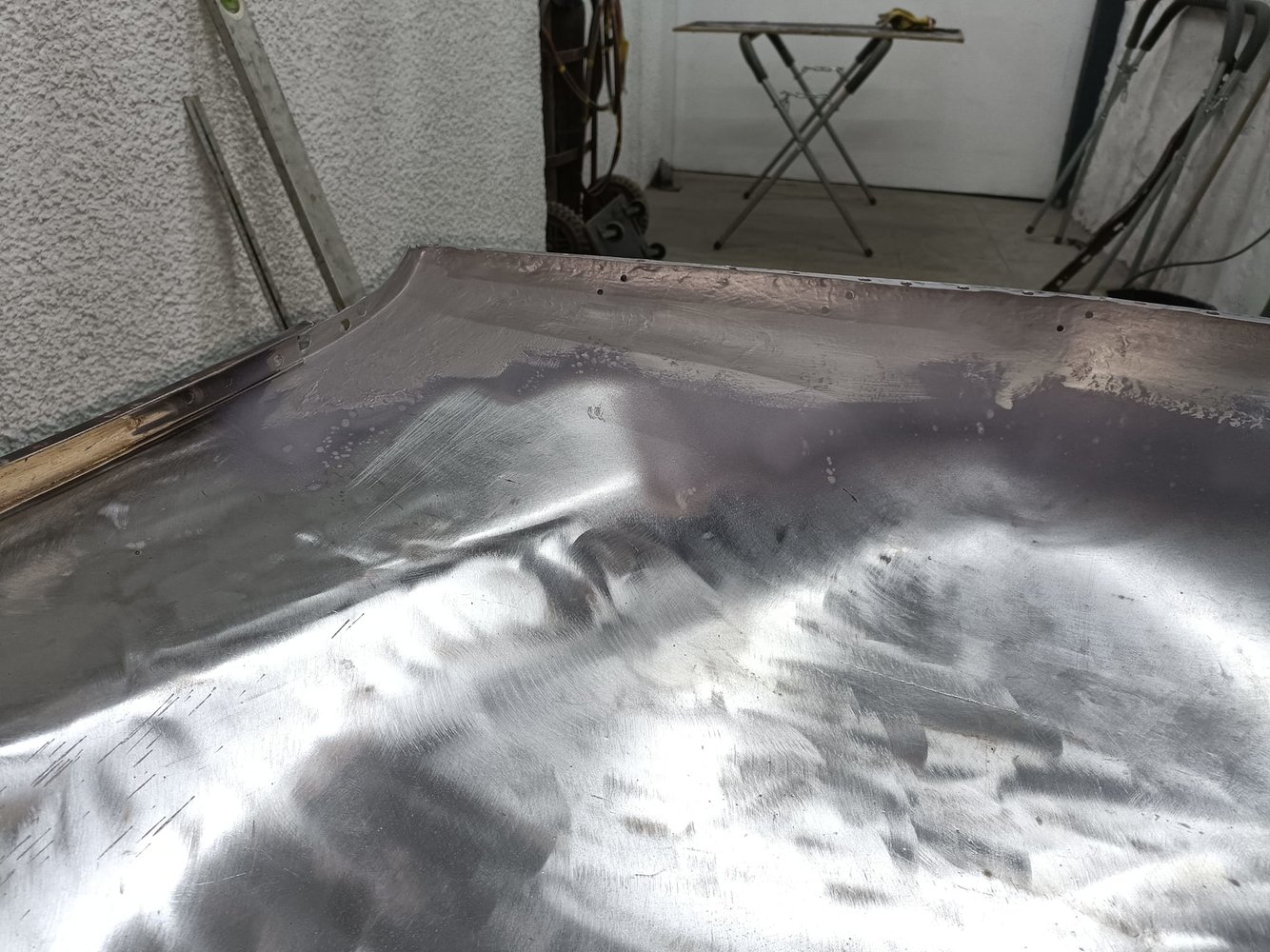

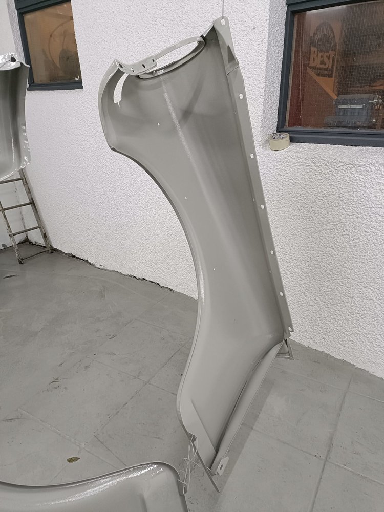

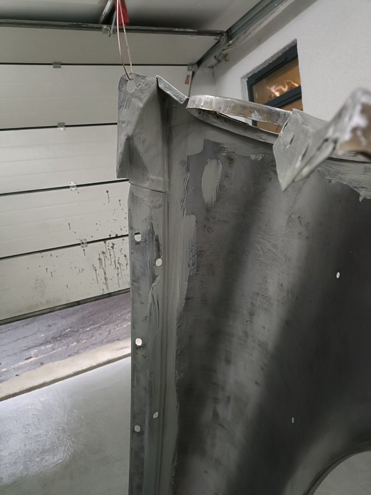

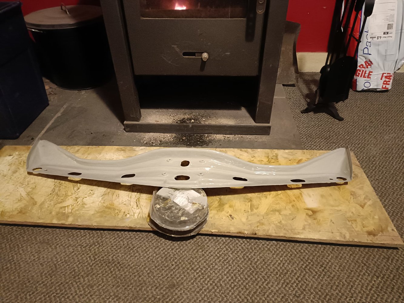

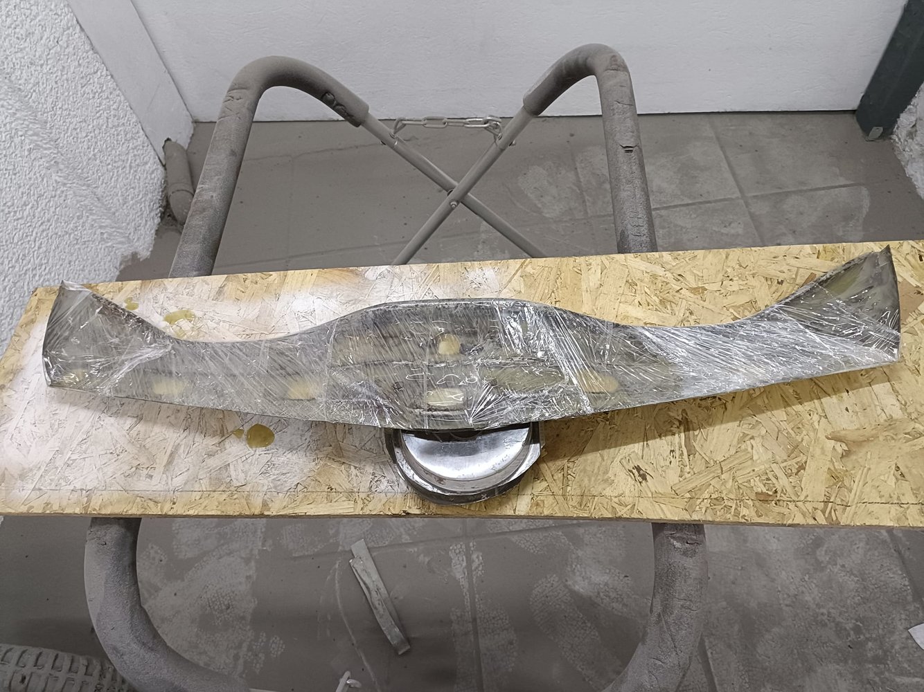

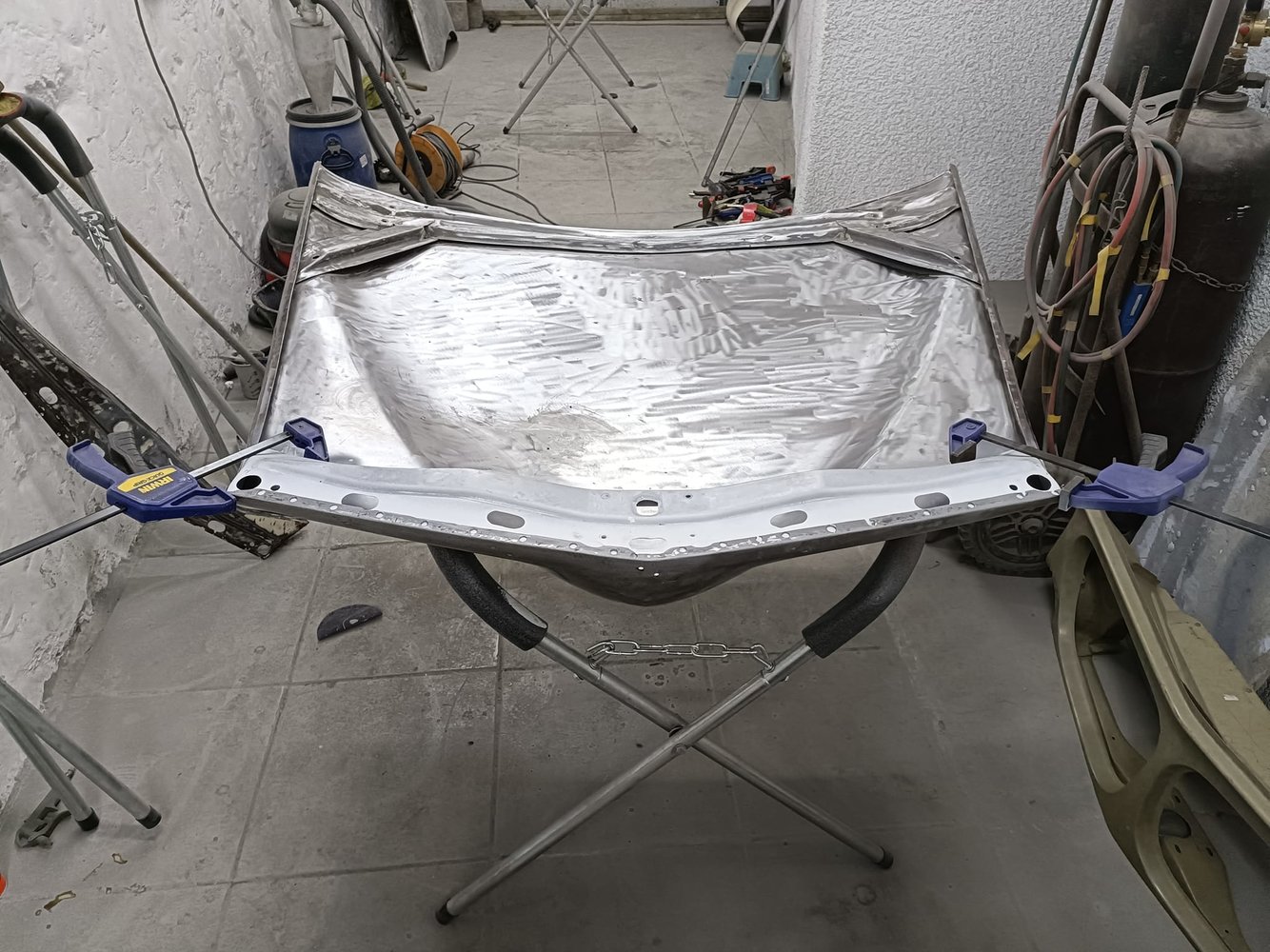

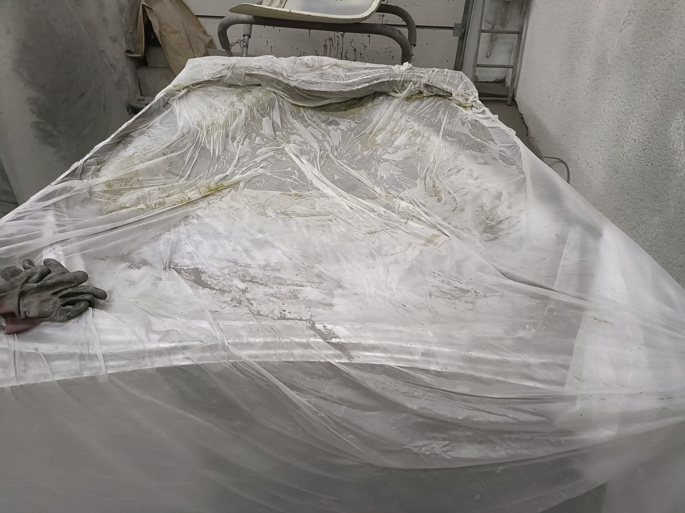

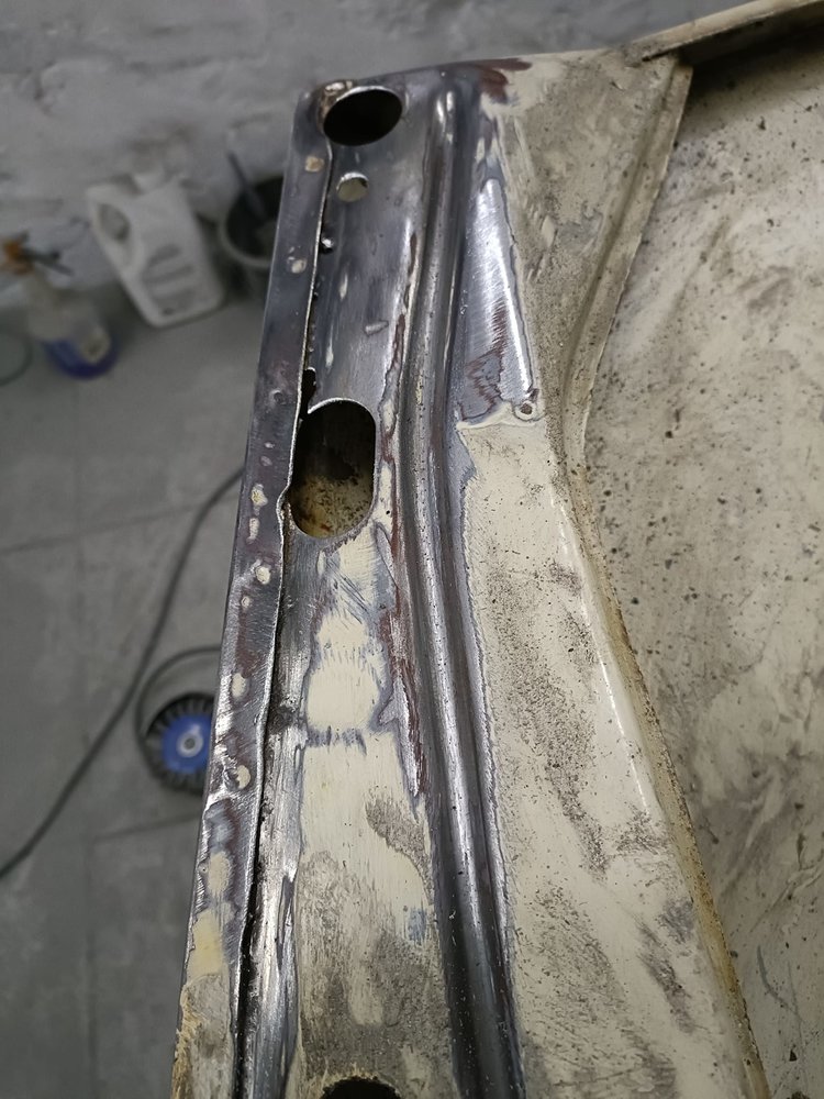

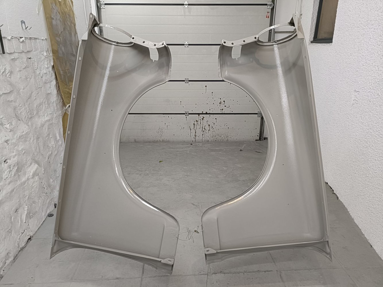

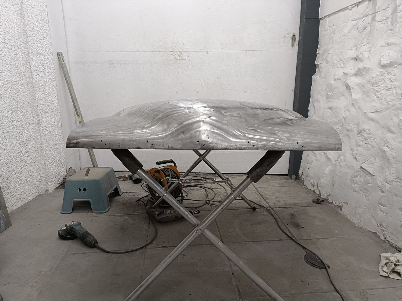

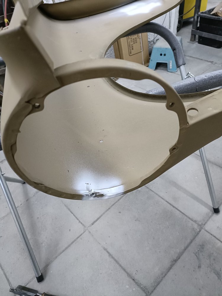

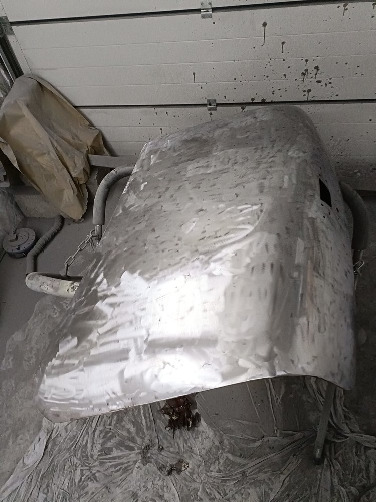

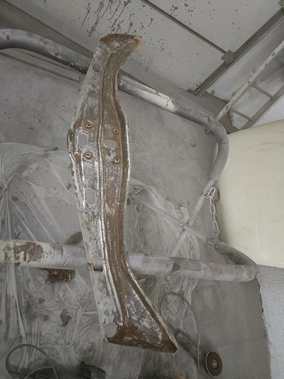

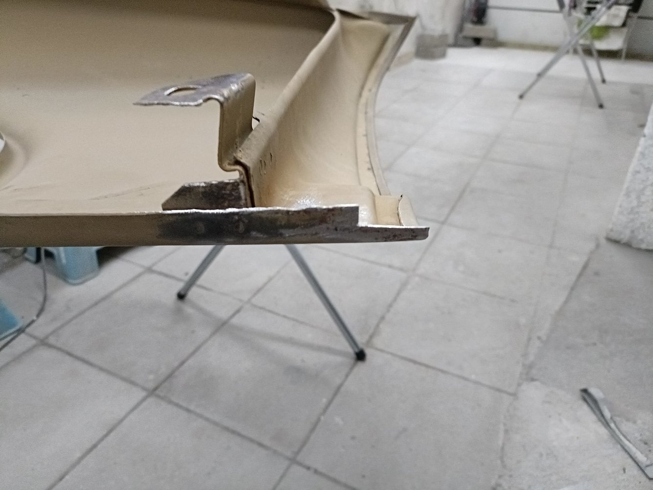

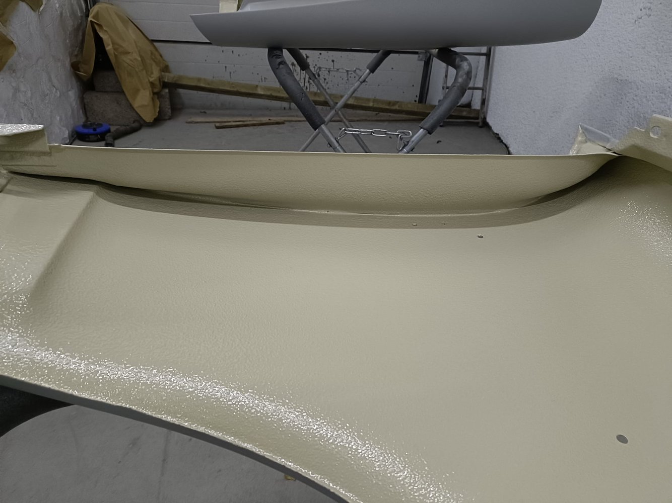

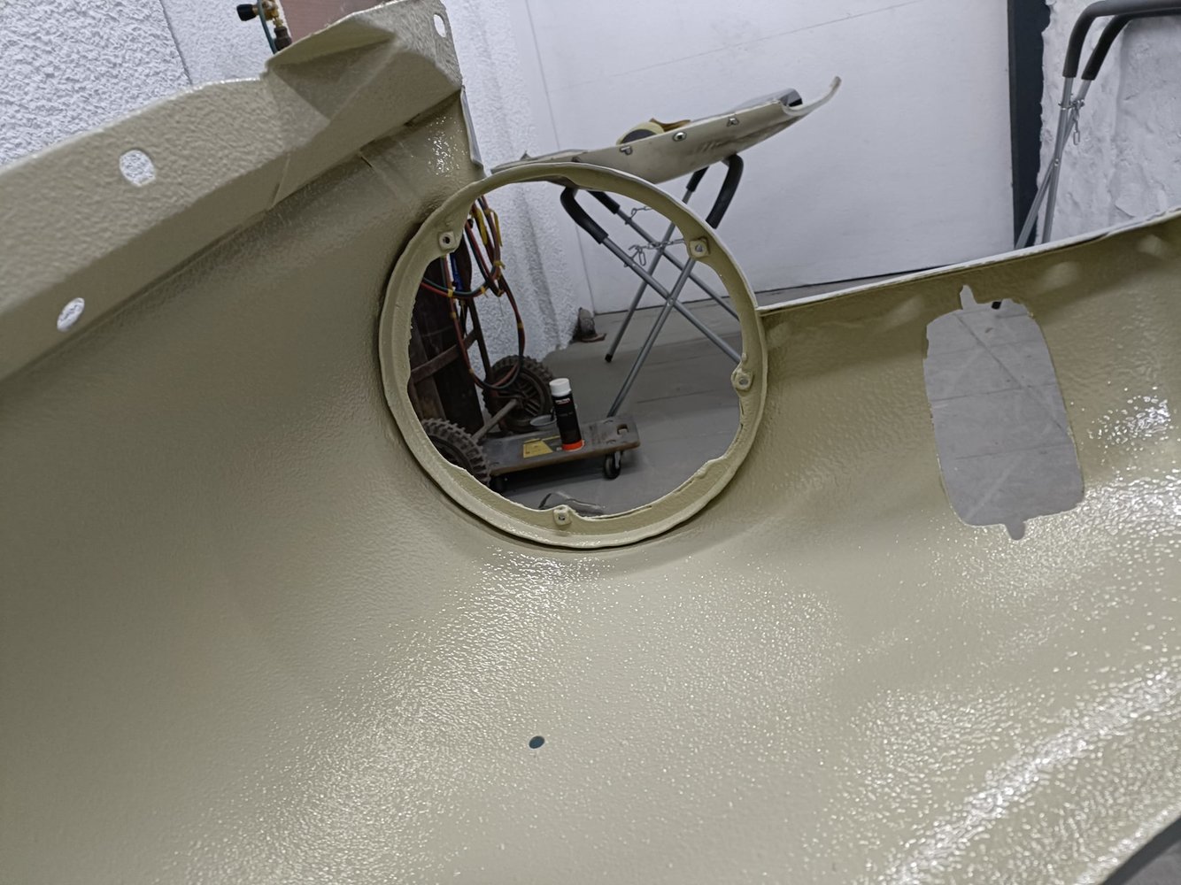

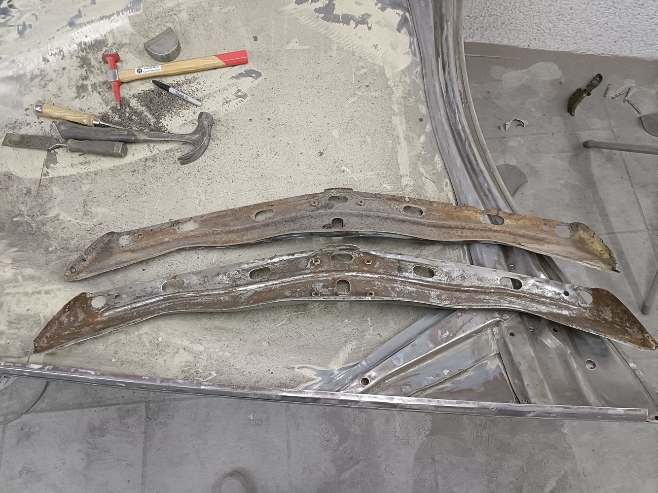

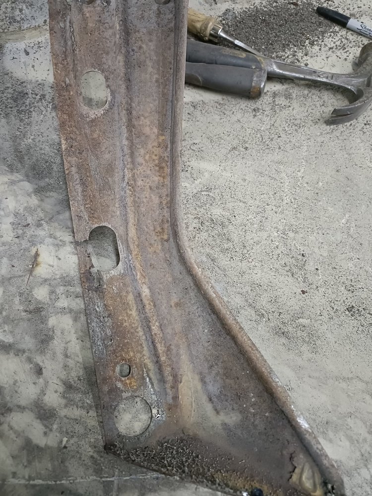

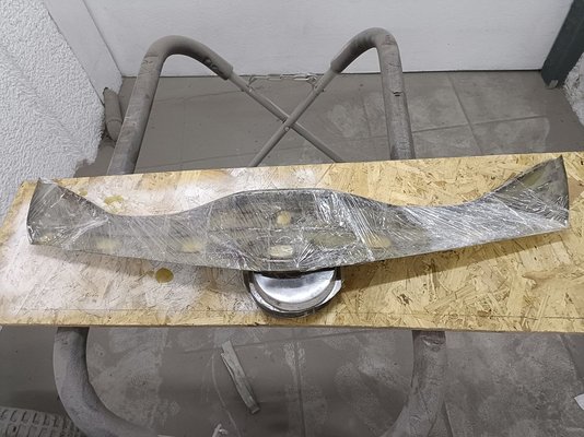

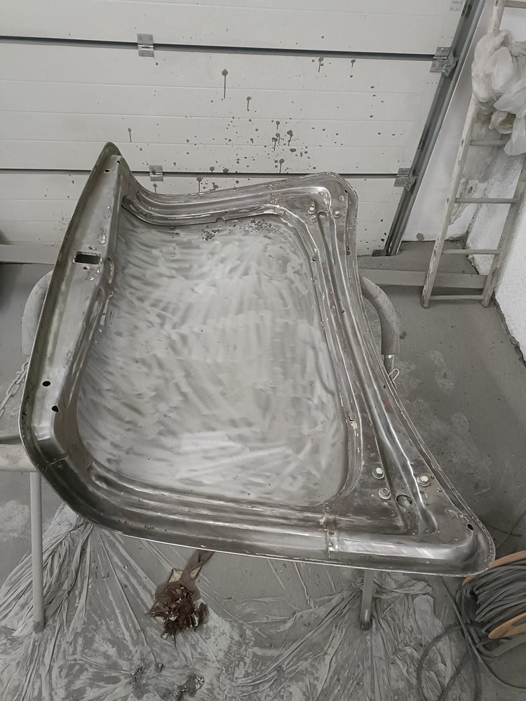

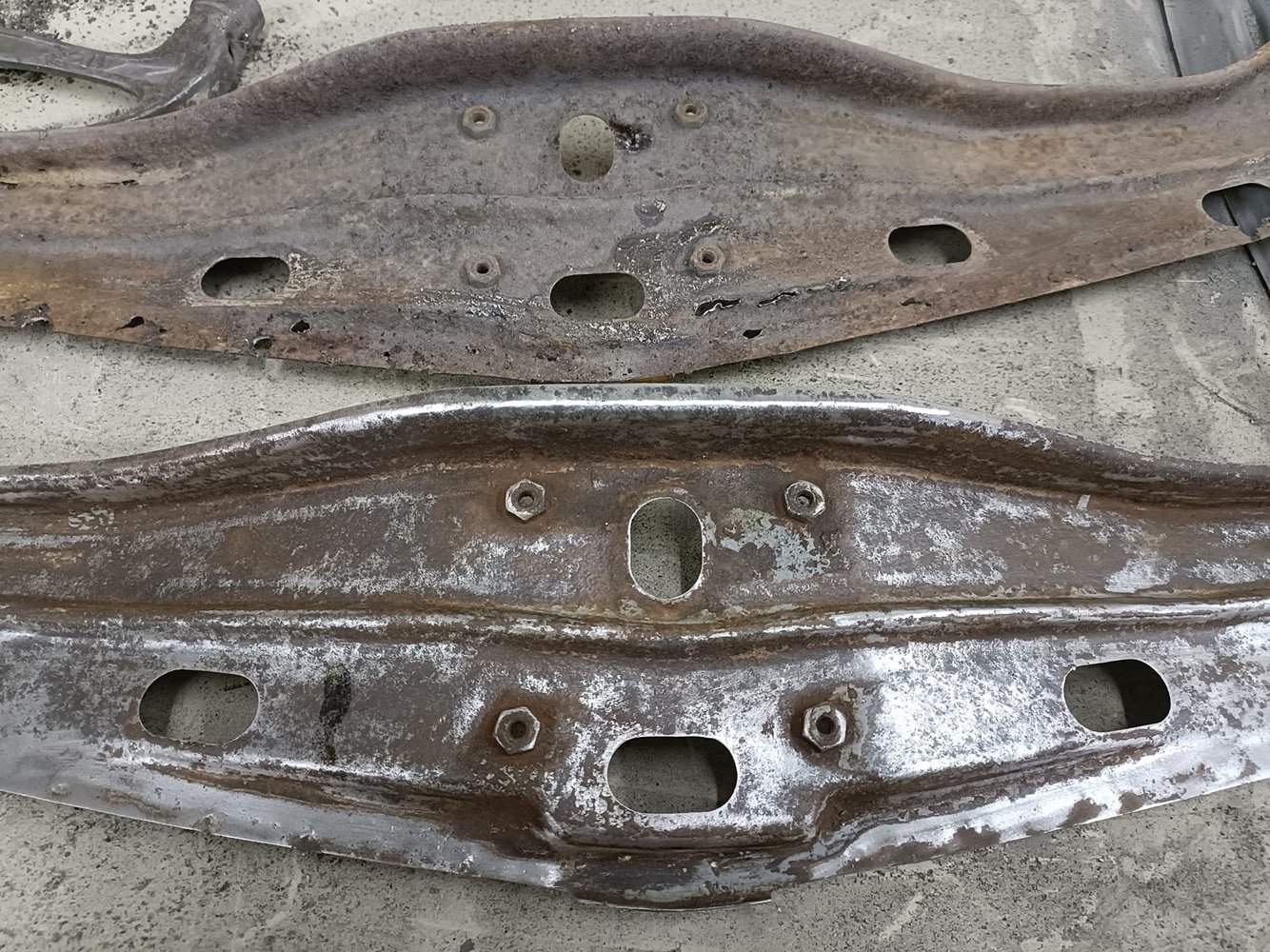

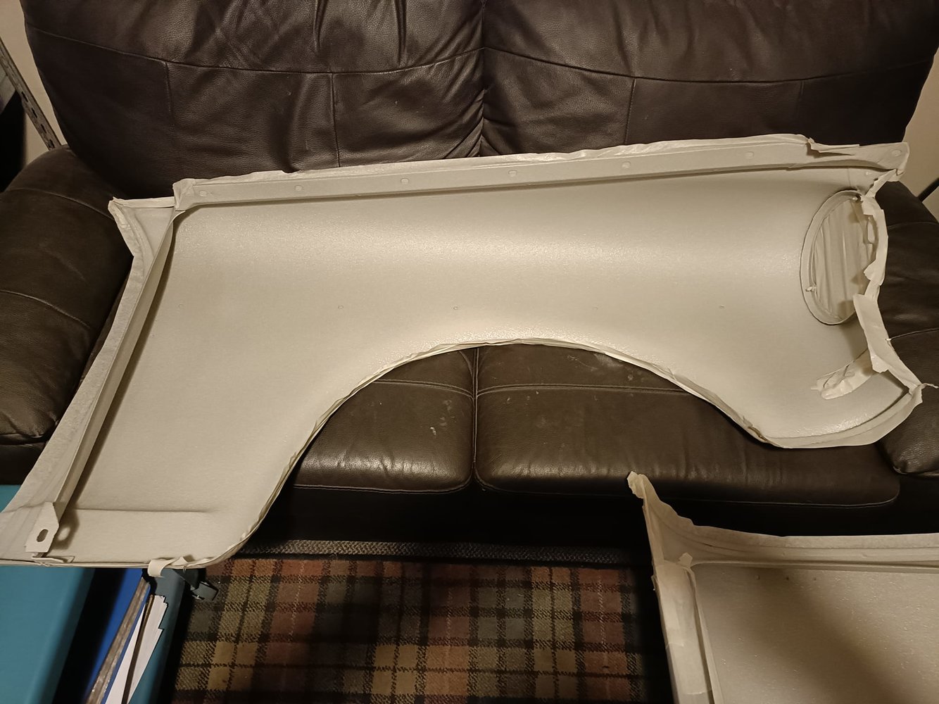

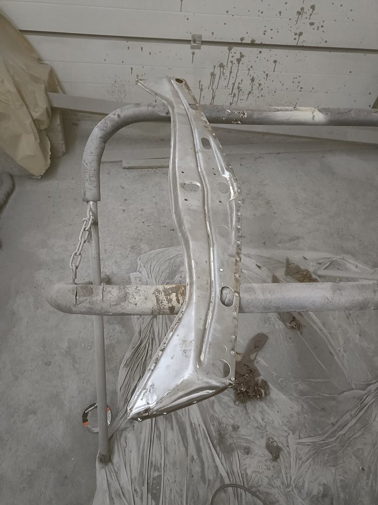

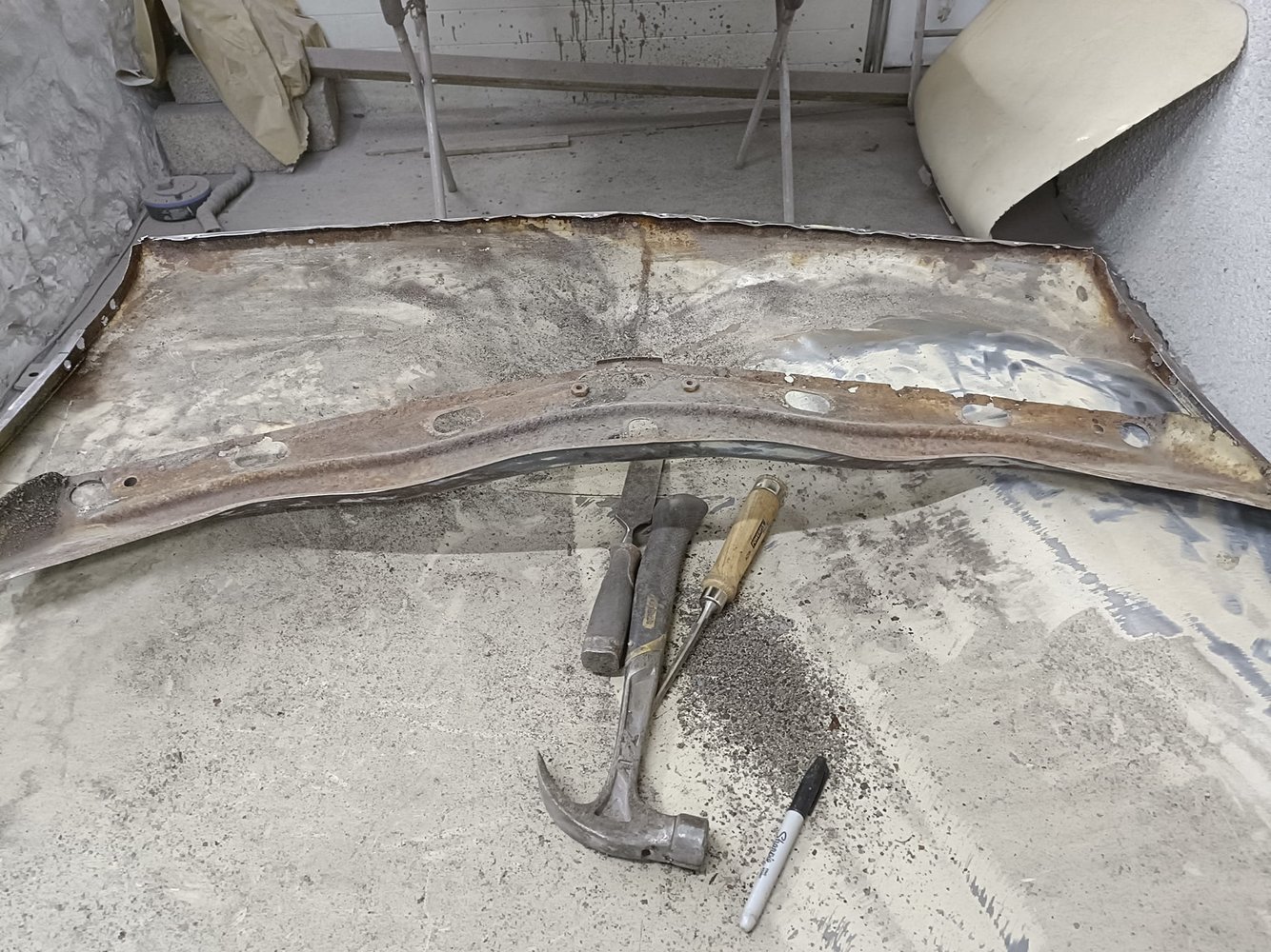

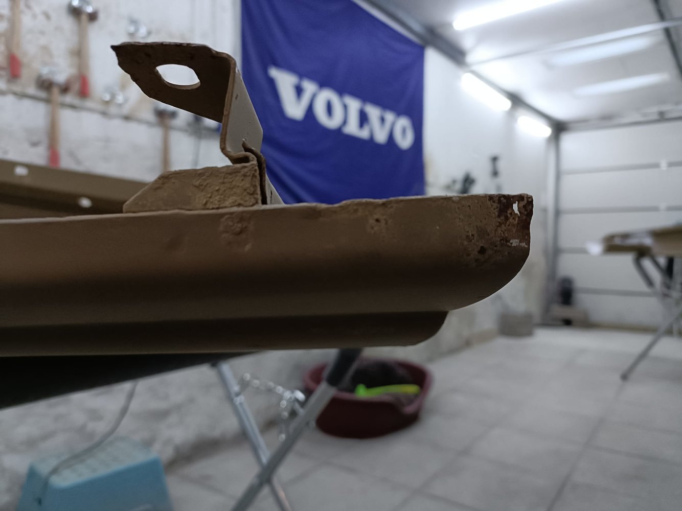

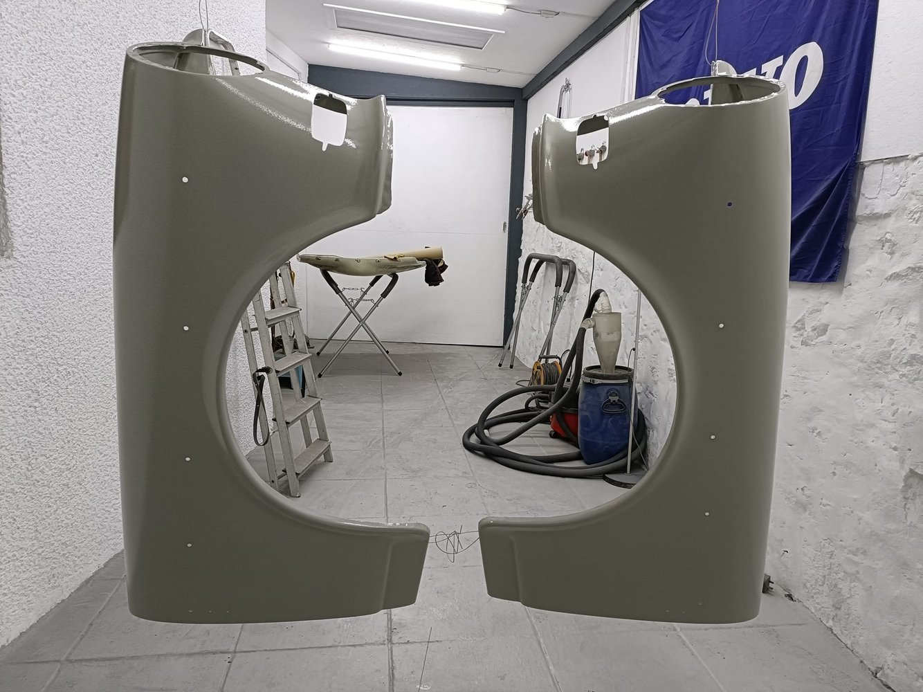

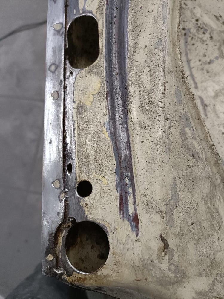

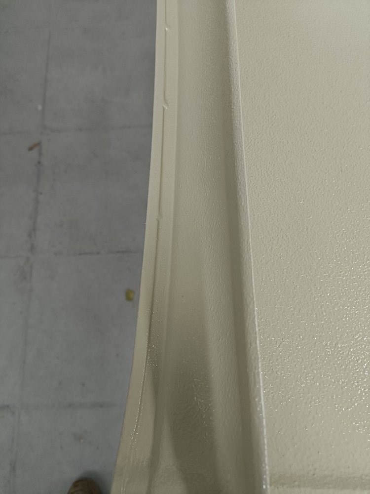

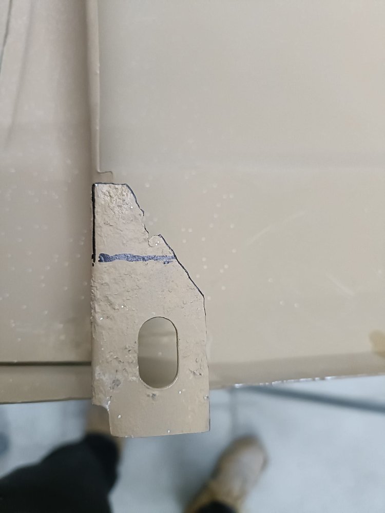

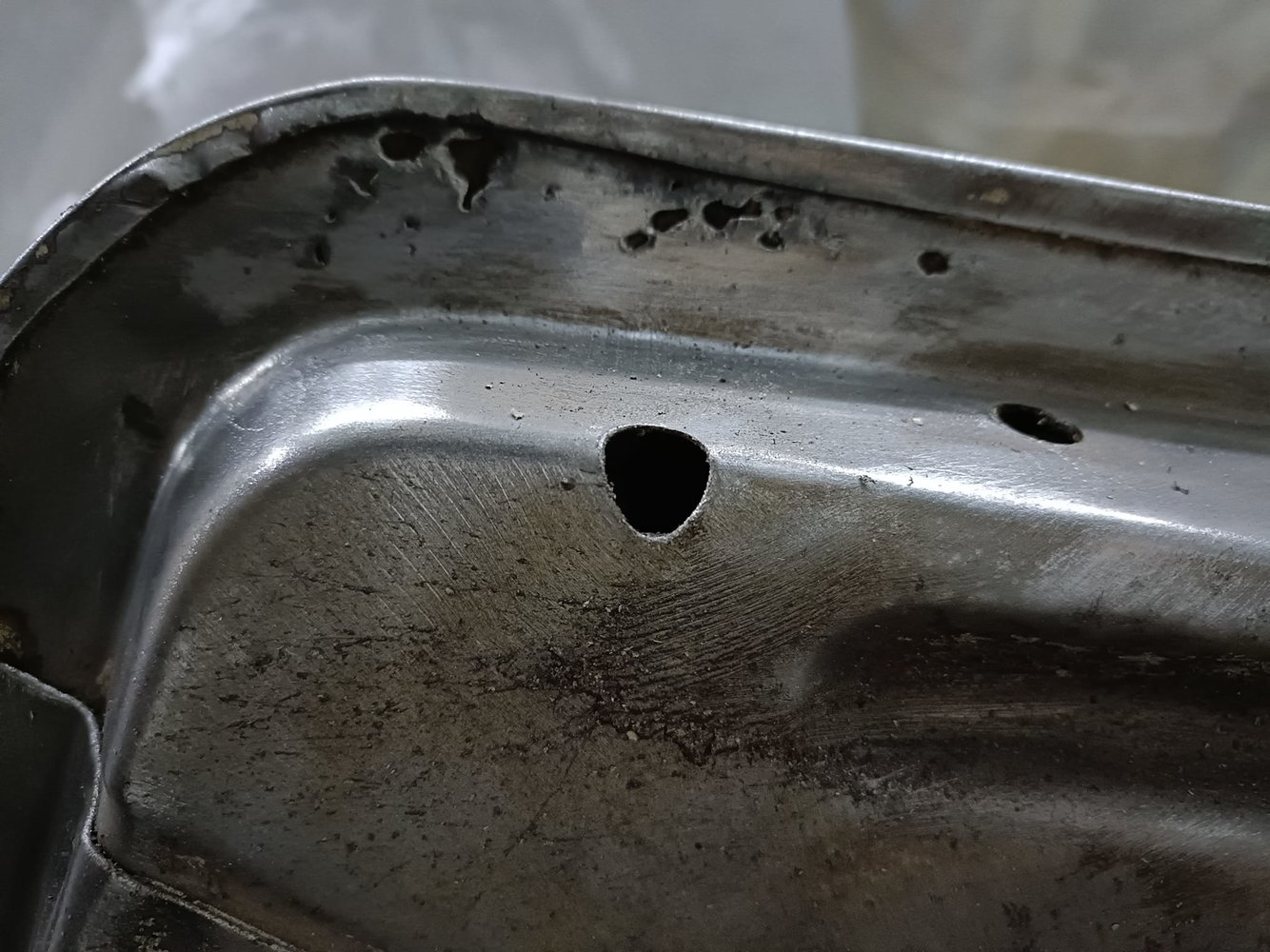

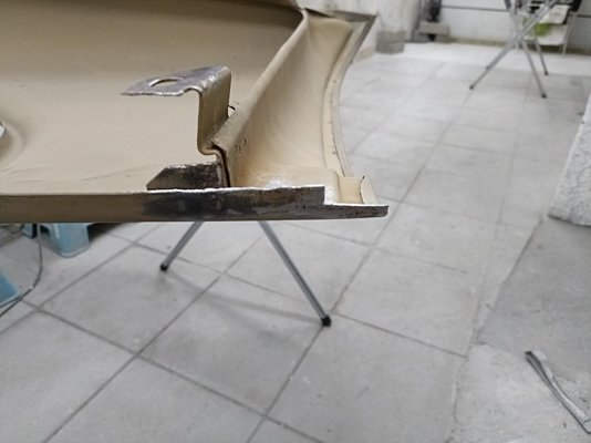

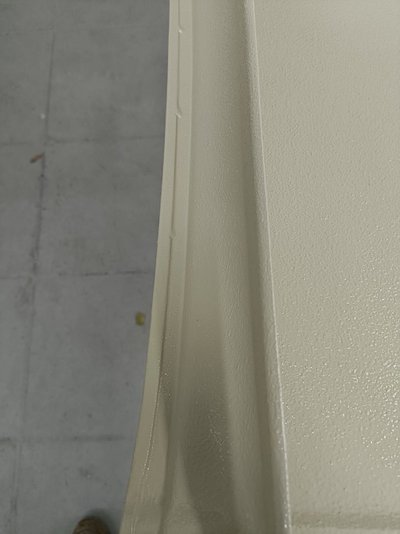

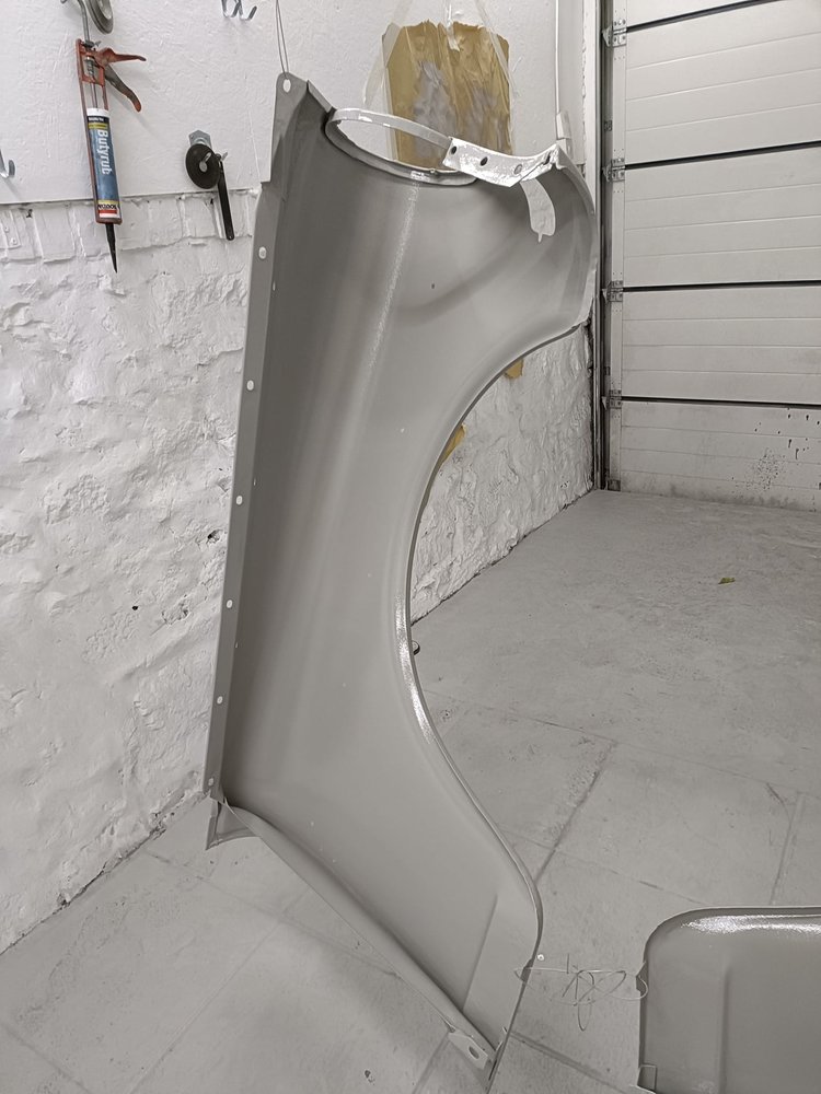

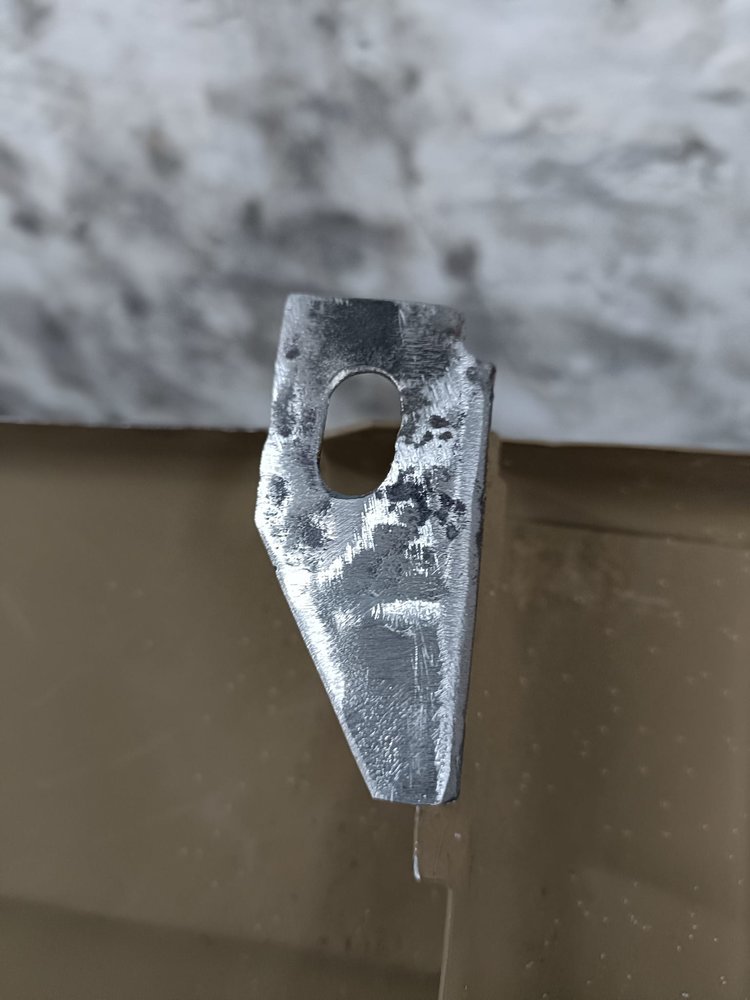

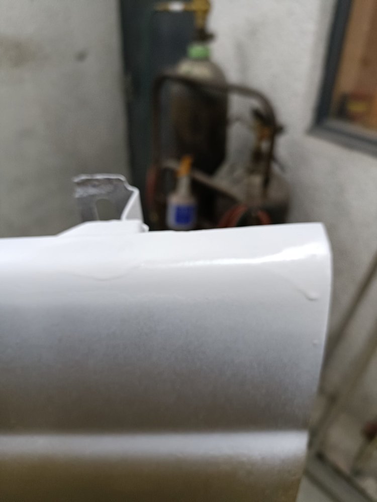

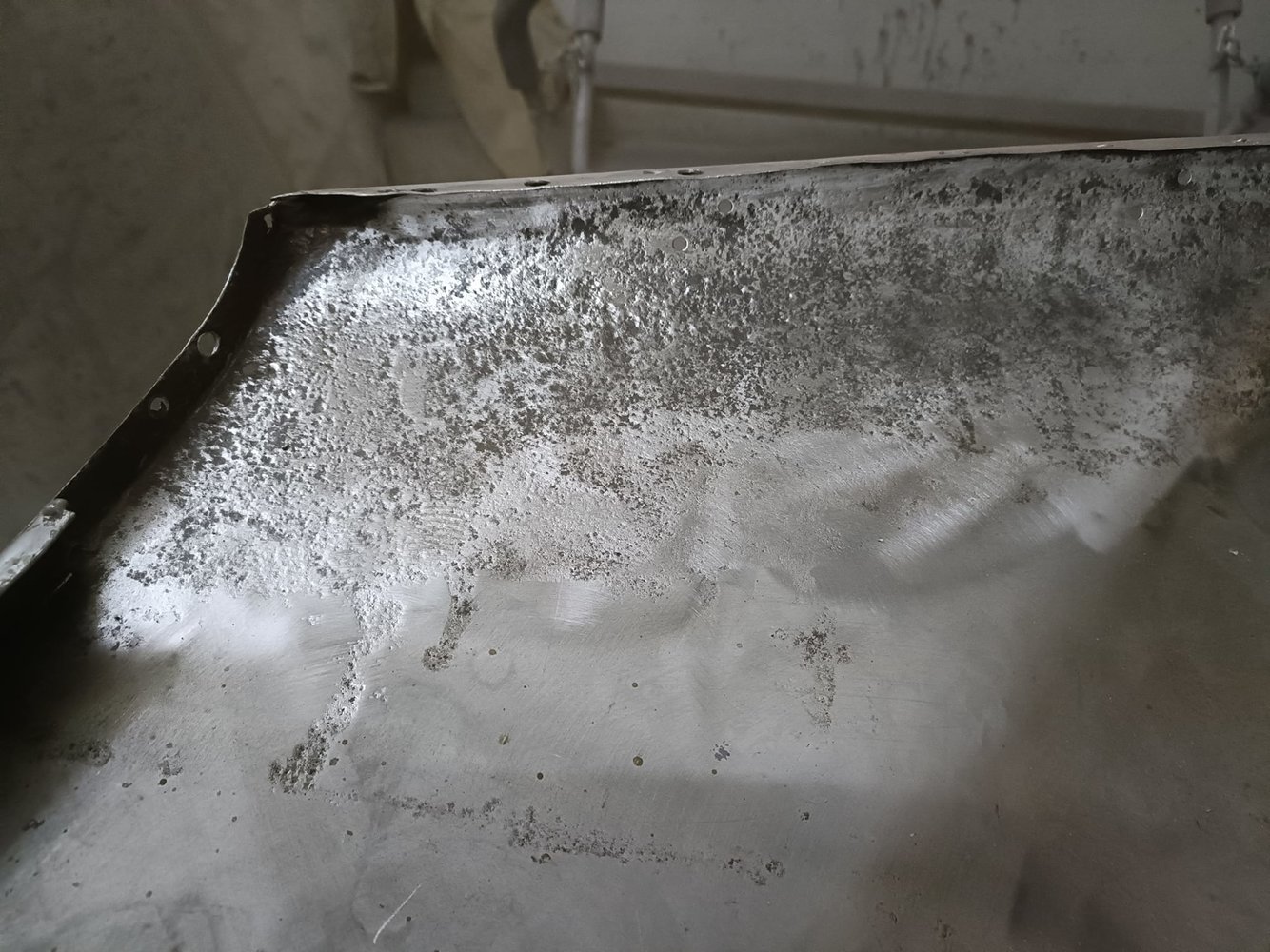

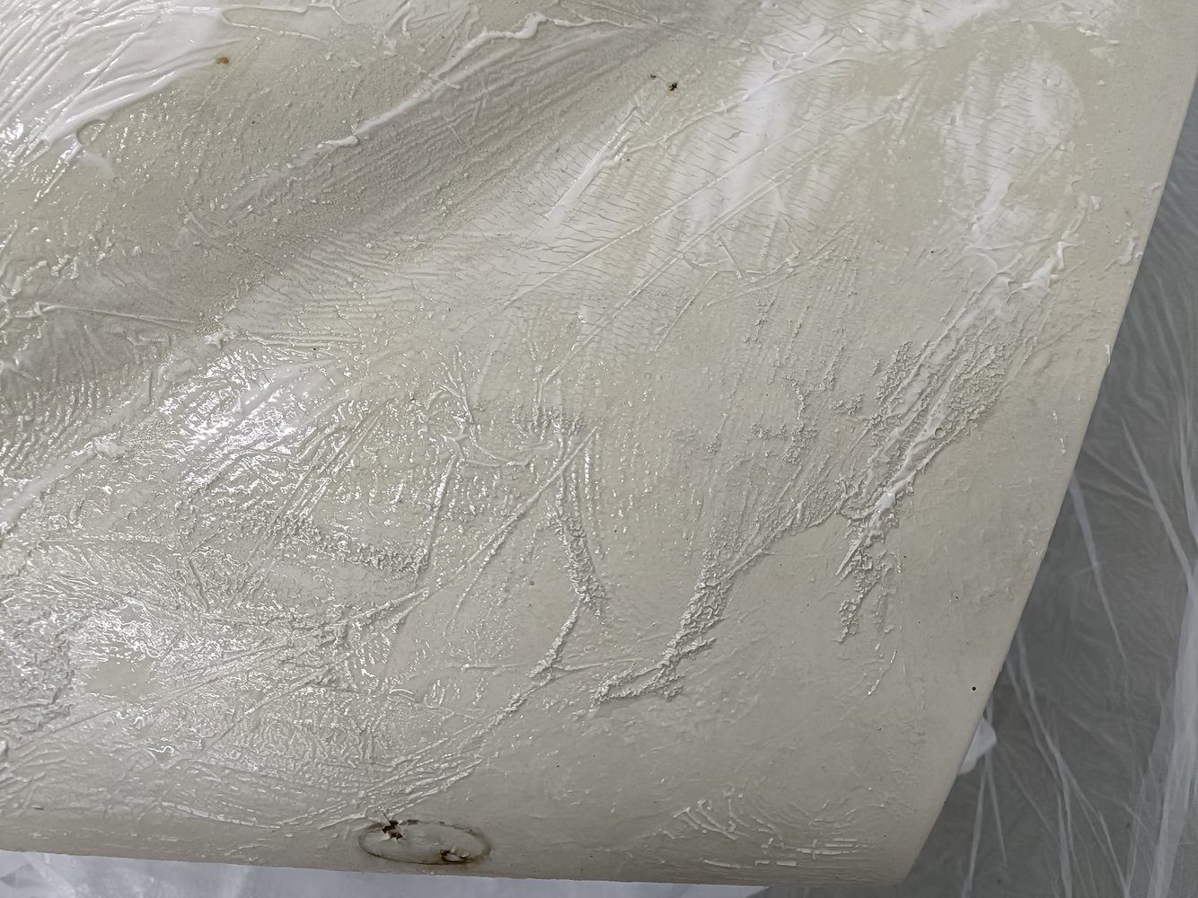

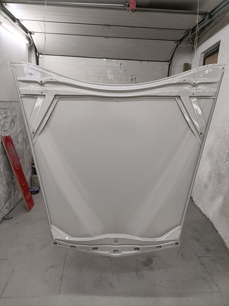

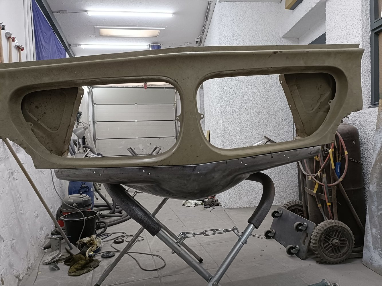

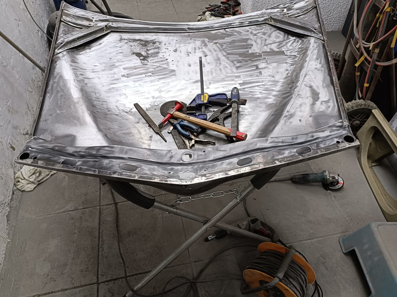

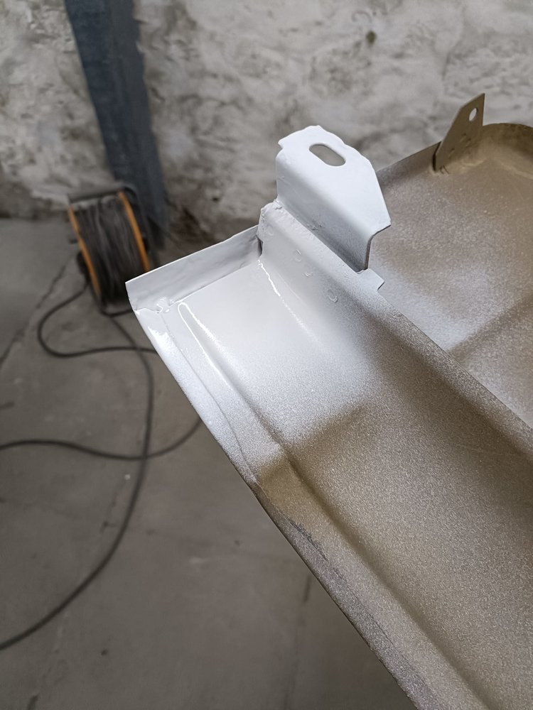

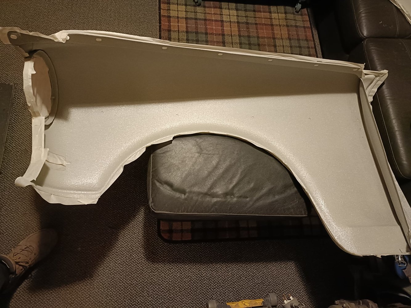

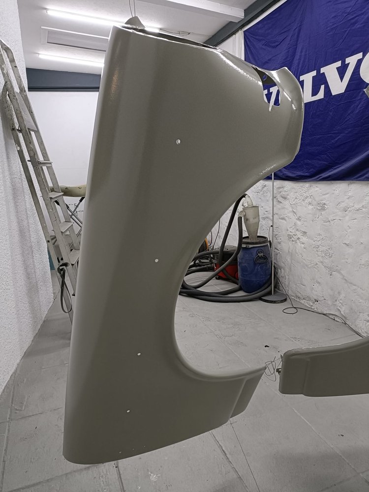

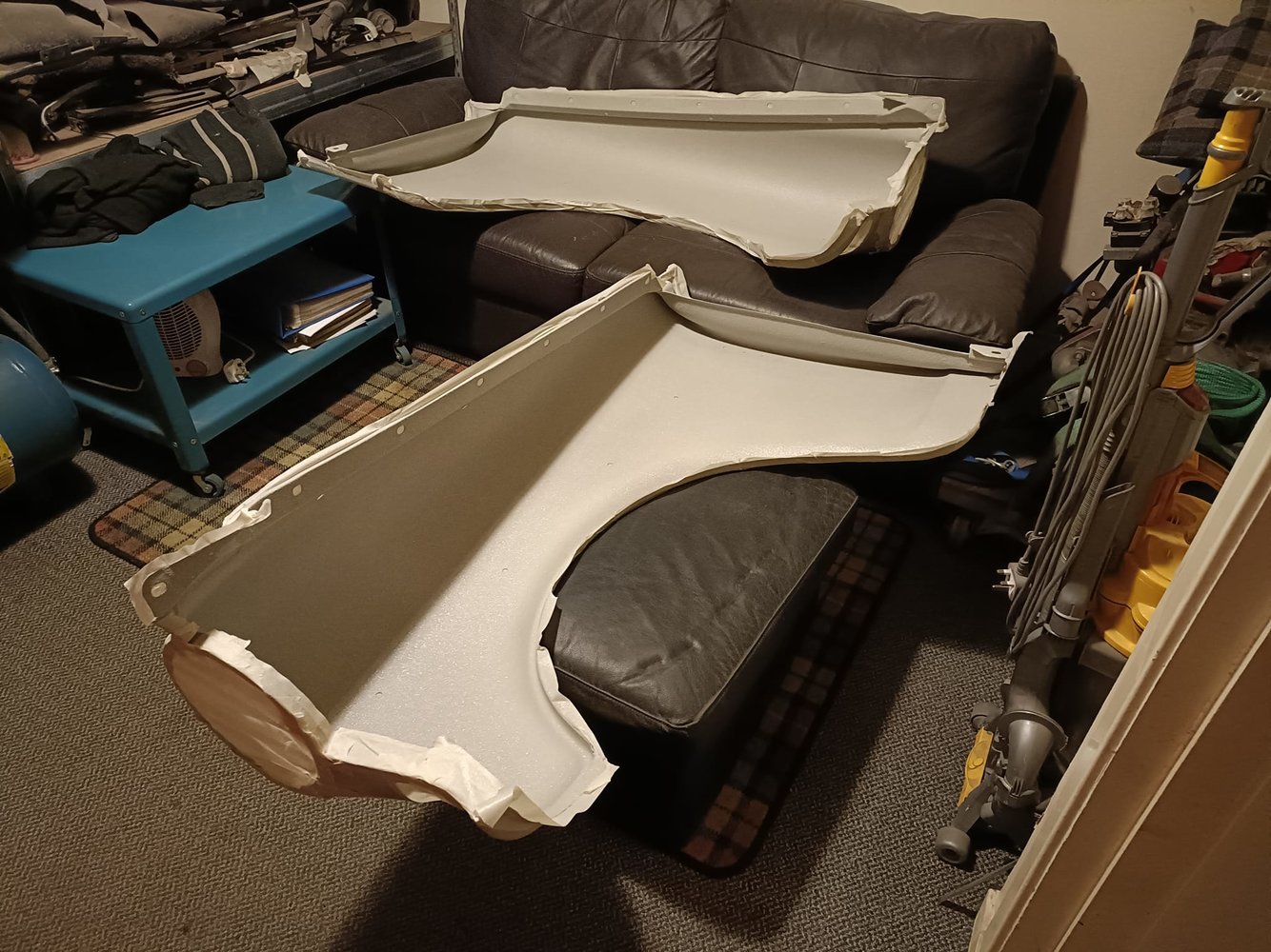

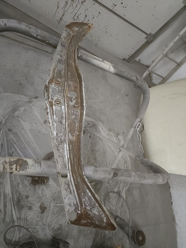

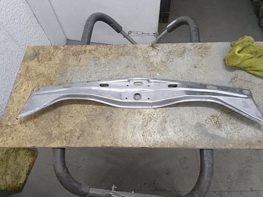

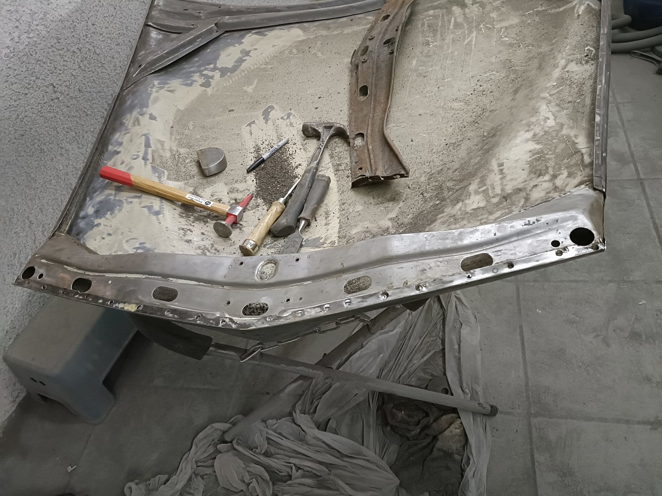

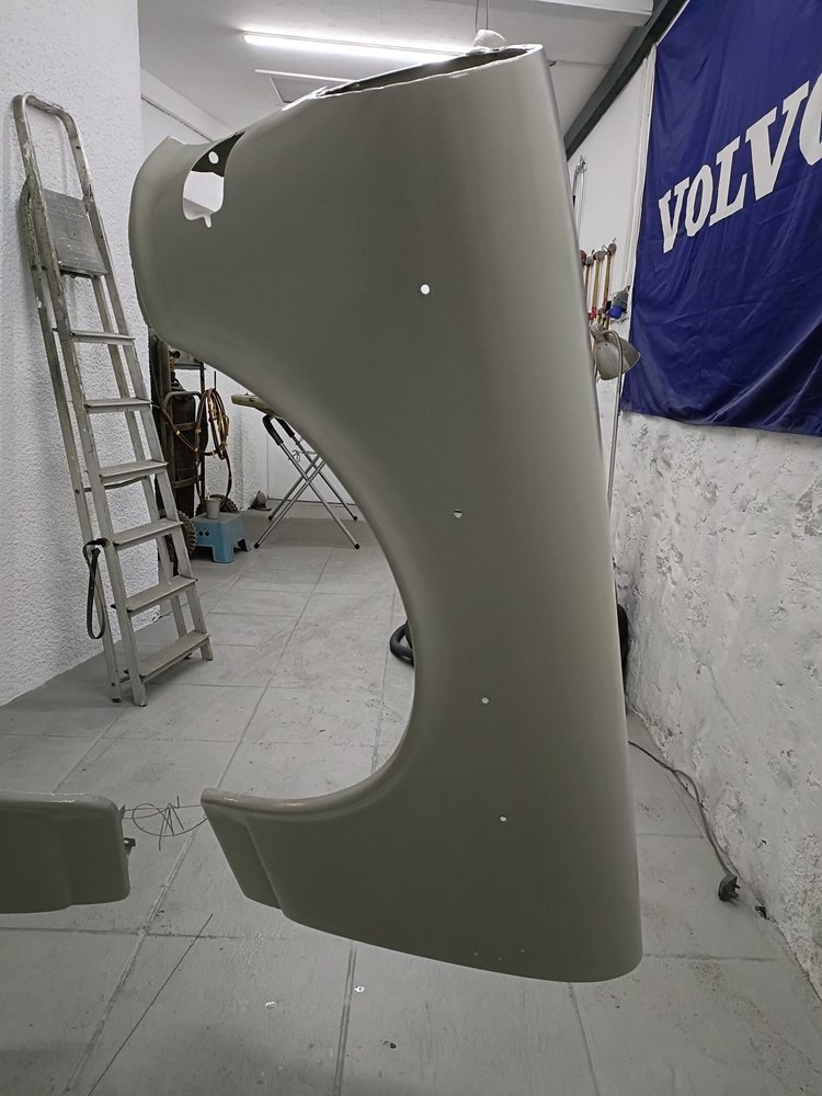

That's lush.Back in the workshop this weekend. Stripped the wings, brushed on epoxy in all the hard to get areas and then sprayed three coats of epoxy.

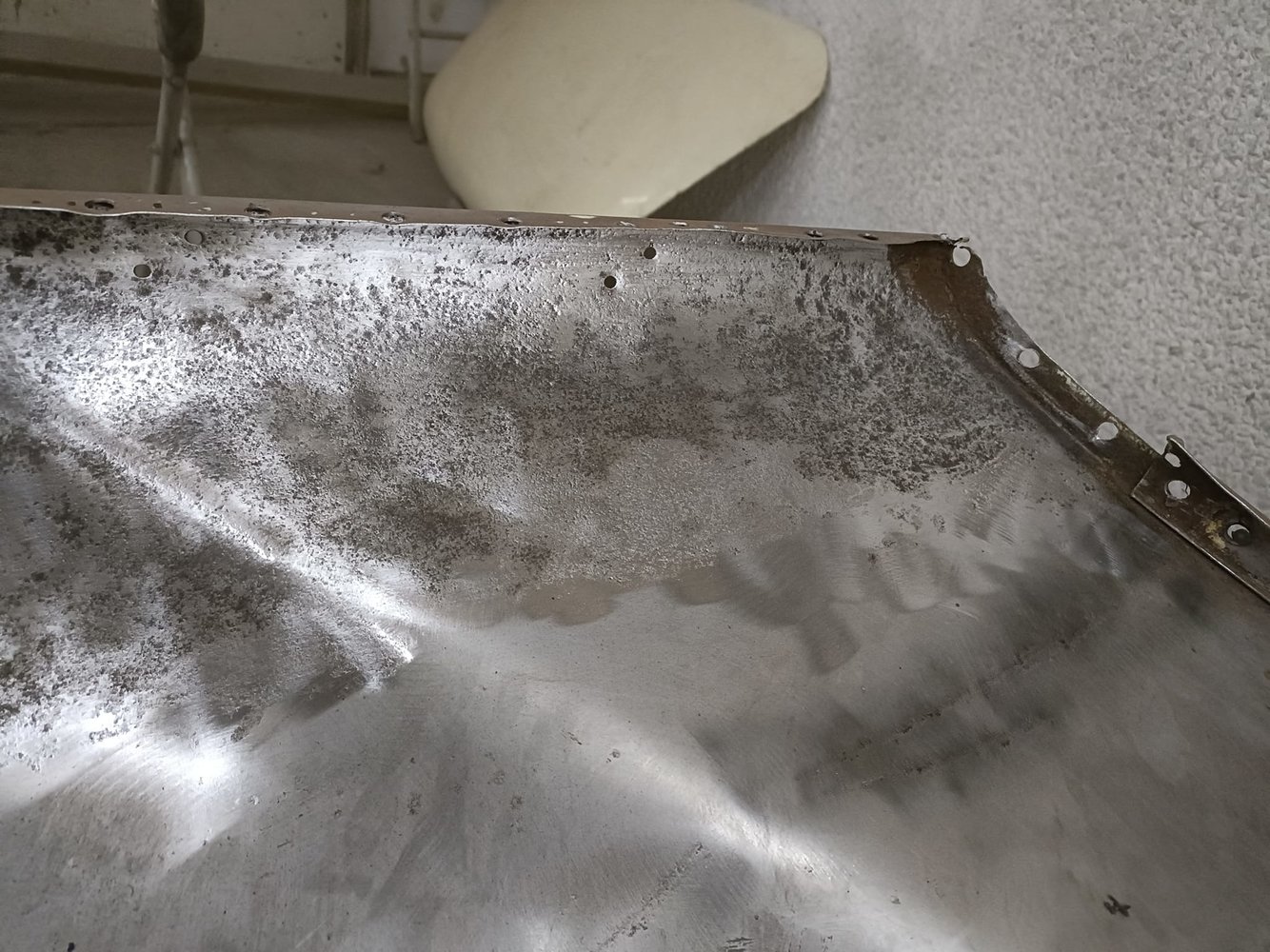

I'd had these sofa blasted, but there was surface rust under the etch primer so not sure what was going on there. I also asked for epoxy primer but the guy used etch, anyhow properly in epoxy now. Will raptor and colour topcoat inside next.
View attachment 372477 View attachment 372478 View attachment 372479 View attachment 372480 View attachment 372481 View attachment 372482 View attachment 372483 View attachment 372484 View attachment 372485

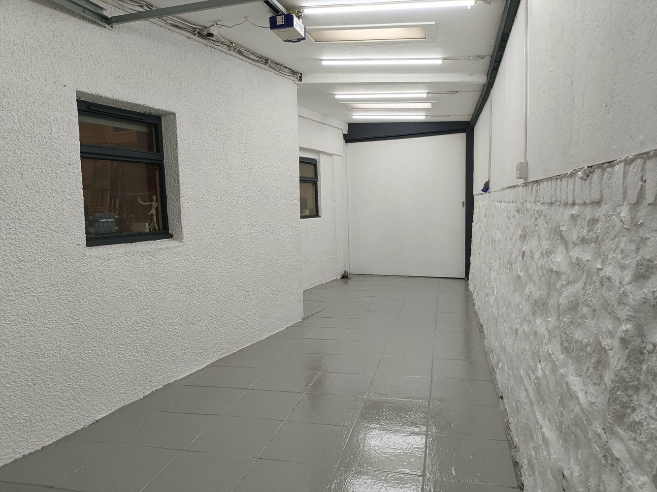

Ikea's finest (cheapest).How the other half live!![]()
Thanks Dan.Definitely better than it was new!
