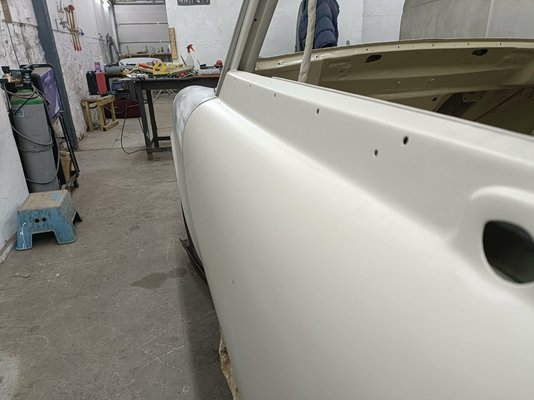

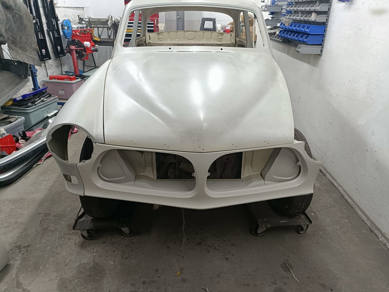

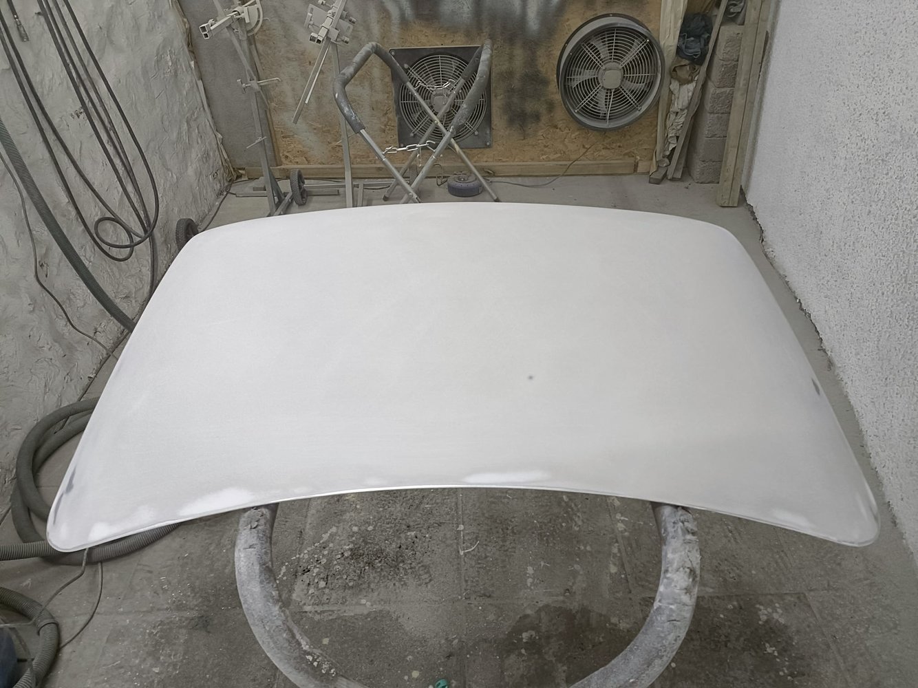

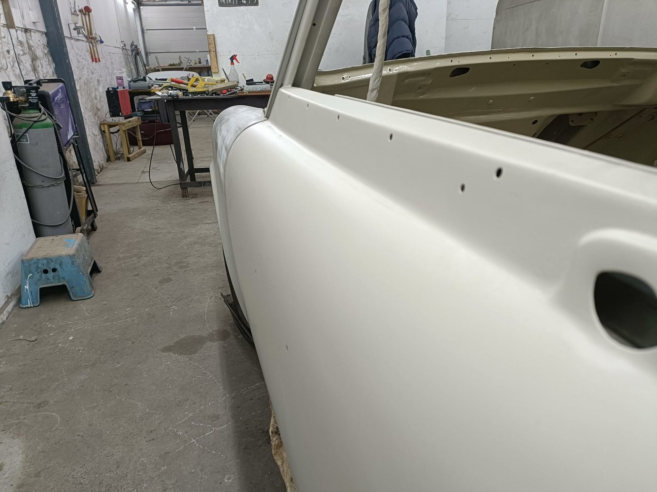

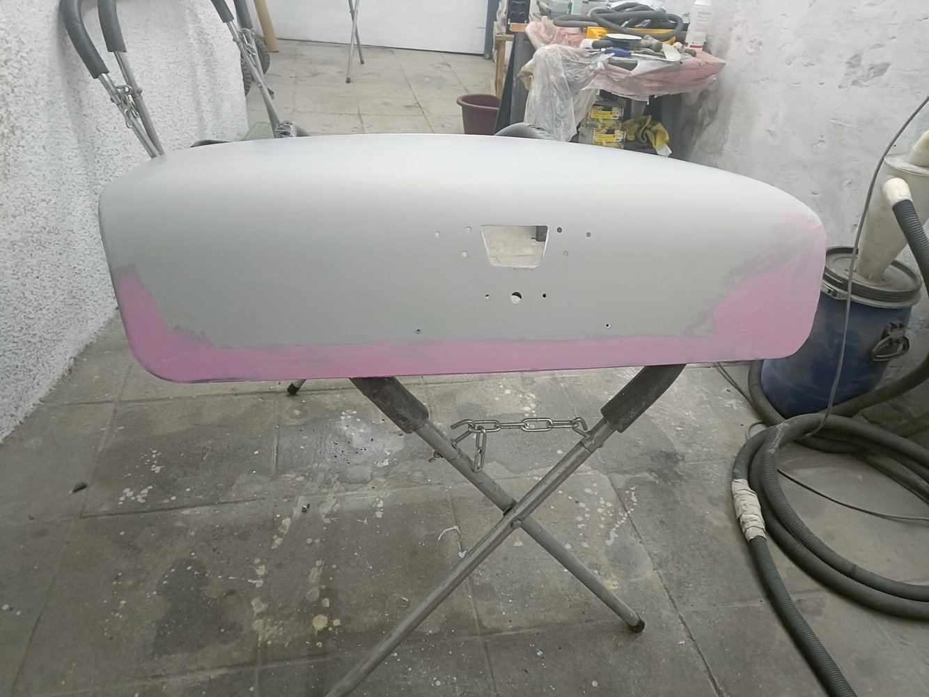

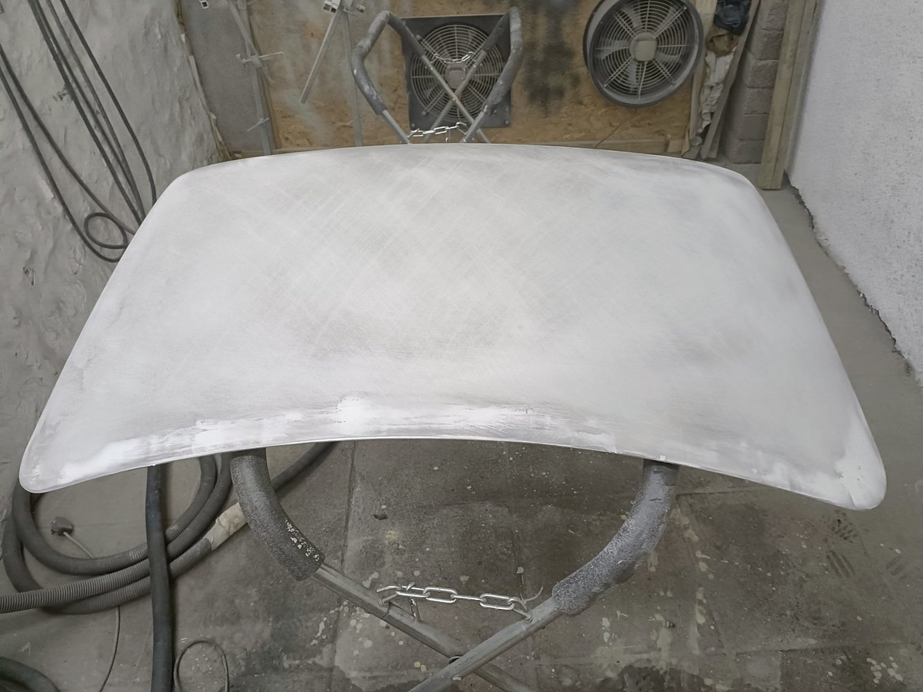

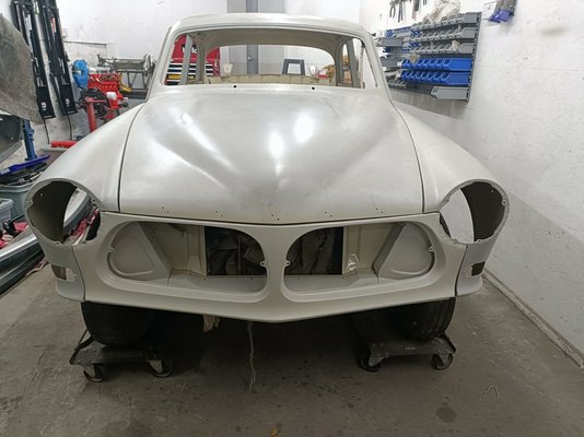

Just about to start bodywork so lots of sanding and all that sort of thing. :-)getting closer to the end!
Thanks. I do have good heating but just running the chinese diesel heater at the moment. I have padded coveralls and they’re awesome.Lovely work and hats off working in this weather and I assume you have good heat in your workshop ?

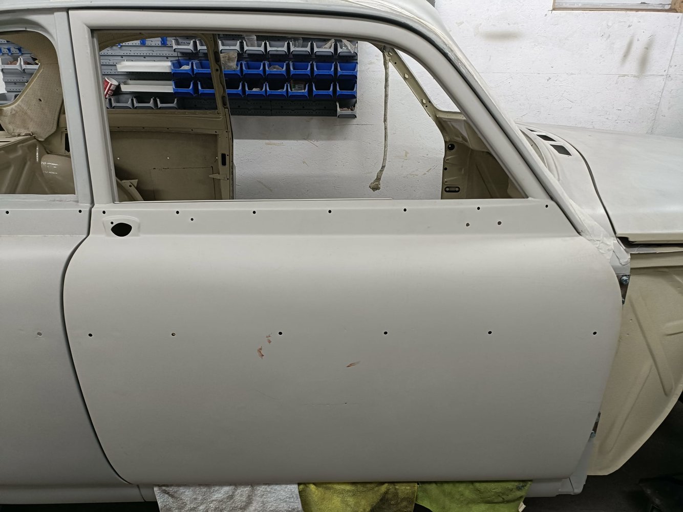

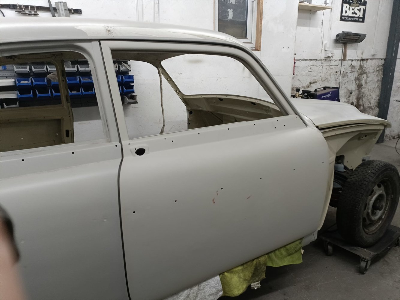

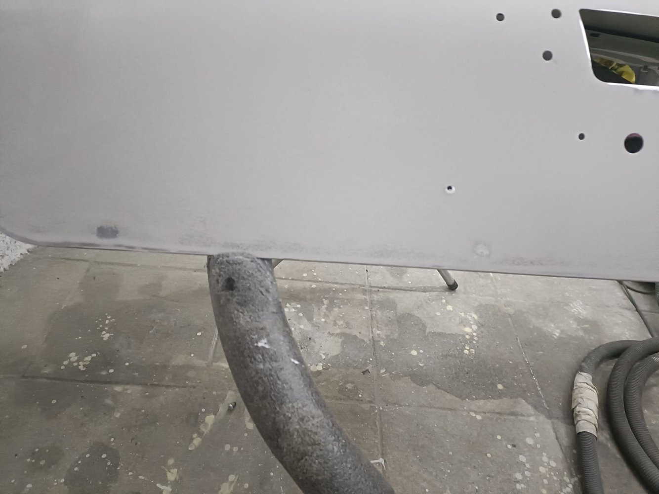

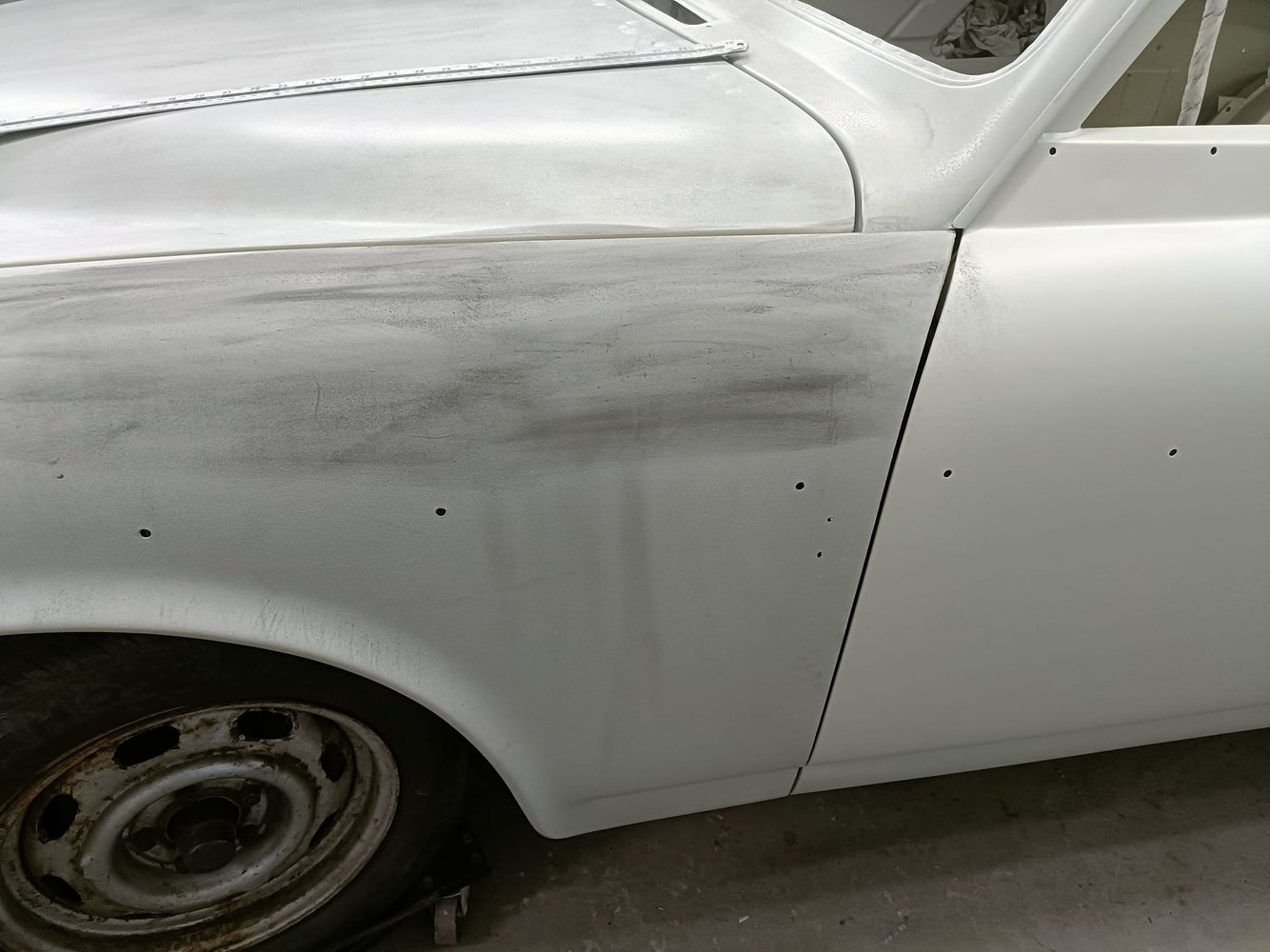

The blotches in the middle of the door. It’s a bit achy now, think I need another beer too.I can't see the blood but my eyes are bad and I'm very very drunk ..
Had a Christmas night out last night and hit my finger with a mallet and split the nail.
Surely it's art.Ouch!
So if Fisheyes are caused by silicone contamination,
what paint defect is caused by Blood on the panels ?
(hope your fingers is well soon).

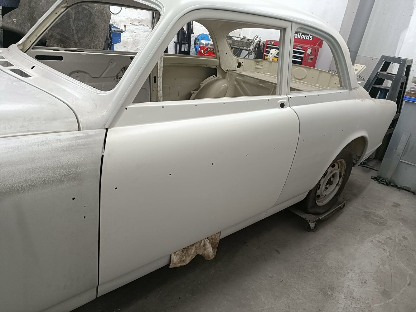

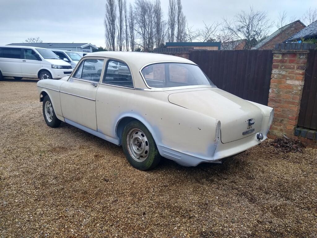

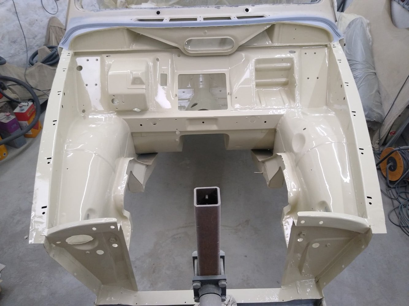

Congrats, this was my old mans car, I plan on restoring one, one day...I bought my mate’s 131 and I’m down in England picking up the parts and will transport her back up to Scotland in Feb. My mate has owned the car for over 20 years. She’s a genuine original rust free car with new front panel, wings and a load of other spares as well. Suspension and engine have been rebuilt, bolts etc have been zinc plated. The car is apart and needs painting and reassembling. I will epoxy prime the whole car, stone chip the bottom and then topcoat the whole car except the A surfaces. The A surfaces will get painted once the car is back together.
Will try and do a build thread, will see how I go. Video of the car as it is currently;
I hope to make a start in late Feb / early March.
