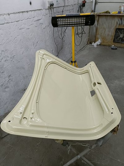

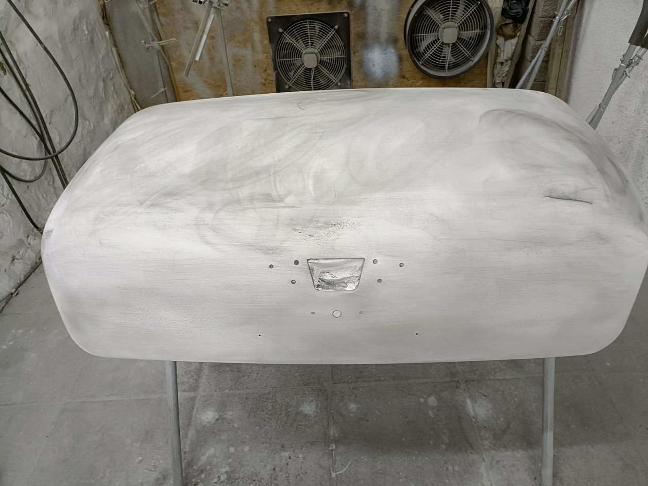

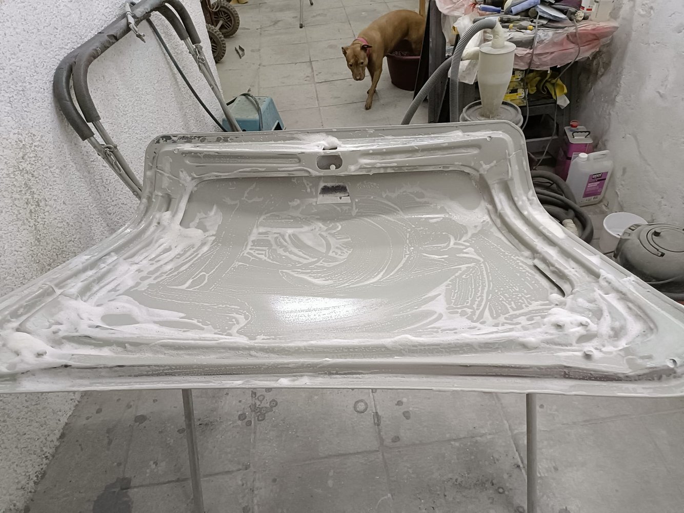

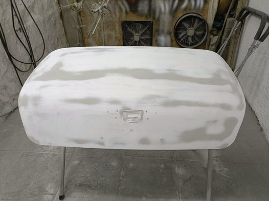

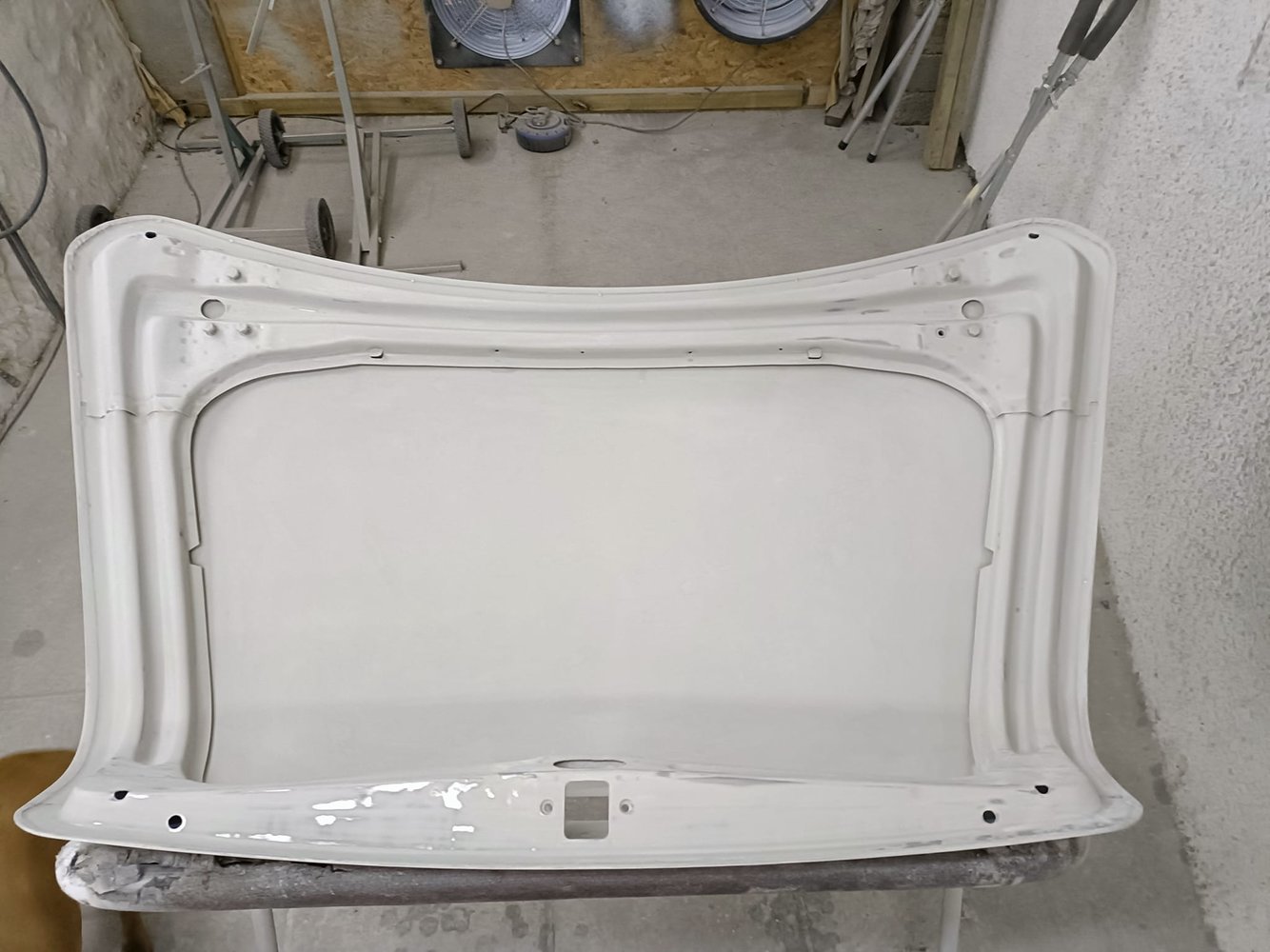

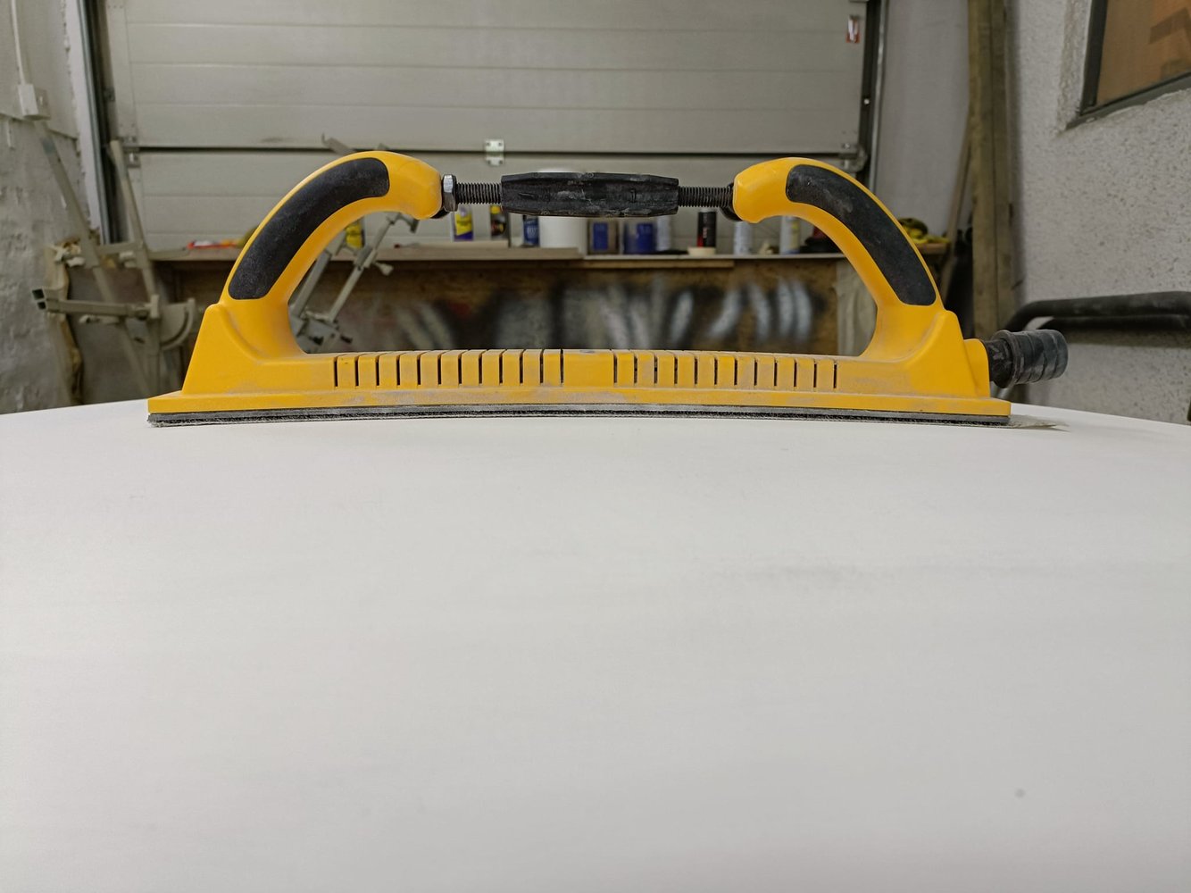

Blocked the boot lid down today. I made a start yesterday with a long flat block but that was no good as it's a compound curve so changed today to my Mirka adjustable block and a flexible block. Think it's turned out good. Will give it a couple of coats of epoxy and put to the side and start blocking the car.
