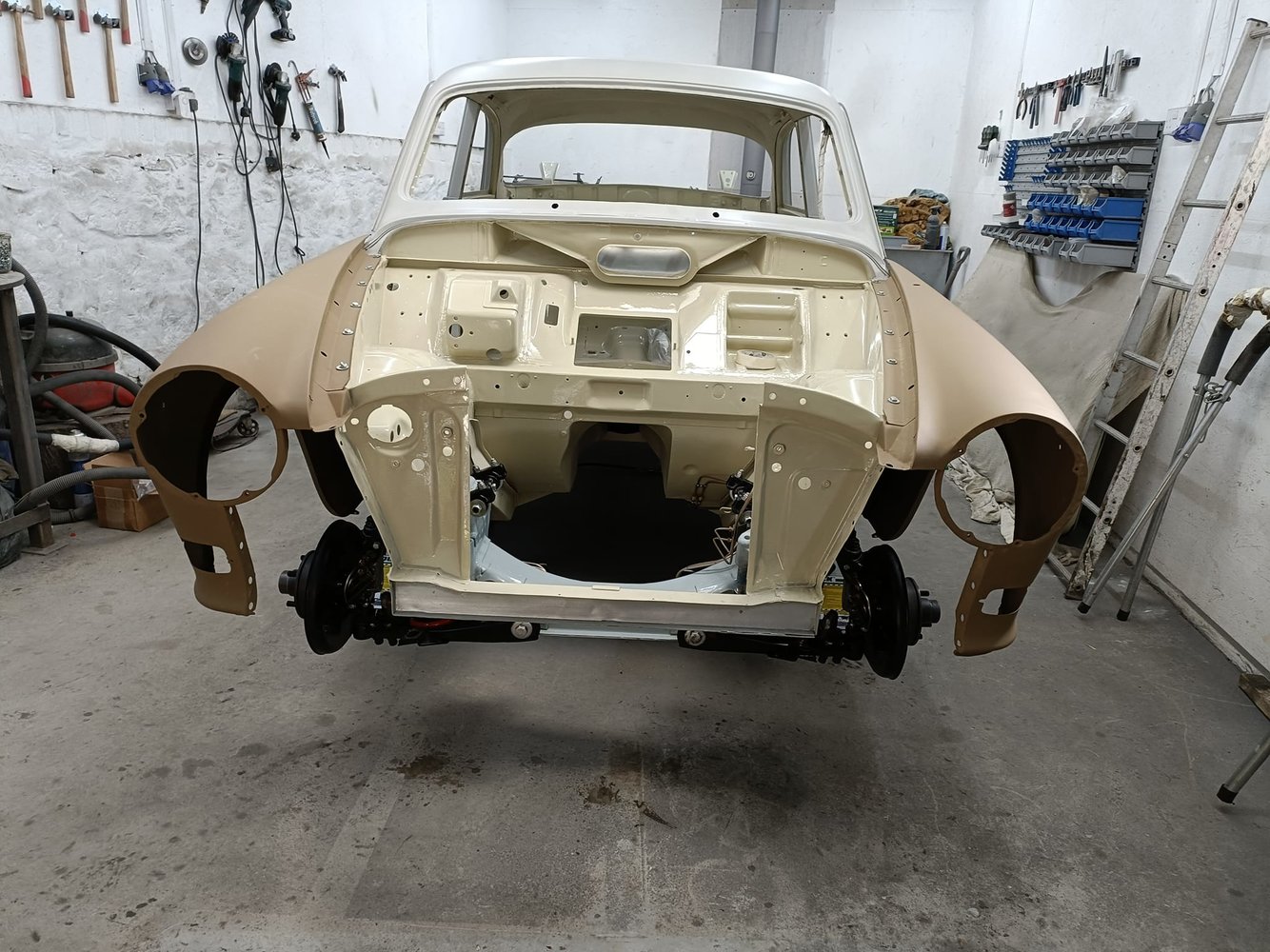

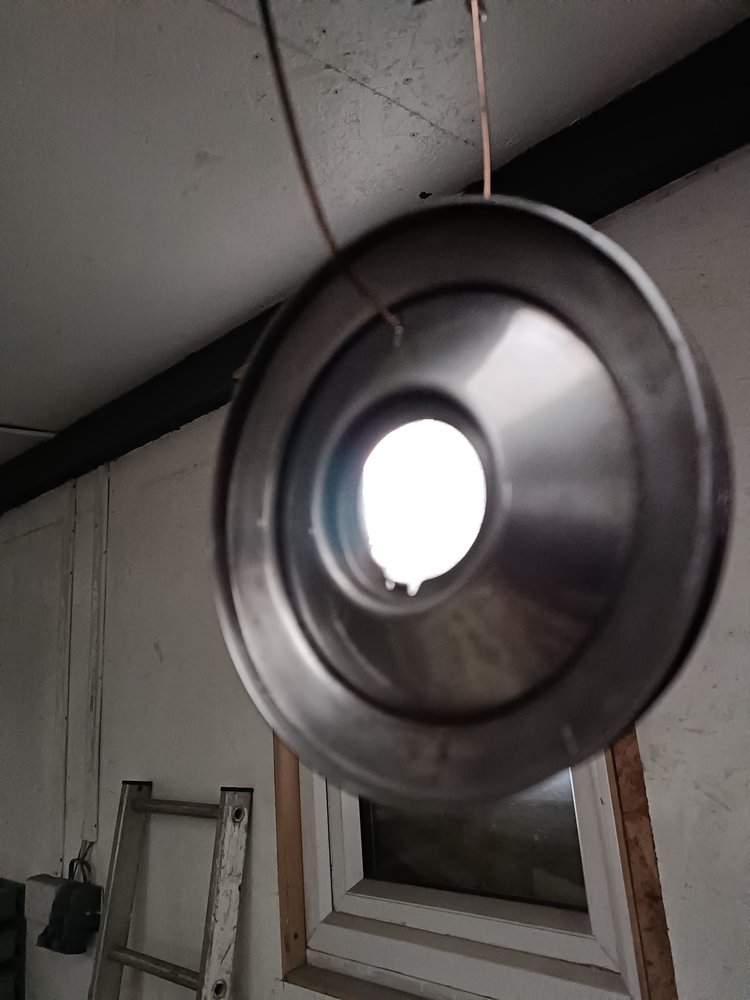

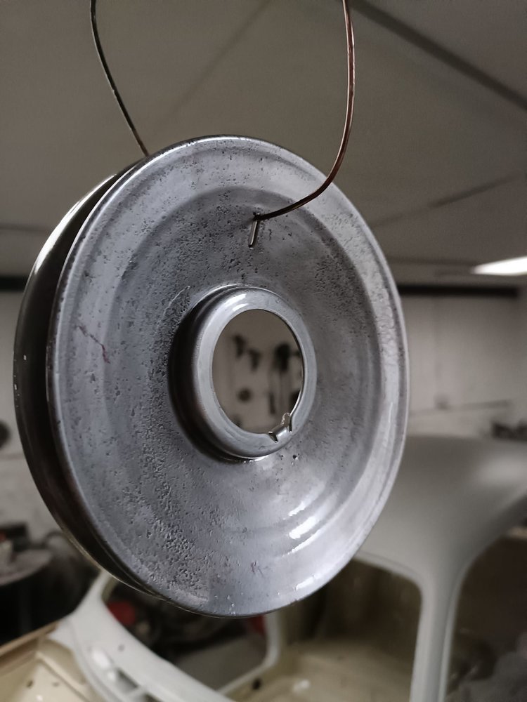

Yes that's right, made by Dunlop. They are the Volvo 140 GT wheels.In the picture with the dog, is that a wheel with a steel rim and an alloy centre? A bit like an MGB GTV8 but with a different pattern.

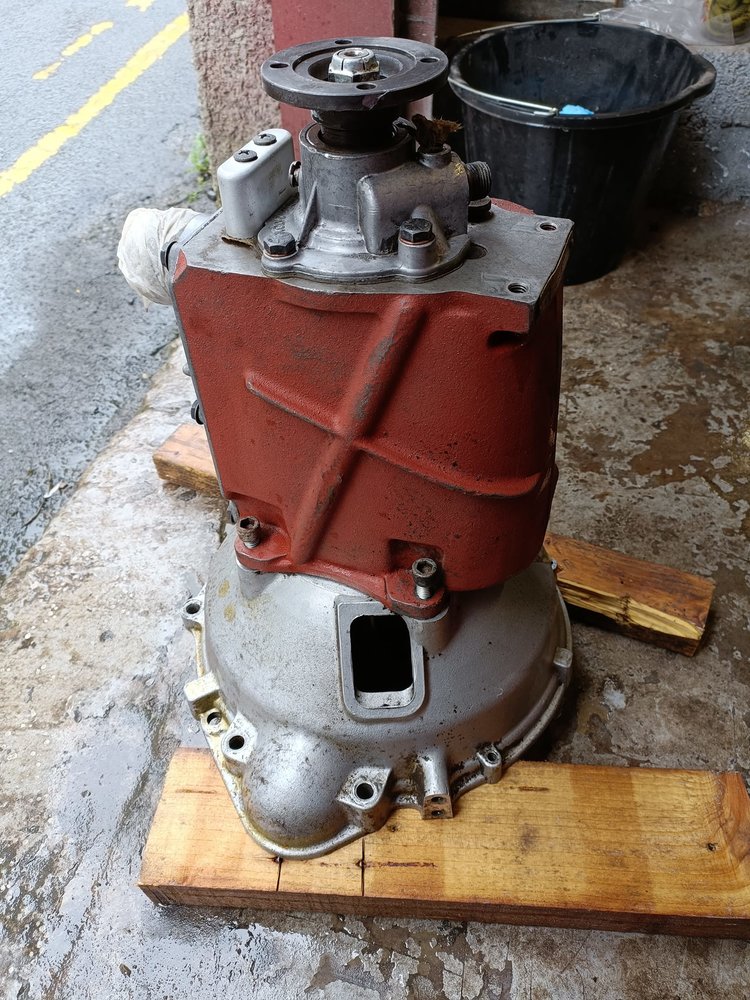

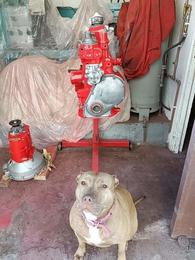

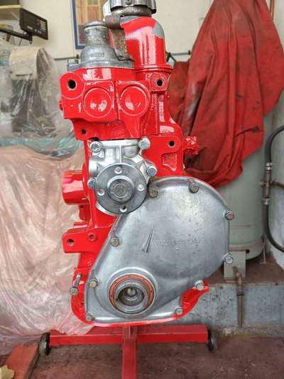

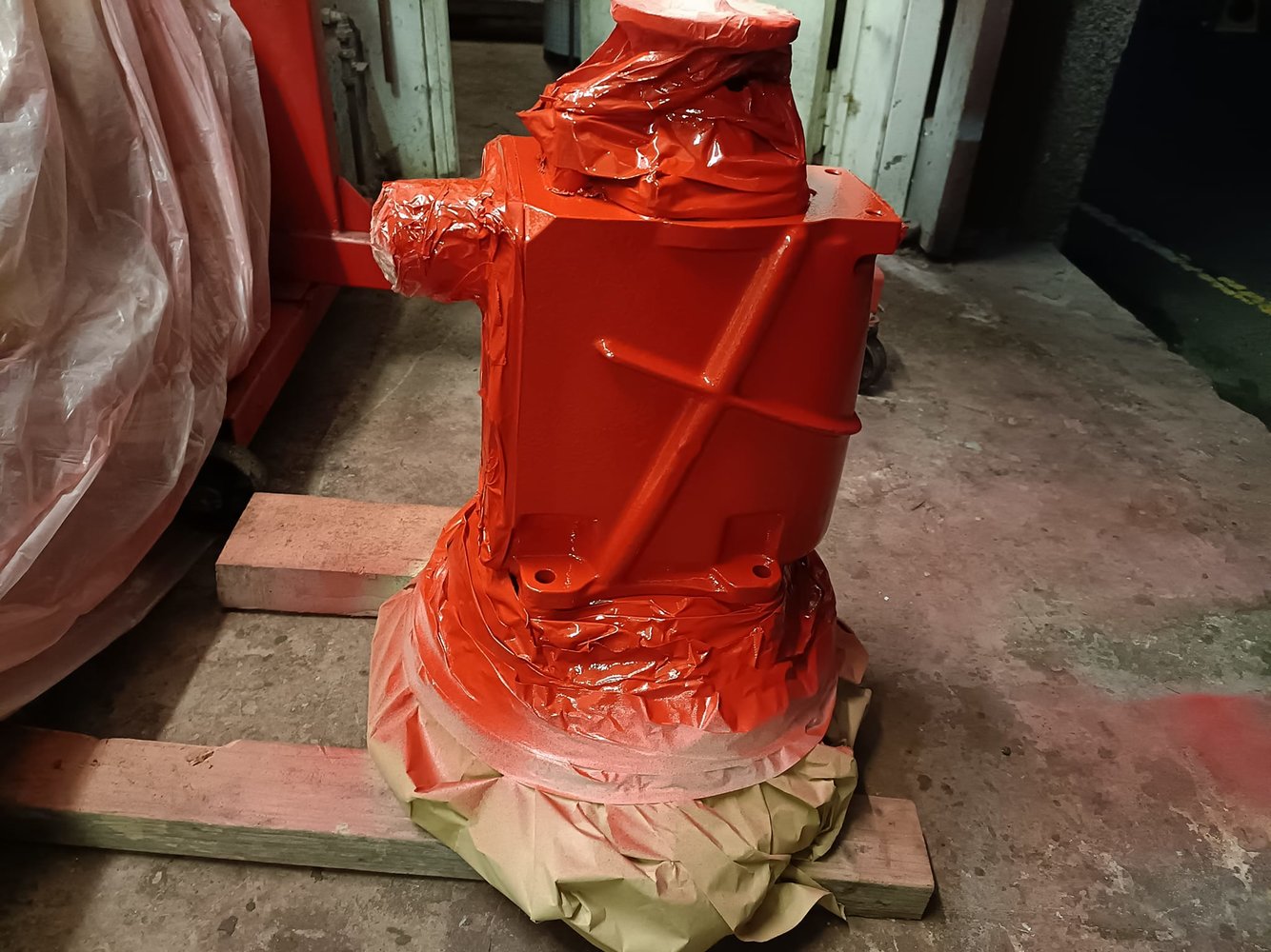

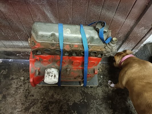

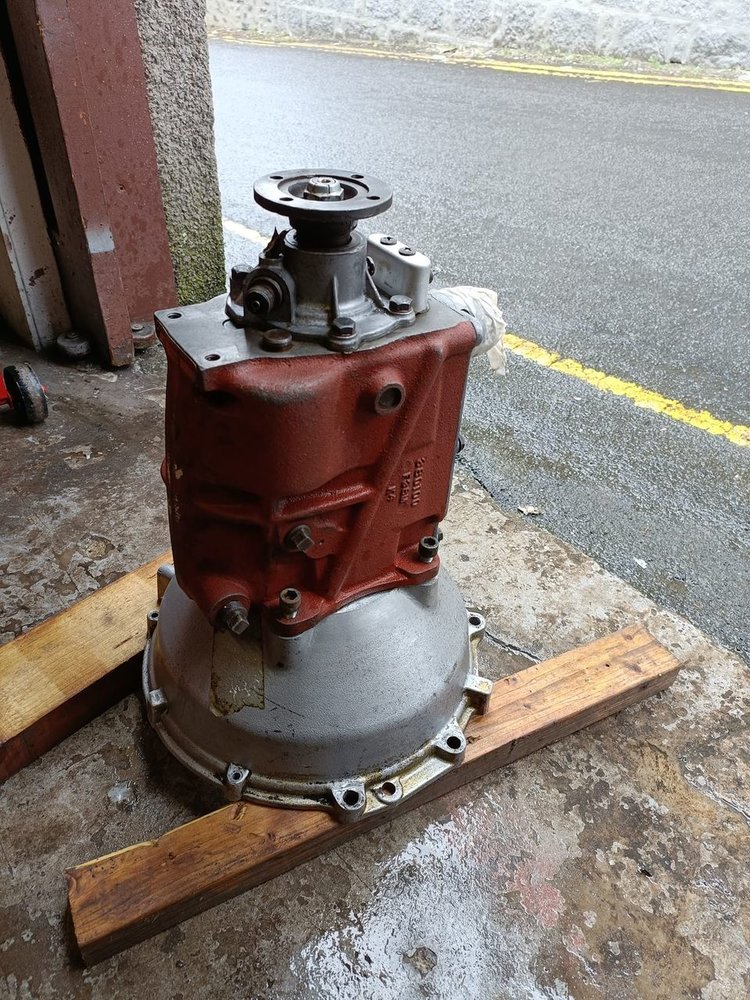

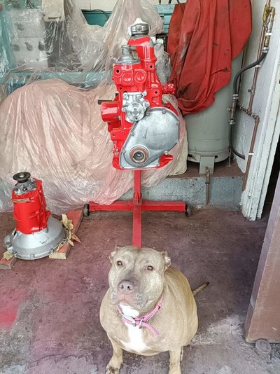

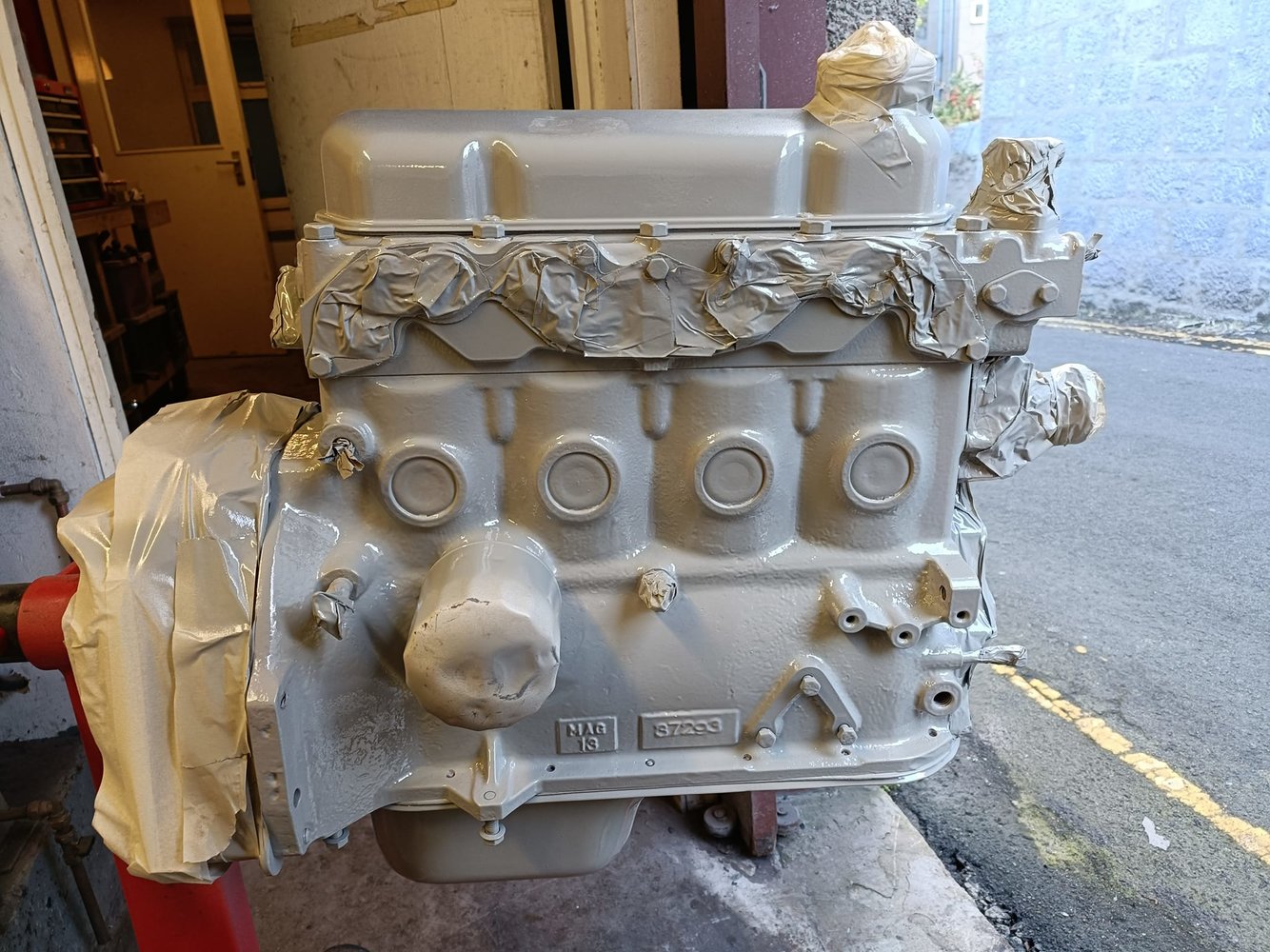

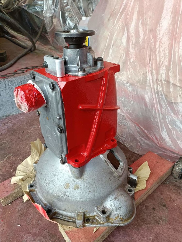

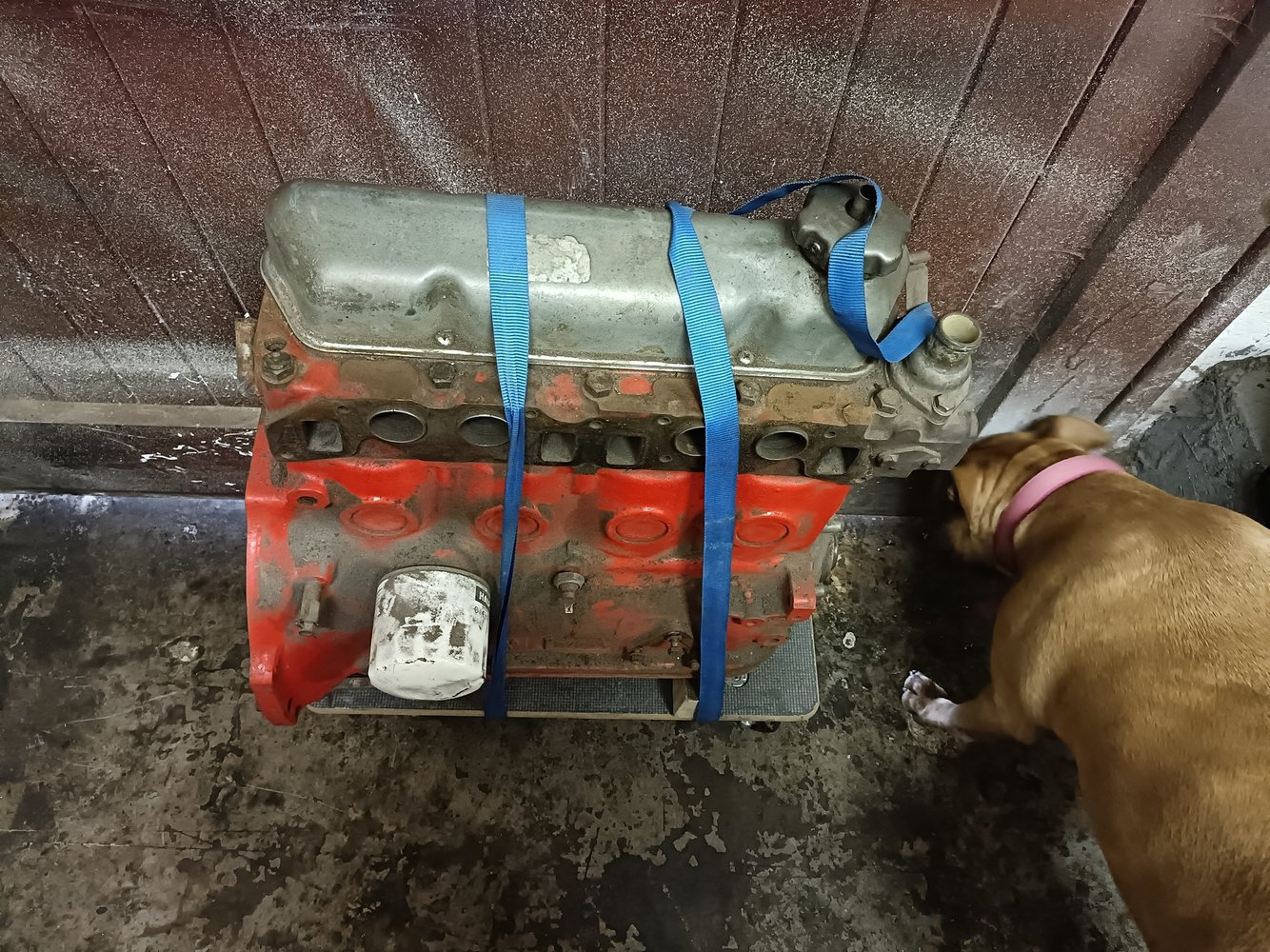

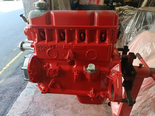

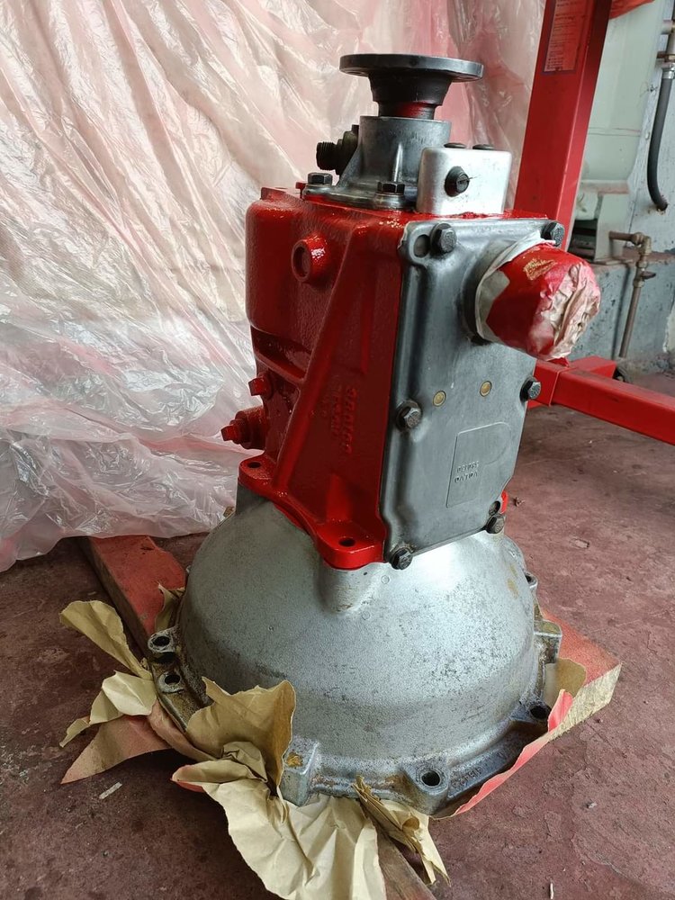

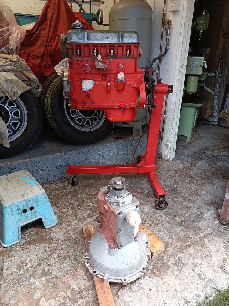

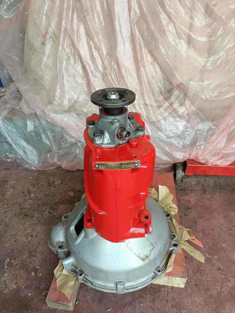

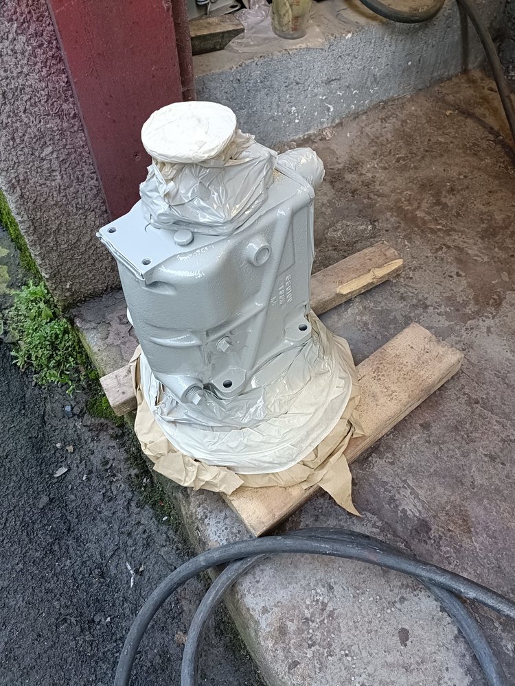

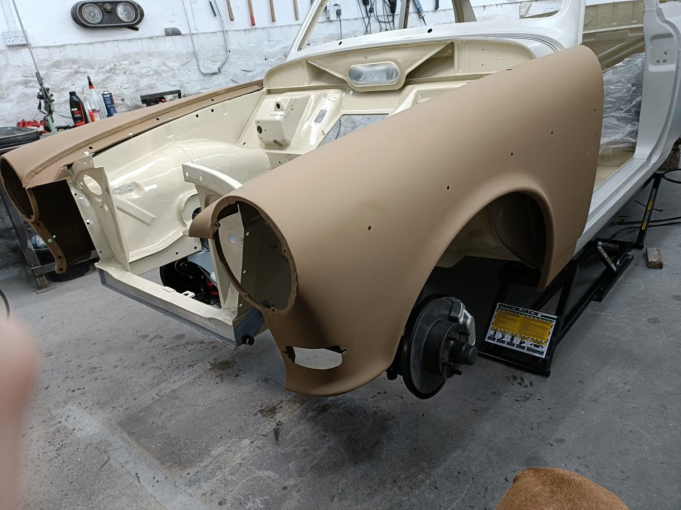

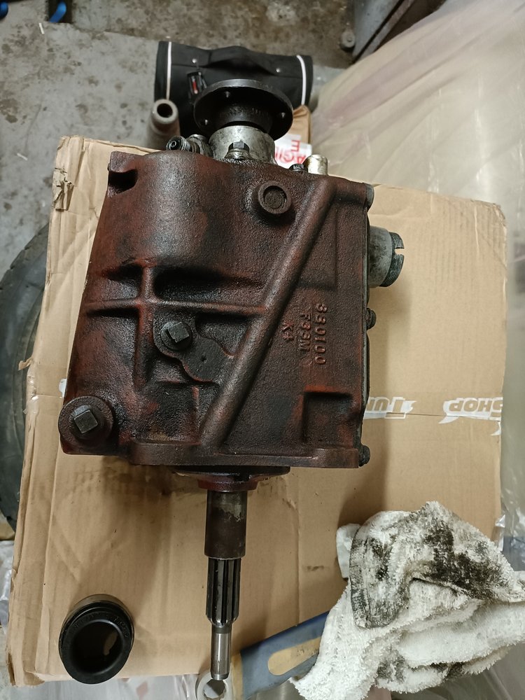

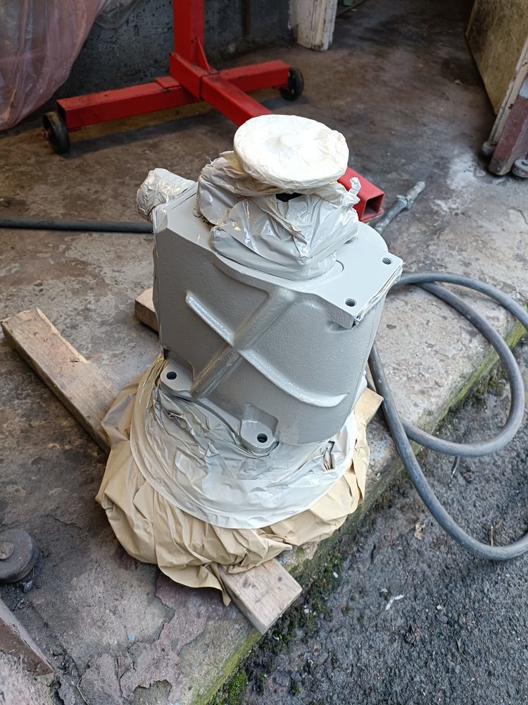

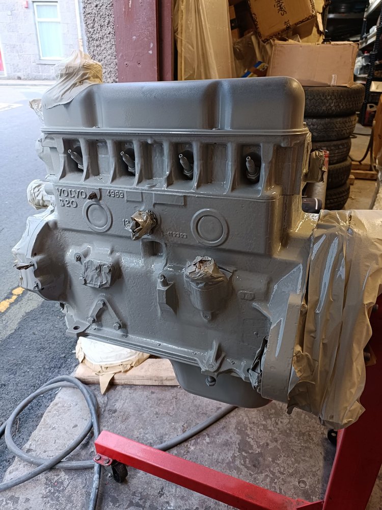

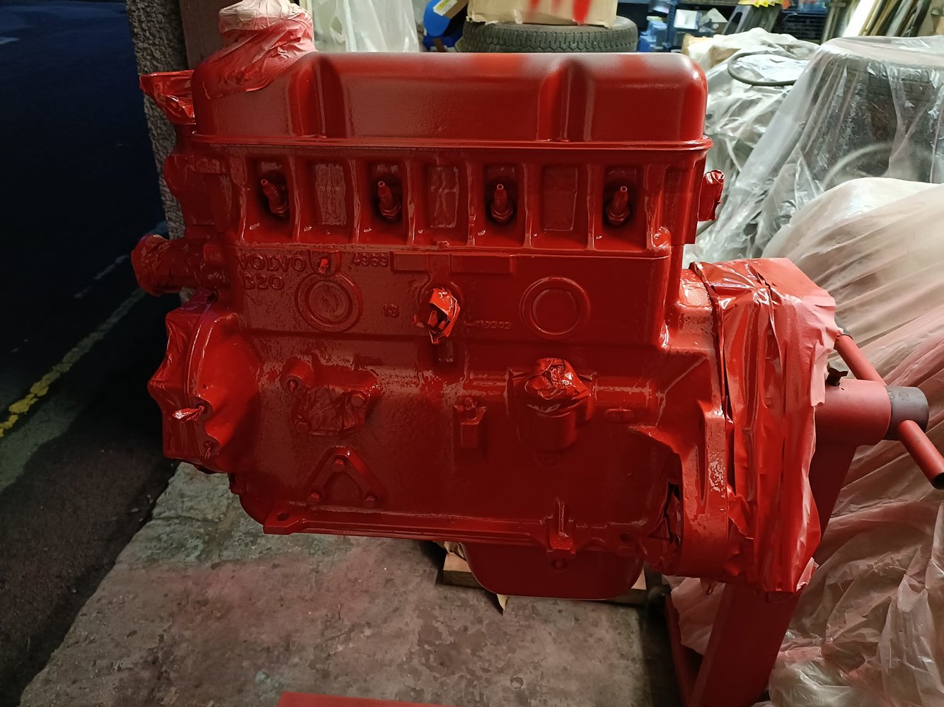

Coming together now.Gave the engine and gearbox a good clean and a rub down. Plan is epoxy primer and then topcoat.
To drive and enjoy it. Doubt it will see a show not really my thing.Coming together now.
What's the plan when you get it on the road? Shows, daily driver, classic rally, trailer queen, or a bucket list round the world thing?

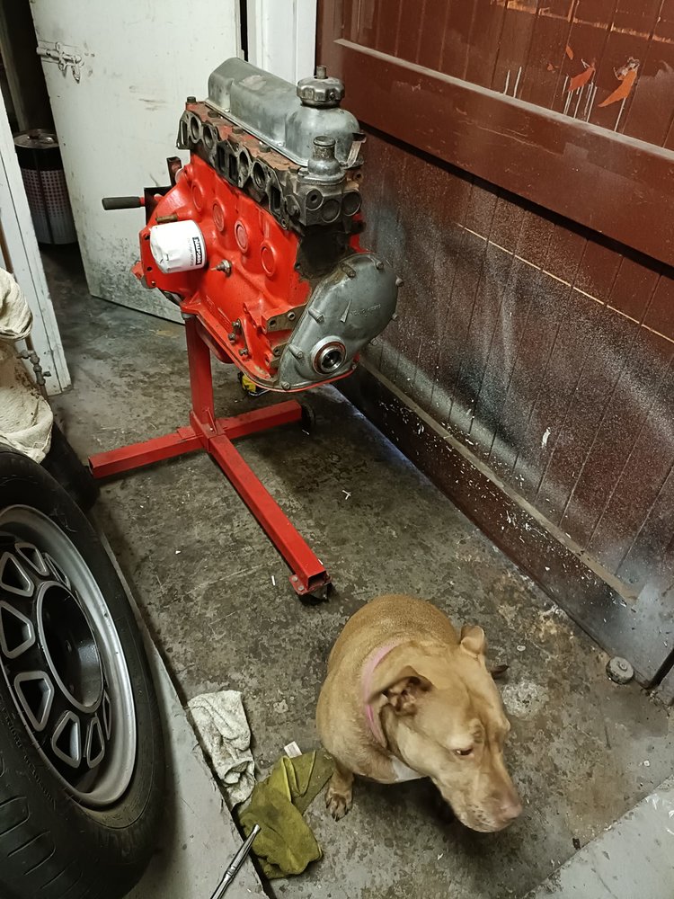

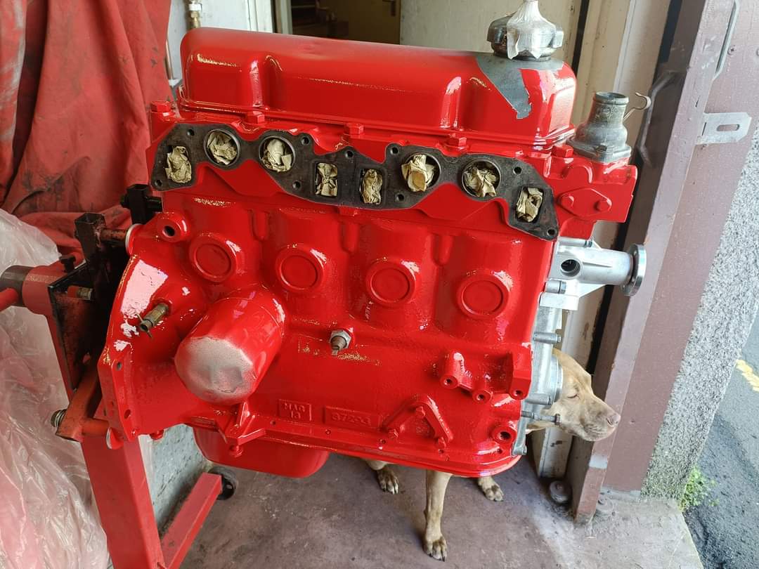

Rubbish workshop dog just wanting to go home.

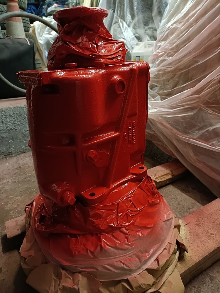

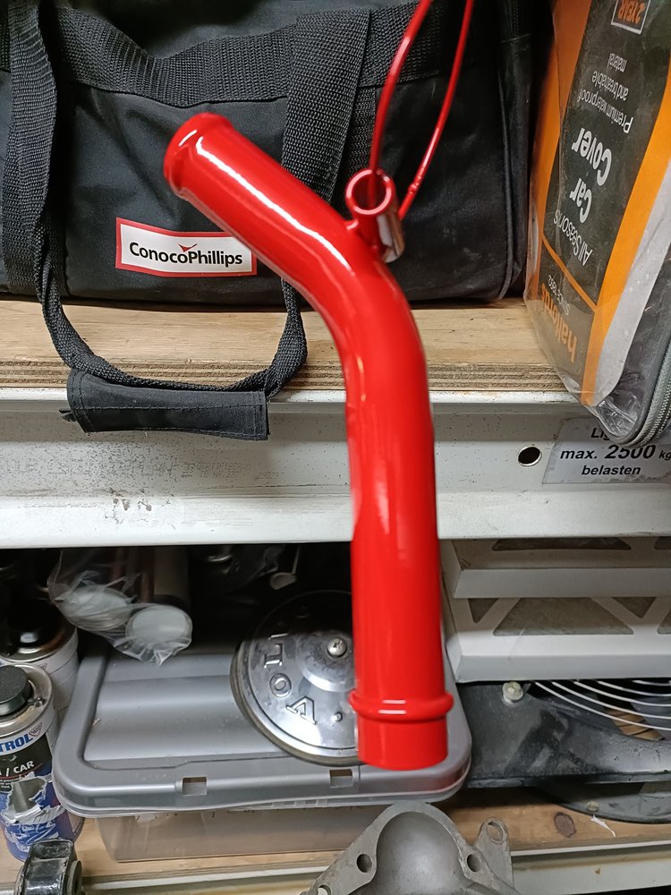

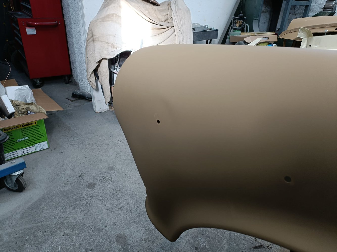

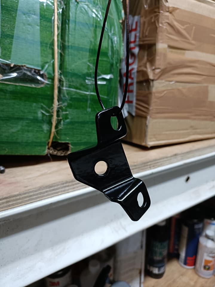

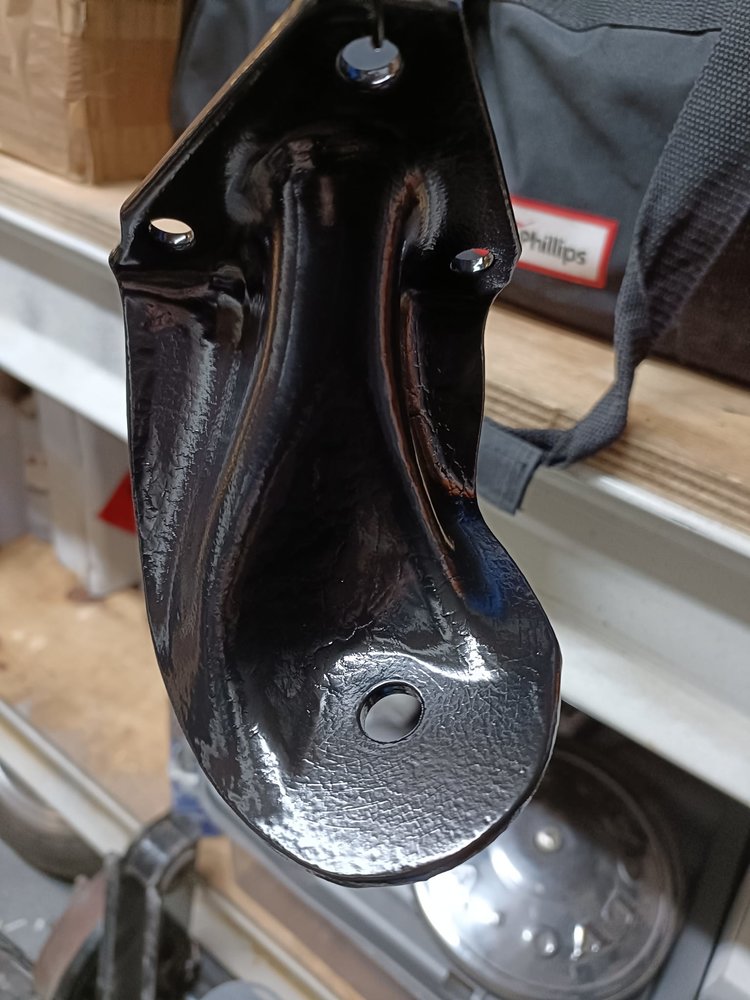

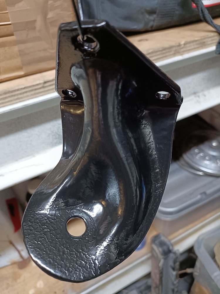

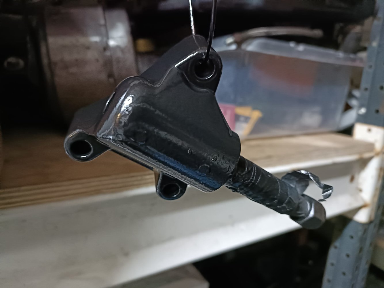

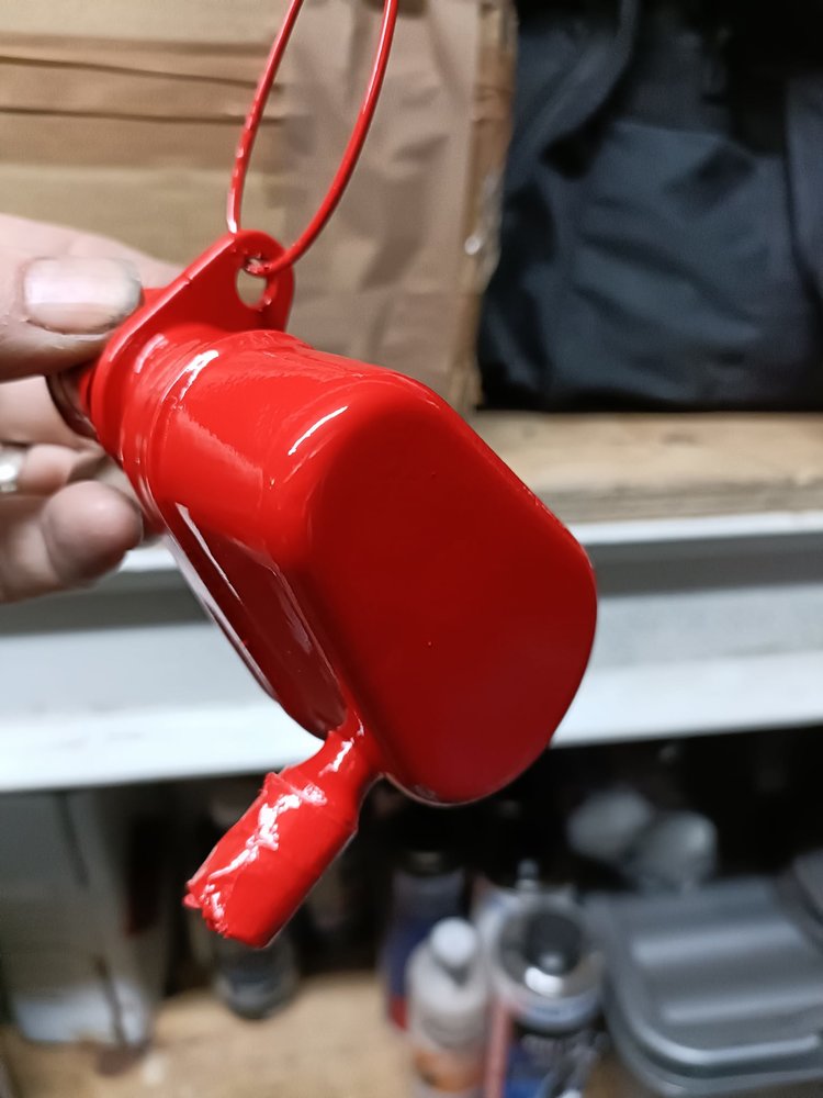

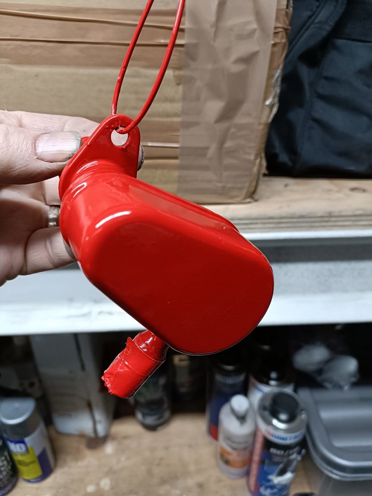

No I didn't prime it and I had a bit of a reaction with the old paint, assume the old paint was 1k. It dried nicer but still not spot on. It normally flats out nice and is a satin sheen. I primed everything after that.In post 155 the bottom 2 pictures have some texturing in the paint that almost looks like hammerite. Is it a trick of the light or is that how Jotun Hardtop HB comes out?
I ask because the only Jotun I have used is Jotamastic 80 on the underside of my car and on suspension parts. I have been very happy with it.
