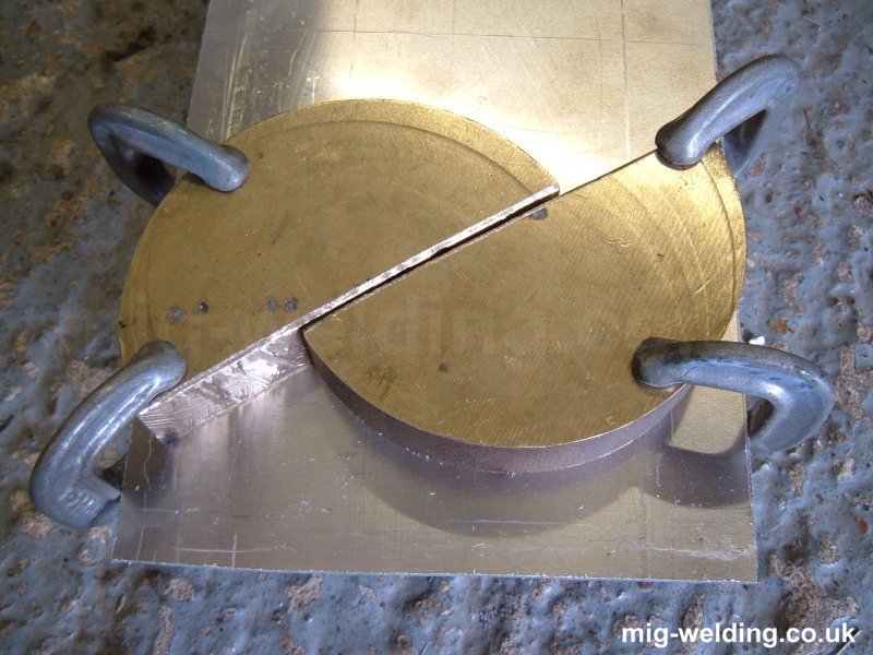

Using a Brass Heat Sink
Brass has a much higher melting point than aluminium and it is also quite inert which makes it an ideal material to use as a heat sink.
The brass heat sink is effective when clamped immediately behind the aluminium to be welded. Here I've clamped two off-cuts of brass bar approximately 20mm thick to the rear of the aluminium sheet.
Brass heat sink
Finally a Nice Weld
The heat sink takes a great deal of heat from the weld, so the welding motion can be much slower and hence neater. The slower weld also reduces the build up of aluminium so there is less weld to file off for a flat finish.
aluminium with a heat sink can be welded with much the same technique as you'd use for steel. I've settled on the technique I use for thin steel - short bursts.
Much neater aluminium mig weld
