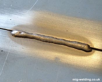

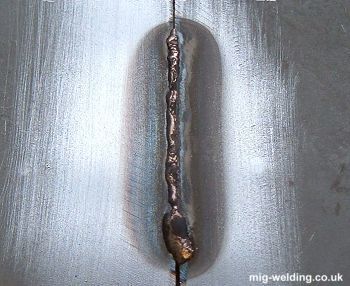

A MIG Brazed joint
Silicon-bronze brazing wire feels a lot like mild steel wire to use, though because braze melts at a lower temperature than mild steel it can be applied at much lower power settings.
For brazing a butt joint (as in the photograph) the two sheets of steel should be spaced apart by about the same thickness as the steel. For an overlap joint the two sheets should be spaced apart by at least 1mm. The steel sheets aren't melted during brazing, so there has to be a gap for the filler material.
MIG brazed joint

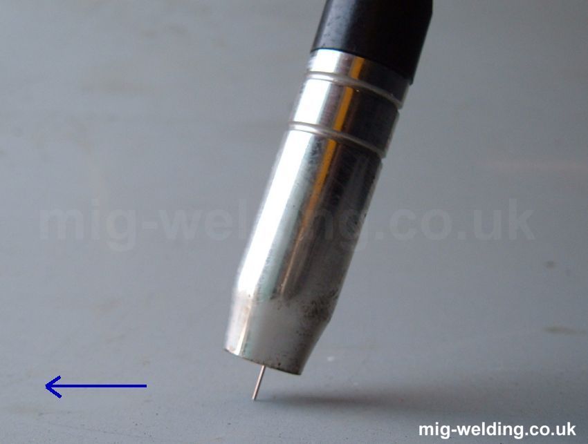

The MIG Brazing Technique
The technique for mig brazing is to weld in a straight line, moving the torch forward. The forward angle of the torch pre-heats the metal about to be brazed.
During brazing there is a bright blue shimmering light traveling on the surface of the metal ahead of the weld. This is an effect of the arc which apparently does the same job as the flux in gas brazing.
I'm brazing 1.2mm steel, so my welder is set at the minimum power setting (less than for normal mild steel welding), but the wire speed is roughly double that which I'd use when welding.
Orientation of the welding torch

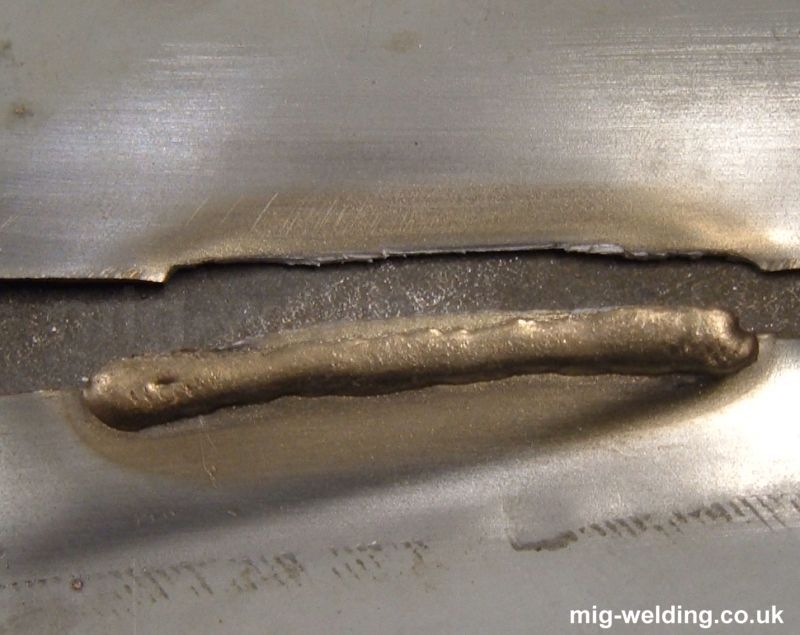

Braze Penetration
I found I needed to space two sheets of 1.2mm steel apart by somewhere between 0.5mm and 1mm for the braze to flow all the way between the two sheets of metal.
The gap is important. While ordinary welding will penetrate to the back of the weld through melting through the two sheets of steel, brazing doesn't melt the parent metal, so it needs a gap to get to the rear of the joint.
MIG braze penetration

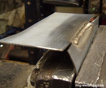

So How Strong is MIG Brazing?
It certainly took a lot of effort to bend it backwards and forwards in the vice. After bending it backwards and forwards a few times I thought I'd film the fatigue test. It took a further 22 cycles to break the brazed joint, and even then it was the steel that broke not the joint.
I was very impressed. Here's the video of the fatigue test for those with a high boredom threshold.
The fatigue test
Results of the Fatigue Test
When the joint finally broke it was the steel rather than the braze that had failed. Suggests the brazed joint is at least as strong as the parent metal. That really impressed me, as I've read that brazed joints aren't as strong as welded joints.
Kind of gets irrelevant when the brazed joint is stronger then the metal you are welding.
Failed brazed weld

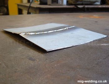

Distortion with Brazing
It is still possible to distort panels when brazing as the photograph shows. Distortion can be minimised by brazing in short runs, and allowing the metal to cool between runs. But using an ordinary MIG there doesn't seem to be any advantage over normal welding.
Braze distortion
Advantages of brazing might include welding of dissimilar metals. Because the two sheets of metal aren't melted together it doesn't really matter if they are the same type of metal so long as the melting point is above about 950C. Most metals will melt at a higher temperature than bronze. It's even possible to braze galvanised steel without removing the galvanising (although this still needs to be done outdoors or with an extractor).
Brazing is not a technique I would use in place of an ordinary weld (without the appropriate equipment and training), though it has hobby uses for joining other materials.
