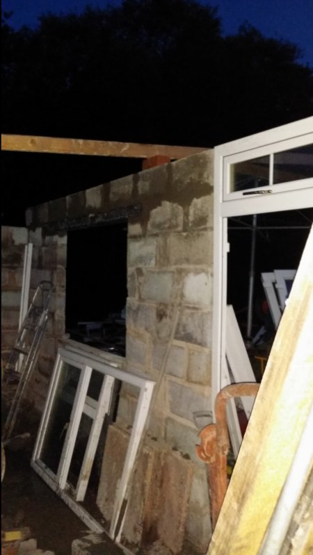

Well you'd get bored if all you were doing was block work mateWell the bdd news is that is "wet" all day so the bolts will get a bit of time. Shed put on hld until tommorow. Hope to get a lot more packed today depending on my injury...

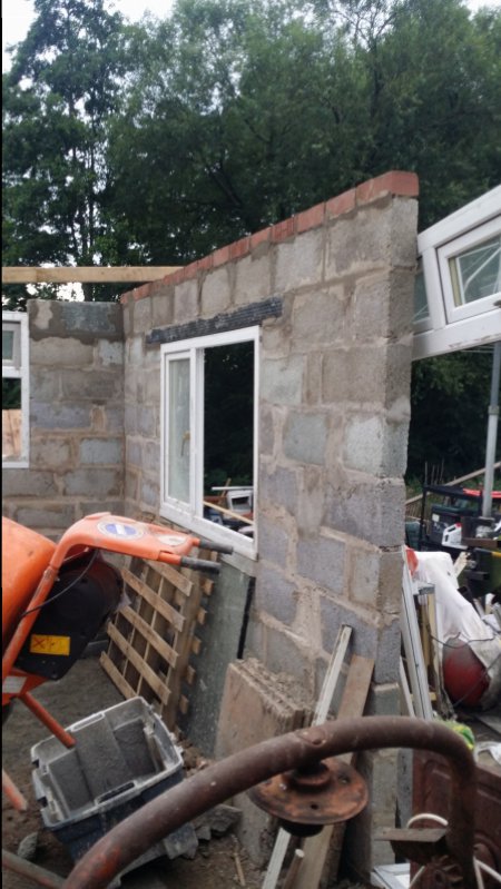

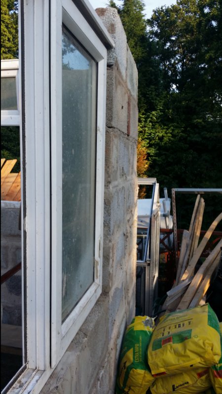

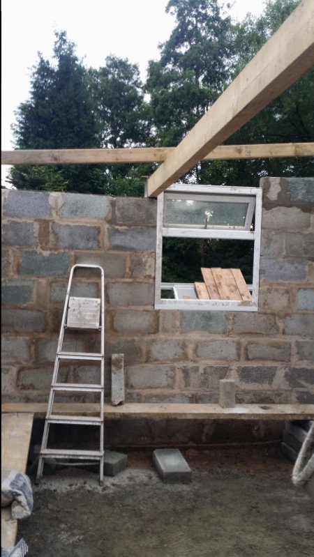

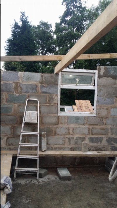

Who me?hope your sitting that window onto a sill..not iff but when water gets into the frame moulding its designed to run through weep holes into the sill then exit away from the building

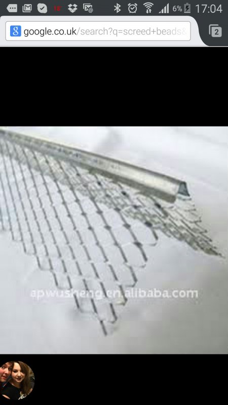

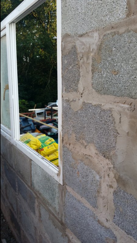

Looking on you tube on how to fix it in place and how to render. Lolcorner bead search for plasters corner mesh and loads comes up
