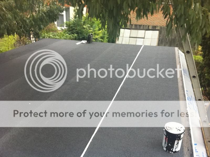

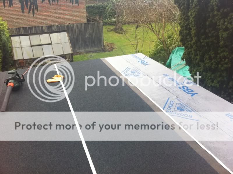

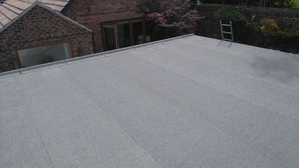

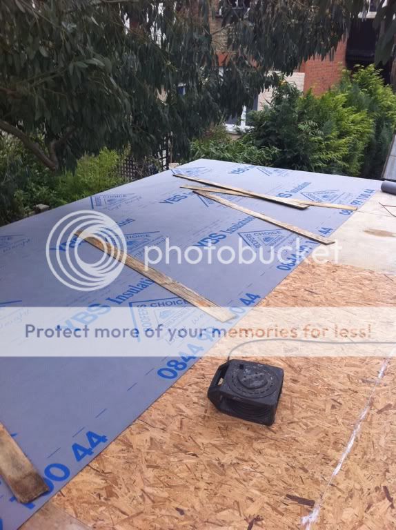

Sorry spotmix is a local to me company but any on site mixing is the same,only pay for what goes in the hole and they have lads to barrow it for you.DONT use Debotec iff you can help it as its crap and does not have the full SBS modified bitumen on it.Try and find a Rose roofing suppler and get the Rose Modi torch on either the modi 4mm plain (sand finnished) or the Modi mineral surfaced 4mm torch on...Its far better stuff to work with and sticks like s$$t to a blanket. Burn the plywood (18mm) 1st till its brown all over as this gets rid of the factory resins on top and acts as a primer.It should be a 2 layer system really but iff moneys tight then you could always overlay again in the future with another layerOk chaps not far away now. sadly being slowed down by an injury to an intercostal muscle but rain now looks imminent for the rest of the week after Tuesday so I might be forced to rest it!

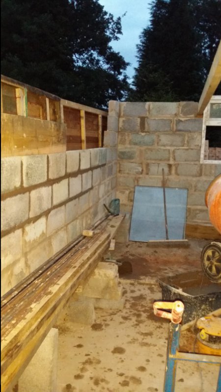

Anyway. Who are these spot mix boys I cant see anyone listed locally to kidderminster.
Second I was hoping to use Kingspan(TYPE) insulated corrugated sheet for the roof, but as I have not recovered all the money out-laid for the bolts and my sons signs for his house before the end of AUgust, money is now very tight. Second hand roof panels seem not existentView attachment 69585 so I am looking at felt for the time being. I had some really thick DEBOTEC on the old shed and have been looking to see how much that is but I cant see it other than supply and fit only.
Looking for suggestions if any one has any please??
