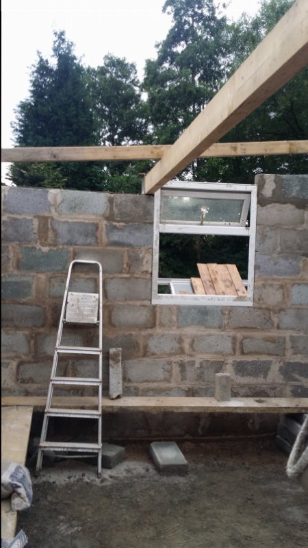

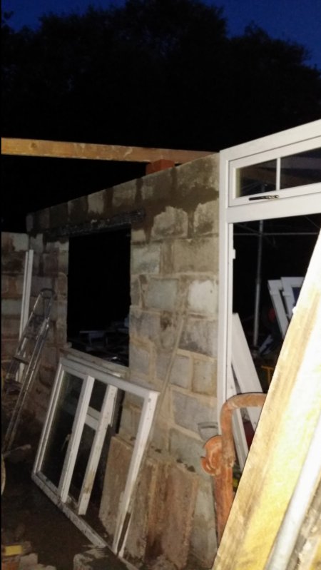

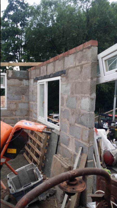

You really need to stagger the joints in the block work better, a building inspector would have a fit if he saw some of those joints, it makes a really weak wall, especially if it's a single skin.
No mate that's it finished .other than filling in the angle of the end wall to follow the rafters.I didn't know how high he was going with it or if he had much block work left to do.
I thought about a pillar but can't see how that's any more stable. I have used wire ties and tied it in to the garage. What could I do now it's built to make it more stable.you should have built a pillar (flat block) were the block work finnishes at the door and tied it in... and every 10ft thereafter...sorry to be nit picking but slam the door and the lots going to fall in..You also need a timber wall plate for the joists to sit on so they can be fixed at the bottom (4x2) along the full length of the wall. Apart from a few details its coming along![]()
believe me the foot print of the block flat is enough for a pillar in conjuction with the wall..can still be added by fixing a "starter plate" (google it) and tie the blocks into that or get some brick ties that screw into the wall via a 8mm plug...also the wall plate does,nt get screwed,it sits on a mortar bed and this enables you to level it up tooI thought about a pillar but can't see how that's any more stable. I have used wire ties and tied it in to the garage. What could I do now it's built to make it more stable.

How do I secure the wall plate then using these and how do I secure the joists/rafters with these?believe me the foot print of the block flat is enough for a pillar in conjuction with the wall..can still be added by fixing a "starter plate" (google it) and tie the blocks into that or get some brick ties that screw into the wall via a 8mm plug...also the wall plate does,nt get screwed,it sits on a mortar bed and this enables you to level it up too![]()

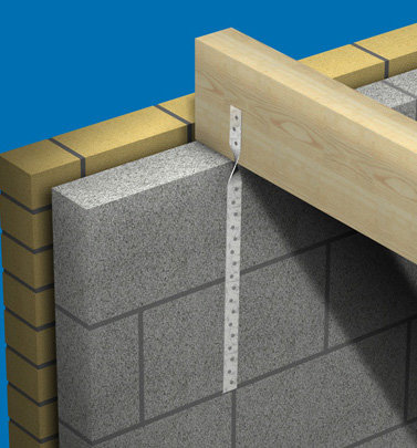

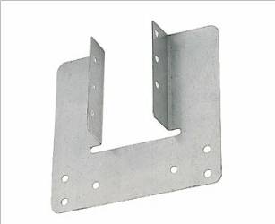

Use these on the roof plate (roof plate straps):How do I secure the wall plate then using these and how do I secure the joists/rafters with these? View attachment 70050 View attachment 70051
I knew about the mortar bed. Even though the wall is level.believe me the foot print of the block flat is enough for a pillar in conjuction with the wall..can still be added by fixing a "starter plate" (google it) and tie the blocks into that or get some brick ties that screw into the wall via a 8mm plug...also the wall plate does,nt get screwed,it sits on a mortar bed and this enables you to level it up too![]()
Ah I posted the wrong pic...lol it was supposed to be like that wall strap you posted but plain with no wings on it. Do I just fill the gaps with noggins between joists using skew driven nails?Use these on the roof plate (roof plate straps):
Use the lower holes on the truss bracket to attach it to the inside vertical face of the roof plate with the two wings sticking up, the truss or rafter sits on the roof plate inside the wings.
You use 30mm x 3.75mm twist nails for the truss brackets and you use every hole (not one nail in each face as I have seen before!).
Just to clarify you do mean every hole and not one nail per block of three holes??Use these on the roof plate (roof plate straps):
I have found these View attachment 70105 so perhaps I have been misunderstanding the advice. I can use these for the joists and some standard wall straps for the wall plates......I Ssume![]()
