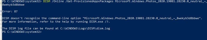

yep ironically just running that DISm but only from admin not elevated. Microsoft photo is not on my computer any longer for some reason!Have you tried DISM in Powershell? Would need to be an elevated (admin) powershell due to the nature of the command, summat like
DISM /Get-ProvisionedAppxPackages
Do a help for the full syntax but you want to list whats installed, possibly remove the package if it’s there, reinstall or just provision if it’s not there.

well I found it and ran it and checked around a few strings but it does not seem to be working!Have you tried DISM in Powershell? Would need to be an elevated (admin) powershell due to the nature of the command, summat like
Interestingly I was on 1909 version of windows 10 and it should be fine but others have had this.

The pipe character is when you want to list the packages that are installed. When you refer to a specific package for install or removal you precede the package name with a forward slash.
Hafve a look at this article which explains a bit more about how to remove all teh bloatware. It sort of explains DISM better than I can.
https://www.makeuseof.com/tag/easily-remove-bloatware-windows-10/
