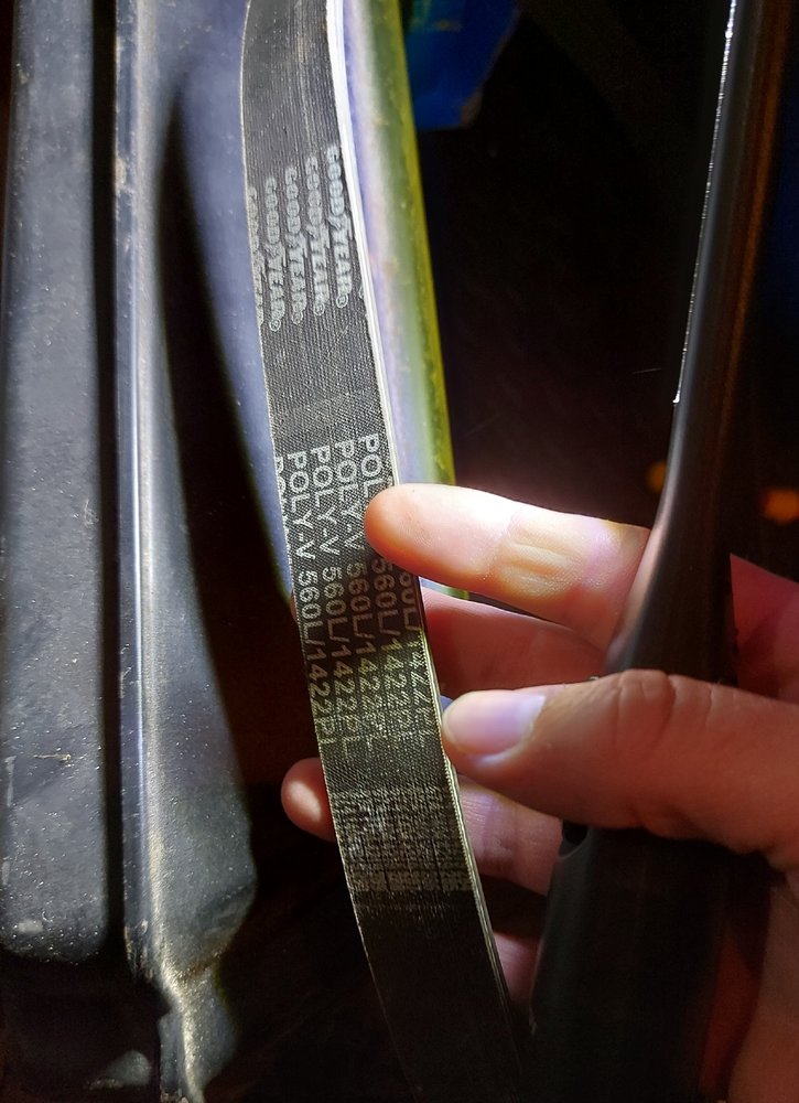

Seriously, as others have said, check the runout/play in the spindle before deciding which to keep, other than that the SIP would be the better of the 2. The only downside of using the VFD for speed control is that you lose torque at low speeds. If they had kept the stepped pulleys you would still have the ability to use them for coarse speed setting but by fitting a single pulley you are limiting the usable speed range of the drill.

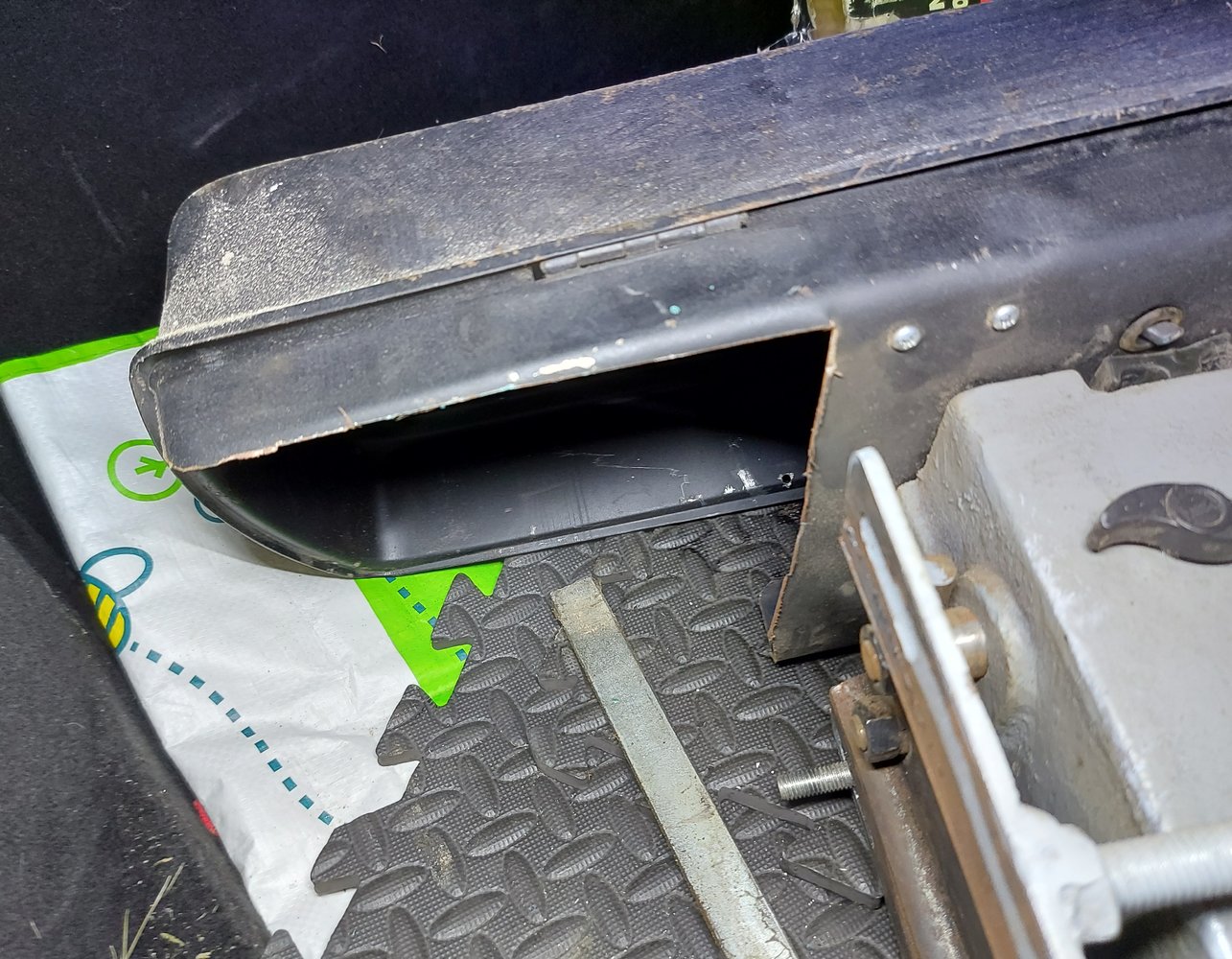

Sounds good ...but didn't realise it doesn't have stepped pulleys? Could they be re-fitted? Is there a pic of the entire machine or have I missed it? Seen the one looking down, but not with pulley cover up.Yes it's got the wind up handle for the table. The table is quite large actually. Probably 2 foot square something like that.

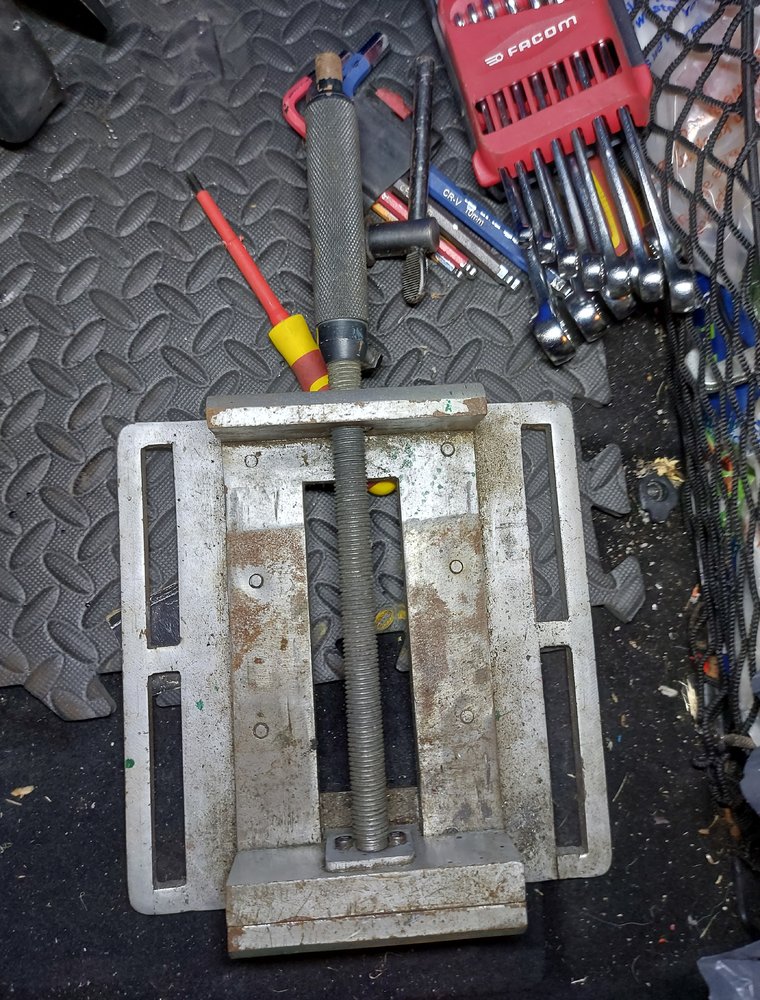

It came with a large drill vice too. When I looked at it again I realise it's home made. But still decent I will keep it with this drill. It's heavy made out of 10mm steel.

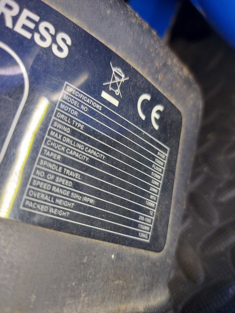

Interesting that it mentions 50hz. That is what the inverter is set up as max.
