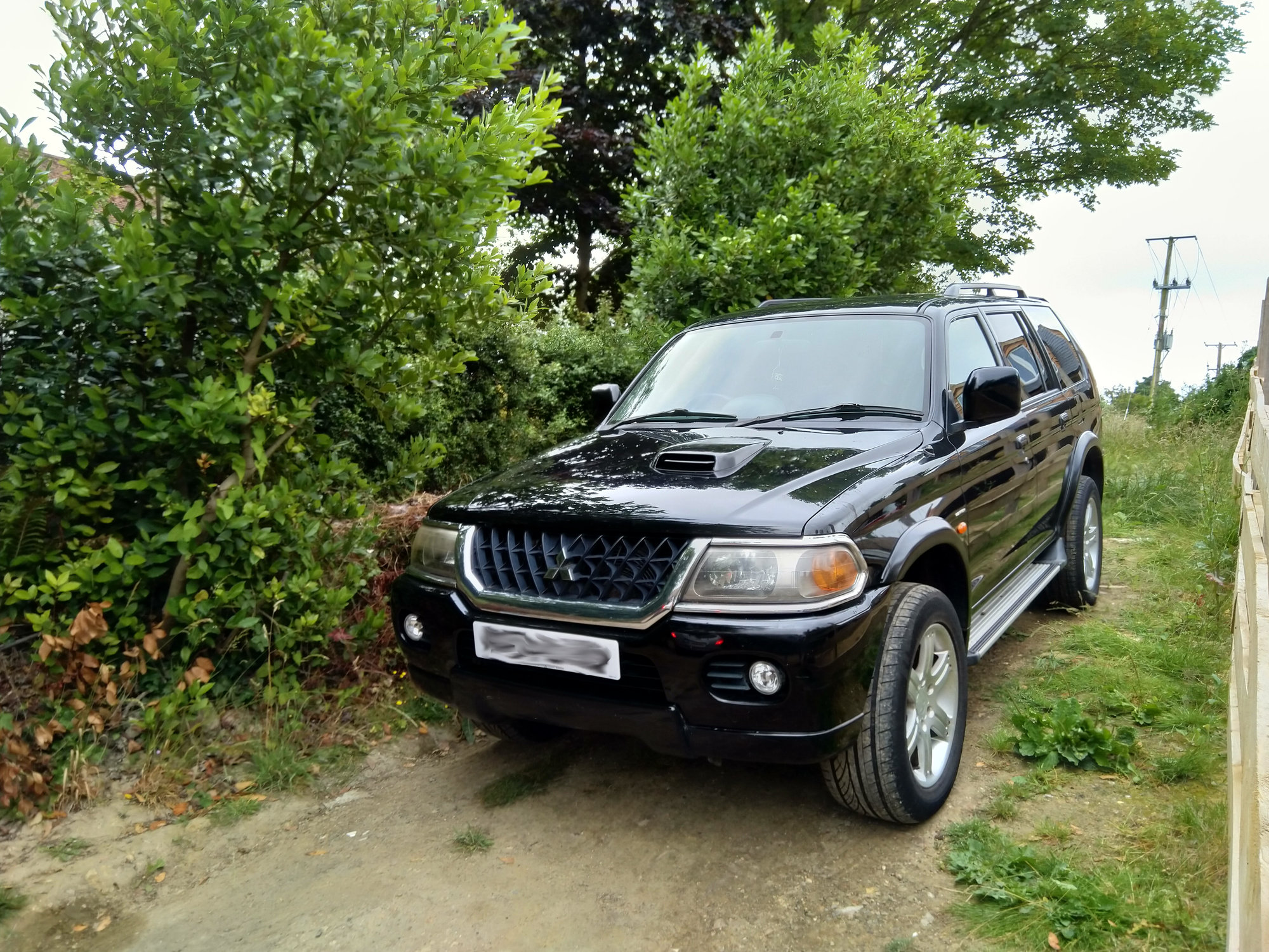

So I bought it <£500 and in great condition - book price 1.9 -2.7K, if nothing else I can fix the head gasket (or the head) - assuming that the diagnosis is correct and sell it after I have used it for a couple of months. From what I can gather the HG (sometimes) and head (usually) are prone to failure following any sort of overheat, it has a new rad and t.stat on it but the whole cooling system will need careful checking as I don't want to do the HG/H twice!
The chassis of 2725mm is exactly the same as the 2nd Gen Pajero/Shogun LWB chassis of 2725mm - so in terms of a donor for a prototype it fits the bill - especially as it is a top spec model (leather etc) so has lots of nice parts to break and sell - and quite a few apparently fit the L200. As a bonus it has RWD only, as standard and the intercooler on the top of the engine can be re-located to give a lower bonnet line. The 1st gen motor is 114HP on this car - which as others have mentioned is not enough for it's weight , the 3rd gen 2.5td puts out 178hp not sure of swap potential. I believe it was also available with the 3 or 3.5L V6 petrol
