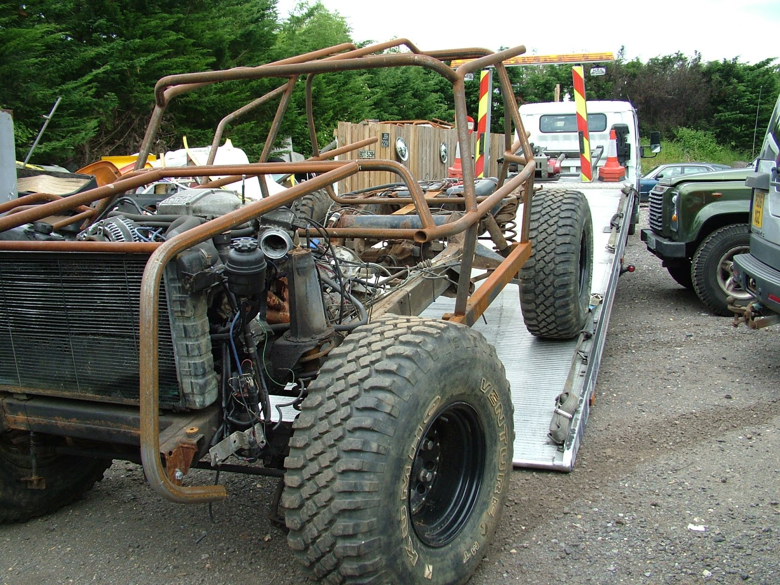

    The early shoguns rot really badly in the chassis
    Honestly you’d be better as a kit build as discos are worth a fortune with low mileage and I mean sub 70k at £5k for a disco 1 keep dreaming if your thinking of a rangie
    As for disco 2 the v8’s suffer with slipped liners due to poor design in the engine bay
    The td5 isn’t built to last in my opinion others no doubtlessly will think I’m incorrect but that’s what opinions are
    Are you over on the mainland soon I’d love to have a beer and chat to you about it
    *edit shogun chassis off google images

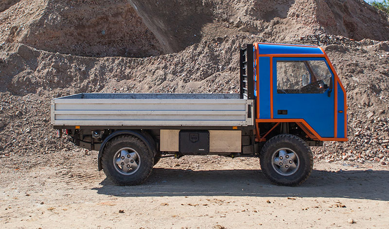

    quite like the idea of a 101 lookalike based on a disco chassis , so many made into campers I reckon in kit form they'd be interesting to a lot of landie fans
  6. owas
    owas Member
    Messages:
    1,848
    Location:
    Birmingham
    24k+vat though
    Edit - just seen it's already been posted :ashamed:

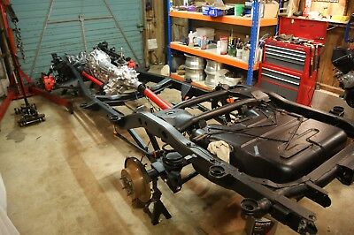

    This has been done with a disco chassis btw, I was condsidering buying the kit for my disco as its a decent price.
    None of the pics on the site are working so I don't think they're available anymore, or maybe they've got a new site, I found it on eBay but it's not on there anymore
    http://www.76175.mrsite.com/Land-Rover-based(2848053).htm
    Edit again - after searching the owner has passed away, and had a terrible reputation for not fulfilling orders, glad I dodged that one ..
