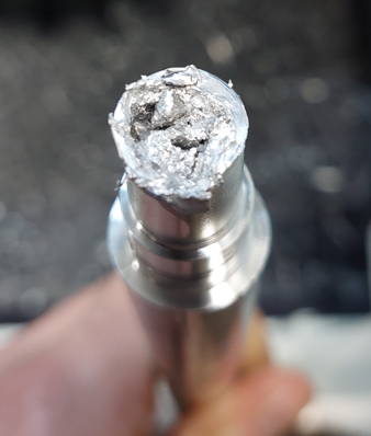

Why wd40? Better off dry imho, in out in out...I cut a solid U shaped round bar door handle up to get a bit of round aluminium bar stock . it cut well on the bi-metallic band saw, popped it in the lathe noticed it was not quite as straight along the length ( 95 mm ) as I'd hoped . Never mind I can turn it round for what I want .
I faced off the end and put a brand new centre point drill in the tailstock chuck , set it to be almost ready to drill , tightened the tail stock , set the lathe going at about 500 rpm slowly advance the drill into the aluminium gavre it a squirt of WD40 eased in in about five mm when " Ping" grrrundle grind etc etc. the drill tip broke in the stock . Stopped the lathe looked at the center drill , it had shattered right fron the tip of the drill point to about 12 mm along the drill body .
This is the second center drill I've ever broken but it wasn't like this one . The first was in a hot forged high tensile steel bolt head .. full of stresses ,
