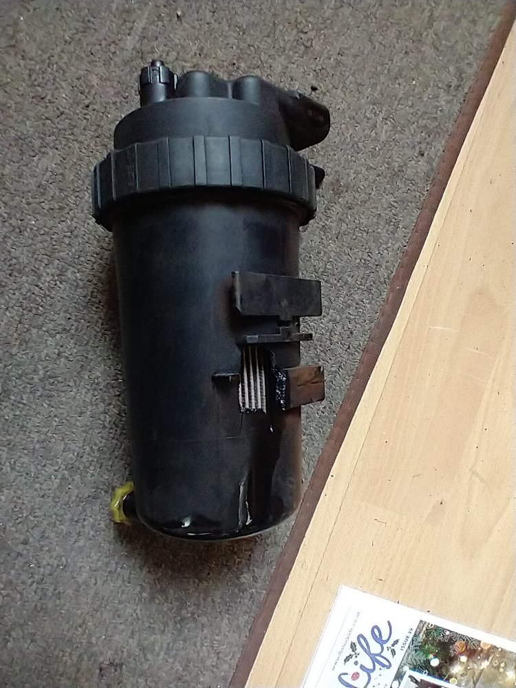

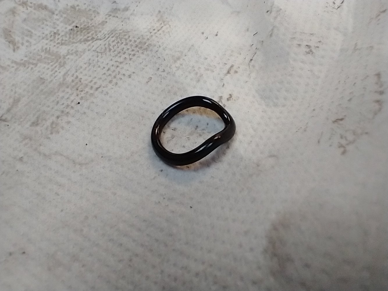

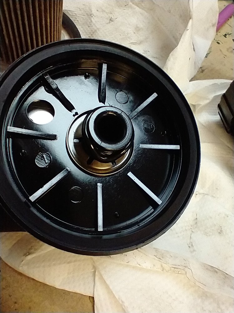

My sister's car was stalling after a long run Ford focus CMAX 1.8TDCI.
Apparently usual cause is a bad oring in the fuel filter. Which had been changed recently had to use a strap wrench to get the top off after the previous person had made it gorilla tight.
Oops
On a brighter note the o ring was toast.
I even have the right sized oring in stock! Now waiting for a second hand filter body from eBay.
No good turn goes unpunished eh?
