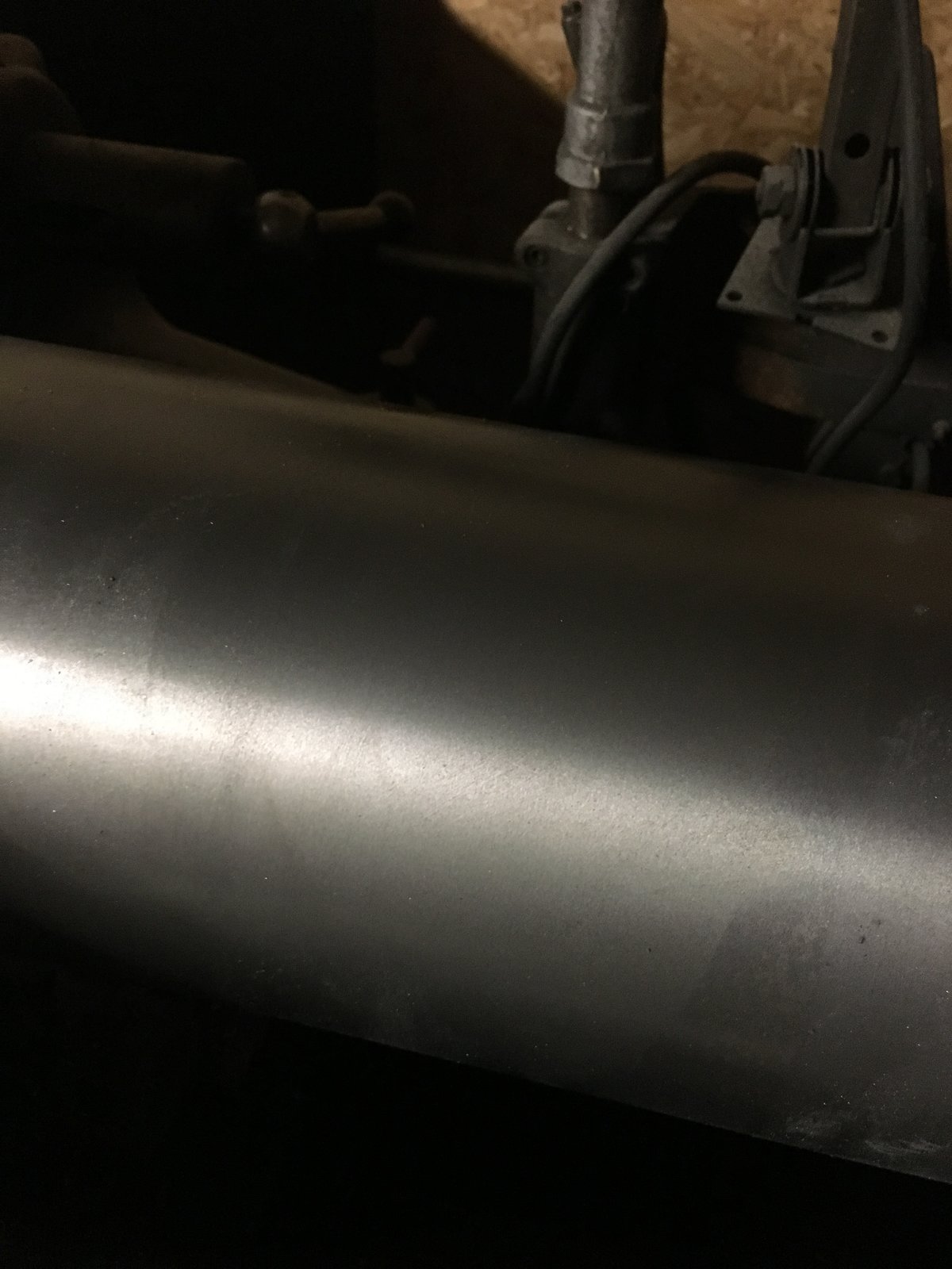

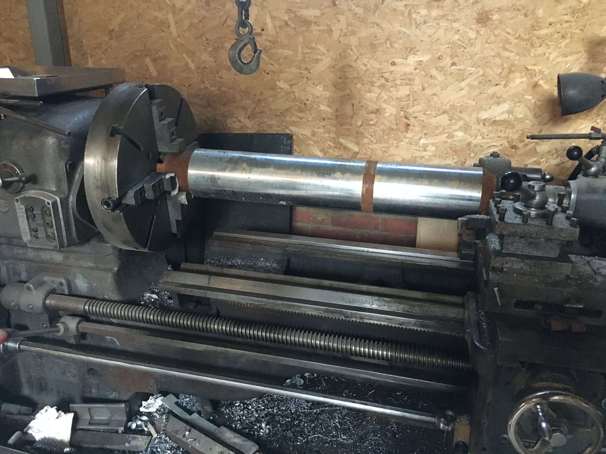

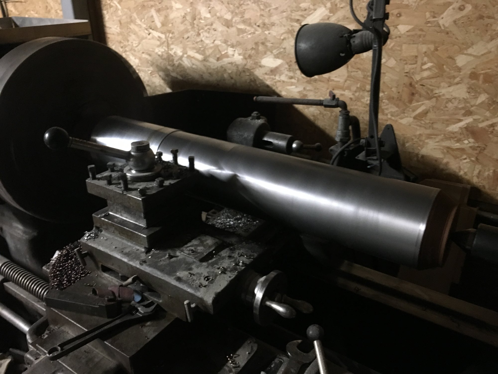

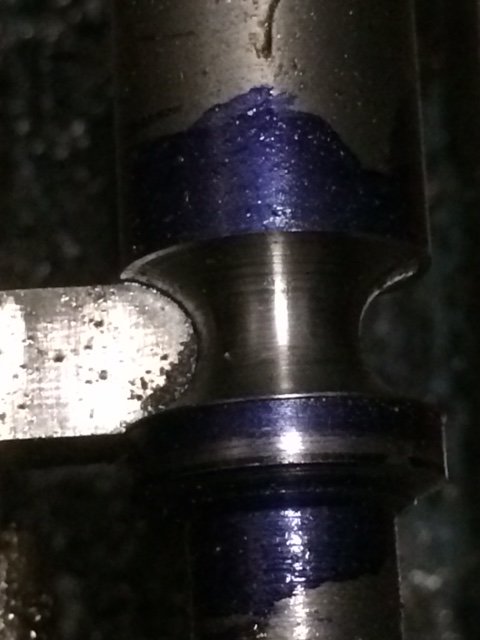

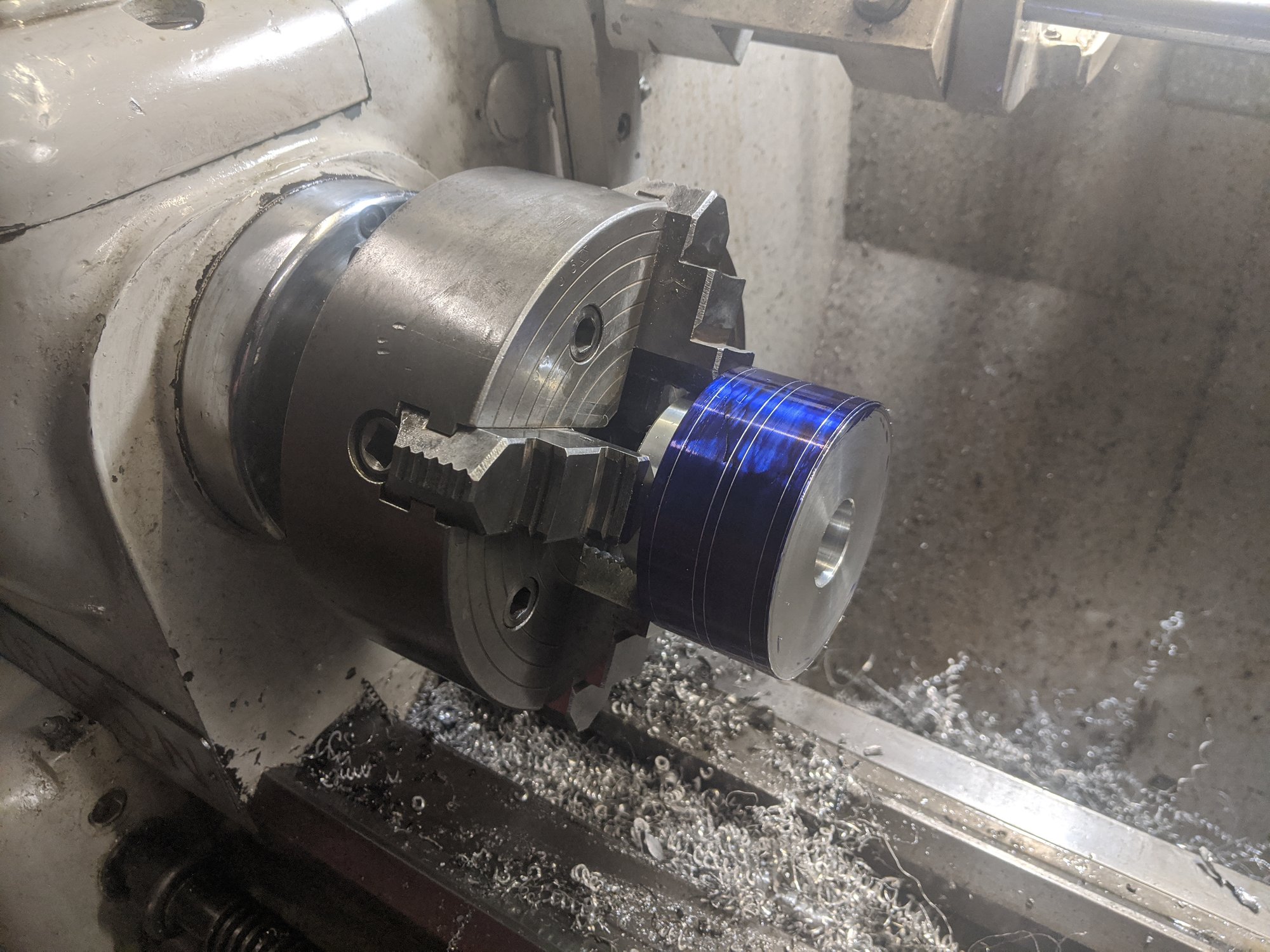

Great finish. HSS?Lump of 200mm chrome round in the dsg being made into something else round..
Machine must be 65 years old and still produces finish close to ground View attachment 229650View attachment 229651View attachment 229652
NoWon't that be more to do with the cutting tools than the age of the machine?![]()
Knux , hss wouldn’t survive chrome.Great finish. HSS?
Big mass and rigidity exceptional design and overall quality equals finish

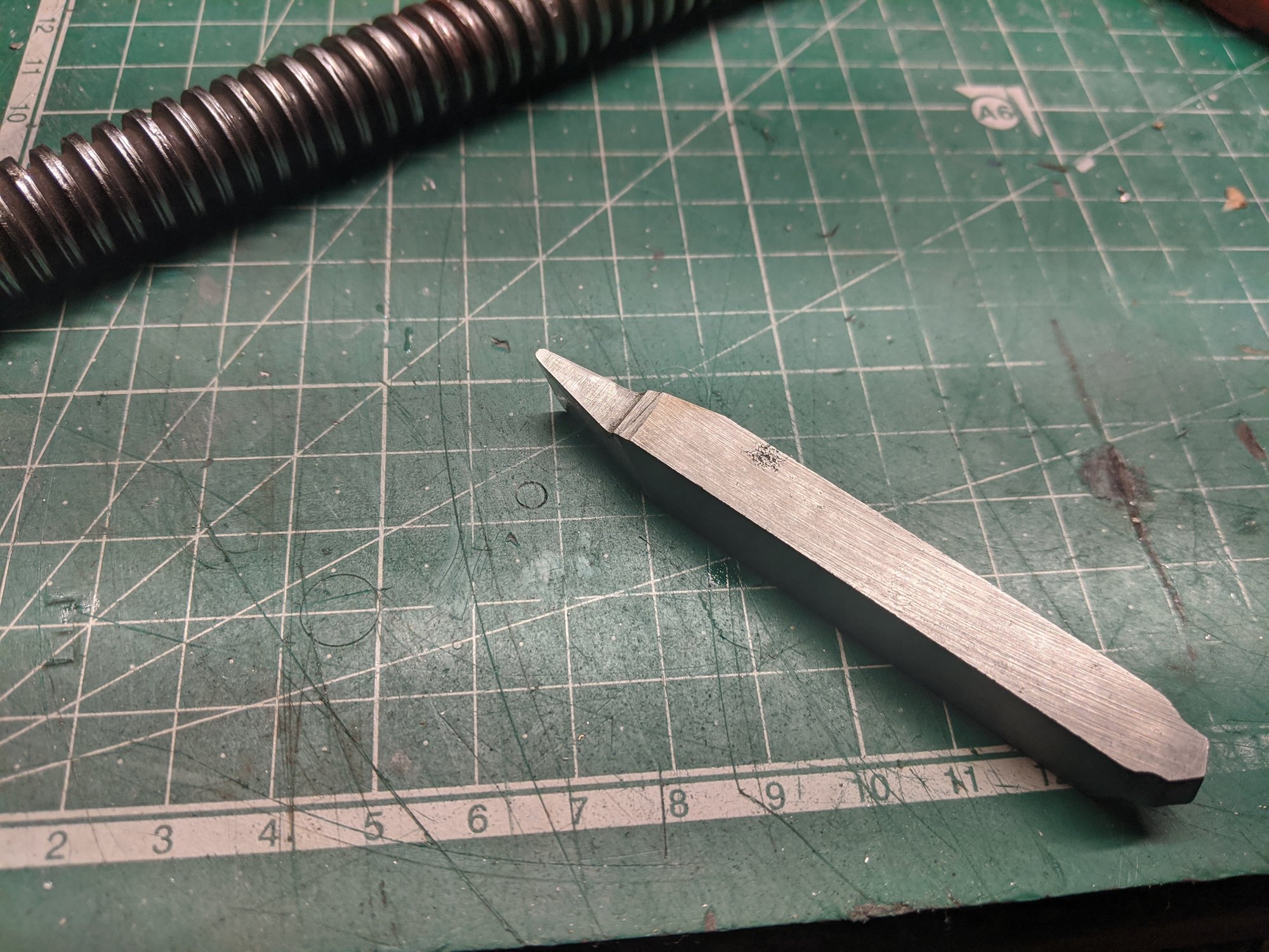

View from the top, dotted lines showing original angle.
Naturally but when you’ve got half a ton of knarly old poop swinging and a damaged used insert and get good finish it takes a good lathe.They definitely help but plenty of people get very nice finishes on tiny little lathes.
Perhaps not on chrome though?
I would imagine so but you could just as easily regrind the tool as is until it just kisses the back edge, assuming that you can accurately set the angle of the grinder you are using.So can you do it the other way with the 3D model? Start with say 5 degrees top rake and a bit of side rake and determine what angle you would need to grind at to achieve a true 60 degrees plan view.
I imagine all the mass of a DSG absorbs a lot of vibration, plus the quality/tightness of the ways and the rigidity all plays a part in a finish like that.Naturally but when you’ve got half a ton of knarly old poop swinging and a damaged used insert and get good finish it takes a good lathe.
I should re state it as ‘ dsg that’s done 65 years of work still gets exceptional finish no matter the material or condition of the tool’![]()
