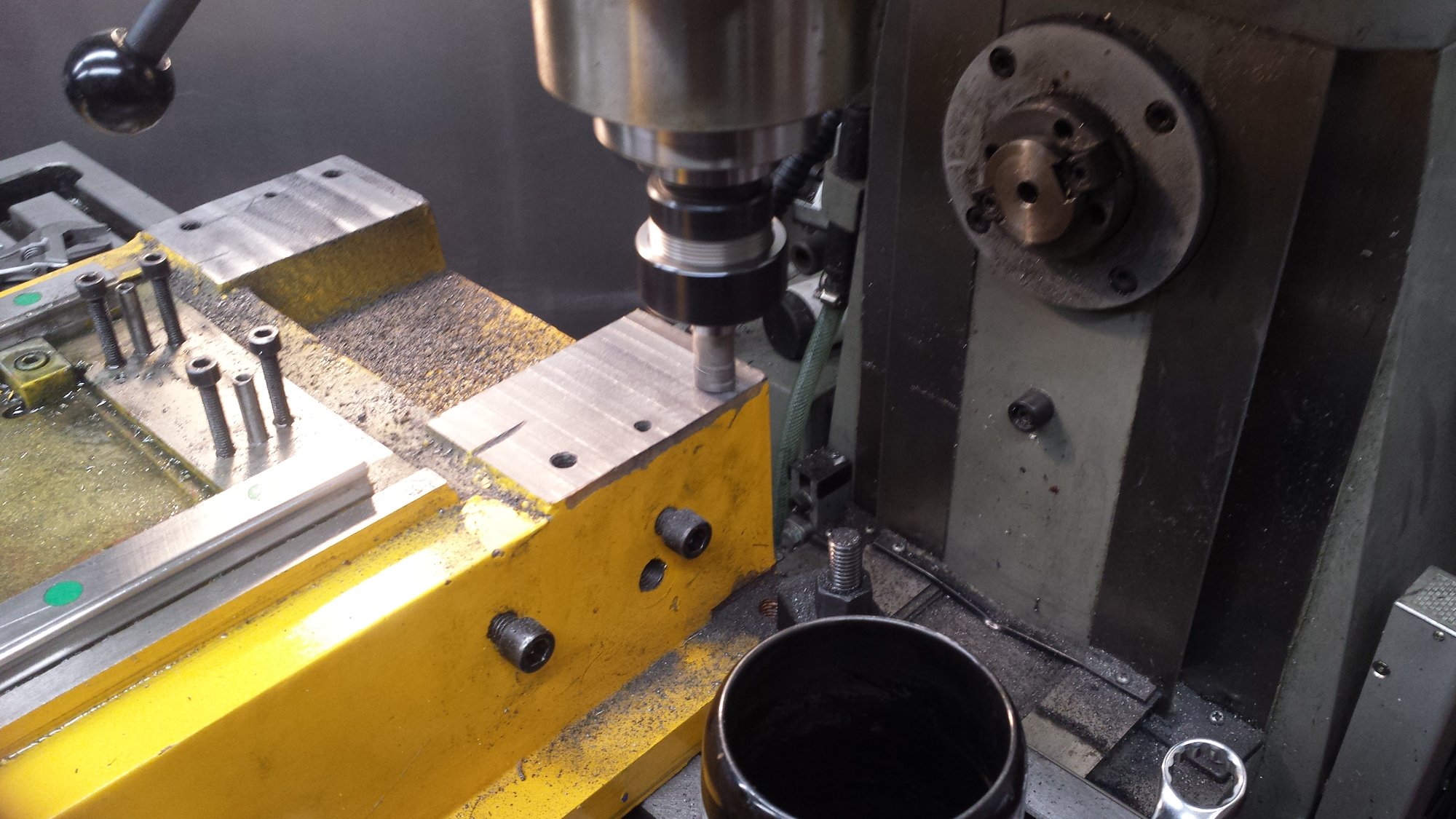

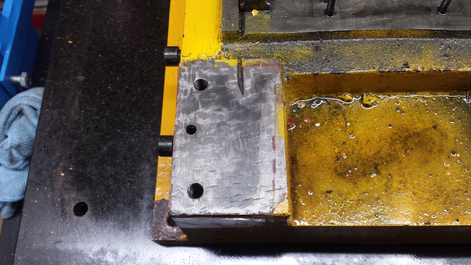

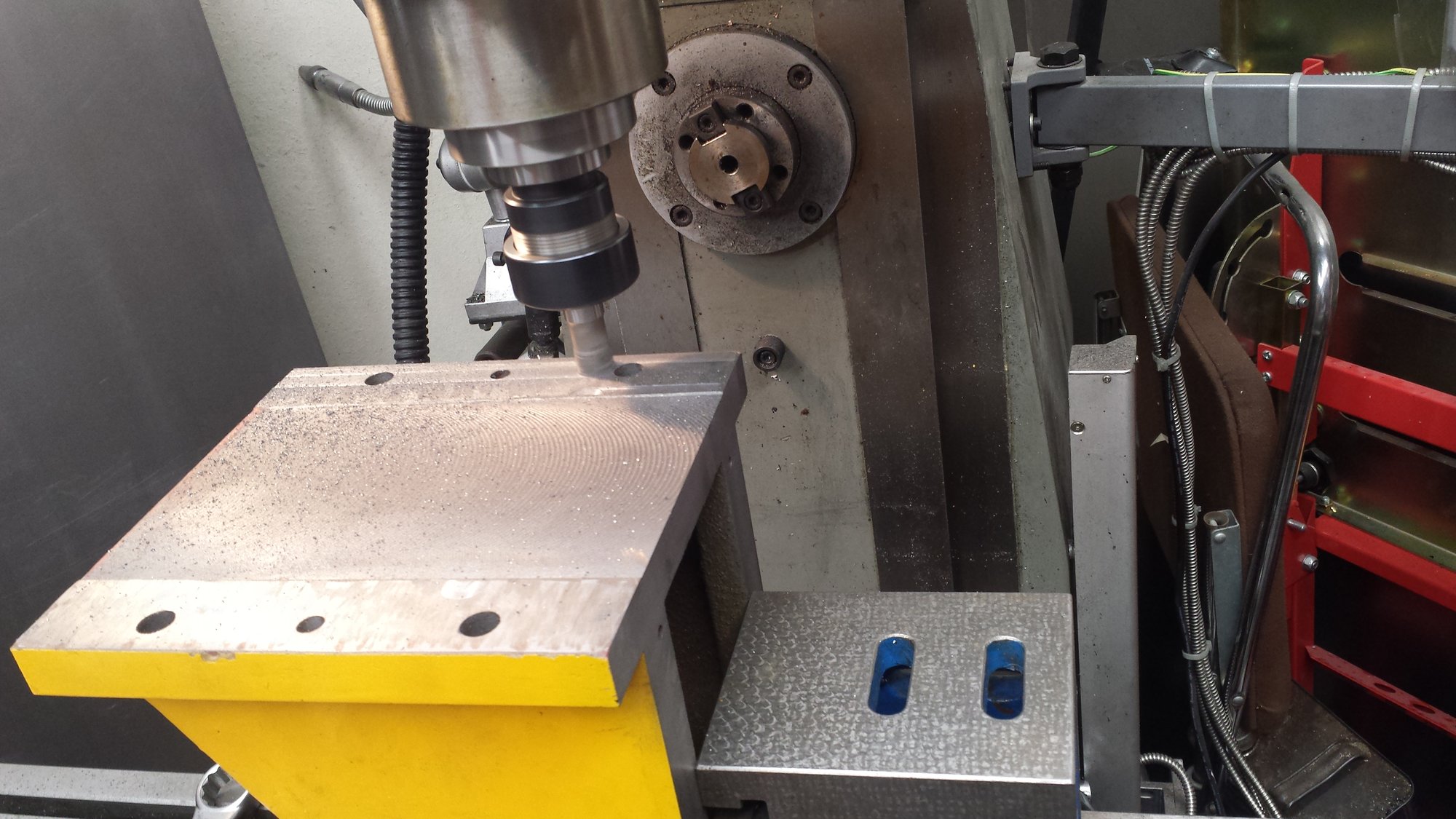

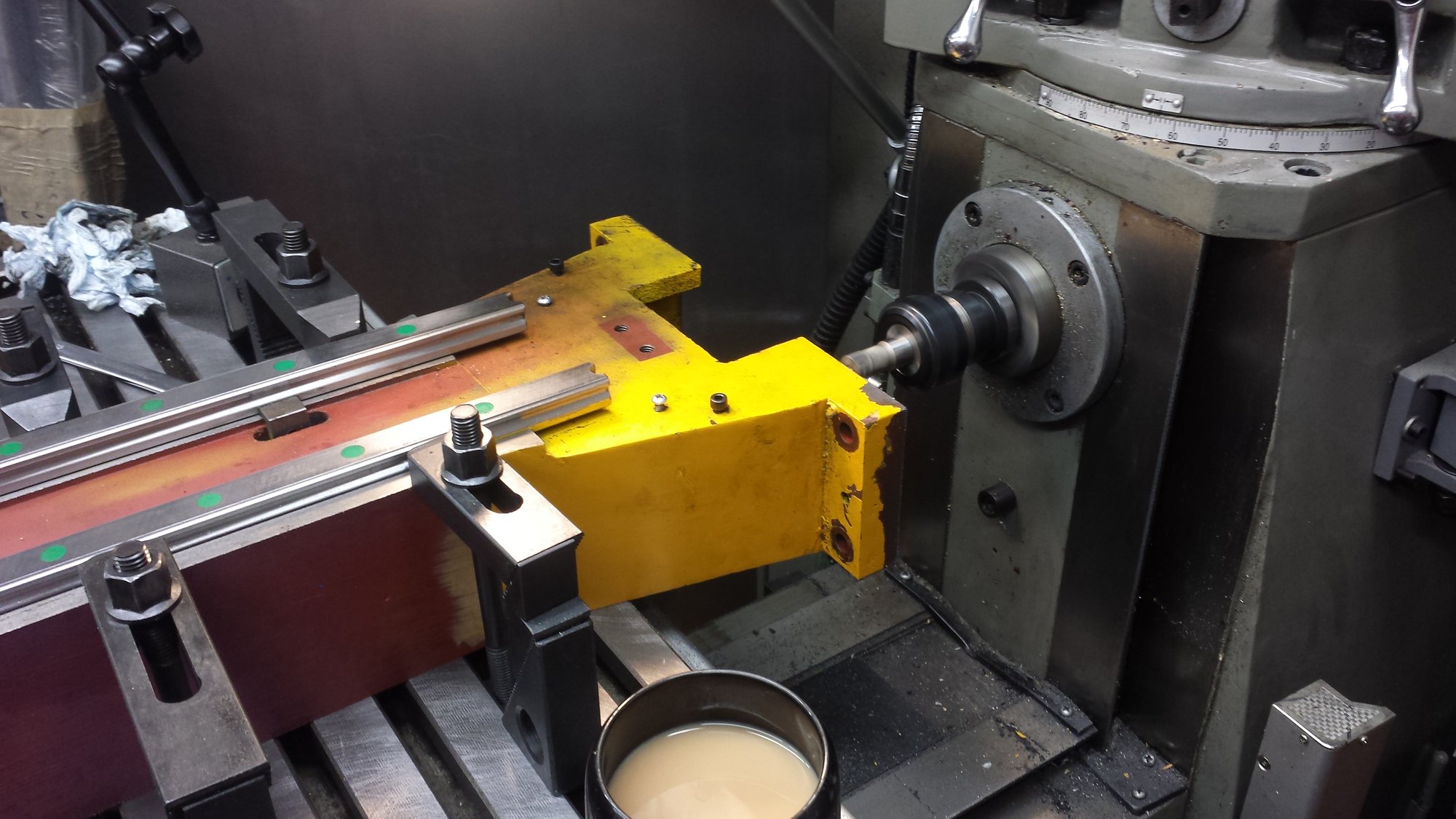

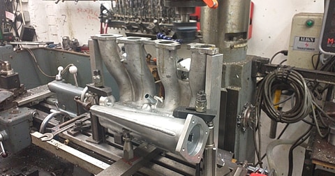

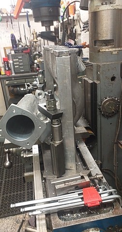

Currently reworking my POS Chinese Syil X5 CNC mill, to correct all the geometric errors.
After measuring the errors in the assembled machine, I set about removing the cosmetic scraping (that appears to have been done with a hammer and chisel, to hide the angle grinder bodging) and correct most of the error by re-machining the faces, in preparation for final alignment scraping.
