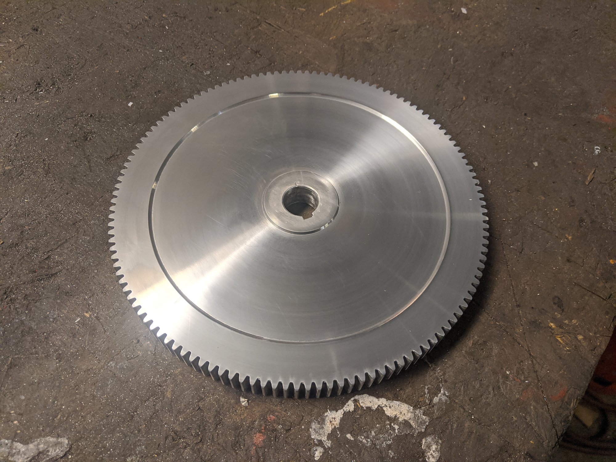

127T gear made again, went perfectly this time.
Still rings like mad, need to start adding sound deadening.
Do you have any pics of the setup? I assume you used a dividing head?
Post #684 shows the setup on the last attempt, yep a dividing head with a compound gear train.
The only changes I made this time were some items to increase rigidity during the cut, the blank was pressed against the chuck jaws and was g-clamped to the chuck also, helped enormously.
Very nice - what size/make dividing head is that?
What are you using the gearing for? I thought that was only for spiral/helical stuff?
It's a 9.5" Victoria, I've got a riser plate to make it 10" though. I paid through the nose for it because it came with all its accessories.
In addition to spiral milling the gearing allows you to divide anything up to about 380 iirc with only the two hole plates. It rotates the plates with the spindle effectively giving you more hole circles. I don't believe there's any other way to do 127T unless you direct index?
Using the centre bush that will hold them cut a couple of teeth plunge in. Creates a perfect tight fit.
You'll have to do it again in delrin
I imagine a couple of face grooves filled with plastic/epoxy/rubber could absorb any ringing?
I self adhesive sound deadening I'm going to try first.
