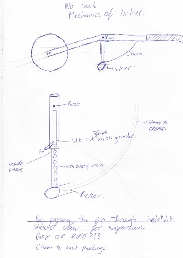

Have you come up with any ideas on how to keep the roller from swaying
How about some form of swinging arms too allow up/down but not side movement ?
No idea where I would get a brush

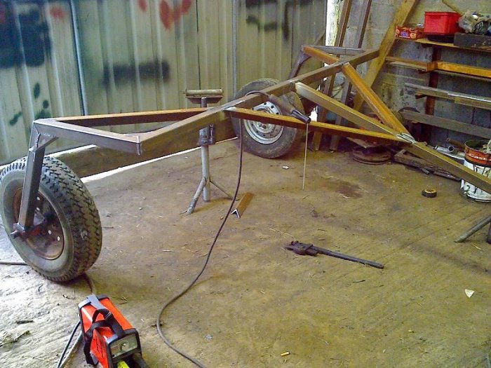

How are you getting on with the lorch, Scarecrow ?
Not sure about the leave spring sparks as the higher up the roller would go the more pressure it will apply but you have given me an idea I have some old dampers which i thing came from the boot of a car which might just do the trick
should be easy enough ?!i like it, im also making one of them scarcrow well its converting one tat is built for the arms of the tractor to one that is suitable to be pulled by the quad. ill have pics up soon till i try an get an idea what im building in my headshould be easy enough ?!
i have got a licker with wickes, not a carpet type one so here is my mechanism, please comment good or bad i want an honest opinion. i never draw stuff i would normall work out my head so forgive my dodgy tech drawing. not to a scale, and is very rough.
I guess it would deppend on the weight of the bar. Even with the method in the pic it can just raise up unless its sprung down.
If raising is that big a problem then use a fixed height one & make the adjustments using an adjustable section in the draw bar.
