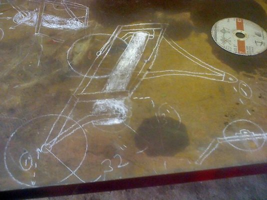

Like the title says I've been tossing this one around in my head for a while and have finally come up with a plan
the shaded area is the roller which will be covered in a carpet and a hood with spray nozzles to spray the roller the biggest problem has been trying to get the roller to spin and also to be able to set it the different heights
I could have used a hydraulic motor but at some stage I might use it behind a quad so I decided to drive it with a belt from the wheels that's why it hinged at the wheels
I think it will work if anybody sees any problems let me know
