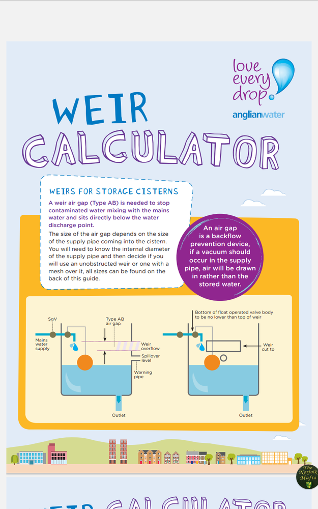

I think it’s the same principle as an eductor - a device usually found on ships that uses the flow of water (usually from a fire main) to pump water out of compartments.The main causes of back syphonage due to a negative pressure in the main is something like a major leak causing the main to act in effect like a syphon or someone Pumping the water from the main. Not normally allowed to pump the water main unless flowrate is very low as a normal water user, I'd need to go check the byelaws to get the flowrate but it's a miniscule flowrate. Ive only ever done it when designing pumping station for water utilities in past. Where that's done there's pressure transducers on the system to ensure it doesn't impact the upstream main. The only other time I know of where you can get a negative pressure in the main is if the fire brigade need to pump water from a hydrant or several hydrants and accidentally pull a negative pressure in the.main.
Thats about right, but the root of the issue is the infrastructure isnt up to the job, poorly maintained and under funded, because share holder Divis are more important…..this wont really change regardless of what hoops farmers etc are forced to jump through!I think it’s the same principle as an eductor - a device usually found on ships that uses the flow of water (usually from a fire main) to pump water out of compartments.
They can shift huge volumes of water, so it’s easy to see how in principle they could easily syphon stuff back into the water main.
I guess even if they wouldn’t be anywhere near as efficient as a properly designed eductor I imagine if the flow paths and conditions were right
How Eductors & Ejectors work - Principle of Operation
Morris Ejector Technologies, Ltd - Venturi Products & Solutions, The principle of how venturi device works, be it an Eductor, Ejector, Heater or Desuperheater, all are based on the Bernoulli theorem and Venturi principle.www.morrisejectors.com

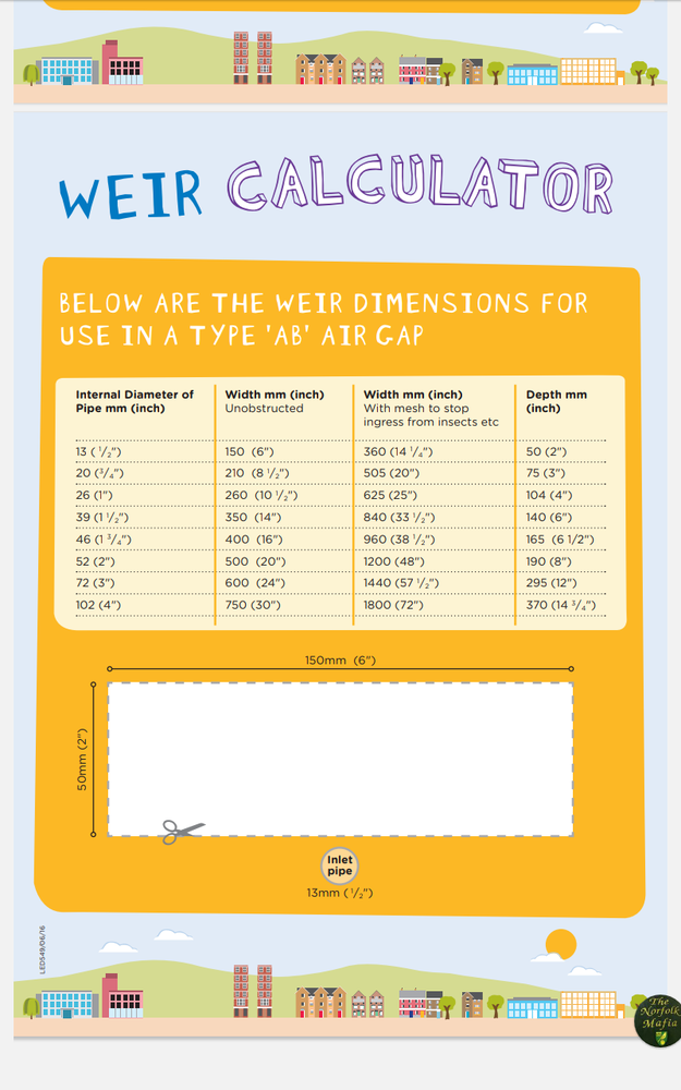

And every tank you fit needs a massive slot cut through the side of it.View attachment 429904View attachment 429905
Outside taps need a double check valve built in or in supply pipe. But they cannot have a hose or even a hose connector unless it's fitted with a DC pipe interrupter.
