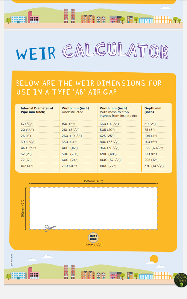

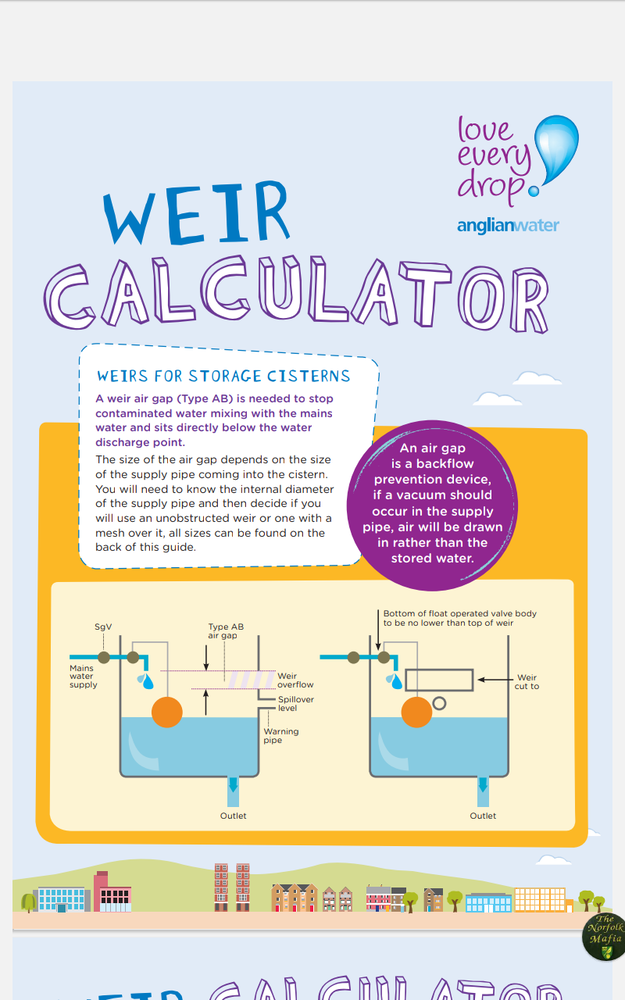

That's the AB airgap weir for fluid category 5, which includes a hosepipe on any non domestic building. It's nuts.And every tank you fit needs a massive slot cut through the side of it.View attachment 429904View attachment 429905

Unfortunately you can only fit a DC interrupter on an open ended pipe.so fit all 3 of them to the washer pipe supply and then your up to the regs

The problem lies with it being a buisiness, and if he's washing overalls that are soaked in cow **** or blood or whatever, do you really want to run the risk of that getting into their water supply?
Same with the hose. If its sat in a puddle of slurry do you really want to run the risk of that being drawn back into the supply if something went wrong?
Whilst the OP may be careful, only wash clean clothes, roll their hose up every night and unplug it, there's plenty of others that might not, and it's impossible to differentiate between the good and the bad.![]()
