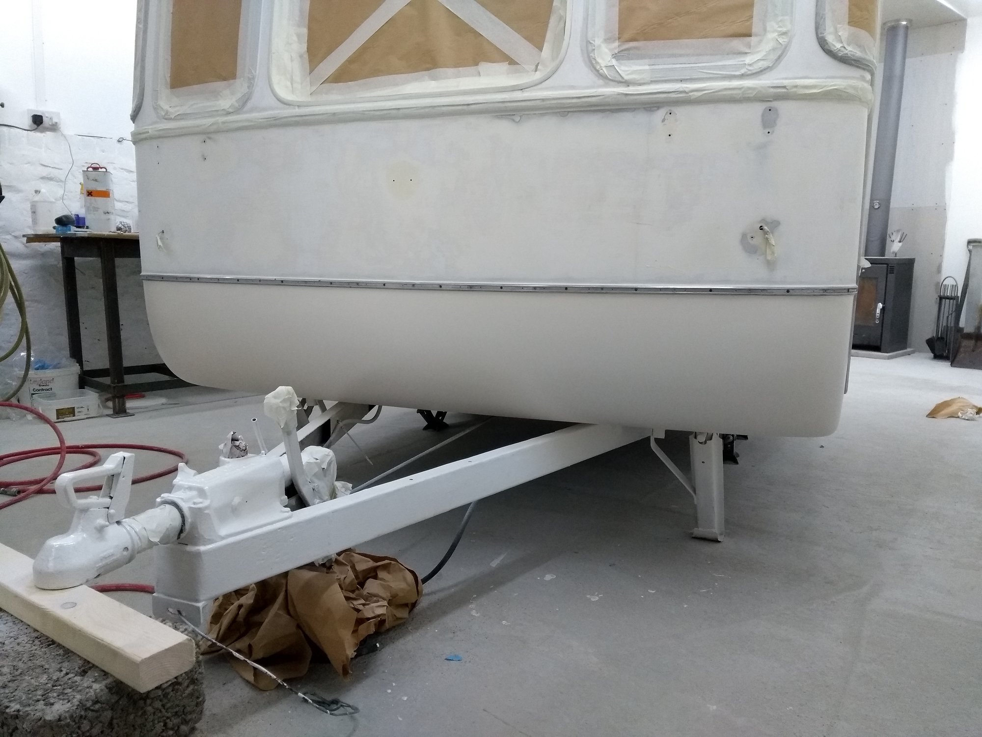

Those peak couplings were notorious for jumping off the towball, I would strip it down and put in a new set of springs, then make a clamp to go round it to keep the coupling head closed while its on the ball.
