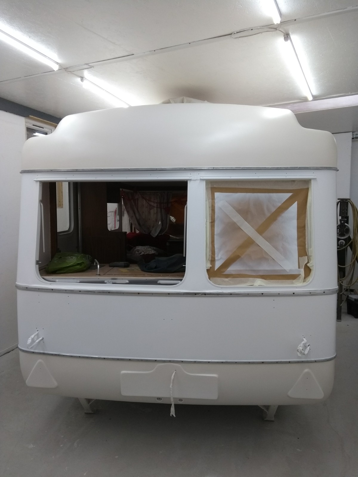

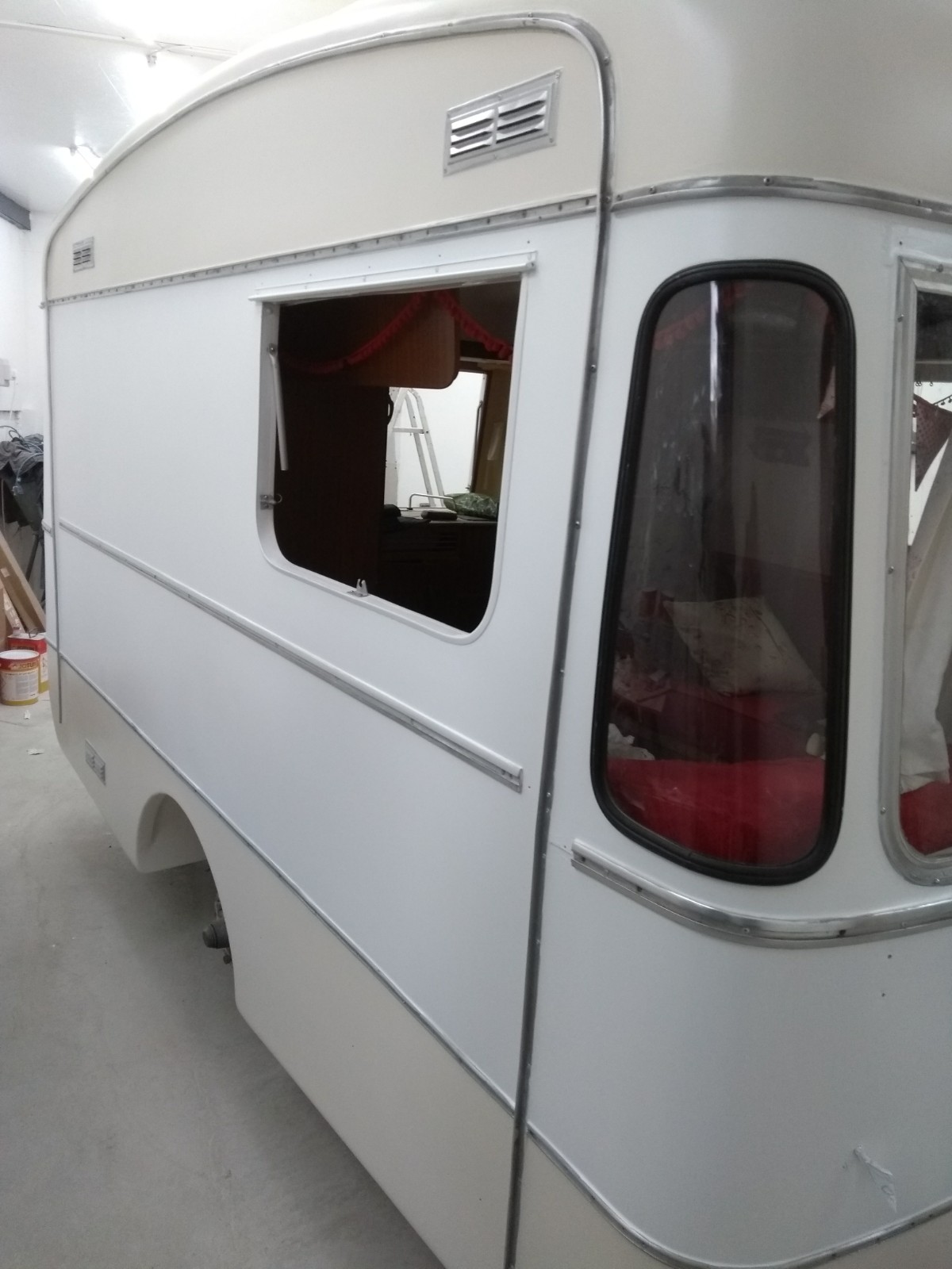

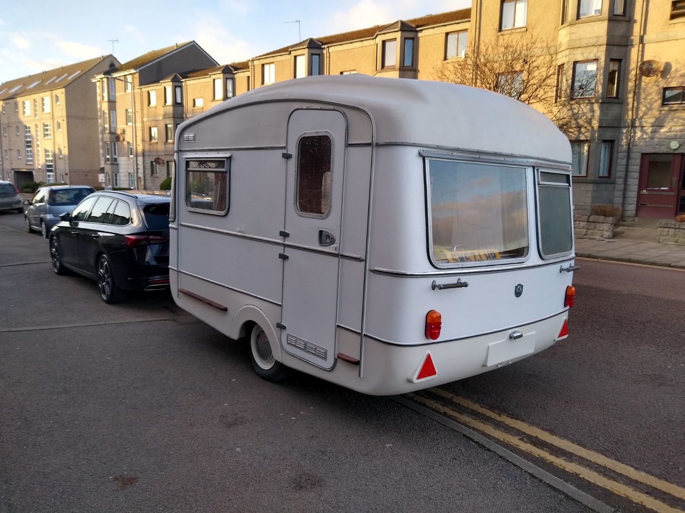

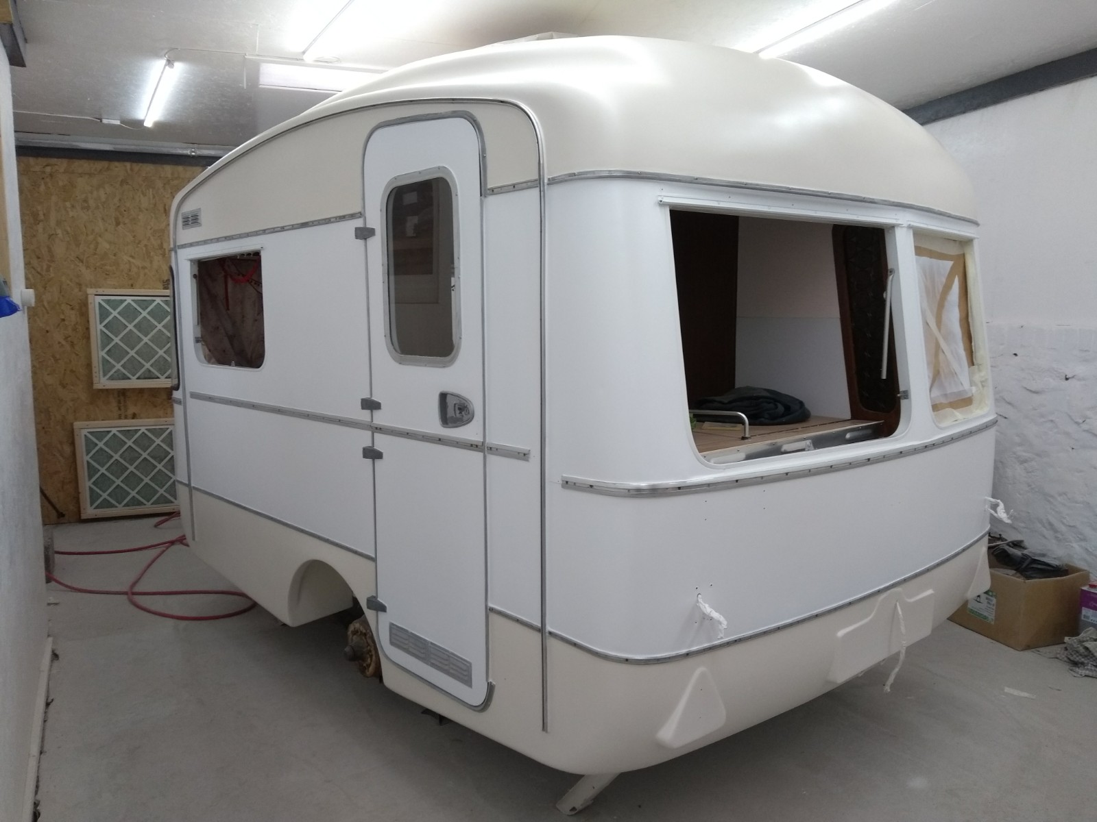

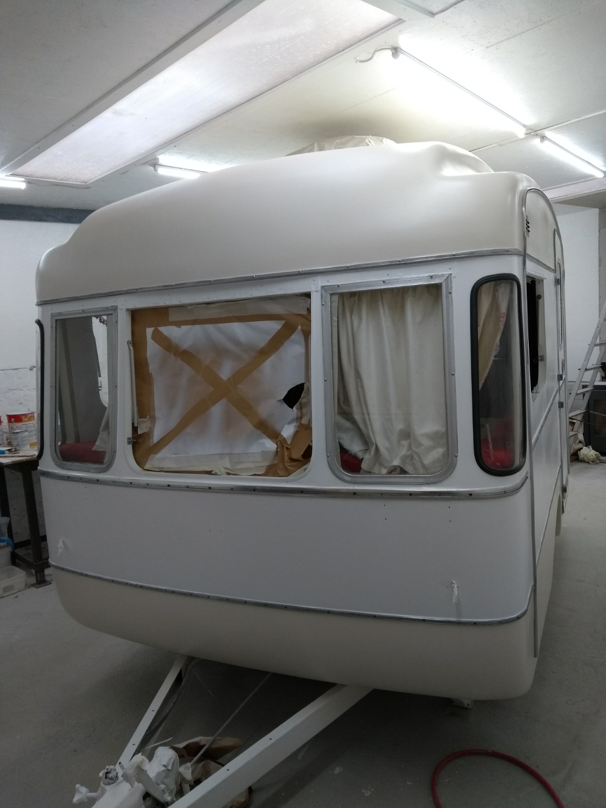

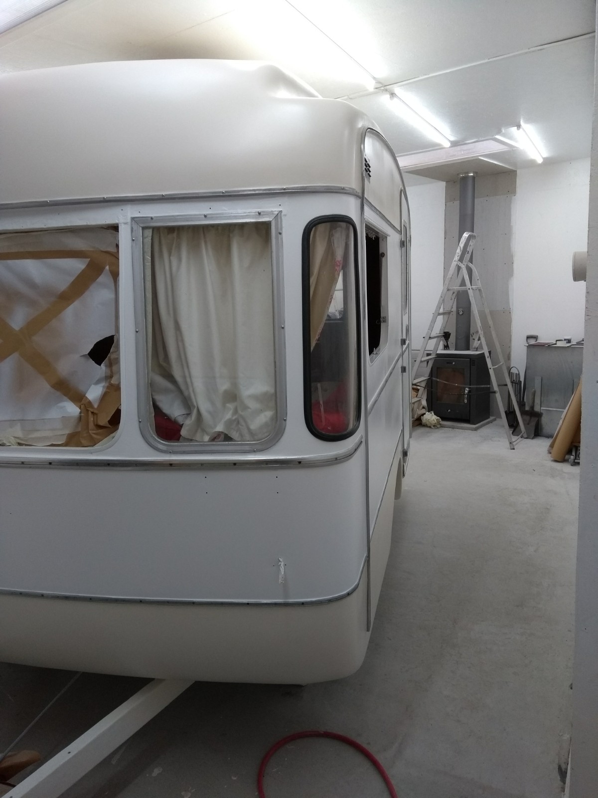

I hate painting, you really have to be a bit of a master at it. You've done a top job there, I would be well chuffed with that.Finished painting the body, came up pretty good. The topcoat used is Jotun HB Hardtop, it’s satin and spray really nicely.
View attachment 169385 View attachment 169386 View attachment 169387 View attachment 169388 View attachment 169389

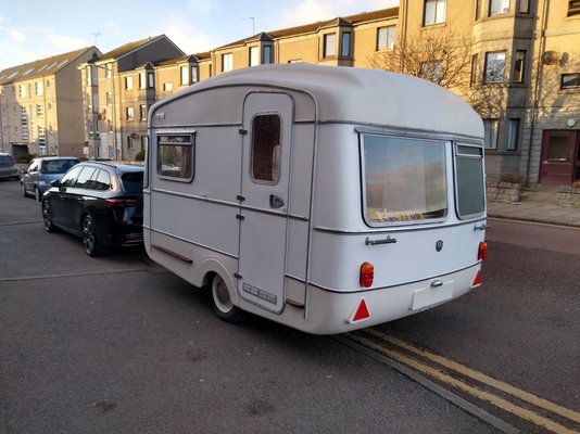

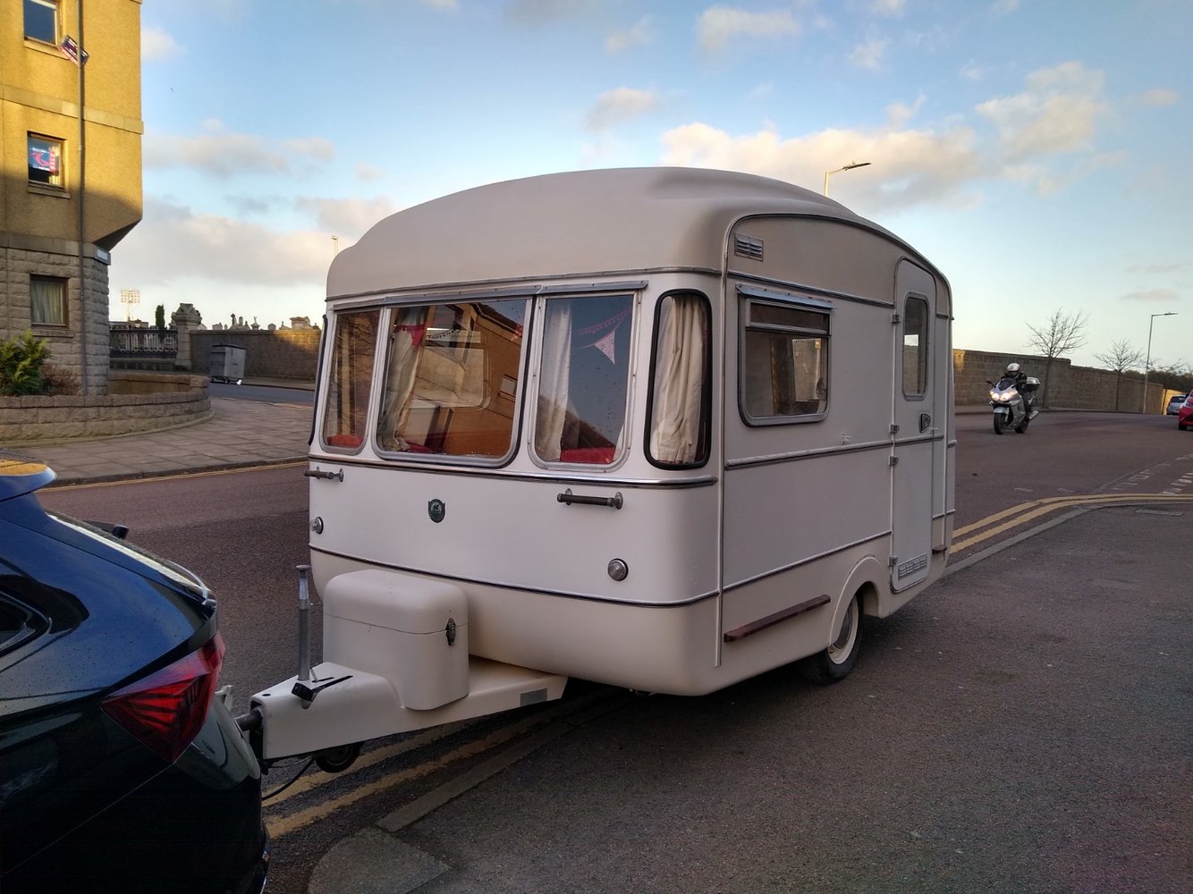

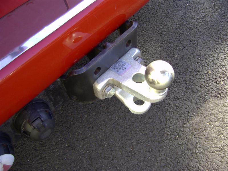

Going back to old posts. Check the towball/hitch size. Old hitches use 2 inch, newer use 50 mm ball. They were the cause of may detachments when 50 mm ball fitted to 2 inch hitch. Especially when they were worn. Your making grand job. will look great once finished.

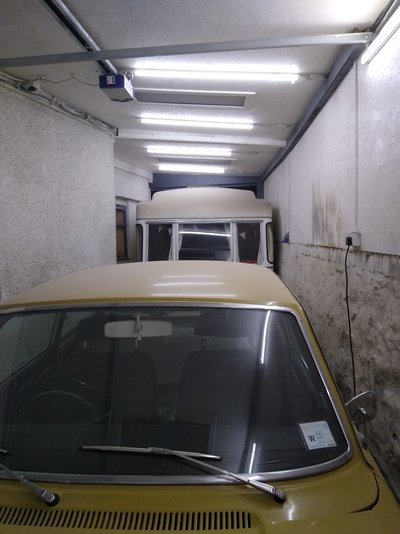

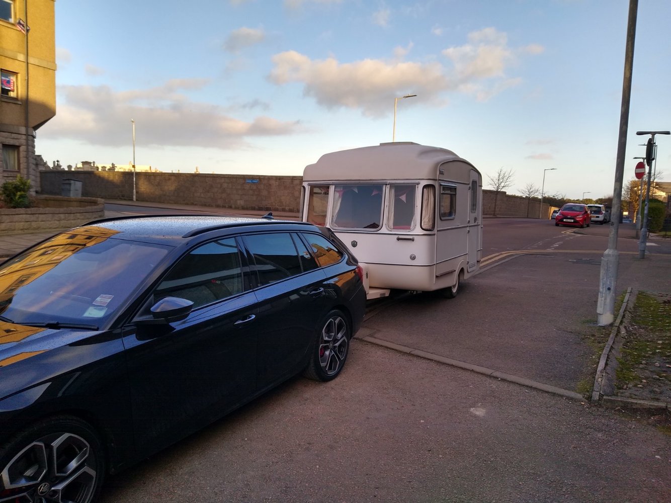

It’s windy but not as bad as it was this morning. Nice in the morning so moving to the storage place first thing.Hope it’s not as windy with you as it is with us. Our sons caravan got blown a couple of yards up our gravel drive, even with the jacks down.

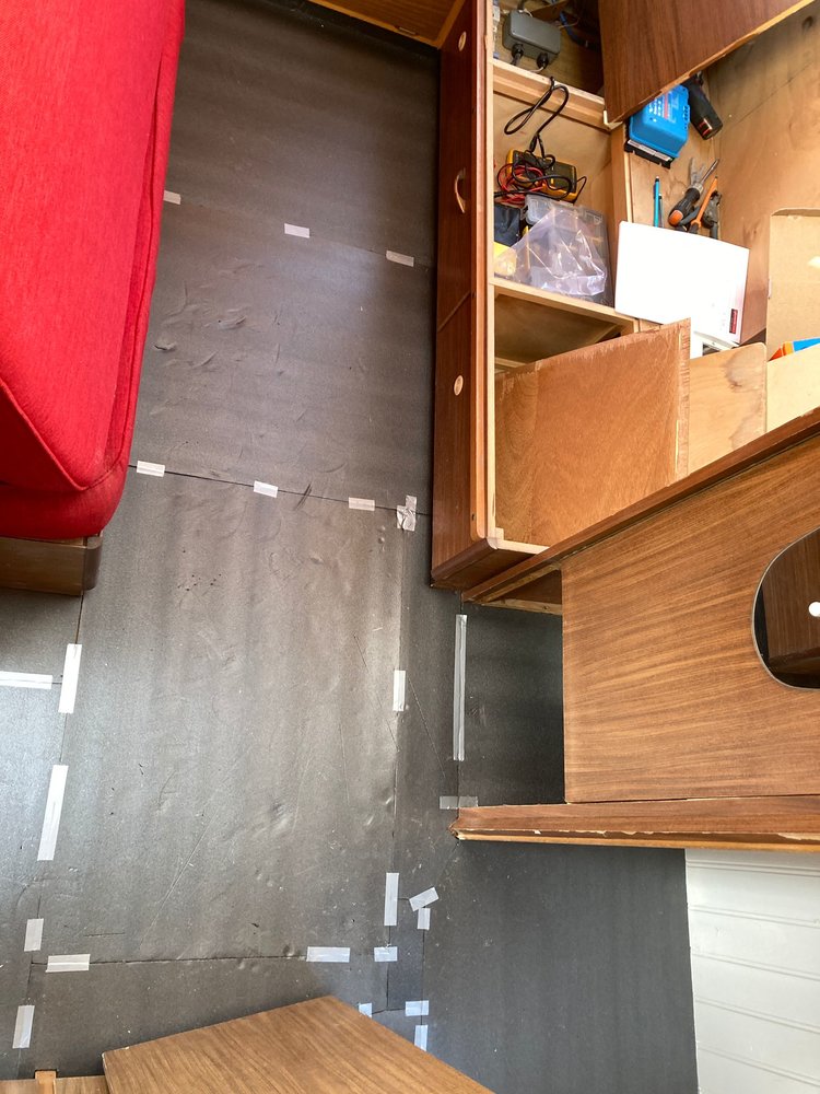

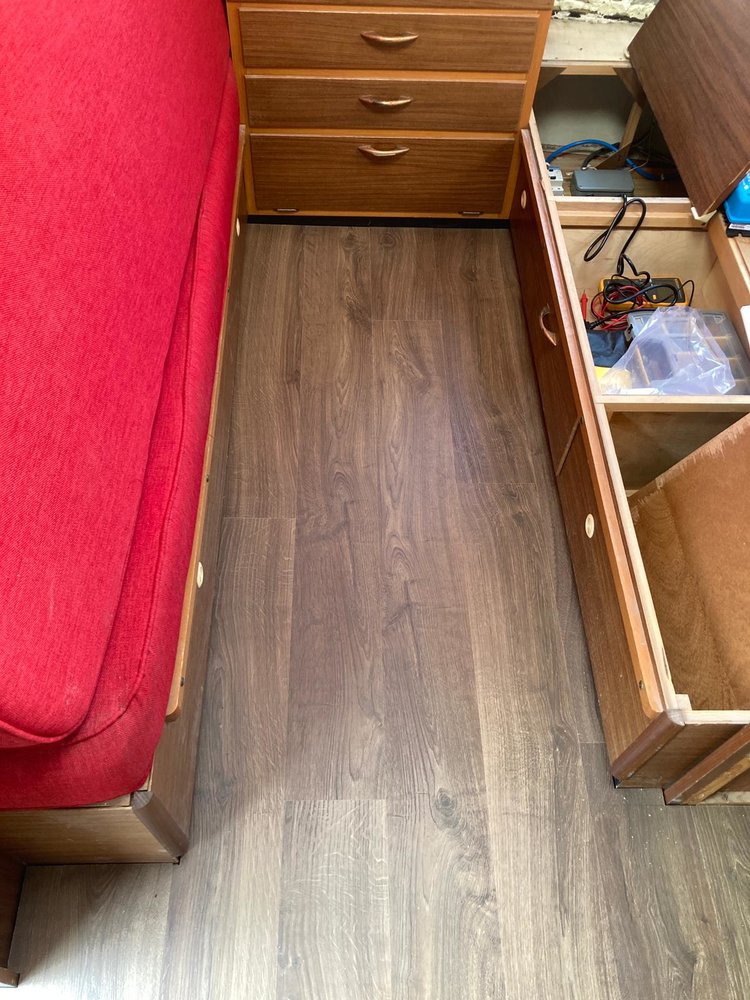

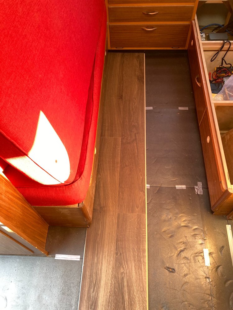

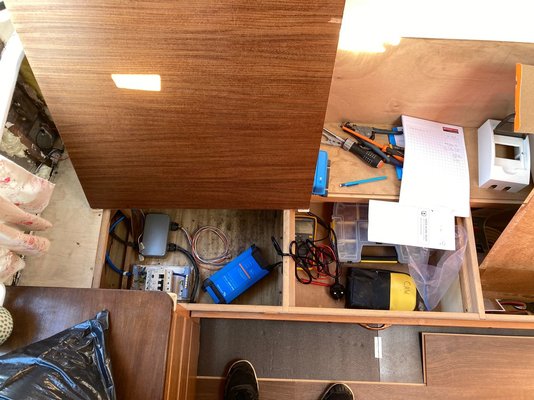

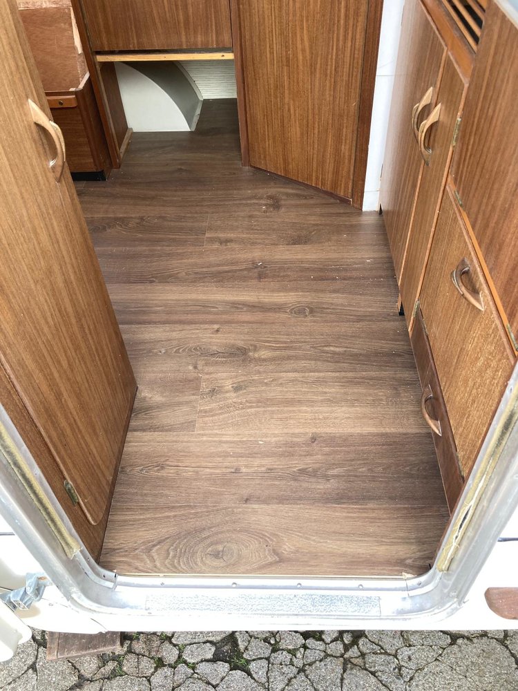

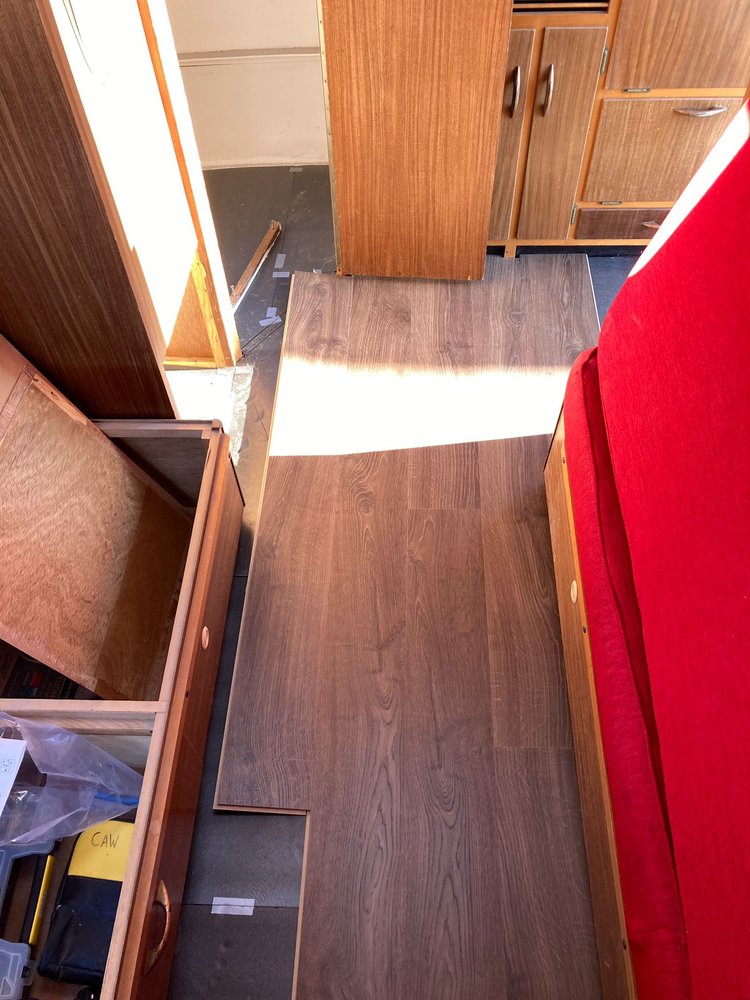

Transformer I think but could be a battery charger. My mate is doing the install. Will have a 240v hookup, leisure batter, 12v lighting, 240v sockets, heater, 12v tap, and a wee fridge. Charges from the car or hookup I think. He's worked it all outand he knows his stuff so I just leave him to it.That floor looks good in there..what is the blue electric thing next to the consumer unit? A battery charger ?
