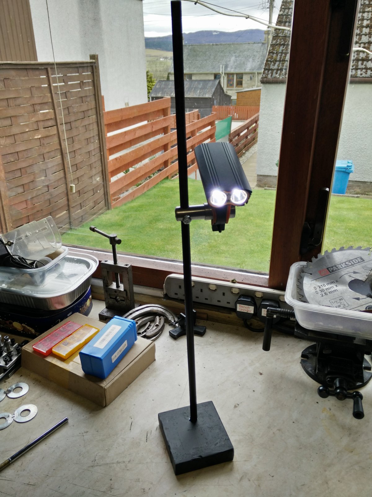

    Easy, and cheaper than swapping out your lid, is to add more light to the welding area.
    I made this using a cheap Banggood bicycle light and a few bits of scrap I had lying about. Three light levels and fully adjustable on the column

    It confuses me that that would work! I thought it was already super bright because of the arc?
    How strange!
  5. Pete.
    Pete. Member
    Messages:
    8,656
    Location:
    Kent, UK
    It's not so strange if you think of it as the difference between someone shining a torch at you, and you shining a torch at them (whilst they shine a torch at you). One way you only see the torch, the other way you see the torch and everything you're lighting up.

    I've found with my limited experience that good lighting makes a massive difference, but if someone is welding outside I would have thought you dont need extra lights?
    I've been using one of those bendy led lights with a crocodile clip on that you get for kids bedrooms from Ikea. Cost about £4 (actually nothing as I stole from daughters bedroom) and shining the light directly and as closely to the area I'm welding
