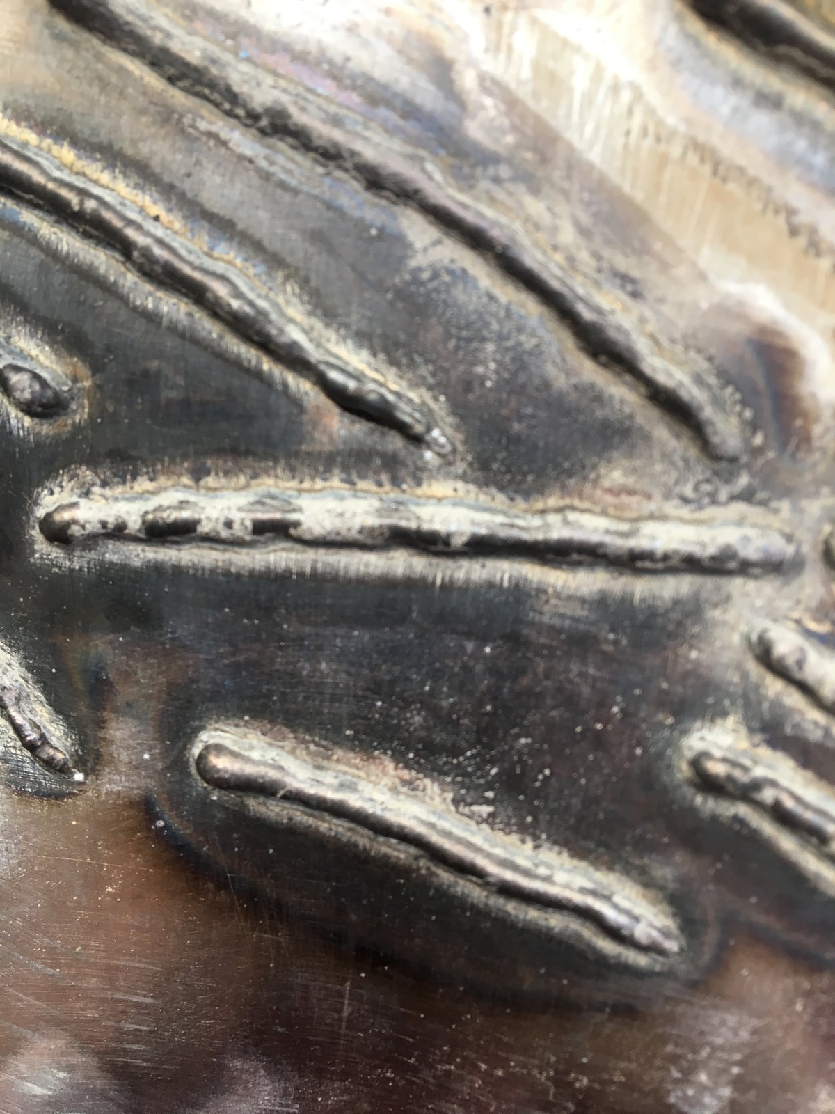

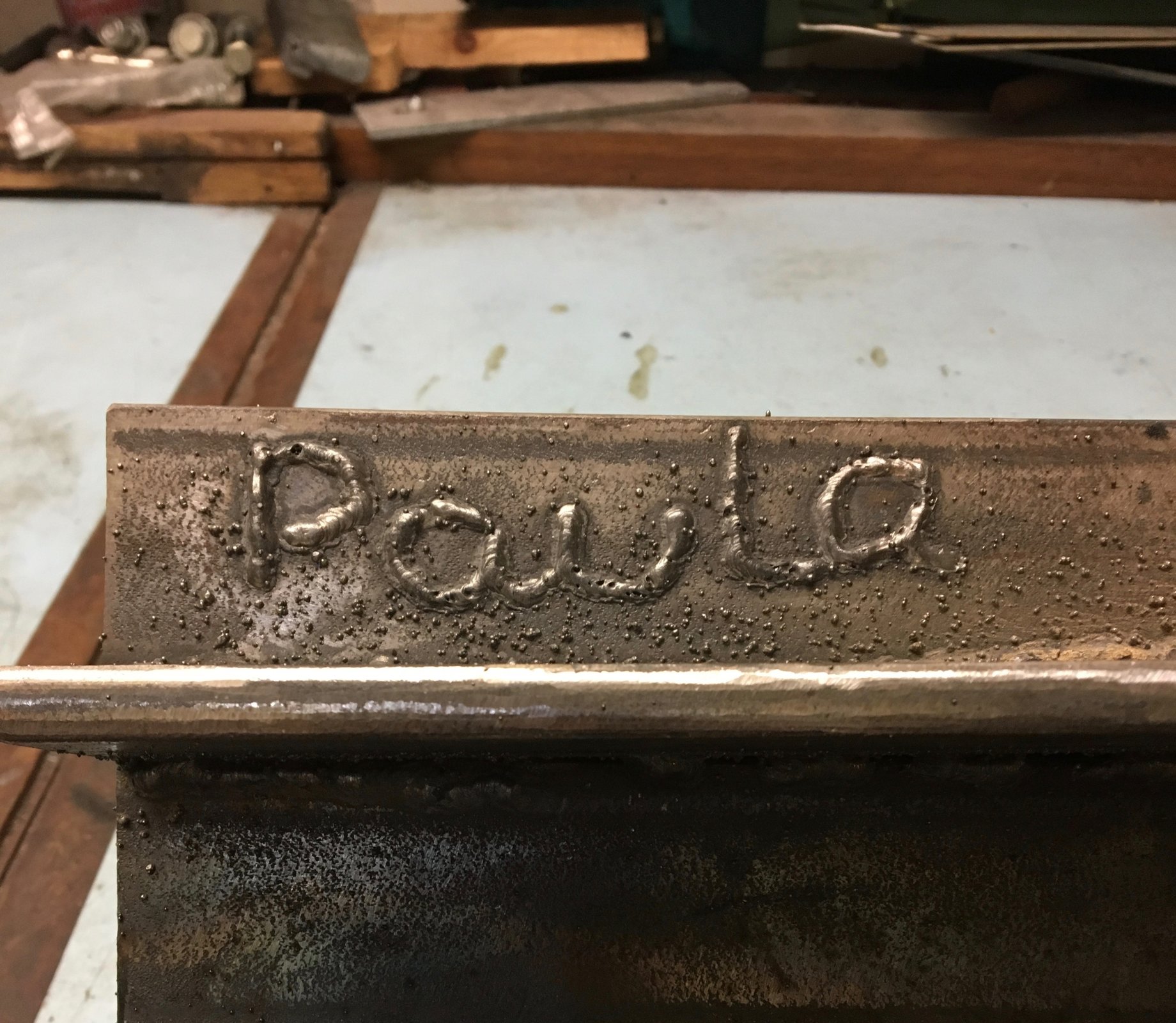

When you have it all set up. get some scrap, clean it up and practice practice, practice. When you get fed up, practice some more. That's what I'm still doing.
you are right thinking it's cheaper with gasless wire. But results will be different for both as already explained. So you will still need to practice on both.Should i practice with the flux core or with the gas? I'm thinking it's cheaper to practice with flux core?

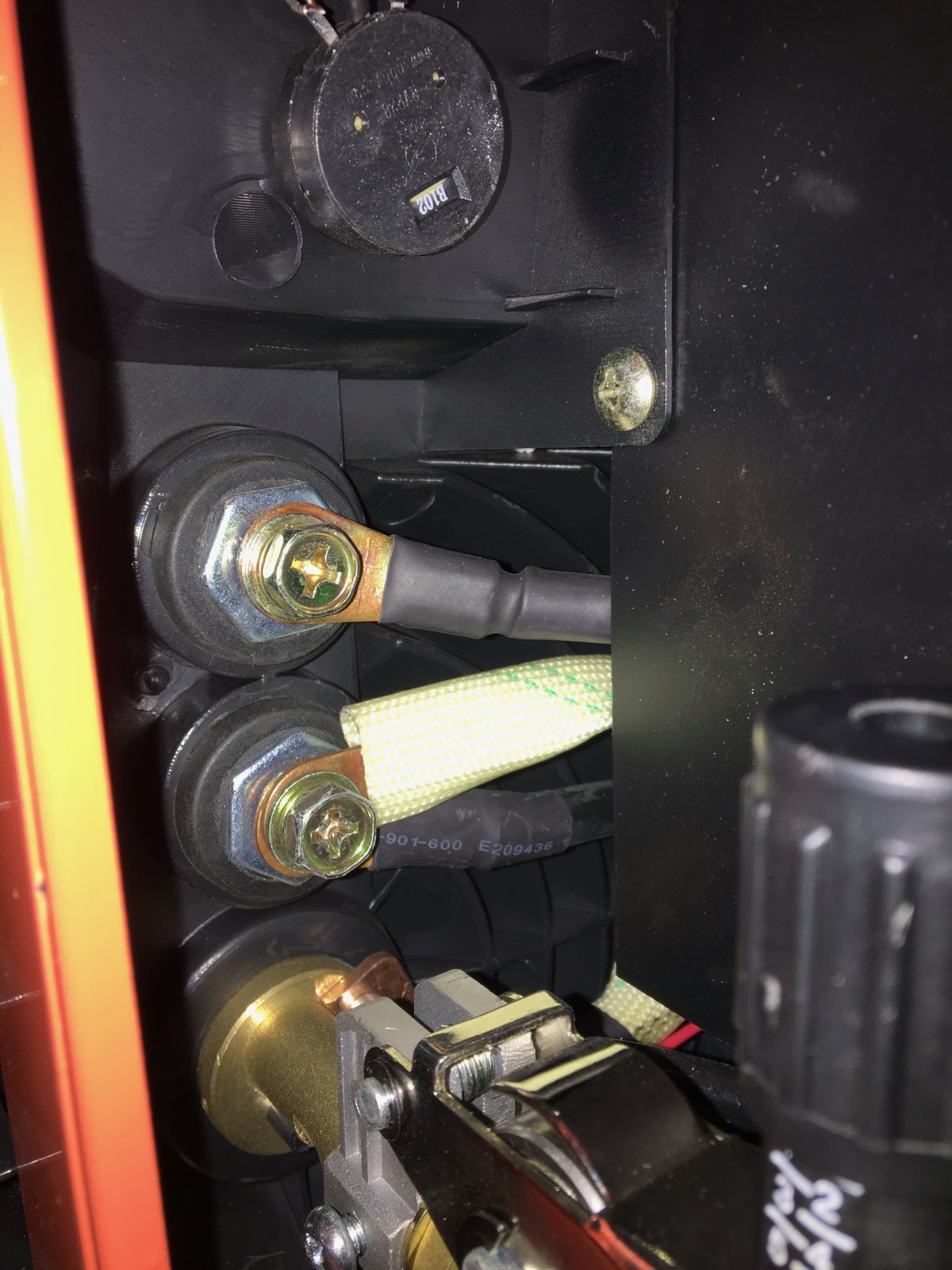

The welder arrived set up for solid wire + gas. The internal wire covered with white heatproof sleeving is the feed in to the Euro torch socket. It was bolted to the lower ( Positive ) Dinse socket. The Earth lead would then be plugged in to the upper ( Negative ) socket.
To convert to gasless wire, the internal white cable has to be moved to the upper ( Negative ) socket, and the Dinse plug on the Earth clamp lead plugged in to the lower ( Positive ) socket on the front panel.

there are 3 wires not 2.
Great.That's right, the manual differs from the machine. The two thick black wires are the actual power, supplied from the main inverter board, and bolted to the rear of the two Dinse sockets. The upper black cable is negative, the lower one is positive, and the Dinse sockets are labelled on the front panel in that way.
As shipped, the setup is for solid wire plus gas, and so the white wire to the Euro socket picks up from the positive.

What does the reverse of the panel look like?
