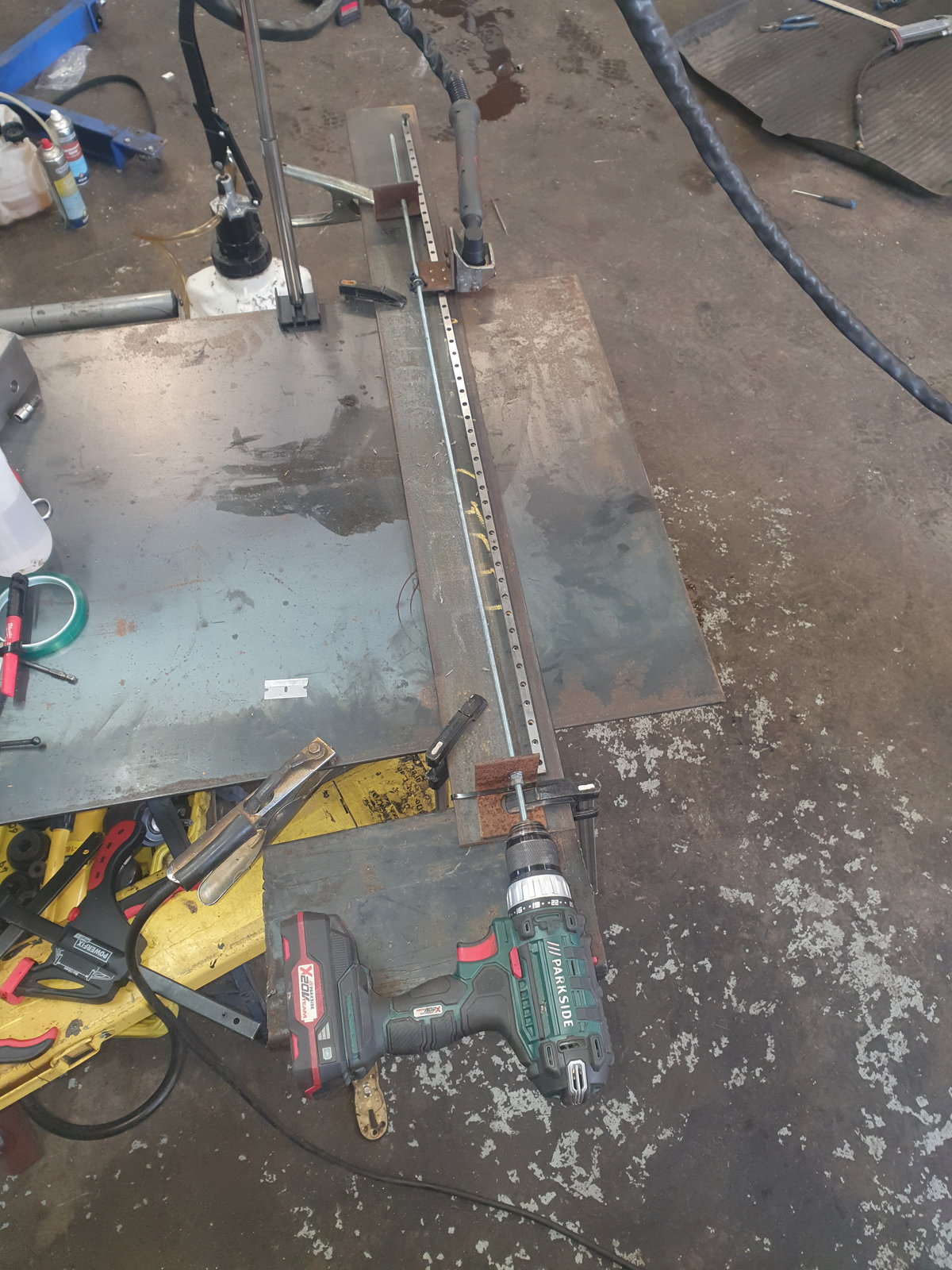

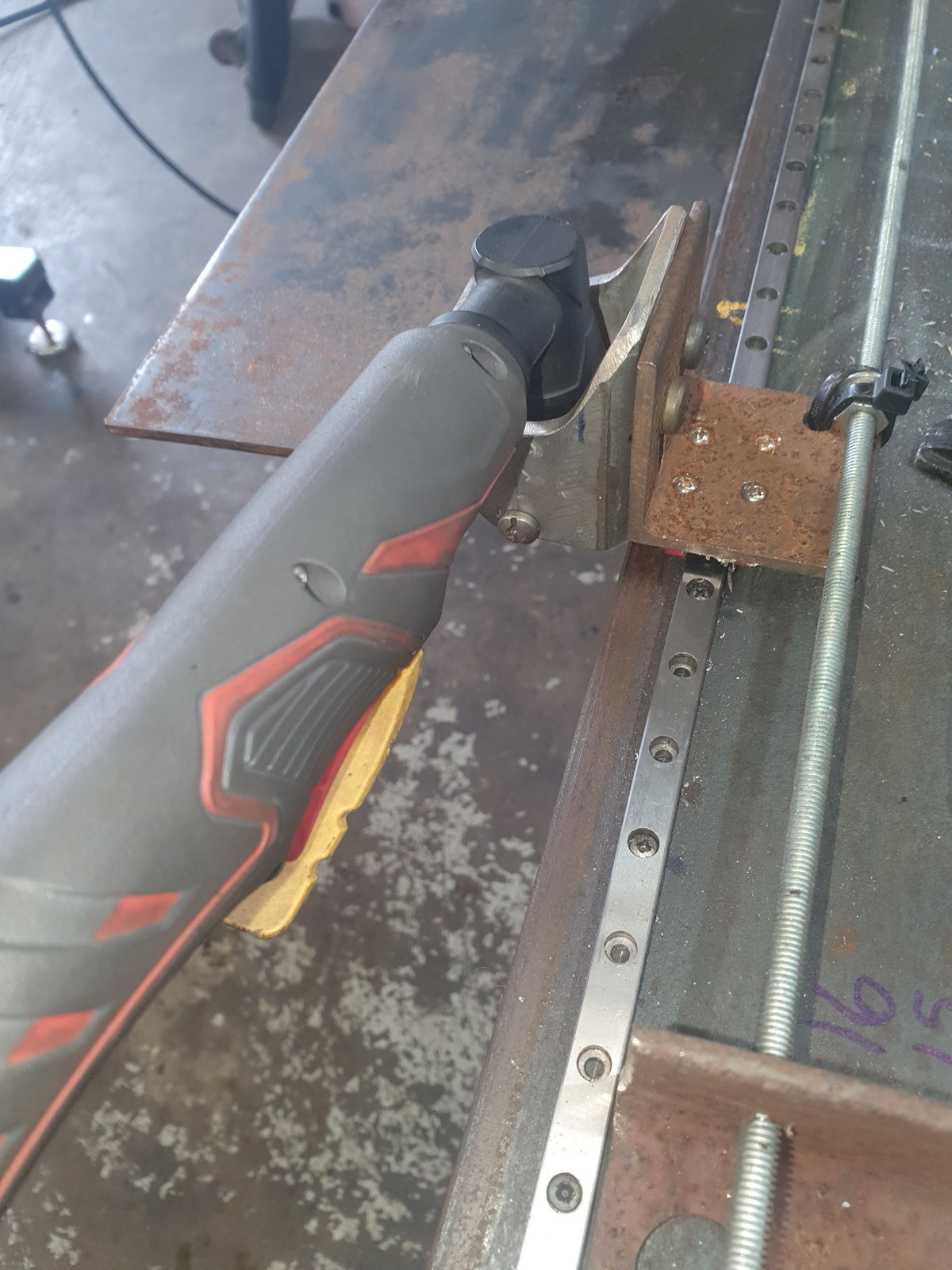

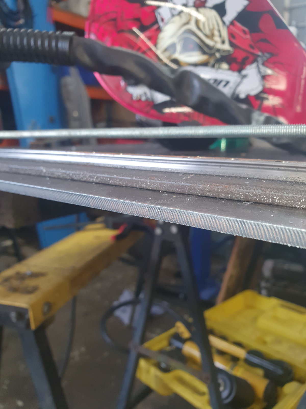

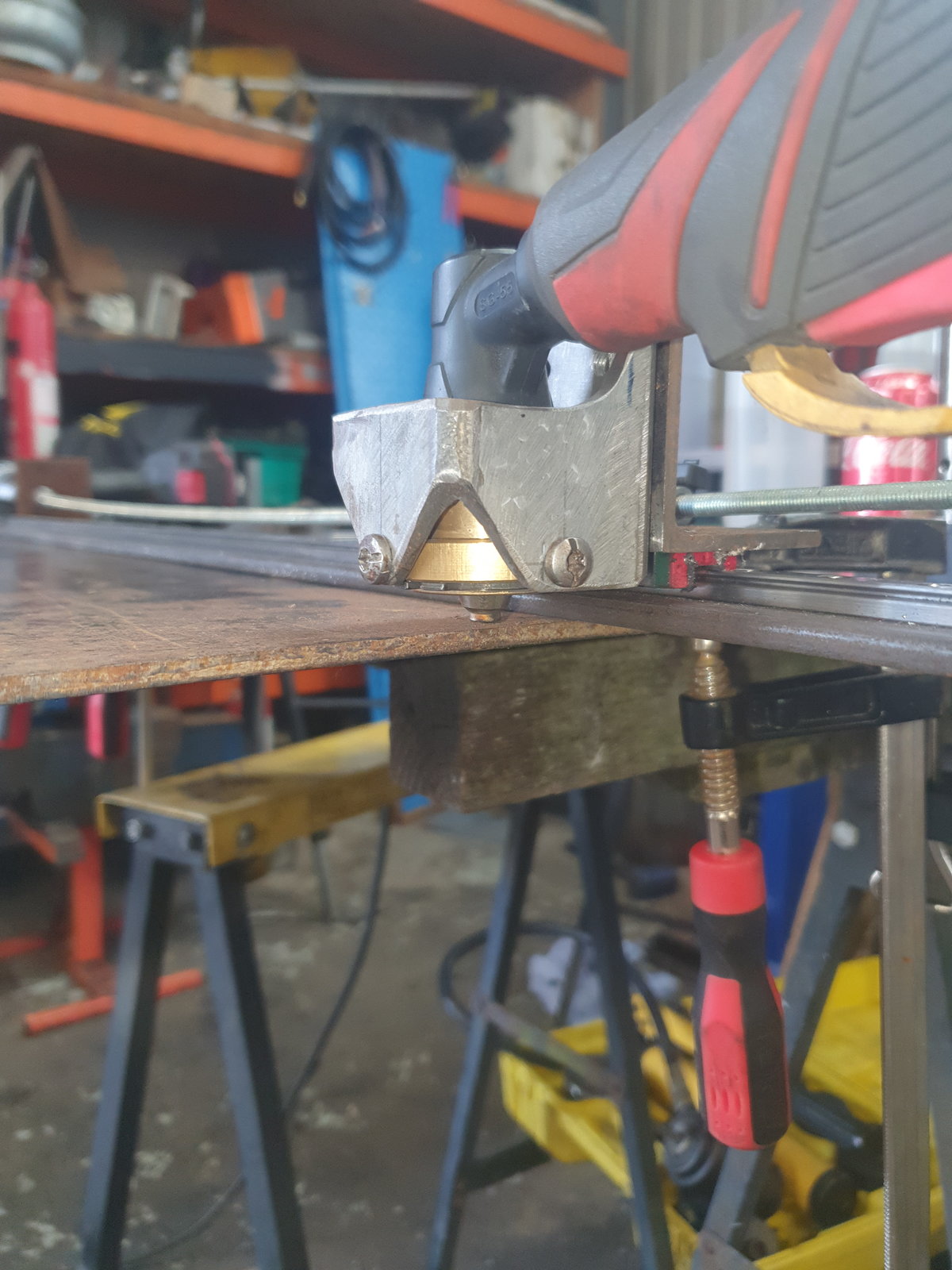

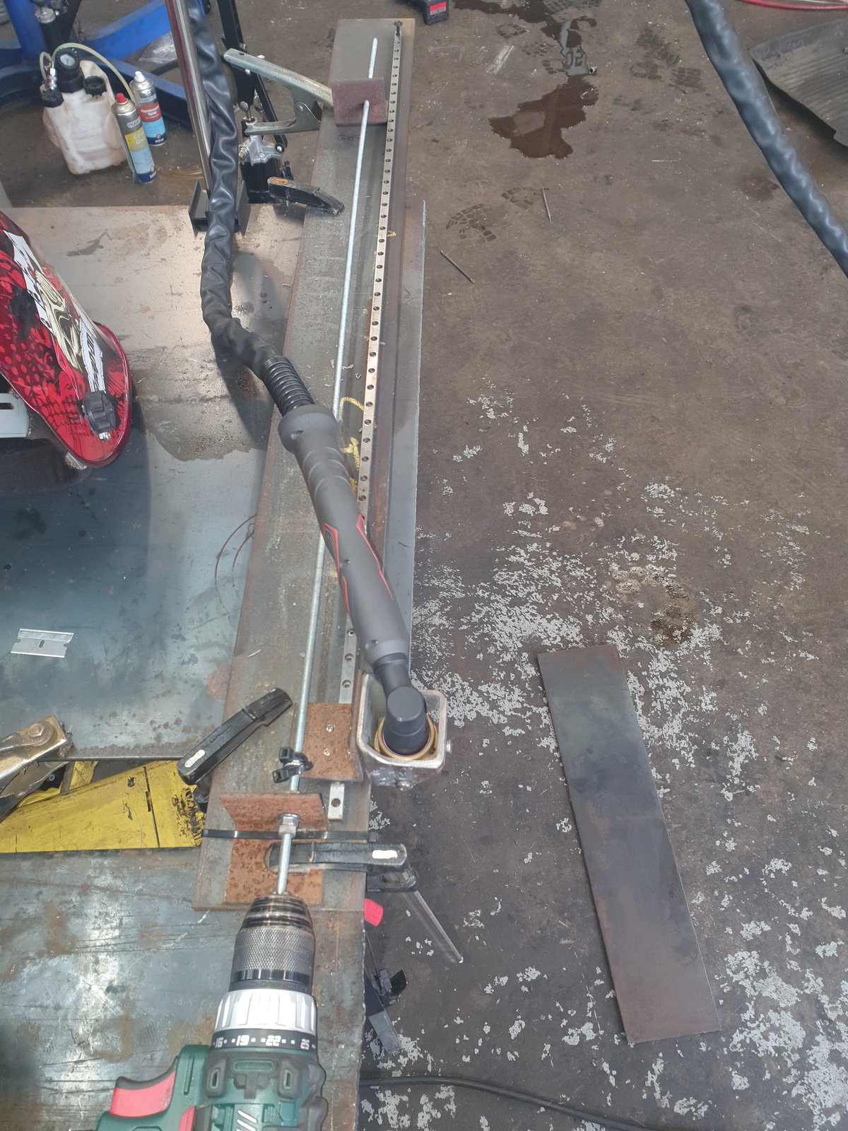

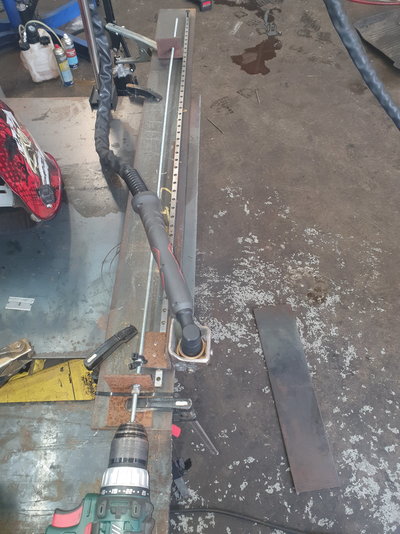

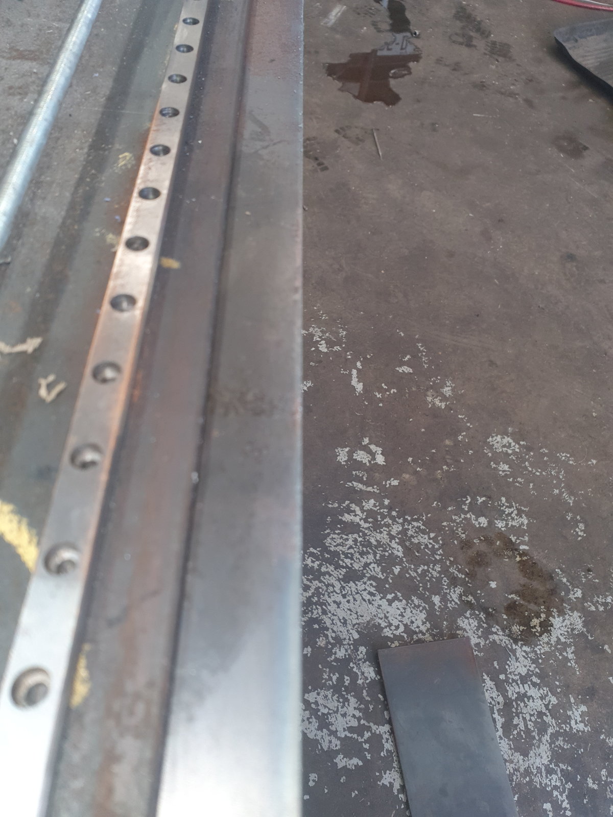

  8. anto44
    anto44 Member
    Messages:
    1,341
    Location:
    ireland
    It works amazingly well, really clean straight cuts, way better than I can manage by hand. The guide rail is off of banggood and I used the holder off a circle cutting guide to hold the torch. Next stage is to get an acme thread lead screw and fit a 12v motor and speed controller. Then I can do some test cuts and make note of the speeds that work best for particular material/thicknesses.
    I would like to build a cnc plasma table in the future

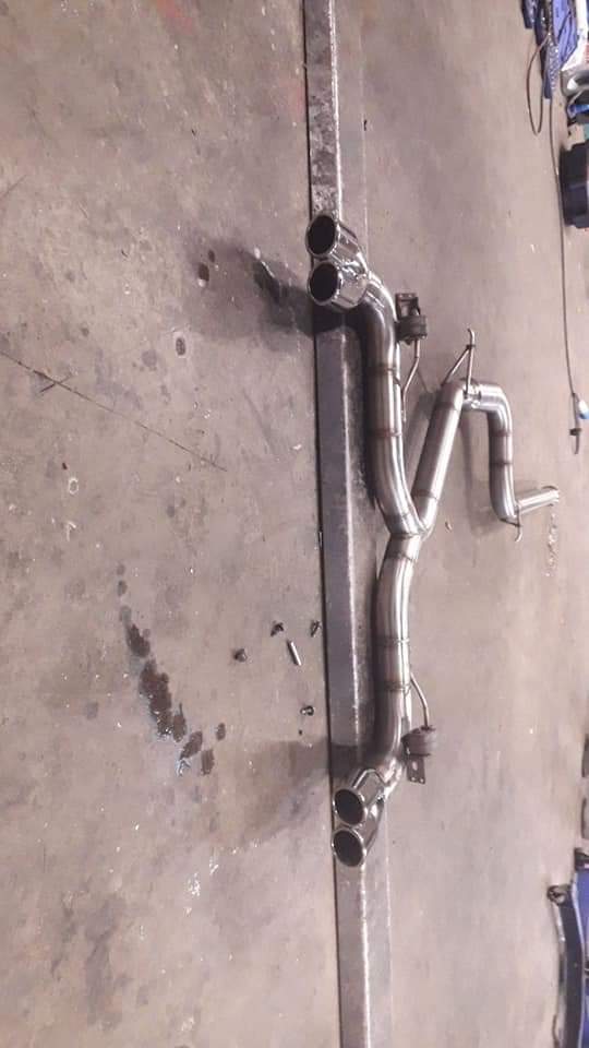

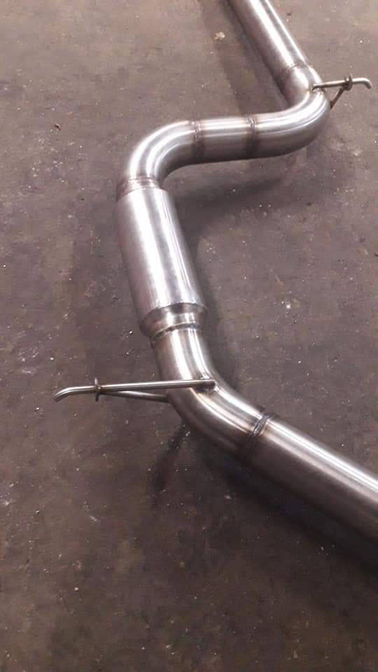

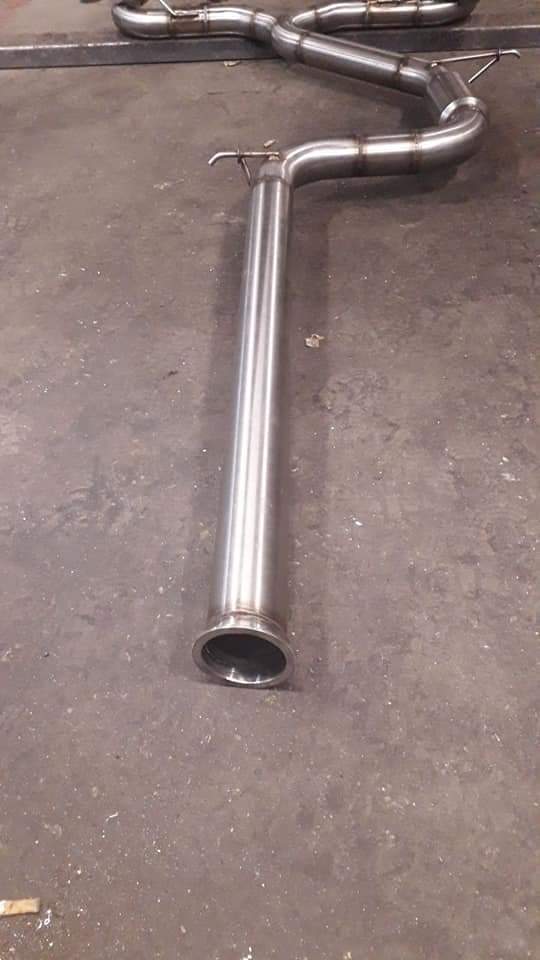

  9. Lovely work on the exhaust. I’d love for someone to do me one in Stainless for my 525D. I want to smash through the DPF and stick in a small resonator box to take off the edge.
    anto44 and stuvy like this.
  10. anto44
    anto44 Member
    Messages:
    1,341
    Location:
    ireland
    I'd make up a pipe and take the whole dpf off instead of knocking it out. Get good money for dpfs for scrap
    stuvy and Exuptoy like this.
