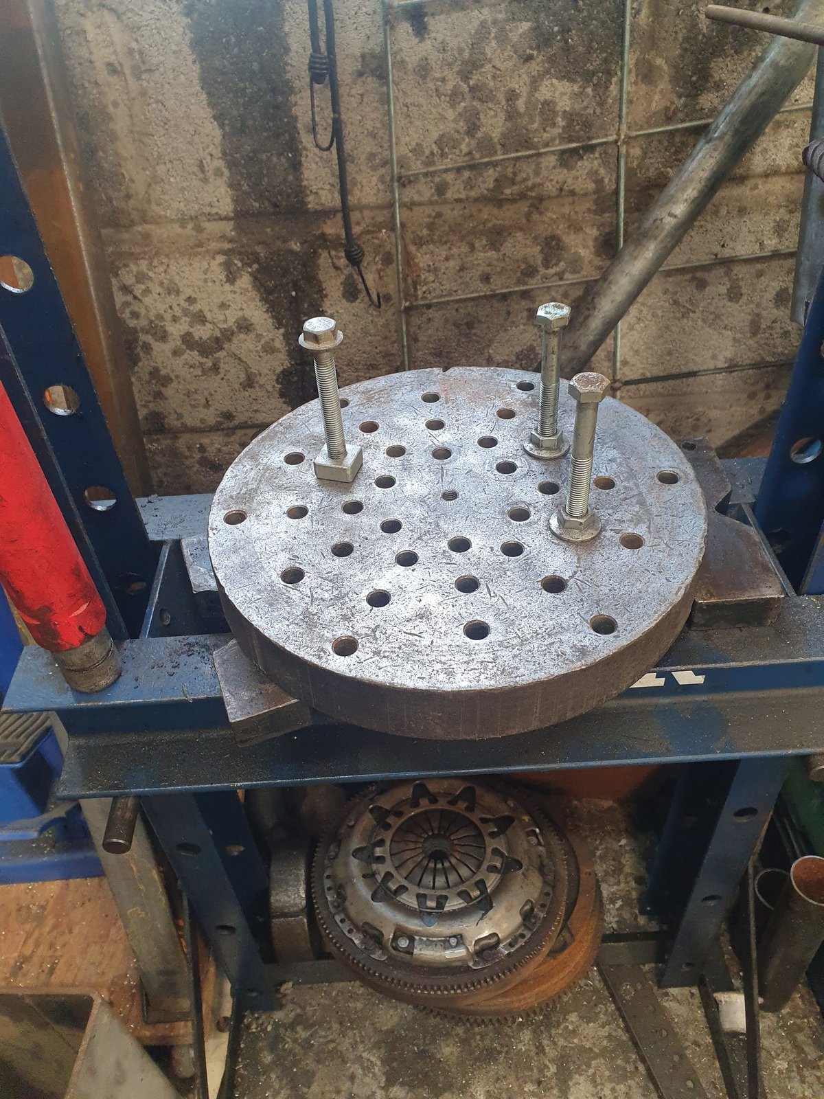

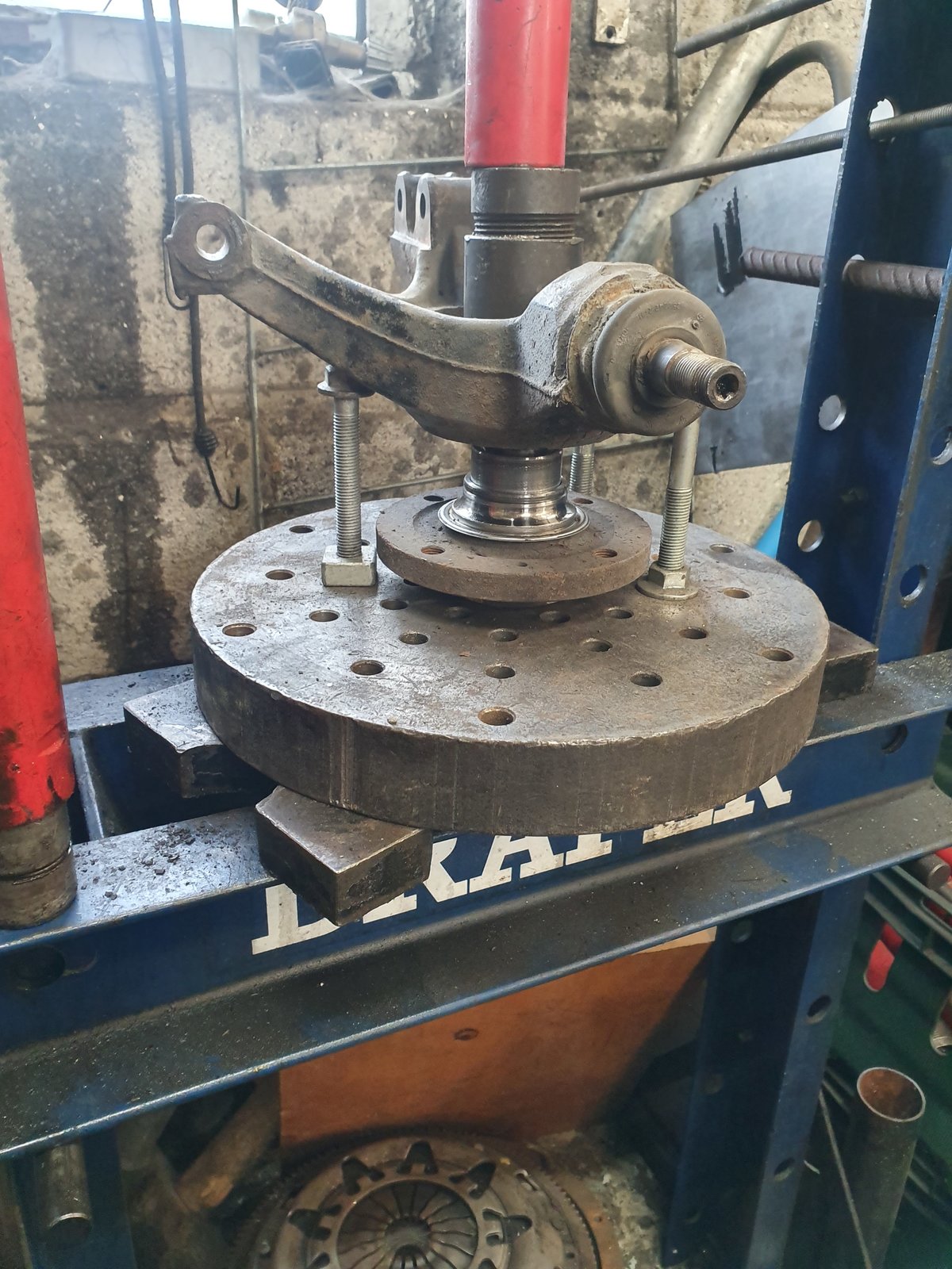

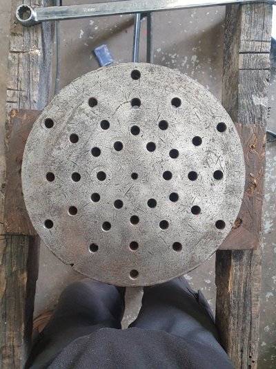

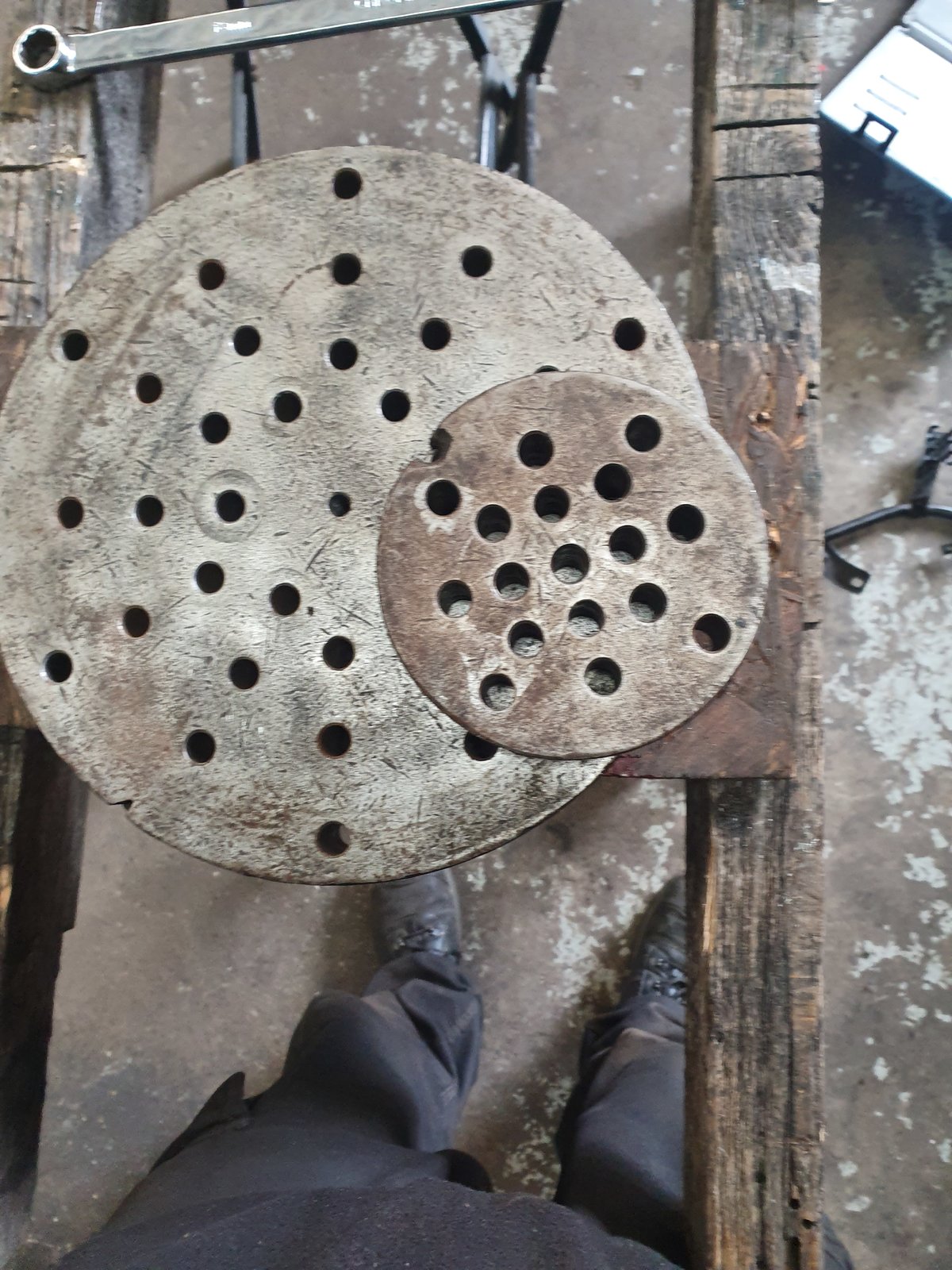

This is a thingy I made a while back. It's for holding awkward shaped parts in the press.

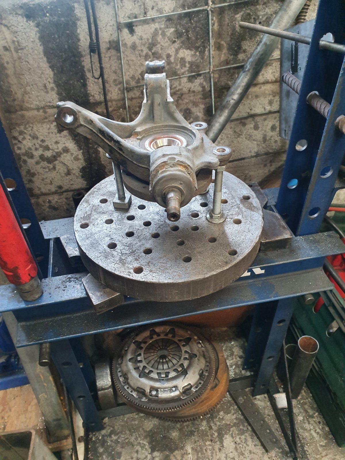

Here it is holding a citroen hub to remove the wheel bearing.

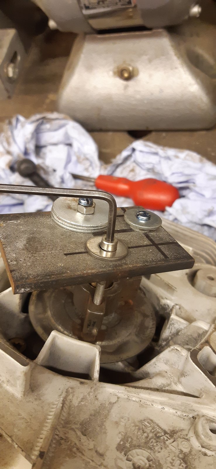

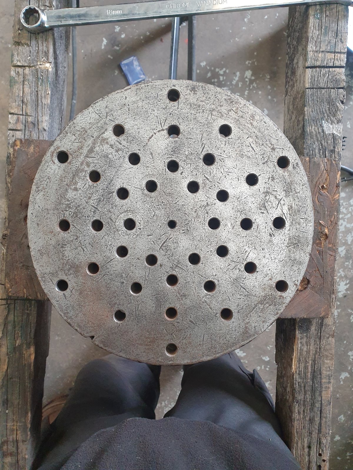

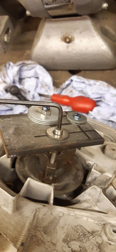

Having the ability to make up a tool or fitting like that on the go is a lifesaver working on machinesI made this last night to draw the clutch boss off a Stihi saw crankshaft,

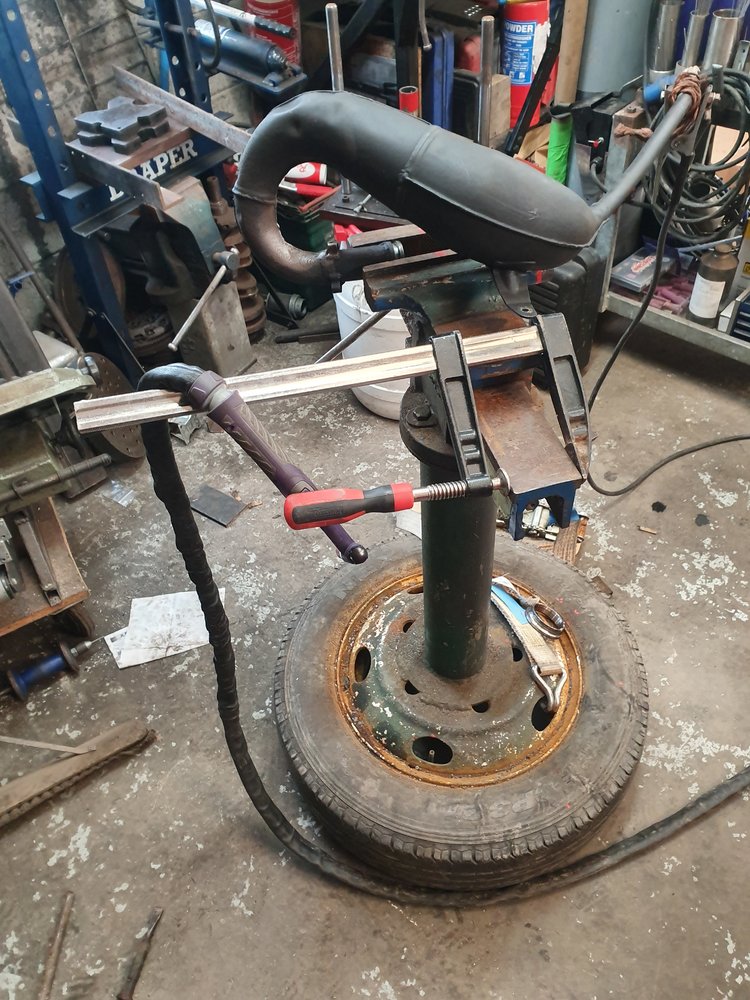

It took longer to find the piece of metal than to make it.
