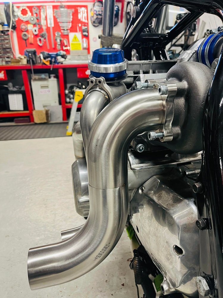

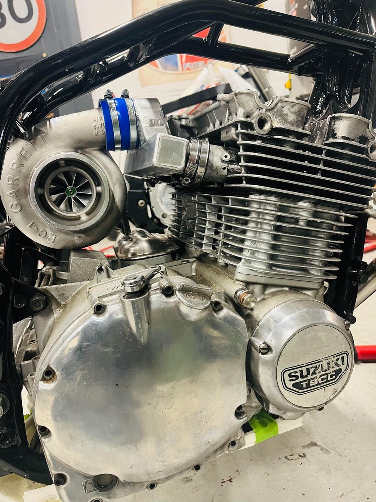

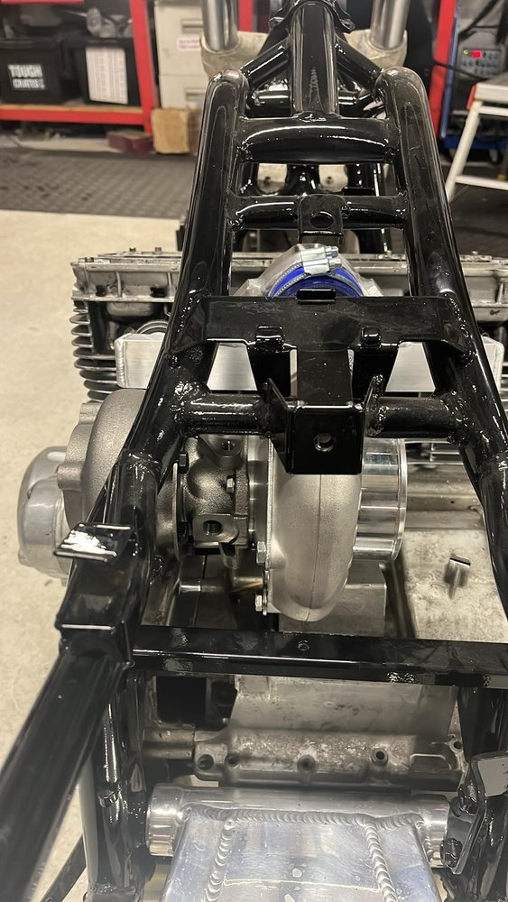

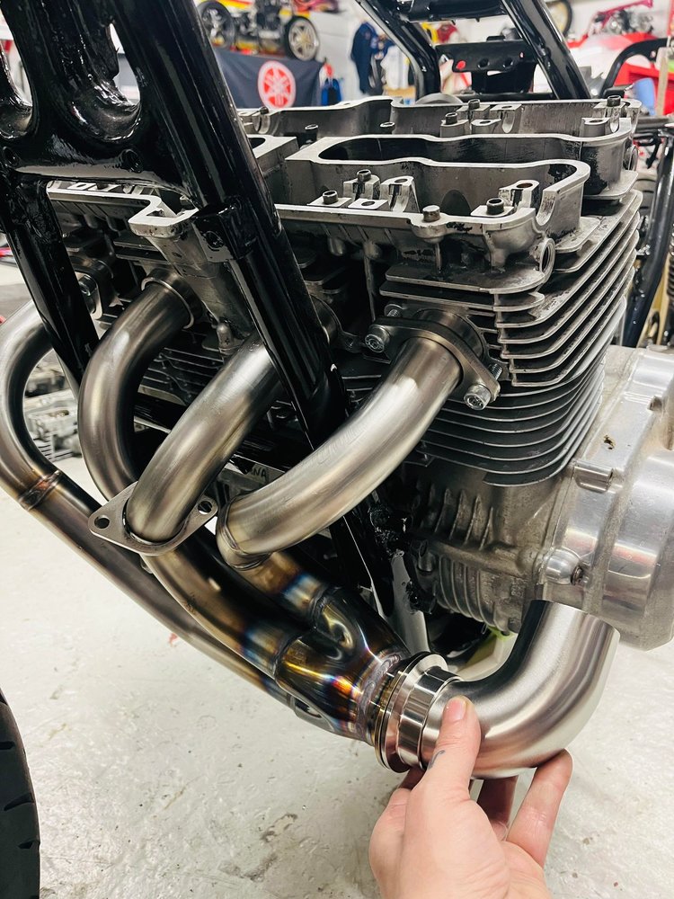

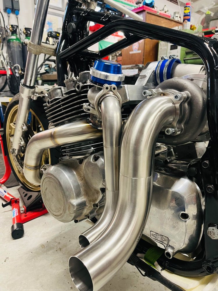

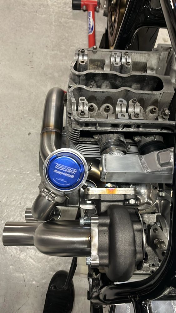

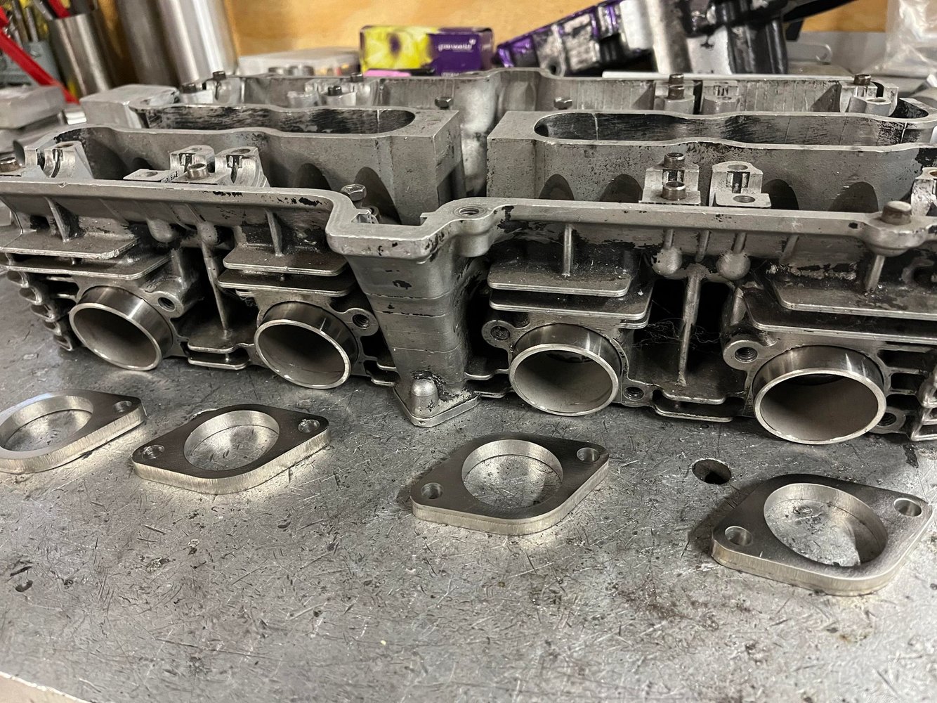

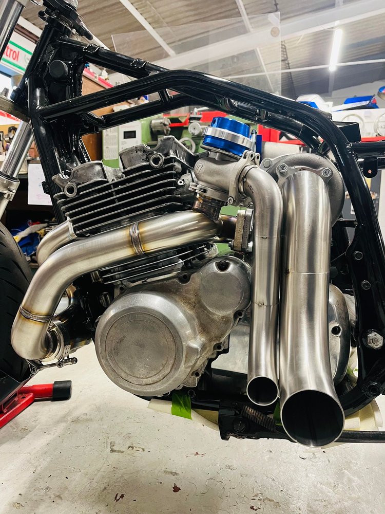

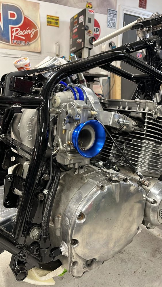

While I was/am waiting for bits I picked up a GSX1400 which had been dropped. Cosmetic damage only which is all sorted bar the dented tank now, and that can stay as it is. I'll be taking that up for MOT next week hopefully then it will become main transport.Will there be an update on the CanAm soon?
Then if all goes to plan (yeah, I know!) after Christmas the running order is:-
1) Dresda
2) Draw through turbo ET.
3) Can Am.
During/in between that lot I want to fit in converting the 1100G to fuel injection.
After the above the project list is the 1100 EL/Bandit hybrid with injection, restoration without modification of the other ET, and the Ski-Doo which is still under serious consideration for becoming a Kettenkrad.
The silver barrels are the high comp big bore for the normally aspirated engine going into the Dresda. The single cyl barrel and head are for a 250 cc Two Stroke Rotax engine in a Can Am. The black barrels and cases are for the draw through turbo engine.
