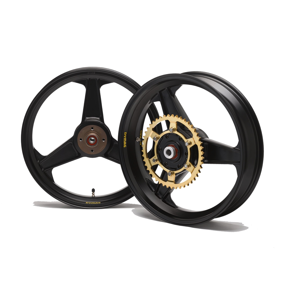

Wheels need to look period, preferably aftermarket race in appearance. Old Dymags and the like are out for me as I just wouldn't trust them. At the moment the most likely contenders are the '06 on Kwak ZX6R wheels as they have more than a passing resemblance to dymags from back in the day.
