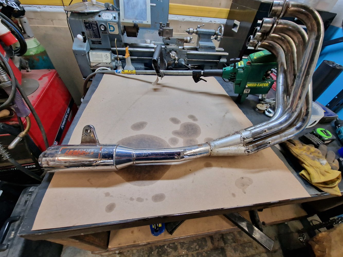

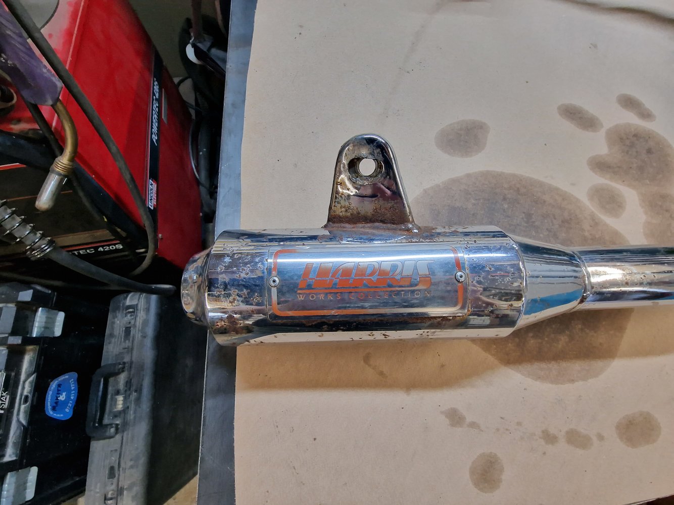

Arrived at the Harris point of the dig out.This is true. Old and worn out tat on EBay is now described as Vintage.
I bet whatever you do that it will be infinitely better than a “vintage” Harris.
That takes me back.

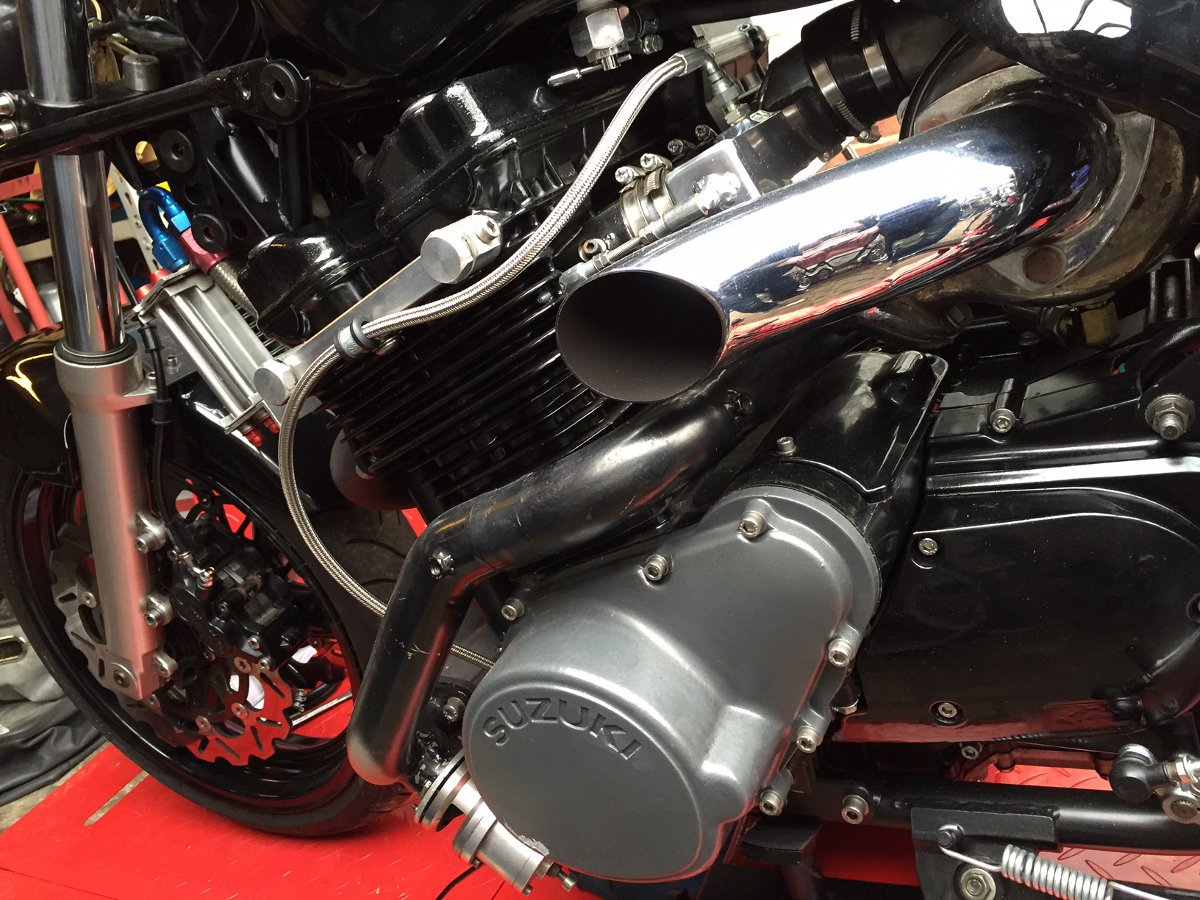

I won't be using an exhaust at all. It'll be a similar set up to the photo below but it'll be swept down rather than forward.That takes me back.
On mine, I had to elongate the the rear mount hole but there was nothing that could be done with the short header pipe.
I bet you could make a new section from the collector back, that looks like a Harris but far more refined and in stainless steel.
As you are mating the exhaust to the turbo, I’m guessing the the Harris headers will be redundant and the collector will be cut off?
A blow through turbo set up is a lot more user friendly for pottering about as the pressure is before the carb/injection. A draw through has to be ridden a lot more like two stroke as the pressure is after the carb and they will choke up if you potter about, sit at idle for too long etc.Wow! Yes that is awesome.
Would I be right in thinking that you have to manage the boost or power at lower RPM to stop the torque from stressing the internals?
I wondered if a bike would naturally restrict torque anyway, purely due to traction/wheelie issues.
I reckon that 180 hp on a 42 year old bike will be more than enough to keep things interesting. They're a bloody handful with the standard 100 hp.A blow through turbo set up is a lot more user friendly for pottering about as the pressure is before the carb/injection. A draw through has to be ridden a lot more like two stroke as the pressure is after the carb and they will choke up if you potter about, sit at idle for too long etc.
Low rpm means low boost pressure as it's dependent on exhaust temp and velocity. So there's a natural moderation of boost, but with an older air cooled engine, especially one with a roller bearing crank you have to keep boost relatively low (single figures) anyway. With the engine I'm building up for this the limit will be around 200hp, so to give a bit of leeway I'll be aiming for around 180 hp at somewhere in the 6 - 8 psi of boost range.
Given that it's an old school set up the boost will be 'noticeable' when it kicks in.I reckon that 180 hp on a 42 year old bike will be more than enough to keep things interesting. They're a bloody handful with the standard 100 hp.
I have a nice man milling a spacer plate up for the lock up clutch too. So although there's not much in the 'bolting it together' category things are moving along.I remember an article in Bike magazine, 30 or so years ago, Pip Highams z1000 with an American Turbo Pak draw through system on it. Nothing else was done, stock frame, brakes, wheels etc. Real old school.....Yeah, that's a compromise between looks and performance. The idea with the build is that it looks like they did mid to late '80s so the turbo has to be draw through with a carb even though injection with a blow through would be better. The same with Slabby forks with anti-dive units won't be as good as J/K or USD L/M but they fit the look.

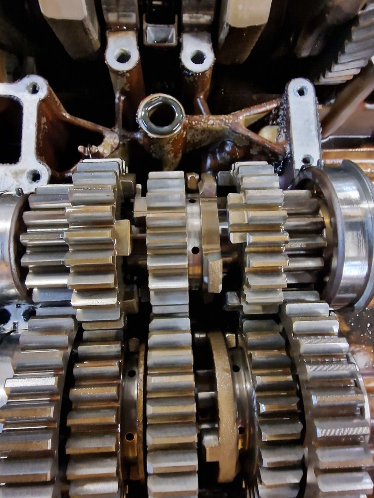

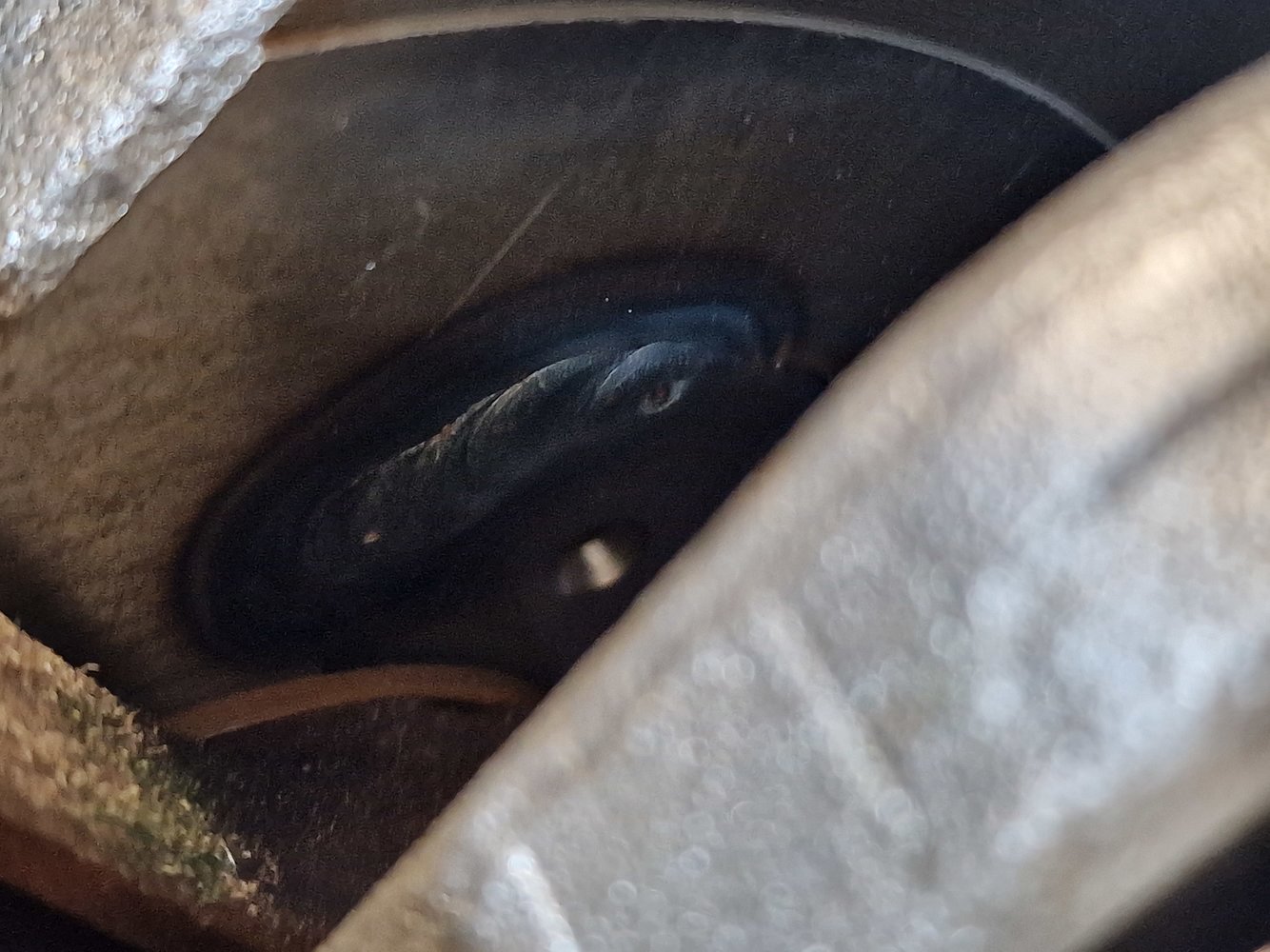

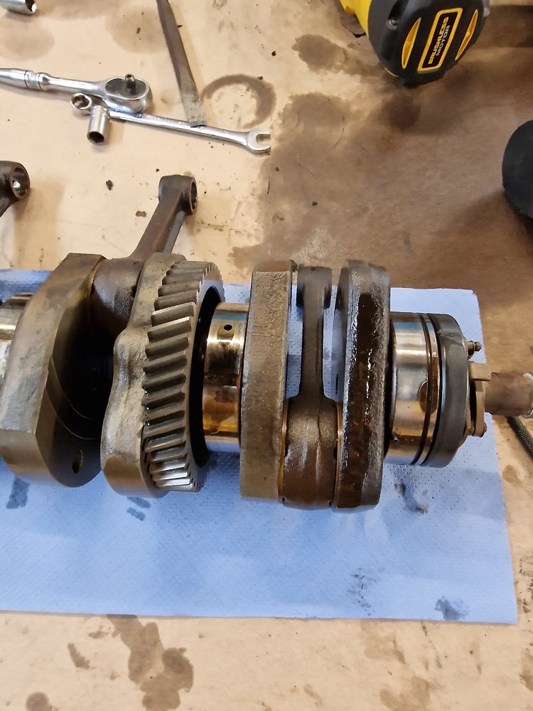

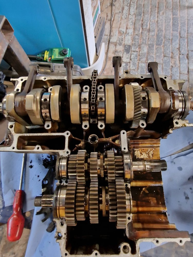

They're a pressed up crank and the primary gear needs to be changed from helical to straight cut because of the power increase. If you don't the extra power from the primary gear loads up on the clutch gear and increases the thrust pressure on both the crank and the clutch. Welding the pin ends to the webs is also required to cope with the extra power as the crank can twist."Strip the crank for straight cuts"
What does this mean? Looks good in there.
Jeepers! Serious engineering there - welding in itself can cause the crank to pull? Also, I'm guessing it needs welding with sufficient energy otherwise it's likely to crack at the welds?They're a pressed up crank and the primary gear needs to be changed from helical to straight cut because of the power increase. If you don't the extra power from the primary gear loads up on the clutch gear and increases the thrust pressure on both the crank and the clutch. Welding the pin ends to the webs is also required to cope with the extra power as the crank can twist.
It's not that straight cut gears are better for normal use, but if you consider that with the turbo it'll go from 100 hp to 220 ish you can see that it'll need to be uprated accordingly.Jeepers! Serious engineering there - welding in itself can cause the crank to pull? Also, I'm guessing it needs welding with sufficient energy otherwise it's likely to crack at the welds?
The Yamaha crank in my xj650 has shell bearings and straight cut gears. Does that mean its good?

It wouldn't be as strong as there's not enough meat in the cast webs to get a decent sized dowel. Two runs of weld about 25 mm long each side of the pin circumference is the accepted way to get enough extra agrip to stop any twist.Wouldn't it be better to dowel the crank pins?
