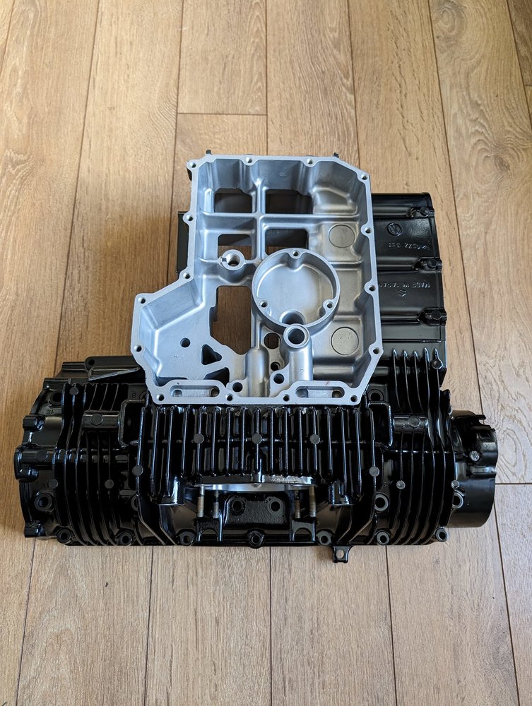

Get the dogs on the gears undercut too, as torque is applied they drag in and hold the gears, especially on 2nd gear which normally rounds the dogs off and you get that horrible jumping out of second when you pile the throttle on.
Shiney, Shiney !
