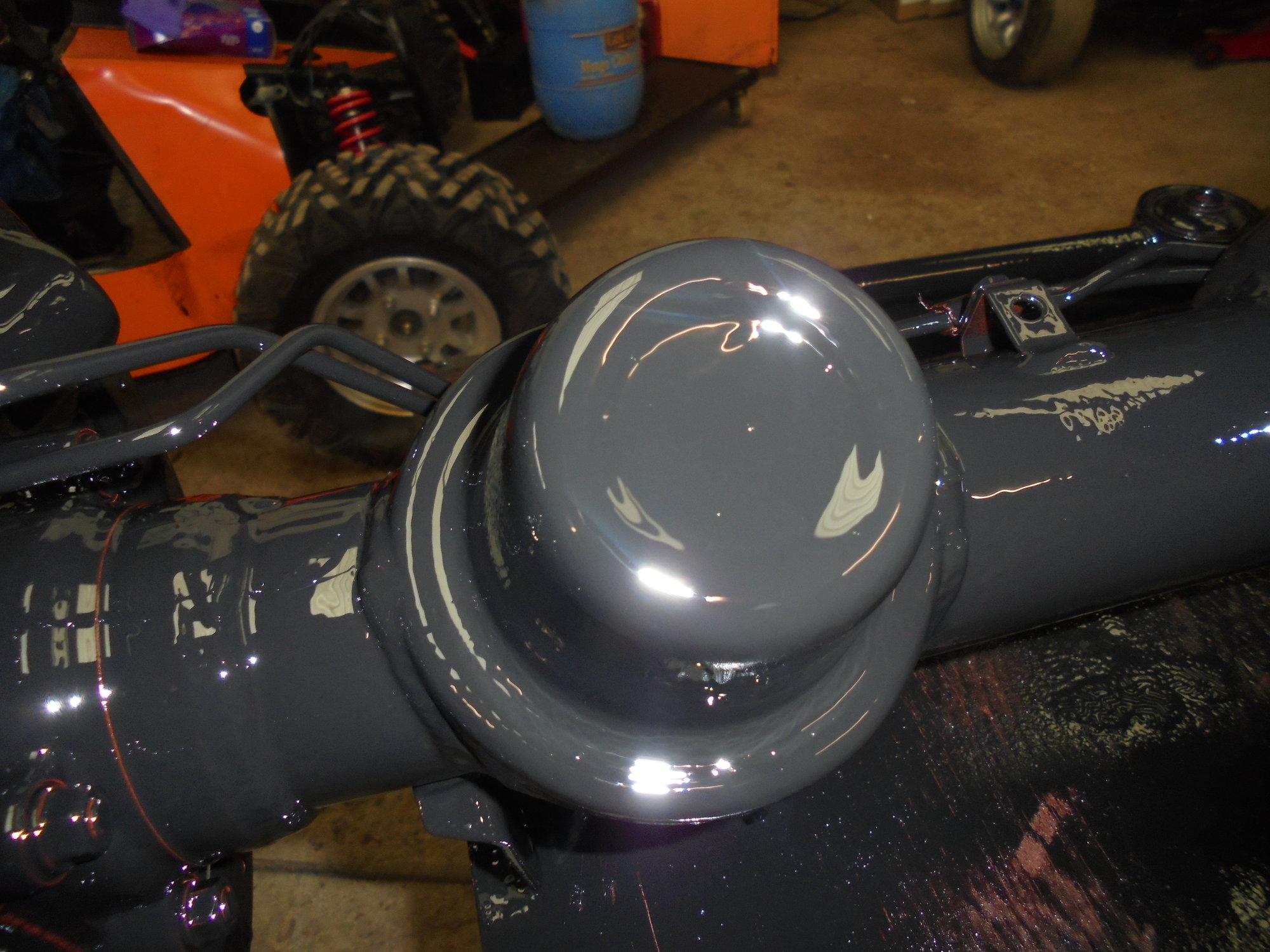

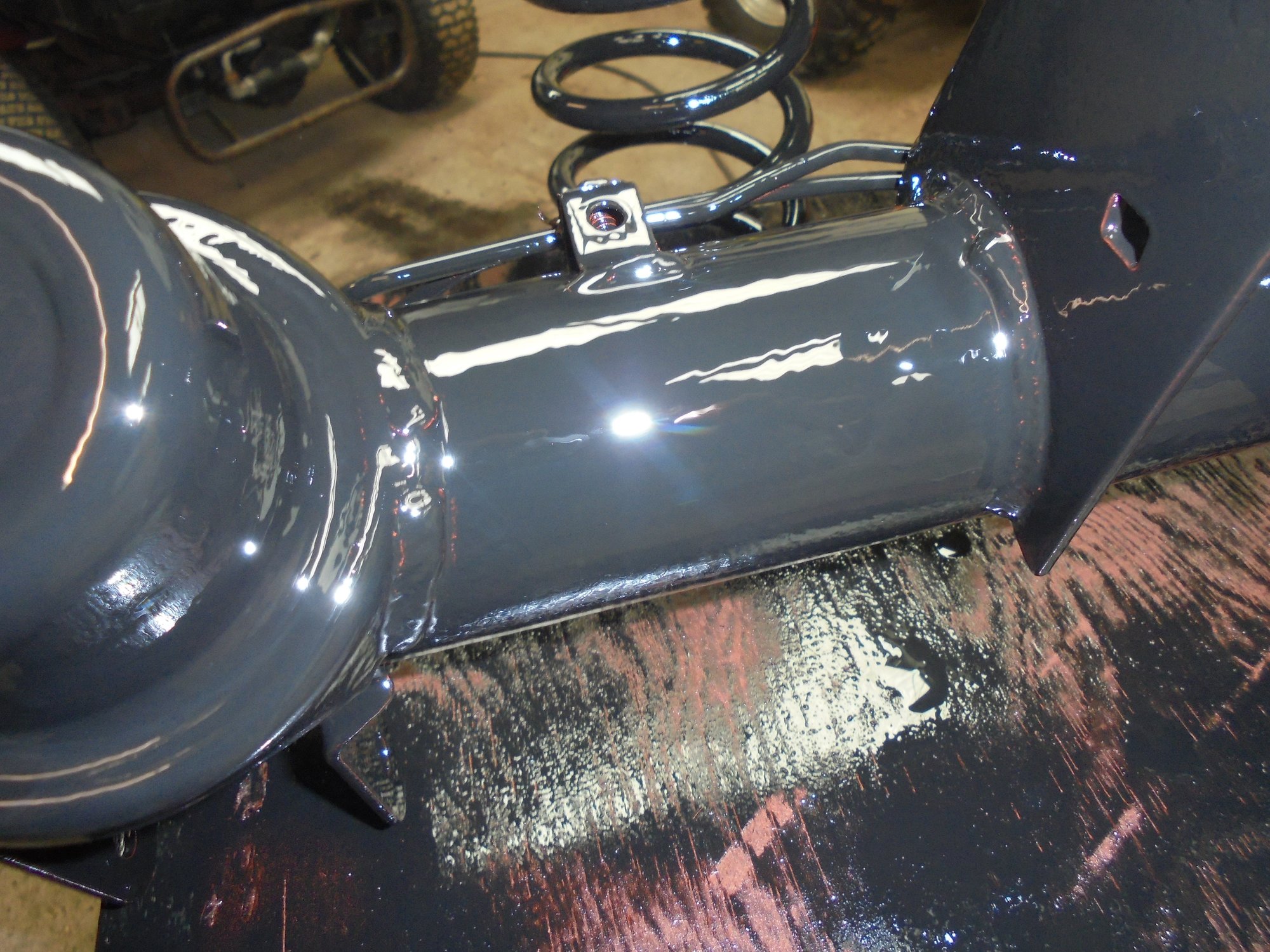

Not saying they are brilliantly made by any means, or designed. I did have to make new rear shock/spring mounts, put a couple of rails in to hold the chassis together/spart at the rear instead of just the roll-bar and the petrol tank. And move the steering rack so inverse ackermann effect became proper ackerman, and reduce the massive bumpsteer from inches to not noticeable. But the actual main structure has held together well.
Roll bar did bend up and back when I used the crane at work to pick it up to work on the axle ;-)

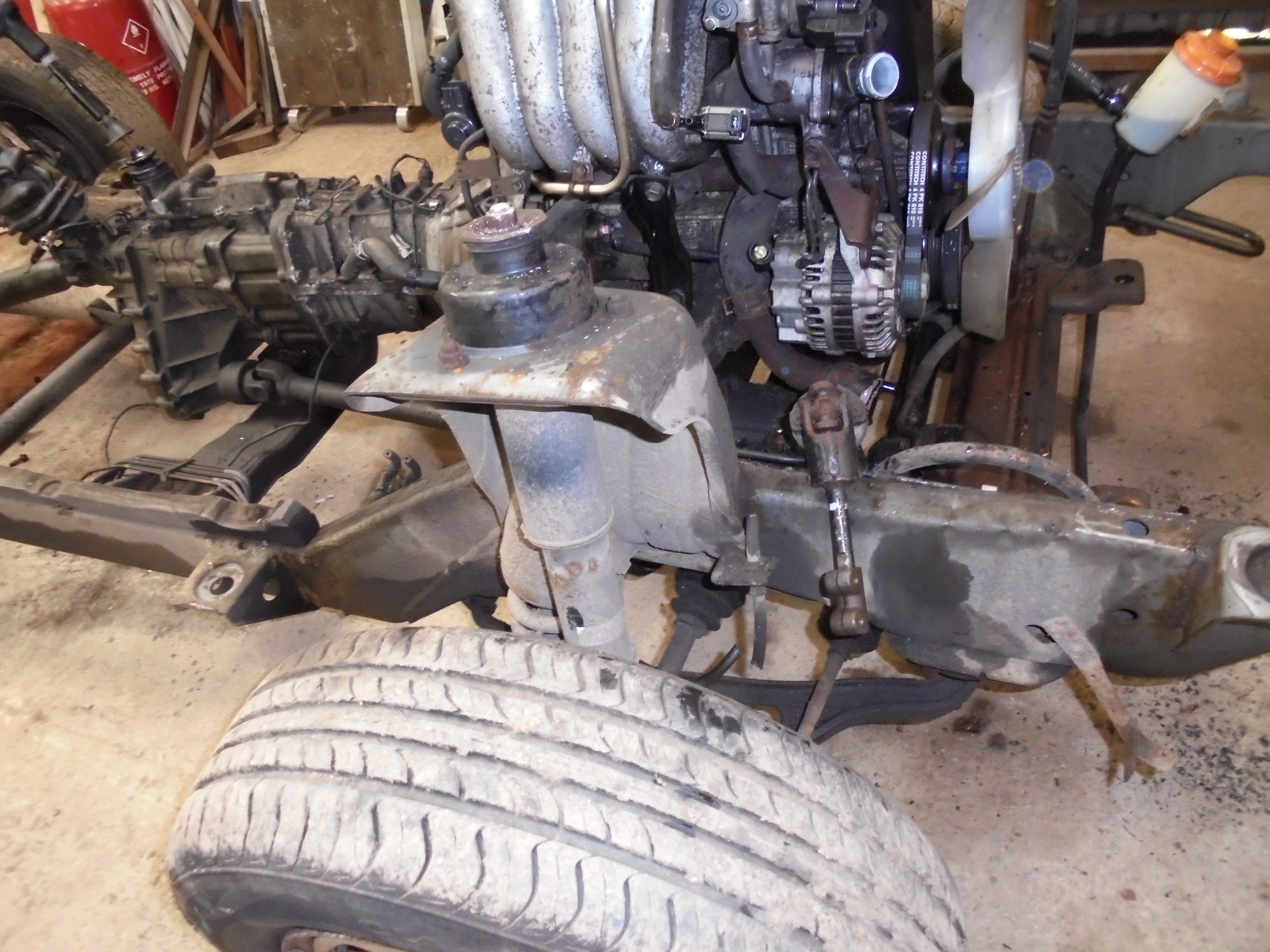

"So instead I have an MR2 parked out front waiting for me to build a new mid-engine chassis with lots of lock and suspension travel . . . "
have you worked out how your going to build it ? double wishbone suspension to get wheel travel ?
why did you choose an mr2 or did one just happen along at the right price ?
or are there merits to having such a heavy engine ie traction
how will you get a really good steering angle taxi front hubs ?
will the engine loom separate out OK, or is it all one?

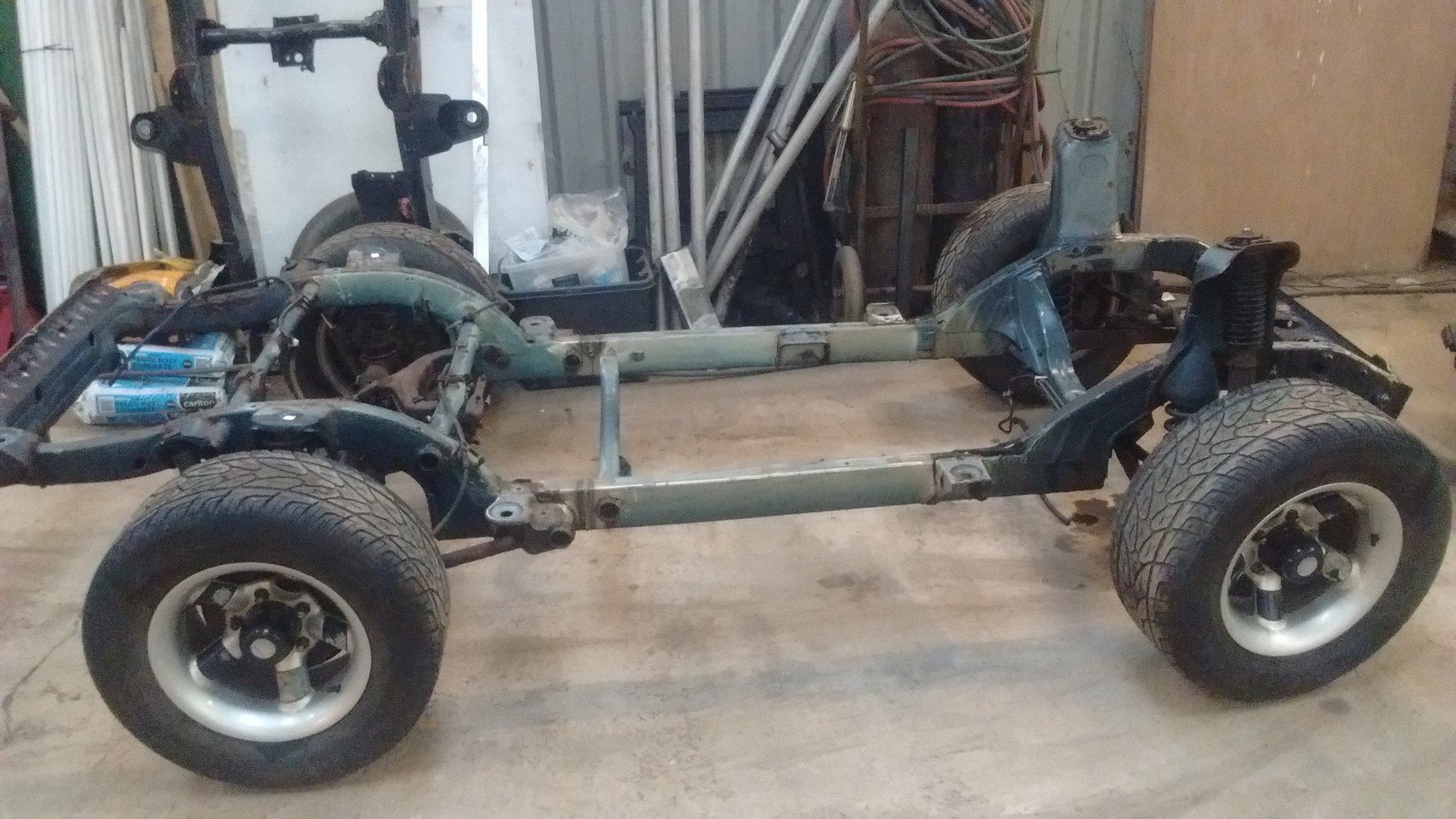

It looks like both the Jeep CJ7 and the Daihatsu Sportrak uses wheels have the same PCD but with a 0.4mm smaller centre bore so that could be a possibility with a bit of emery cloth!

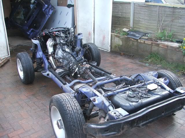

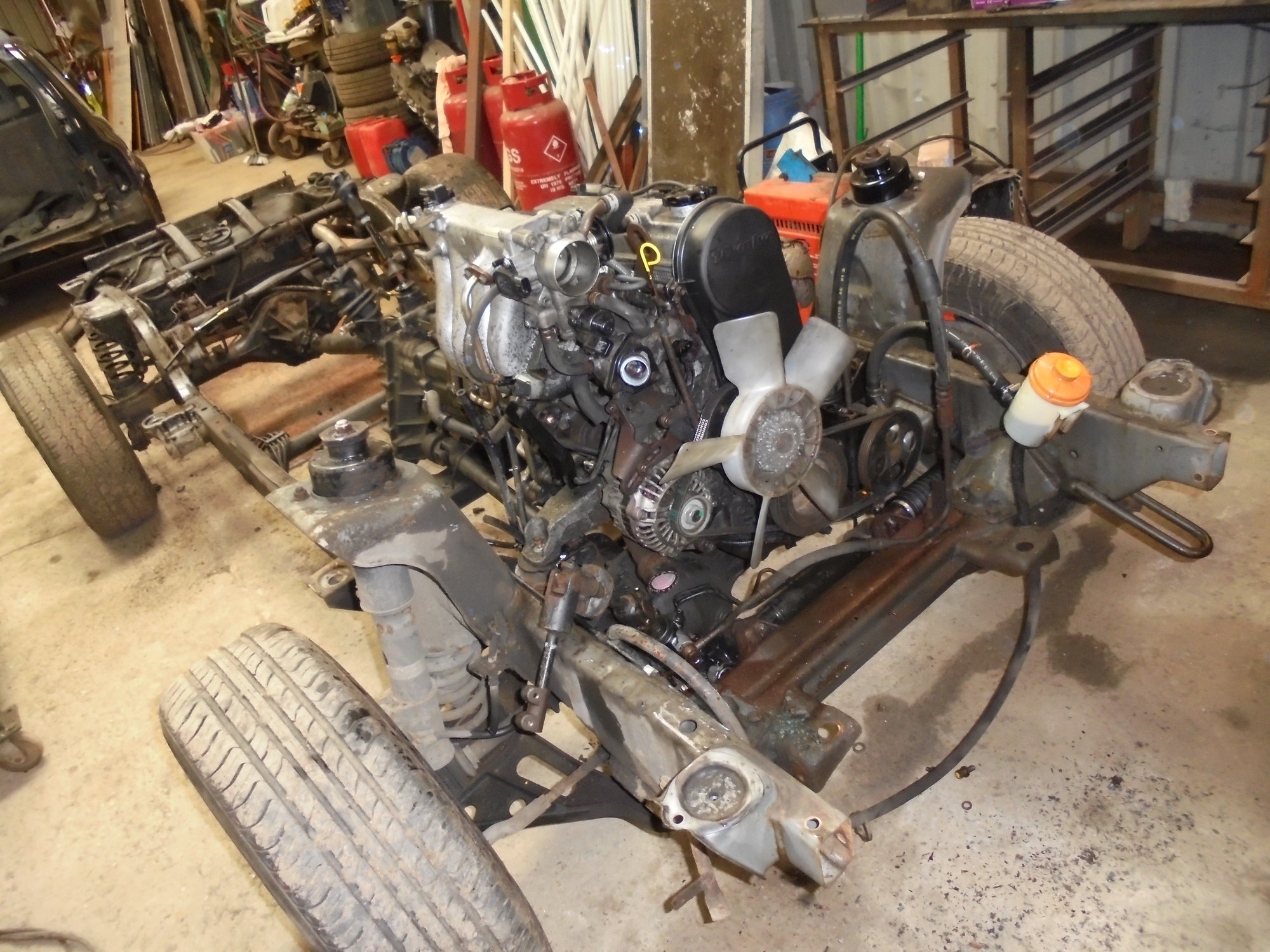

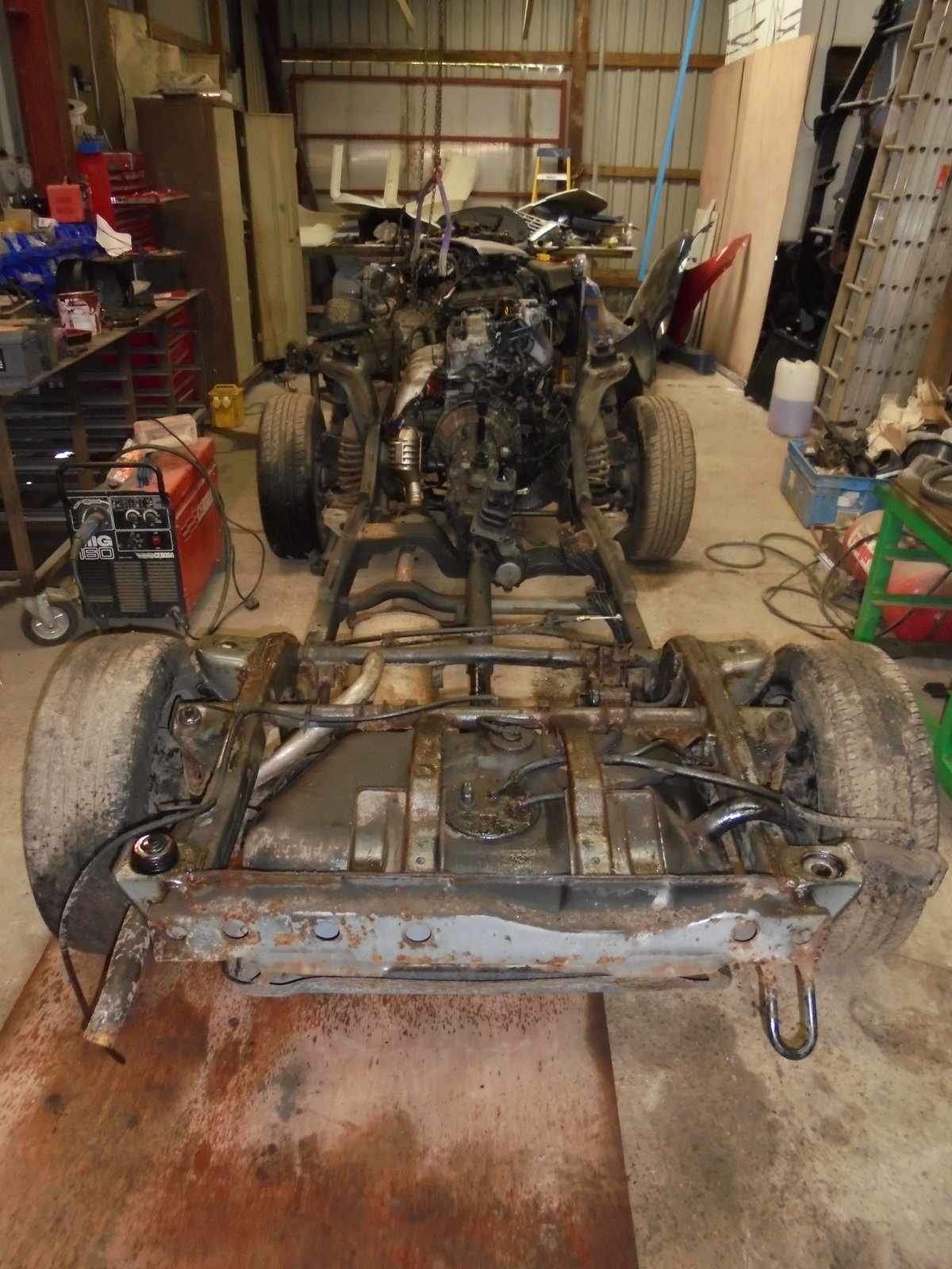

Have you got a pic of the Suzuki with the body off before you stripped the rest?

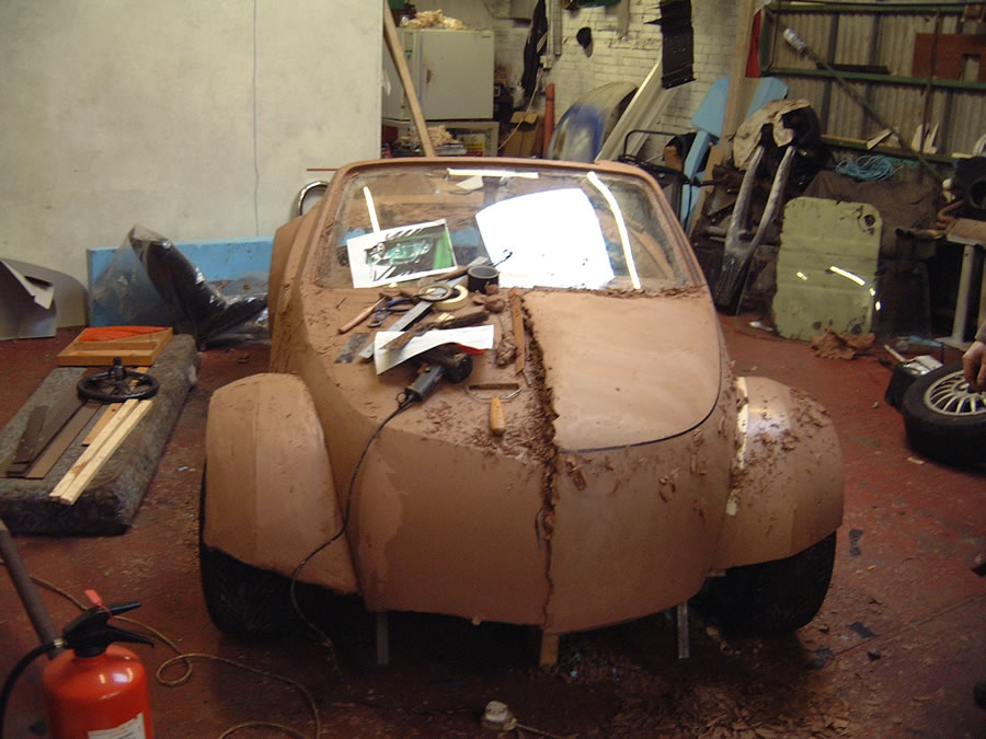

- what happened to the Hoppa - that was some great glass work!@Baloo remind me not to come in my Vitara next time I visit, I'll probably be walking home due to bits mysteriously disappearing![]()
It's been bugging me but I knew I had seen that chassis pic before somewhere- what happened to the Hoppa - that was some great glass work!

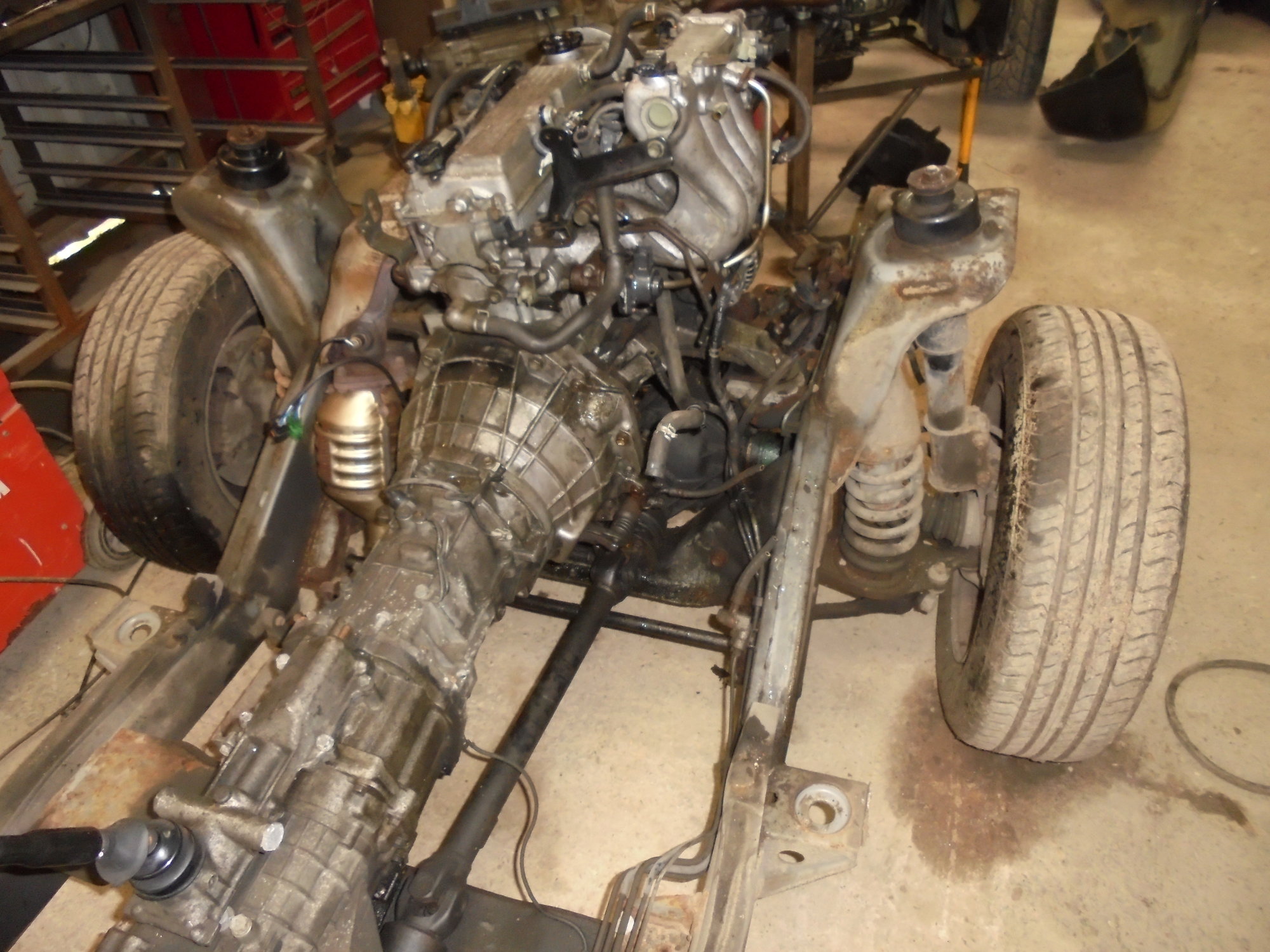

Also excuse my ignorance on all things Suzuki but when the Vitara is not 4x4 is it RWD or FWD ? Looks like a great base for a conversion, as it is not a monocoque so no IVA.
