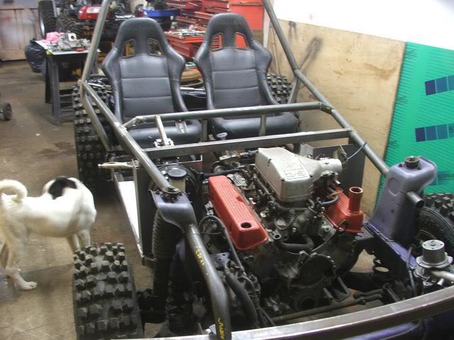

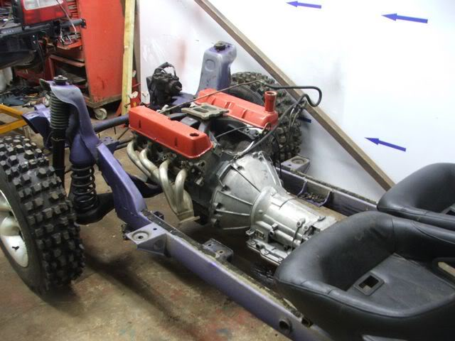

subaru boxer engine is also very lowDry-sump it and tilt it over.

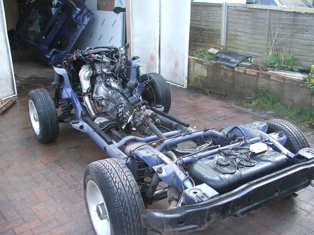

Sorry. Had not spotted from the pics that you are doing an engine swap. If you can score the IVA 8 points it will save you a lot of money on an IVA
https://www.gov.uk/vehicle-registration/radically-altered-vehicles
Build it with the original engine then swap it after registering.
Wasn't sure if you appreciated the implications of messing with the suspension and axles etc. as well as the engine. - Not everyone does!
Very interesting to see that the Suzuki is not a monocoque, gives great scope for this sort of build
I like you! You're mental!

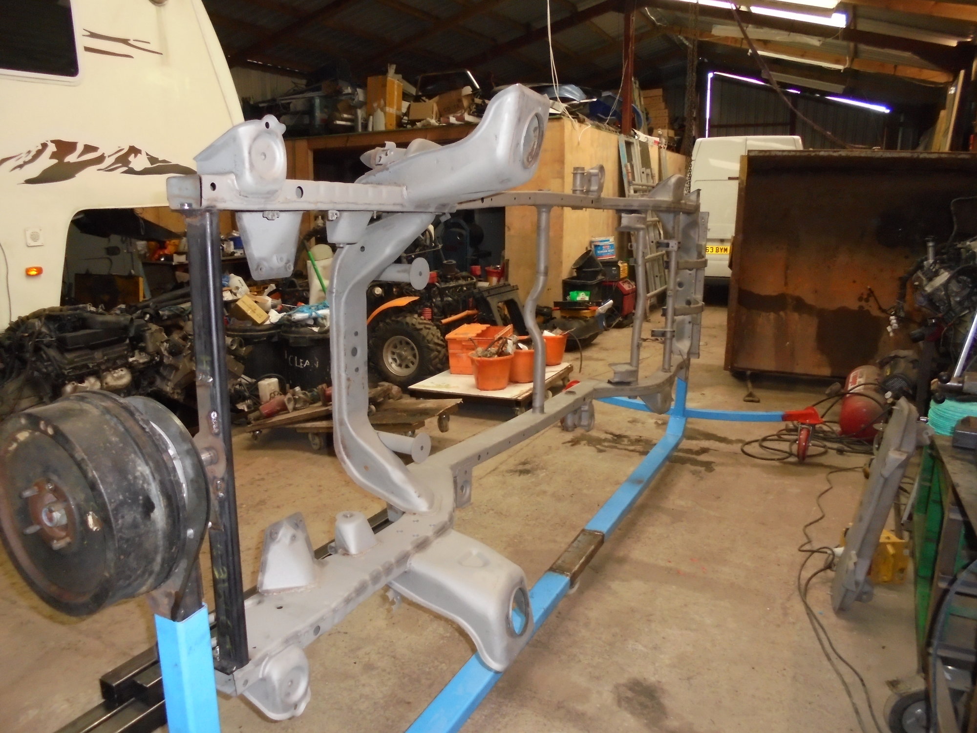

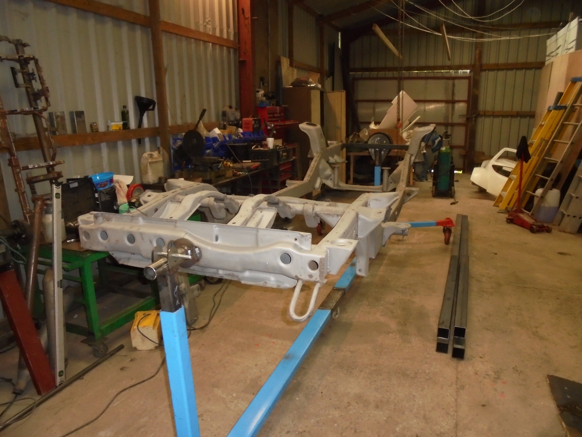

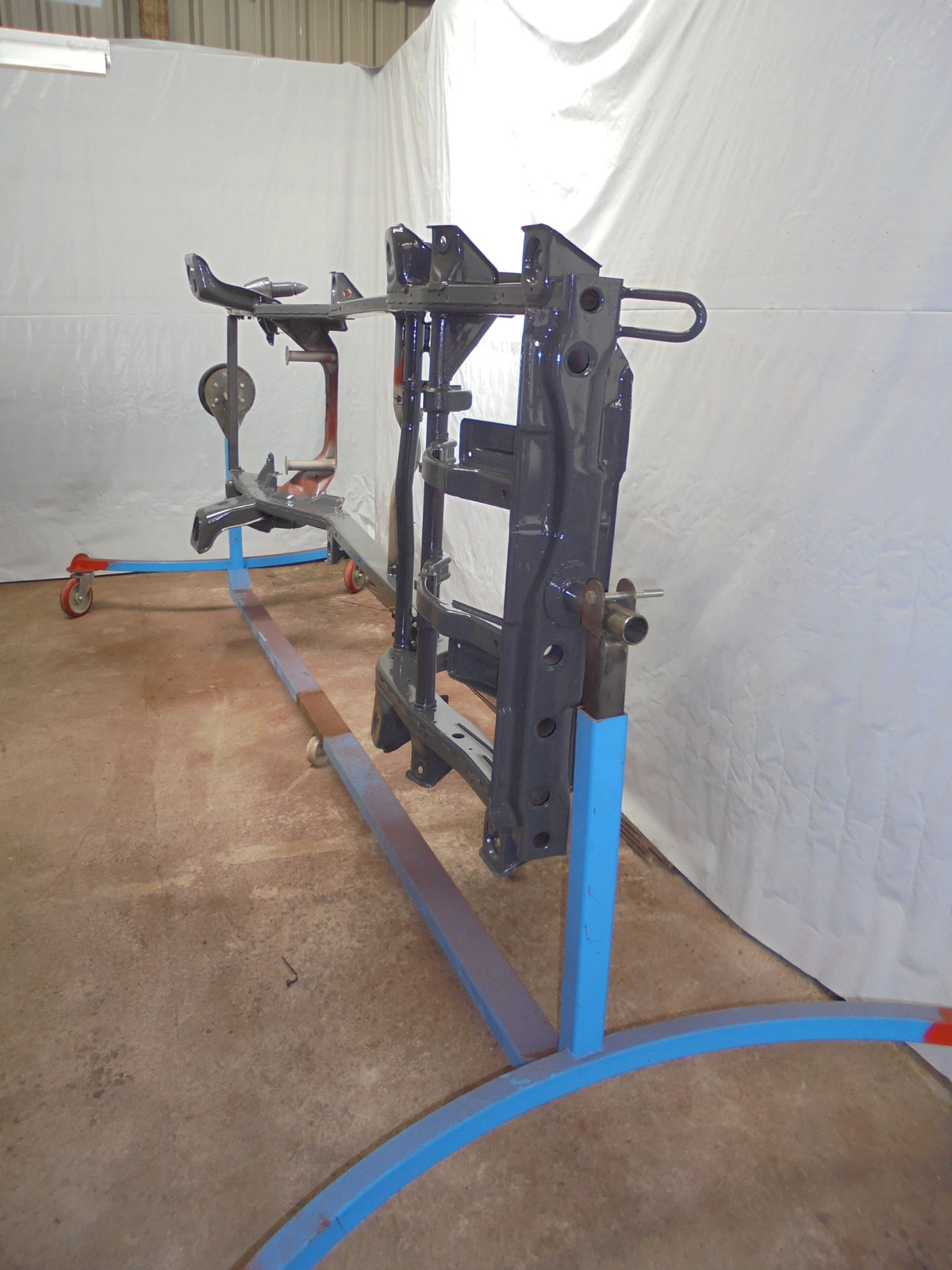

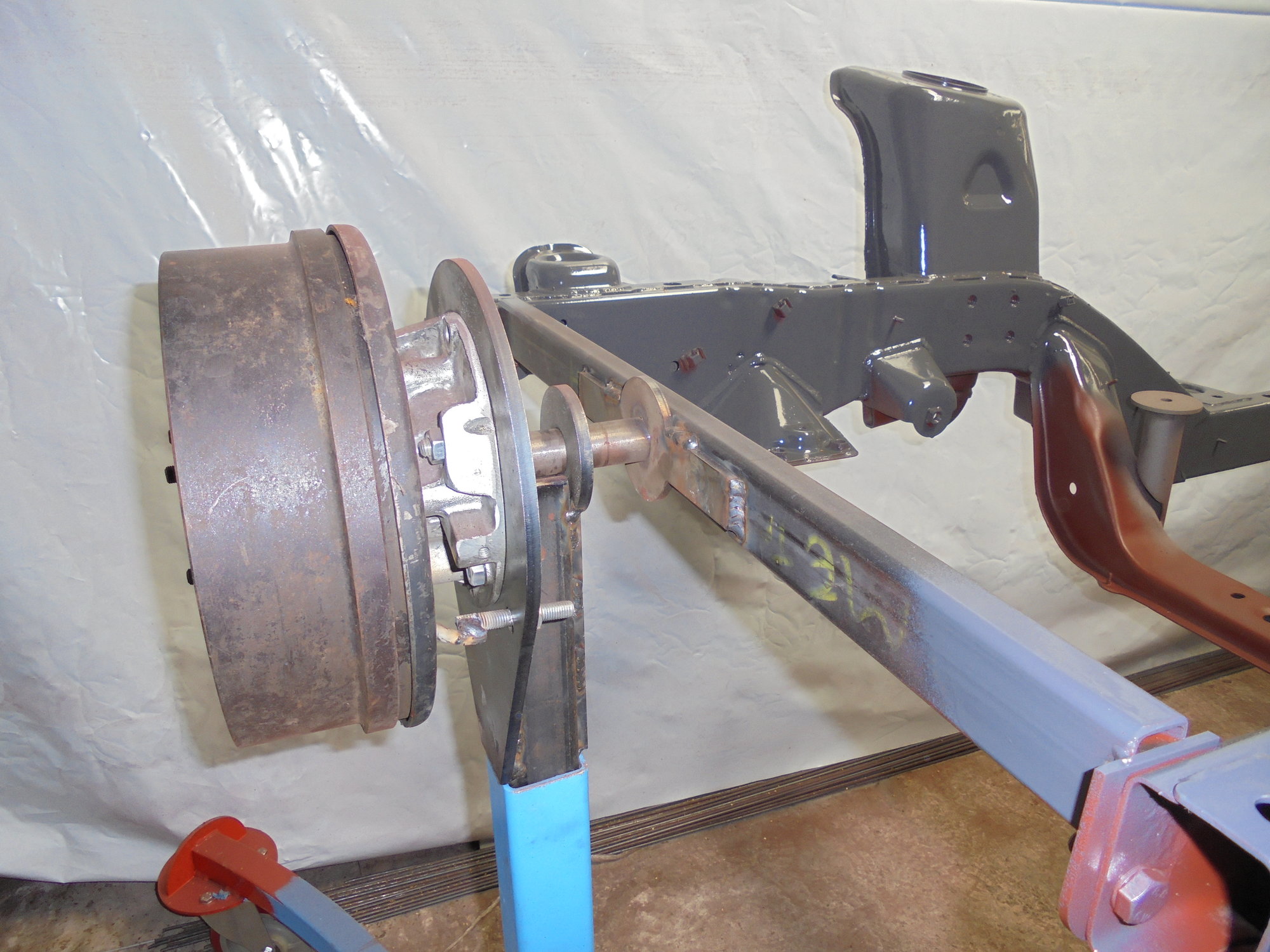

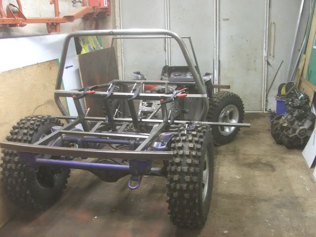

no worries sir, vitara is a proper ladder frame chassis made from mainly 4"x2" box section, wont be changing any suspension or steering
have used them for many projects for many years
View attachment 131978 View attachment 131979
