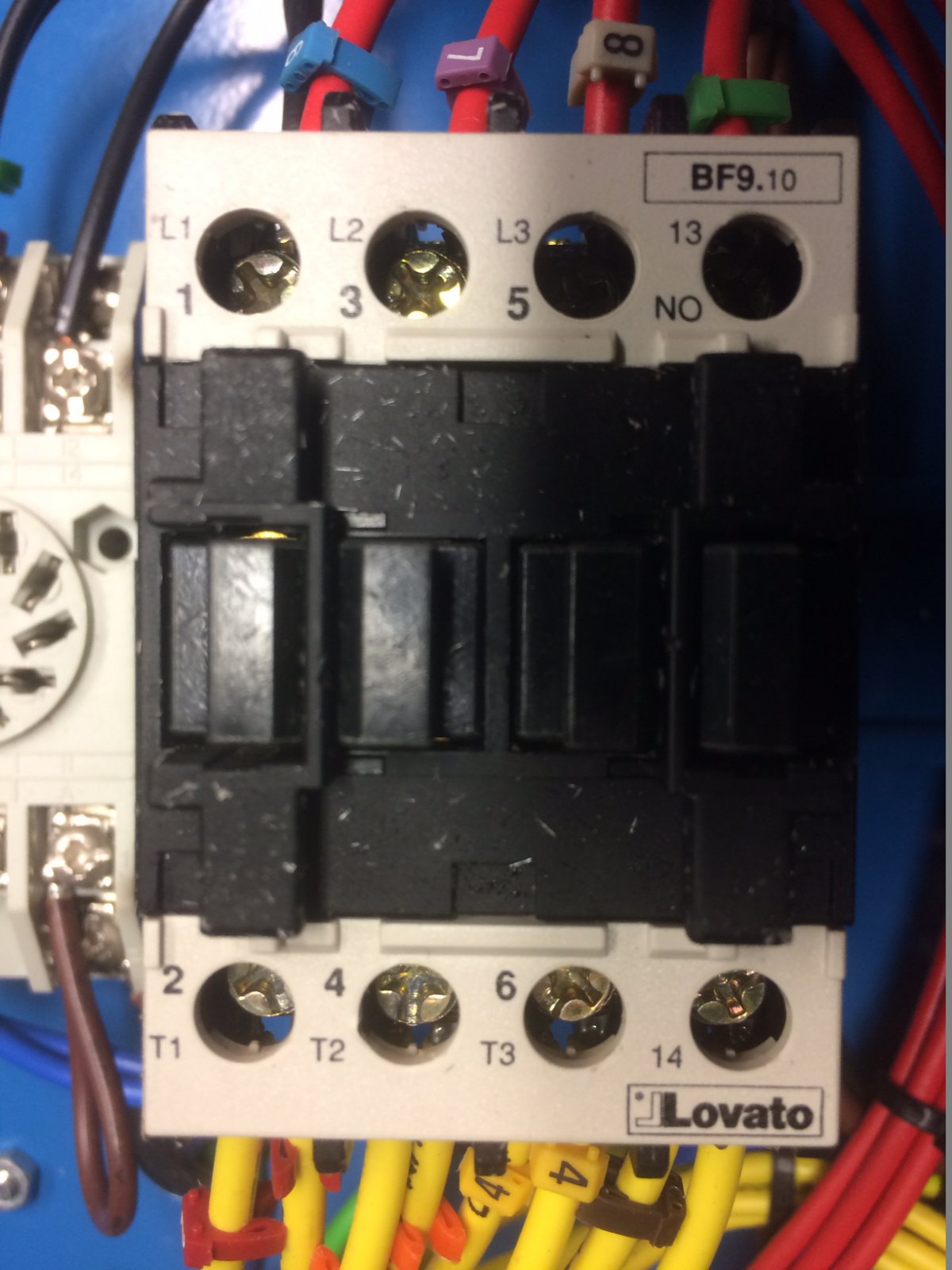

The one linked to is not suitable as it's an undervoltage relay.Please forgive my total ignorance, im an Engineer Surveyor for Zurich Engineering on the Lift/Crane side the only electrical element of my inspections is for obvious damage/
burning/connections in say a lift panel or tripping limit switches, so does the lack of an adjuster on the item @normspanners kindly provided a link to not matter as it covers
the full range ?

Yes I believe it only works with the one contactor @daleydLooking at the pictures again it only seems to be operating the contactor next to it? If so then a smaller rated unit should suffice, but best to check.

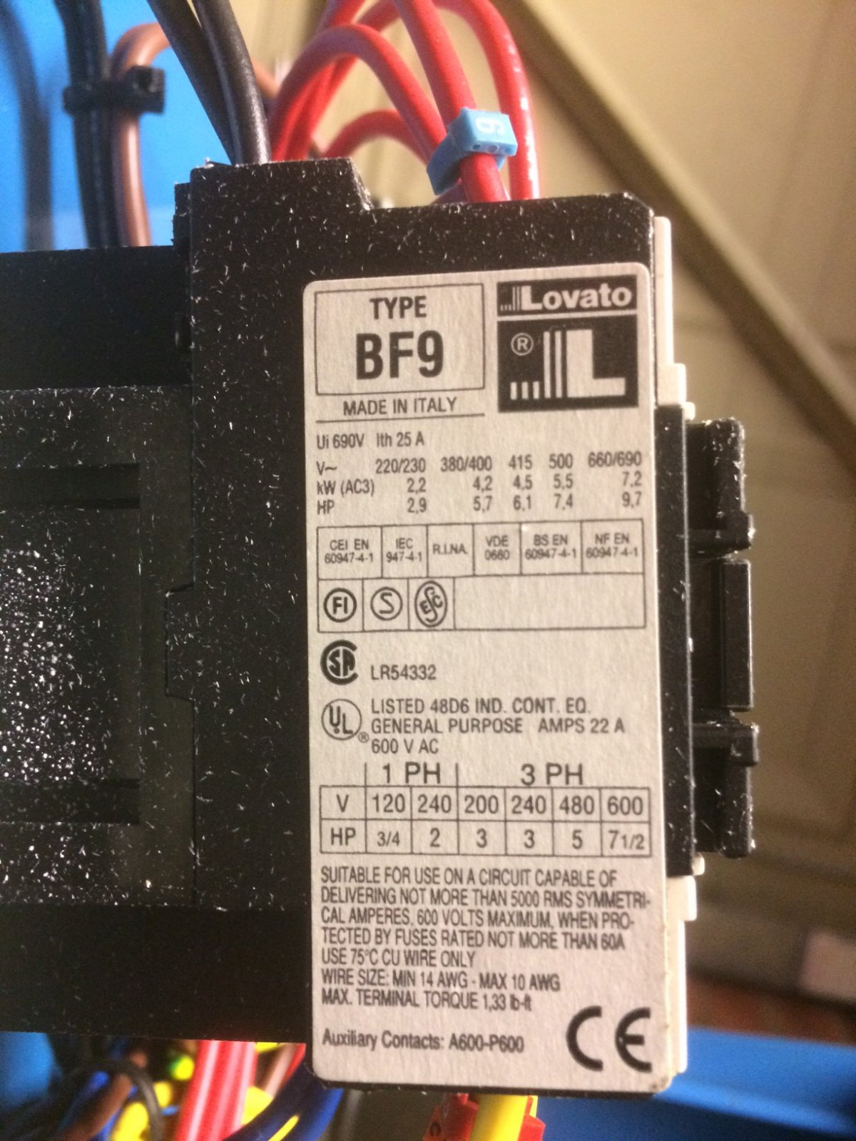

Right off out to the workshop to check !!Just follow the cables from the voltage sensing relay contacts to wherever they go. If they only go to that contactor then I reckon your into a winner as it'll only pull a small amount of current, so you could get away with a smaller monitoring relay. If it powers other stuff then it gets trickier!
Ah just seen your post above as I'm typing! - if it's only the one contactor then you should see some info on the side of it telling you about power consumption. With this you can determine the size of relay you need to switch it.
, but I appreciate if your not used to the terminology or where to look it can be a bit daunting!

Hi, this relay looks like it will do exactly what you need @Simon Melton.
It may well be a bit overkill for your application, but it's the only one I can find that matches the broyce unit specs and is in stock in RS. (240 v single phase supply and separate monitoring up to 300v - this one actually goes to 600v but you can select the range to suit). It looks to be very adjustable so you should be able to set it up exactly the same. The data sheet is very good and explains in some depth the operation modes etc. The output relays are rated to 5A rather than 8 but as you are only using it to drive the one contactor it should be OK.
