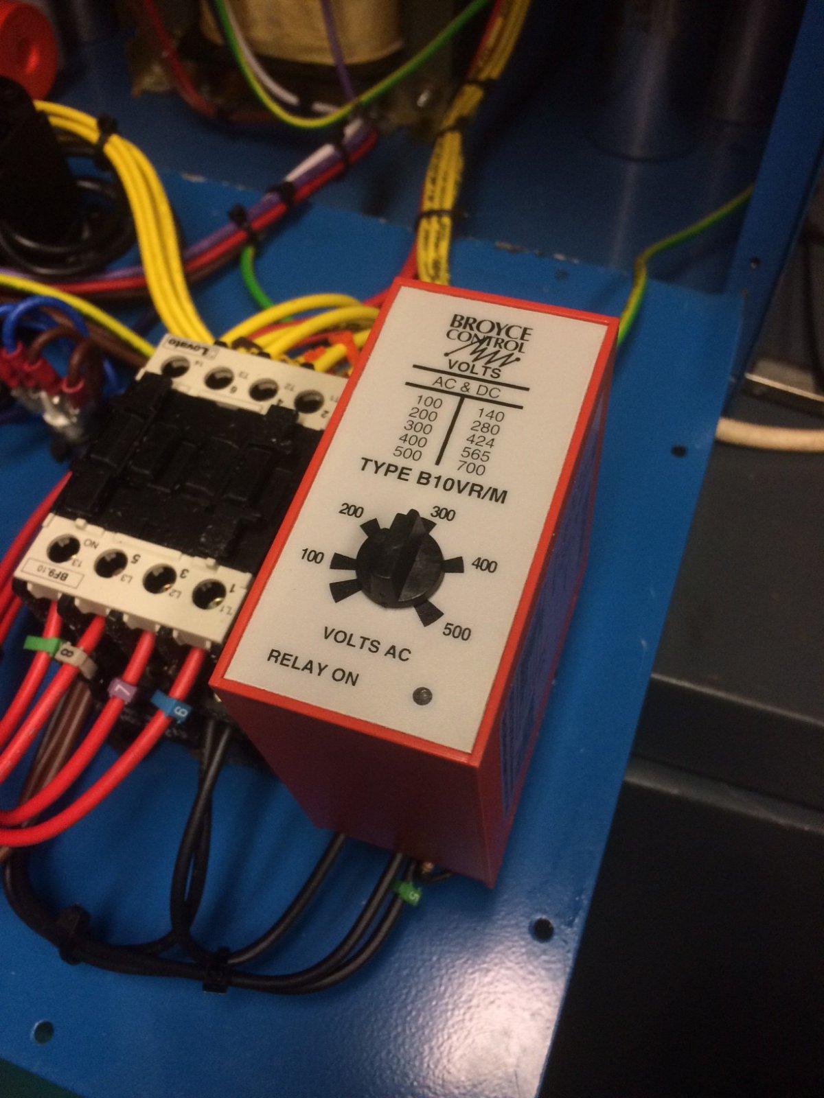

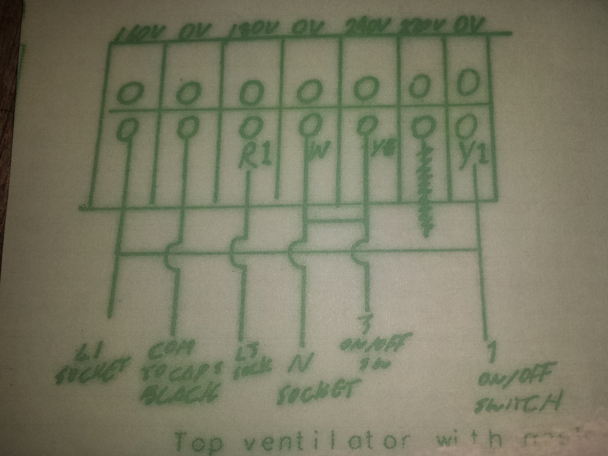

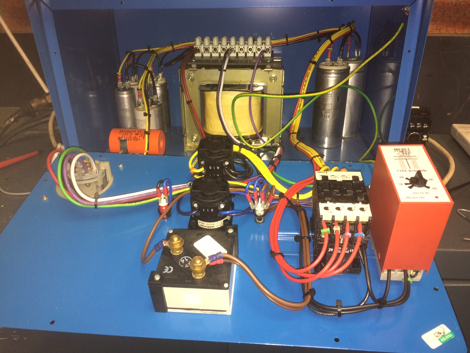

If disconnecting them gives you a working unit, but with reduced output, then maybe the problem is one of phase. It's possible that one winding has been reversed so that it subtracts rather than adds, disconnecting it gives you two working phases. It's a difficult one to resolve at a distance.
