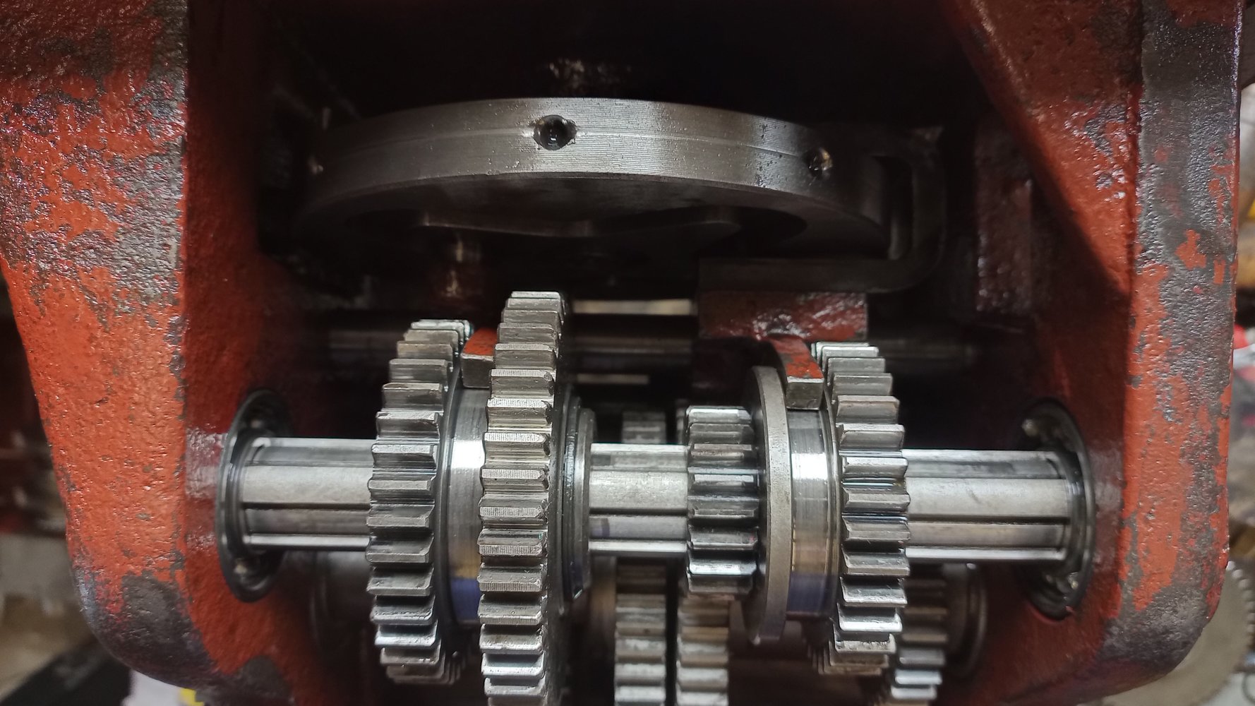

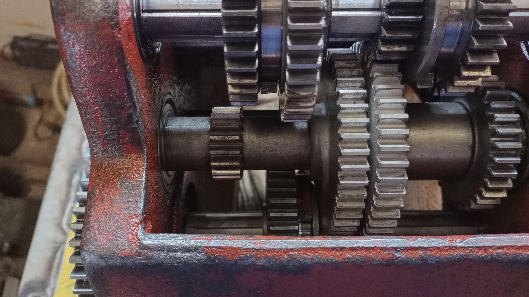

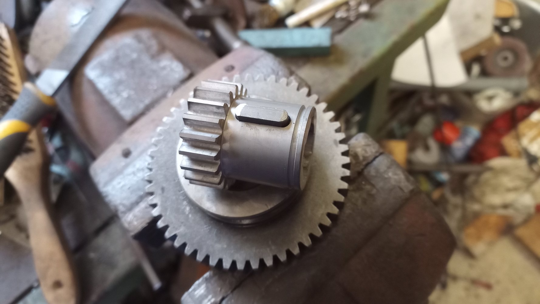

This was found many years ago when BMC nitrided the en40 mini cranks - they grew!Make a jig to hold gears at correct centres and use non-charging lapping paste to polish them back a little.
You can run the pair with a electric drill.

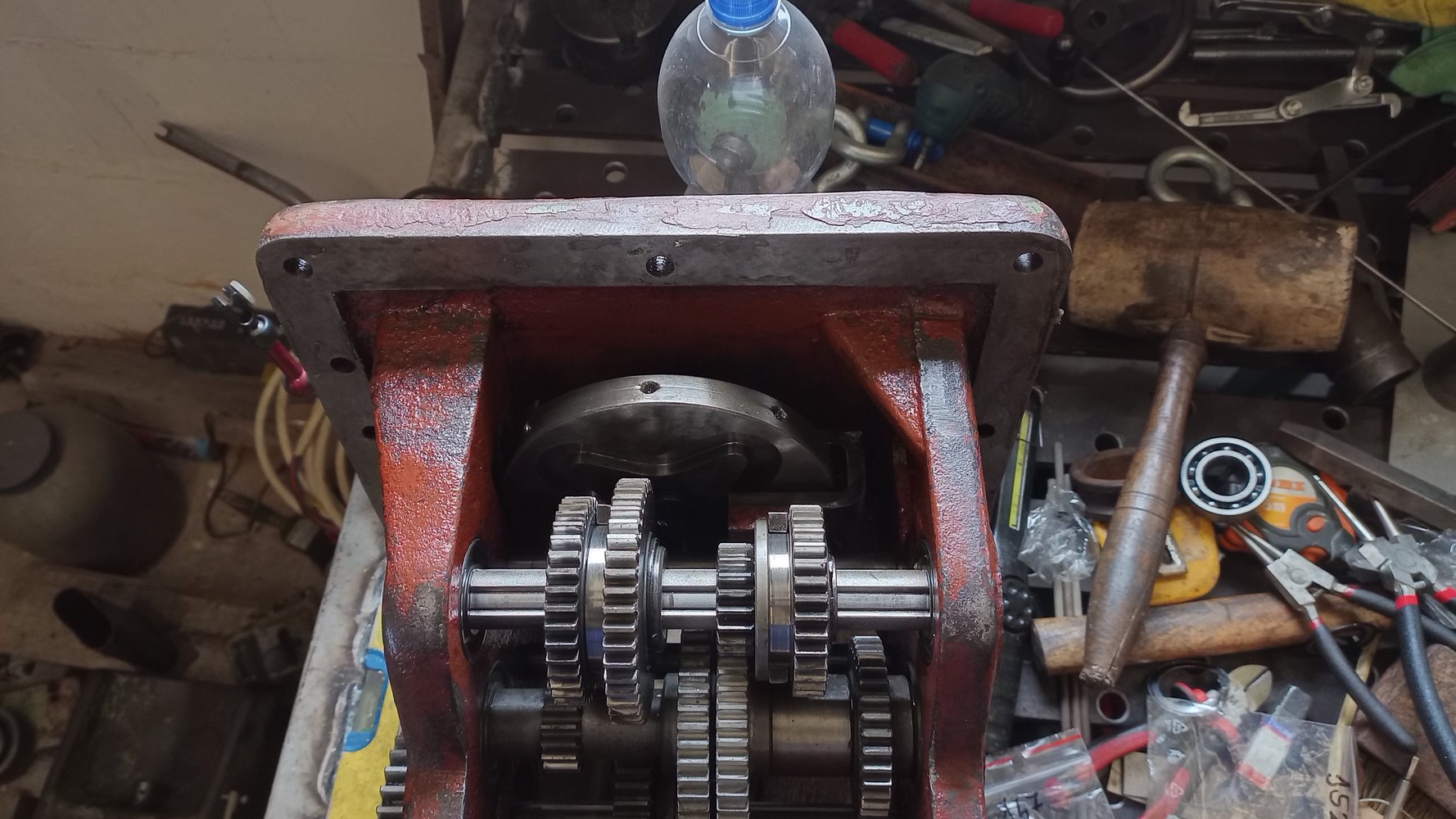

Doesn't sound too bad I doubt if it's any more noisy than mine at full speed. Those spur gear trains are always going to be noisy.

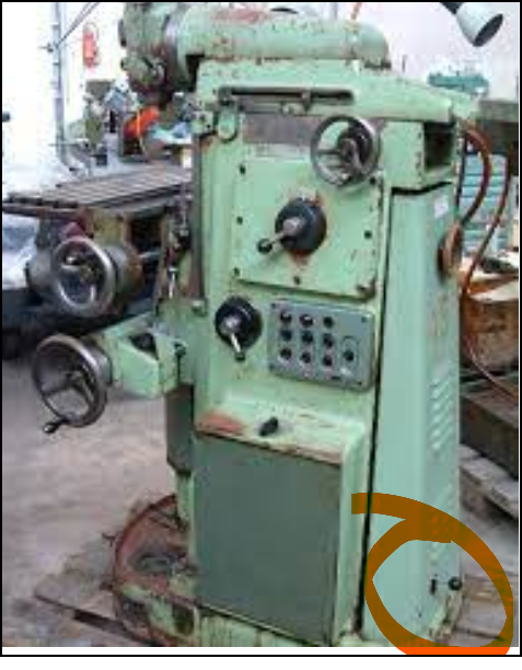

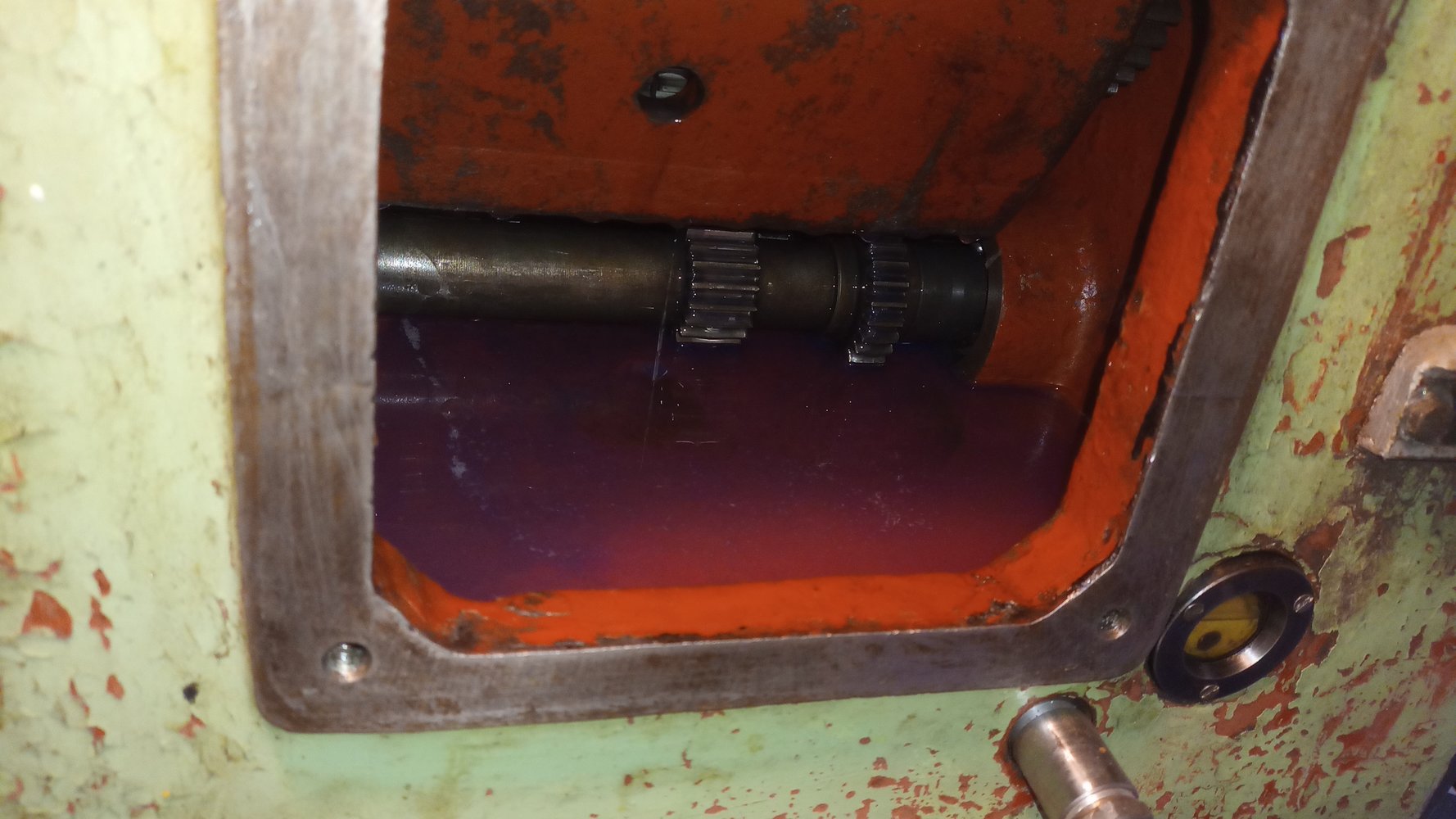

Do you have a feed gearbox in yours, in the base of the machine?

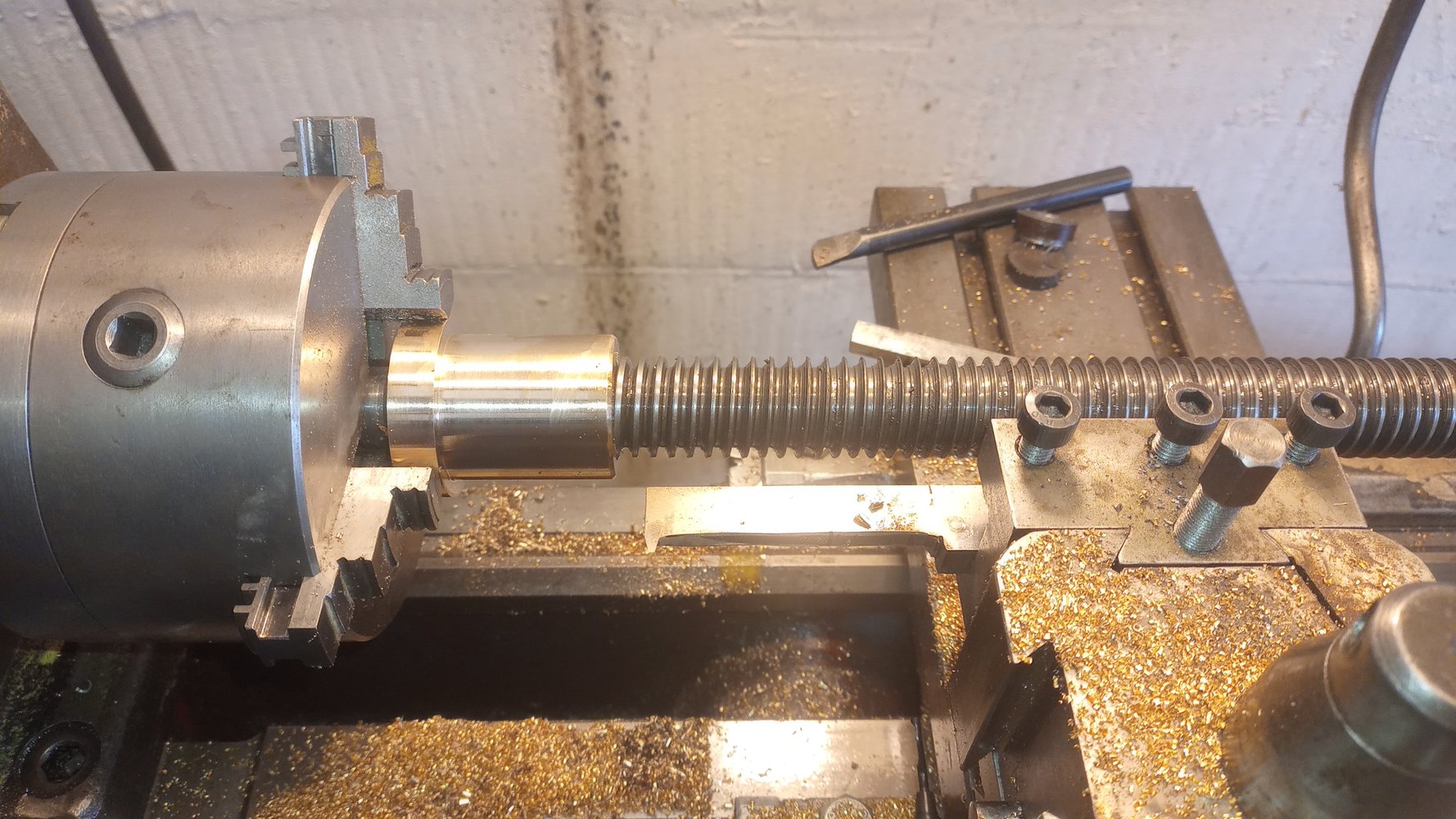

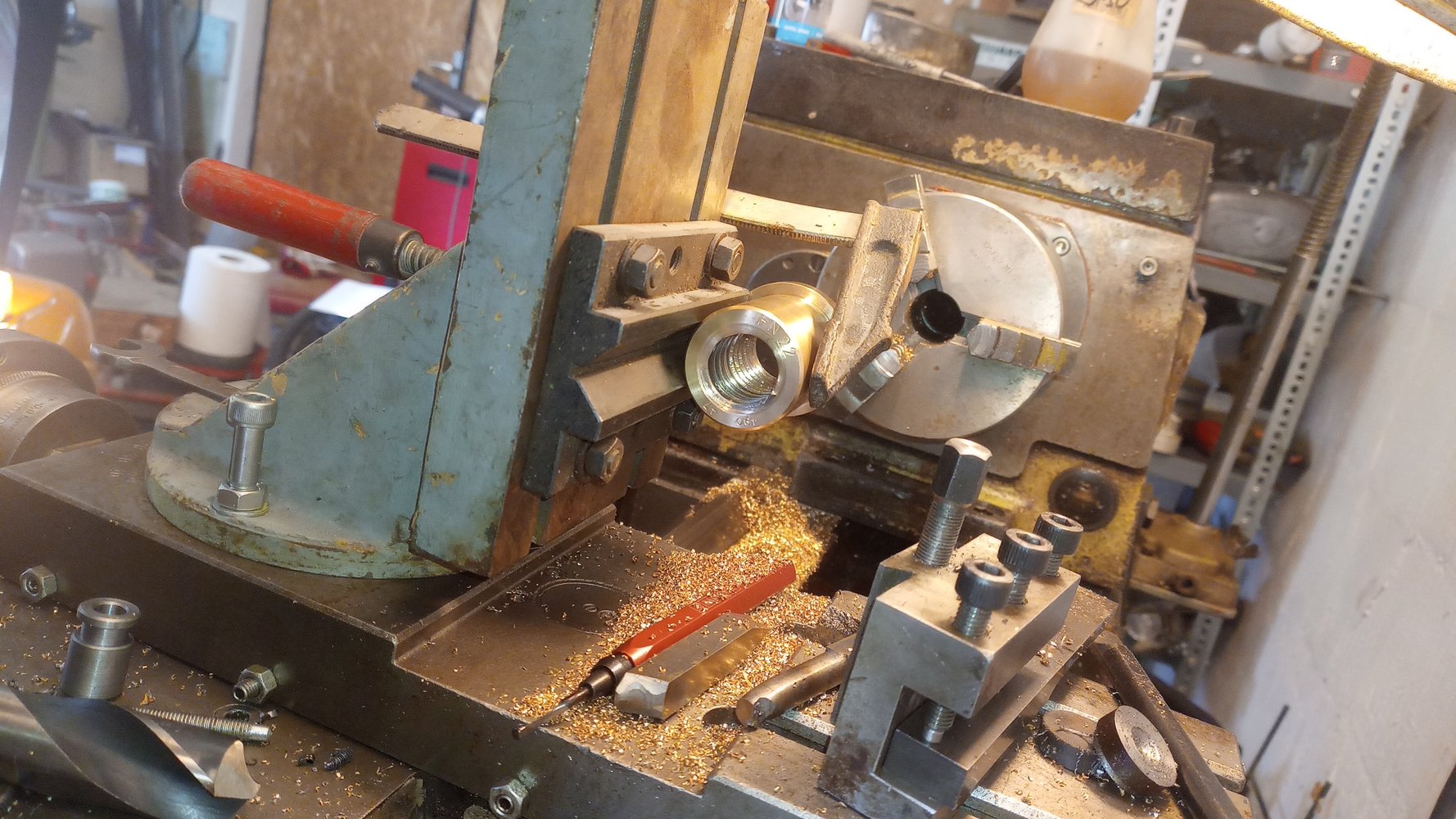

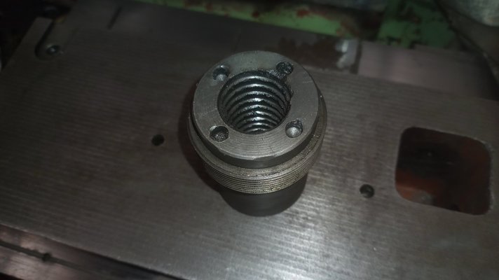

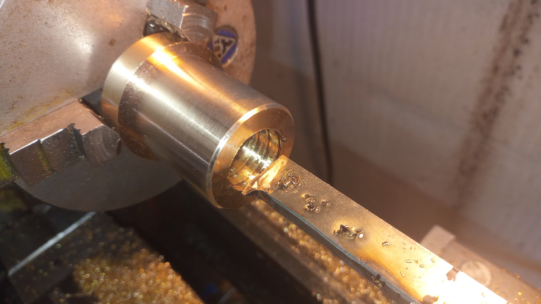

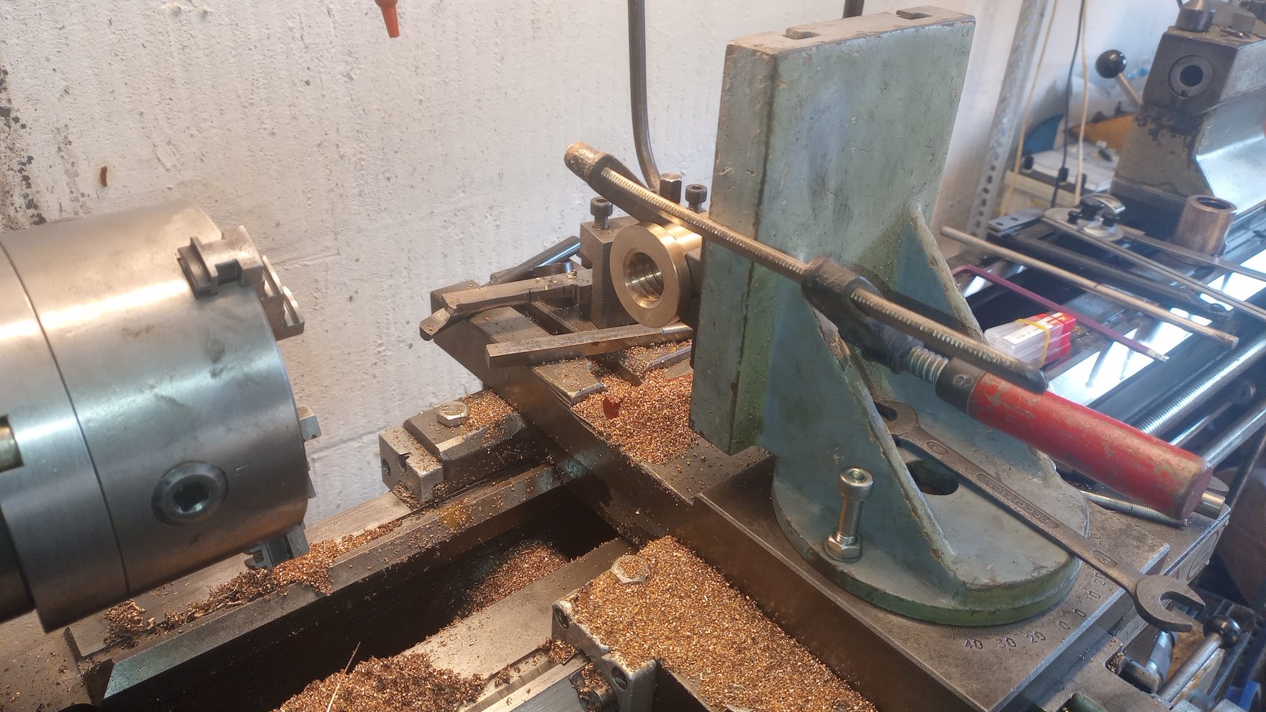

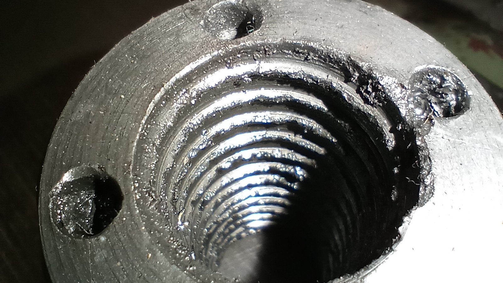

By the way, i took some photos about the replaced X nut..Thanks, it had a worse voice back then, you can imagine.
I'm happy how it turned out.
Yes, i have one, with the reversing gearset on the back. Right now the belt is not installed for the feed gearbox.
Yep, as I experienced now..Heat treatment makes thing get thicker
Sensible way to ht gears is to use induction on just the teeth
Yes, thats what I mentioned.What do you mean, reversing gearset? Does your feed gearbox have a rod with a round knob coming out the rear? I have seen photos of them but mine is not like that.

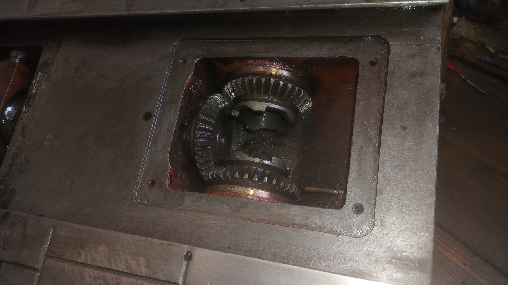

Yes, that lump is where the reversing gear is in the setup.I have the gearbox which is in good condition apart from a couple of leaking seals, but it is non-reversing although it does seem to have and extra 'lump' behind the pulley. I'm pretty sure that the machine doesn't feed when the main motor is in reverse, so I guess that is why the gearbox has a reverser.
Oh, how strange. Is the Deckel like this too does anyone know?In that case, your feeds will not functional, as the ratchet mechanism will push back the selector lever to neutral.
The "ratchet" mechanism looks like this in all axis:Oh, how strange. Is the Deckel like this too does anyone know?
My Aciera has a separate motor for feeds so is independent of the direction of the main spindle.
Is there room for you to fit a separate motor @Pete. ?
