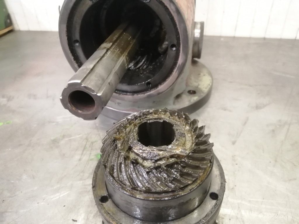

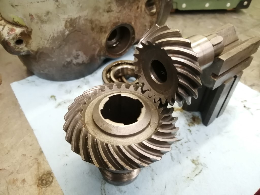

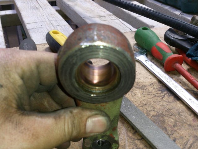

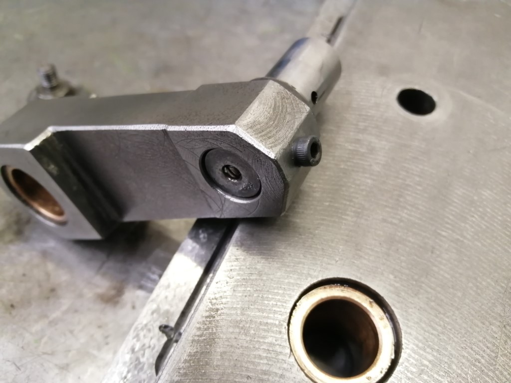

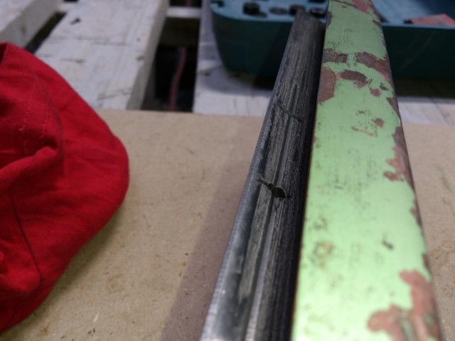

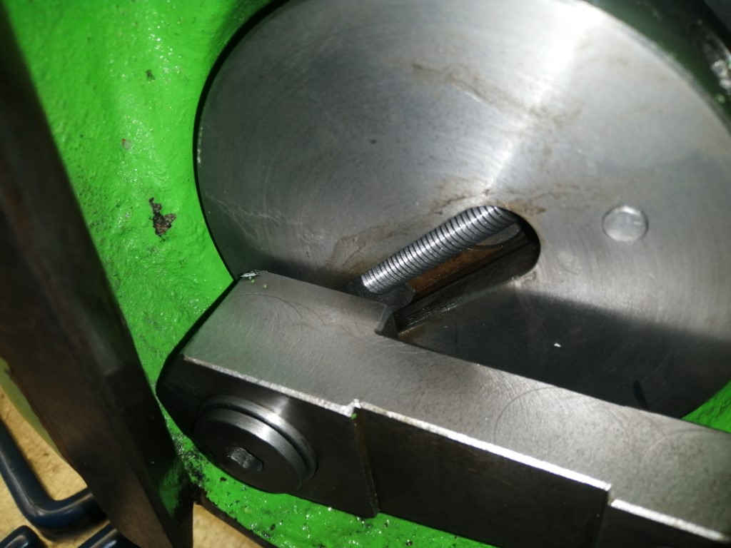

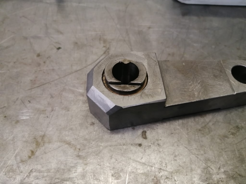

Pete we could build up the broken casting with braze or if you want something that matches the casting, Nickel powder
Thanks Brad that's definitely something worth looking at

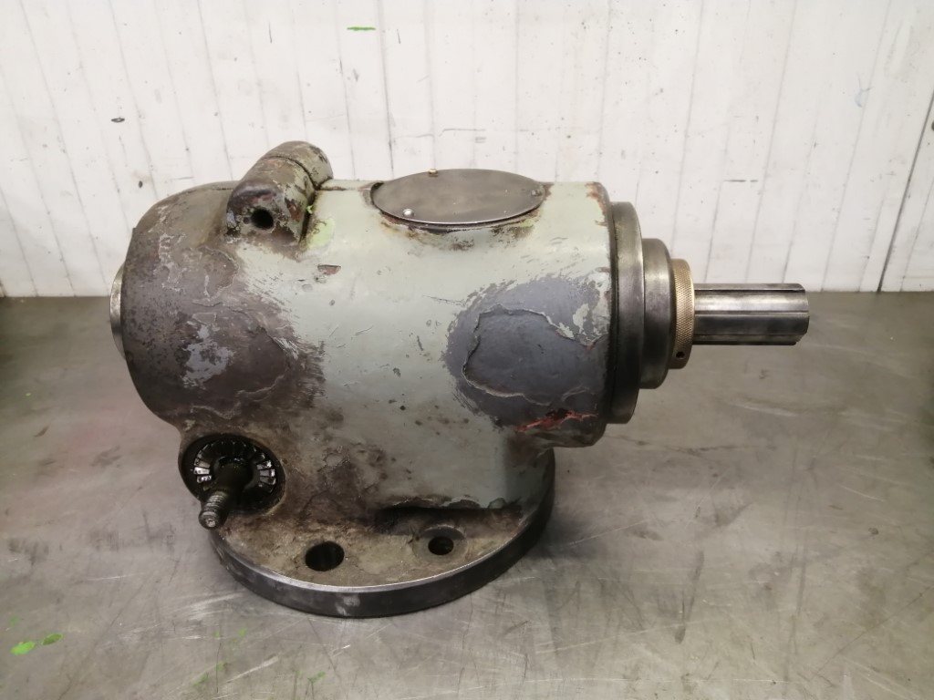

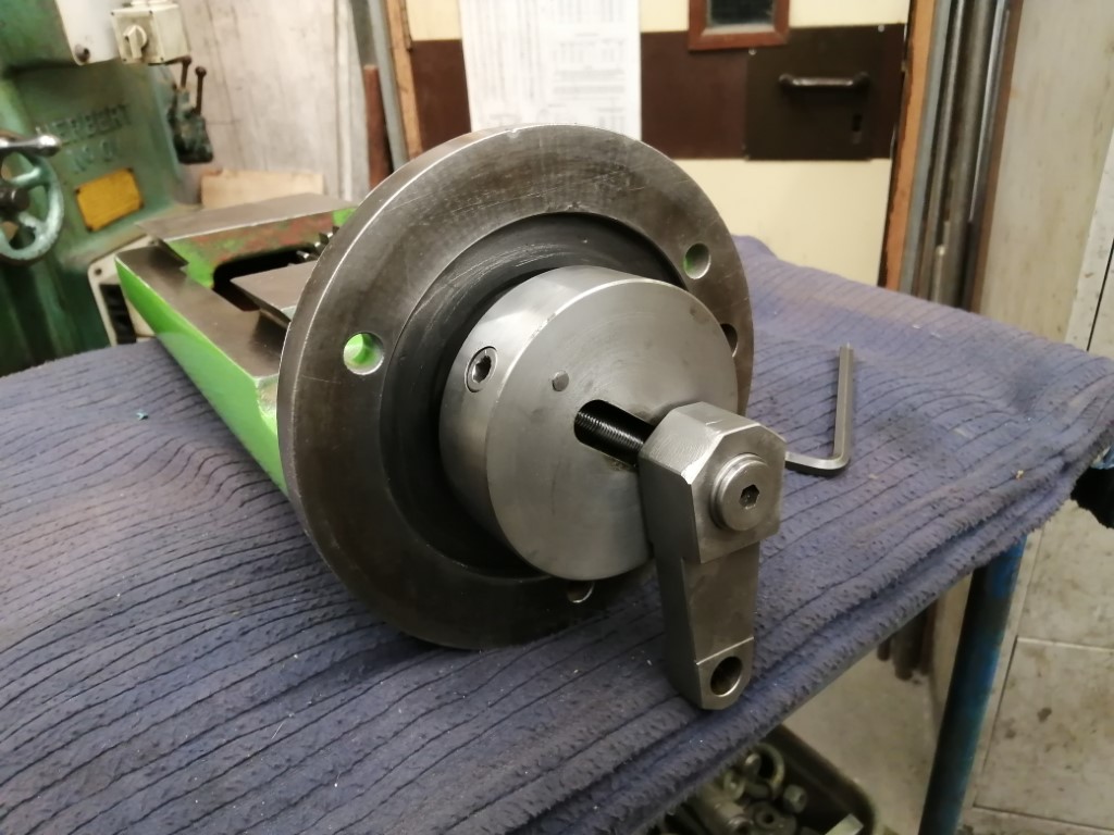

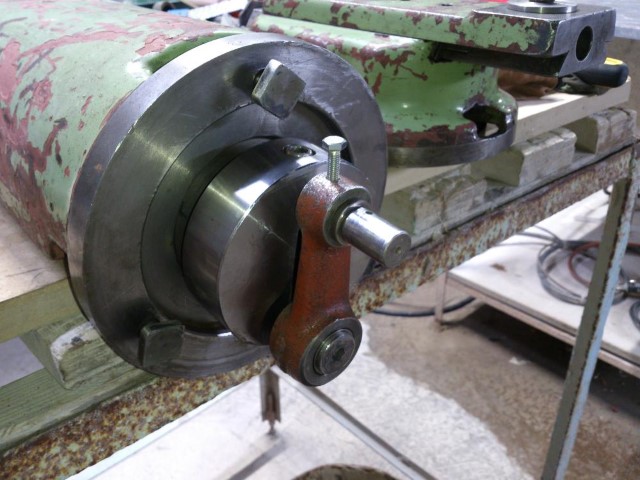

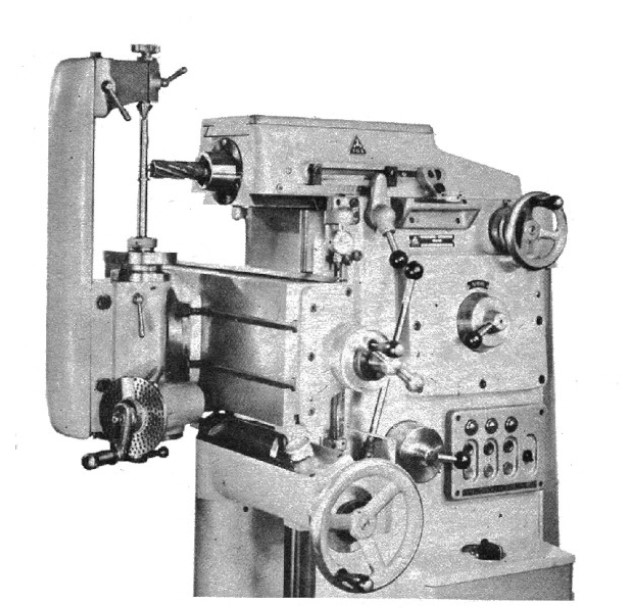

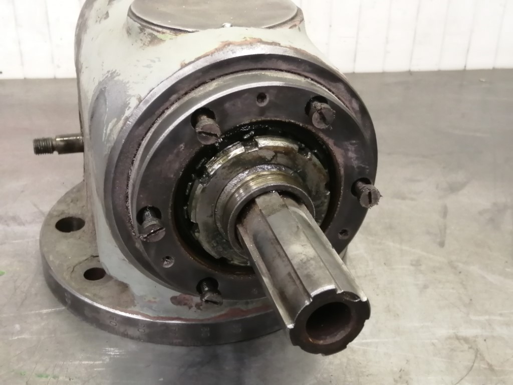

It just occurred to me that it might not be obvious how this attachment is supposed to be used. Basically it fixes to the machine in place of the table and is used to hold parts for machining. Can be used with the over-arm as shown or with a part just held in a collet or there's a thread to screw on a chuck. The arm is shown vertical but it can swing 90 degrees left or right and can also tilt towards the machine 15 degrees or away from it 10 degrees. I guess this is to allow a lead angle for gears etc.
