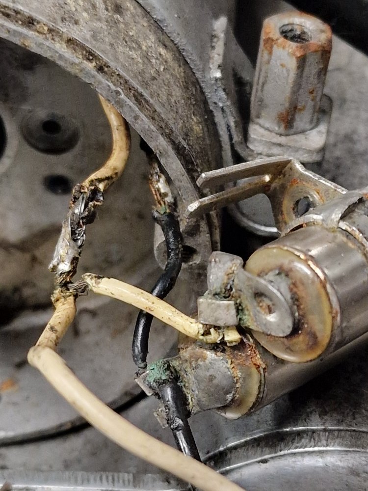

I've yet to take off a failed alarm, I have however taken off a few that were fried by **** poor installs. High resistance connections being the main culprit where they've been installed with insulated terminals from the local market, bodge locks, and solder gobbed on.The best thing you could do to a Datatool alarm is cut ALL of the wires. I've had to personally remove three failed ones from different bikes.

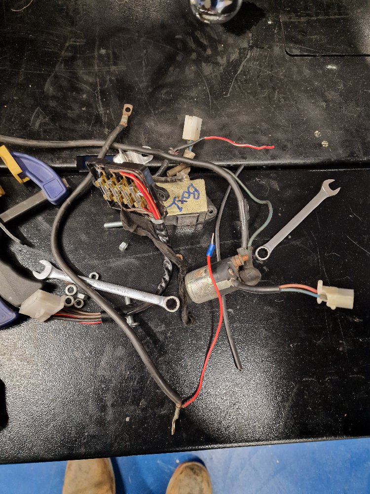

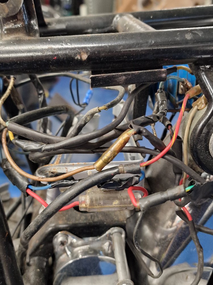

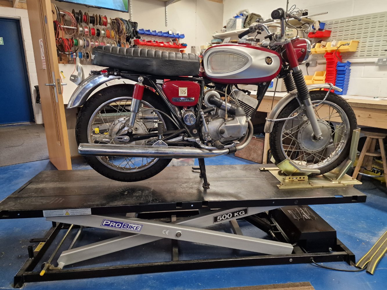

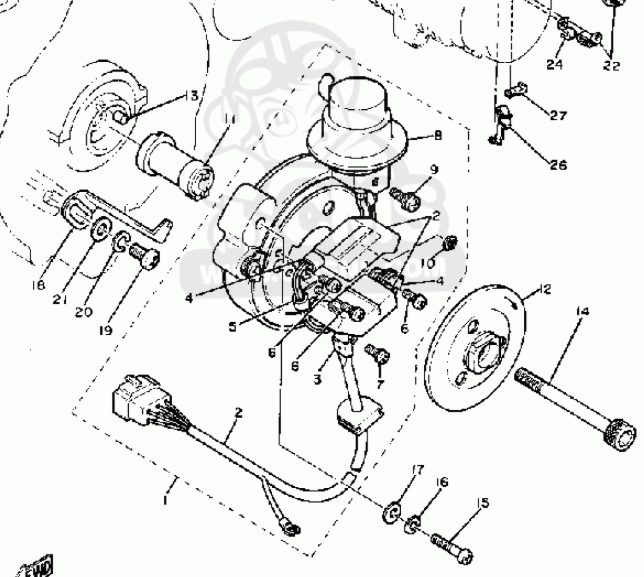

Did you find somewhere to squeeze the earth rail in?.Getting rid of a load of 48 year old stuff to be replaced with more up to date gear with the custom loom.
View attachment 538718View attachment 538719

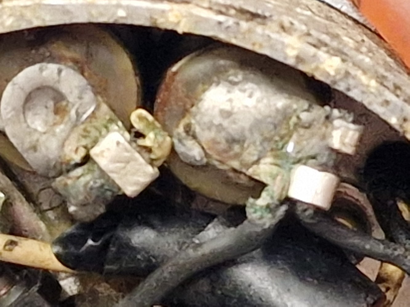

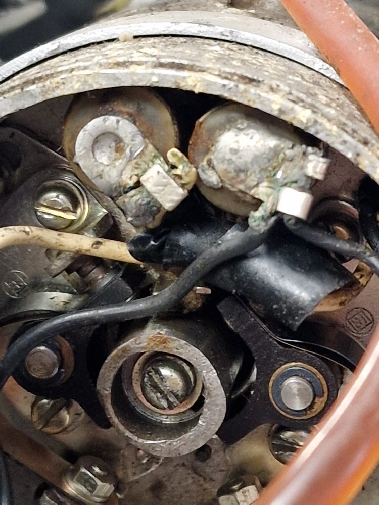

De-pinning the old TCI connector blocks so that they can be remade with new terminals.

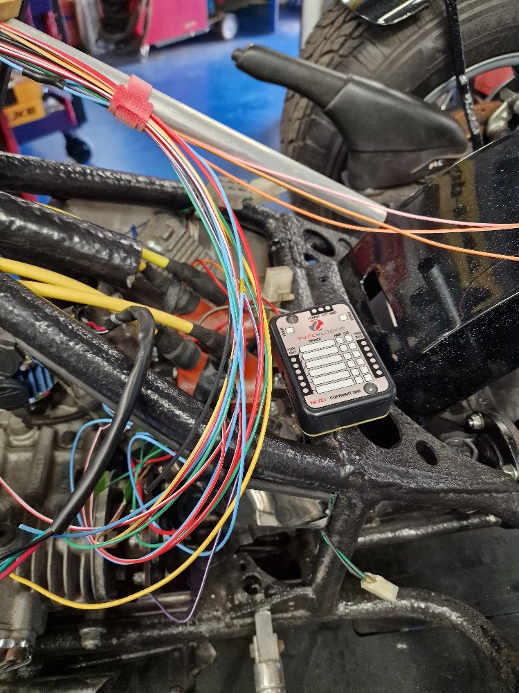

He's bringing the seat and tank over on Monday so that I can see what the space is like. I suspect it will either need the coils moving elsewhere or another box fitted behind the battery box as there's quite a bit to wedge in and with things like the coils & reg/rec generating heat and interference I don't want it all rammed together.Did you find somewhere to squeeze the earth rail in?.
