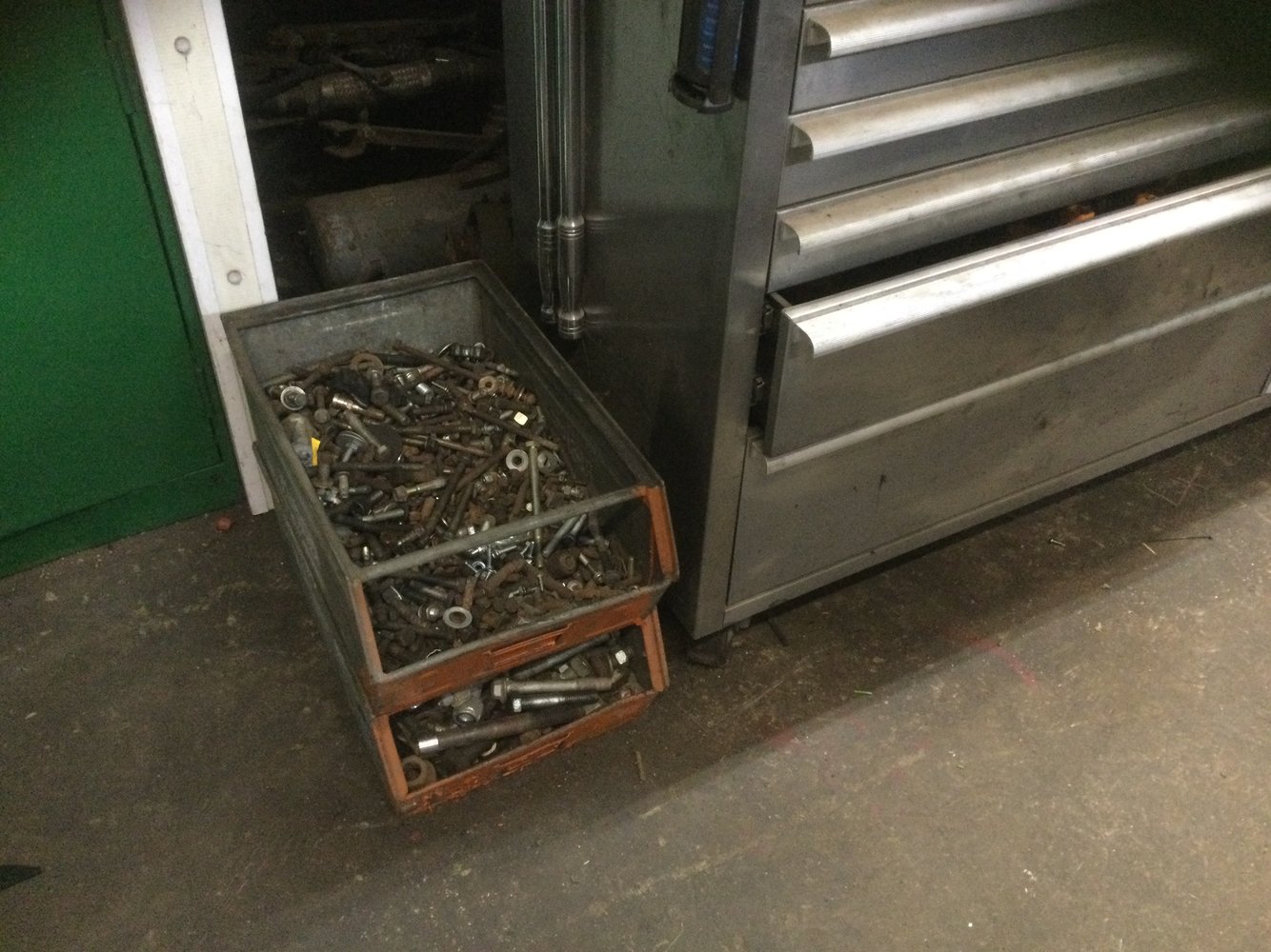

Yes you can.
2 tins of things.
I agree, one for big things and one for small things
